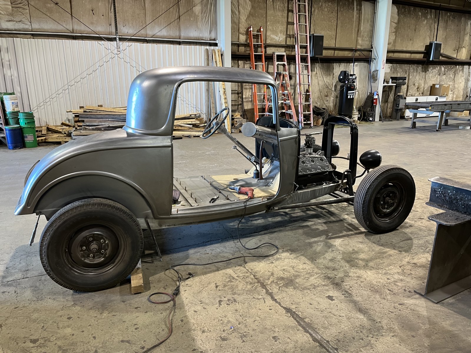

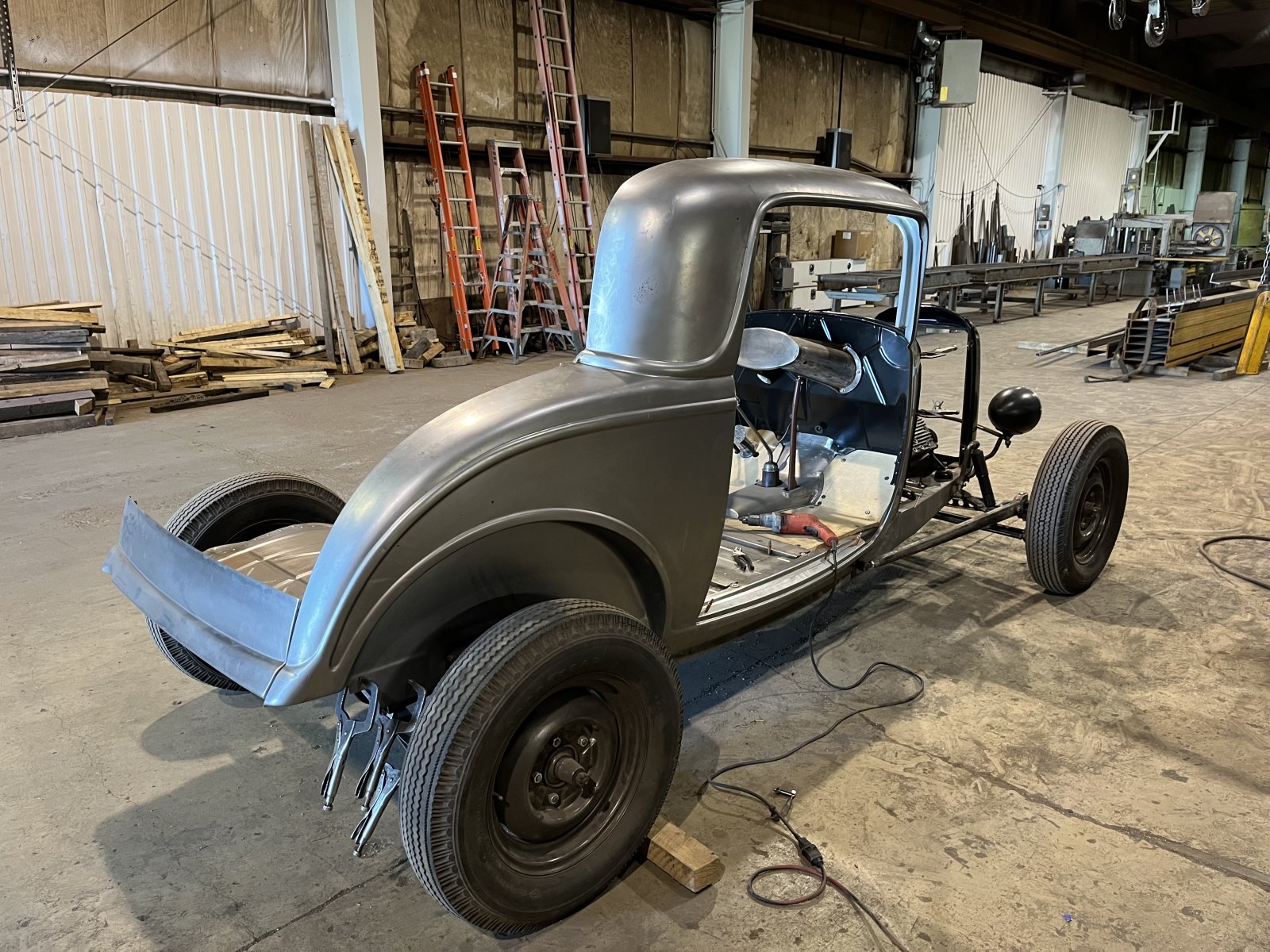

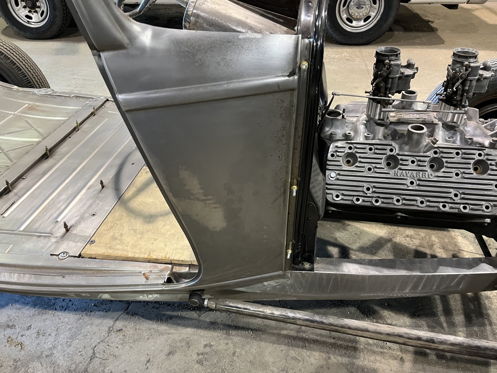

    16058045-A301-4496-9542-6CA89EC45BD6.jpeg 13F5D690-0A62-428D-A7A2-5815143C3CD6.jpeg 13F5D690-0A62-428D-A7A2-5815143C3CD6.jpeg What did Ford do to secure the body to the firewall in 1932? I’m building a 3-window and I am wondering what Ford did there or even what others builders do. I’m temporarily using clecos

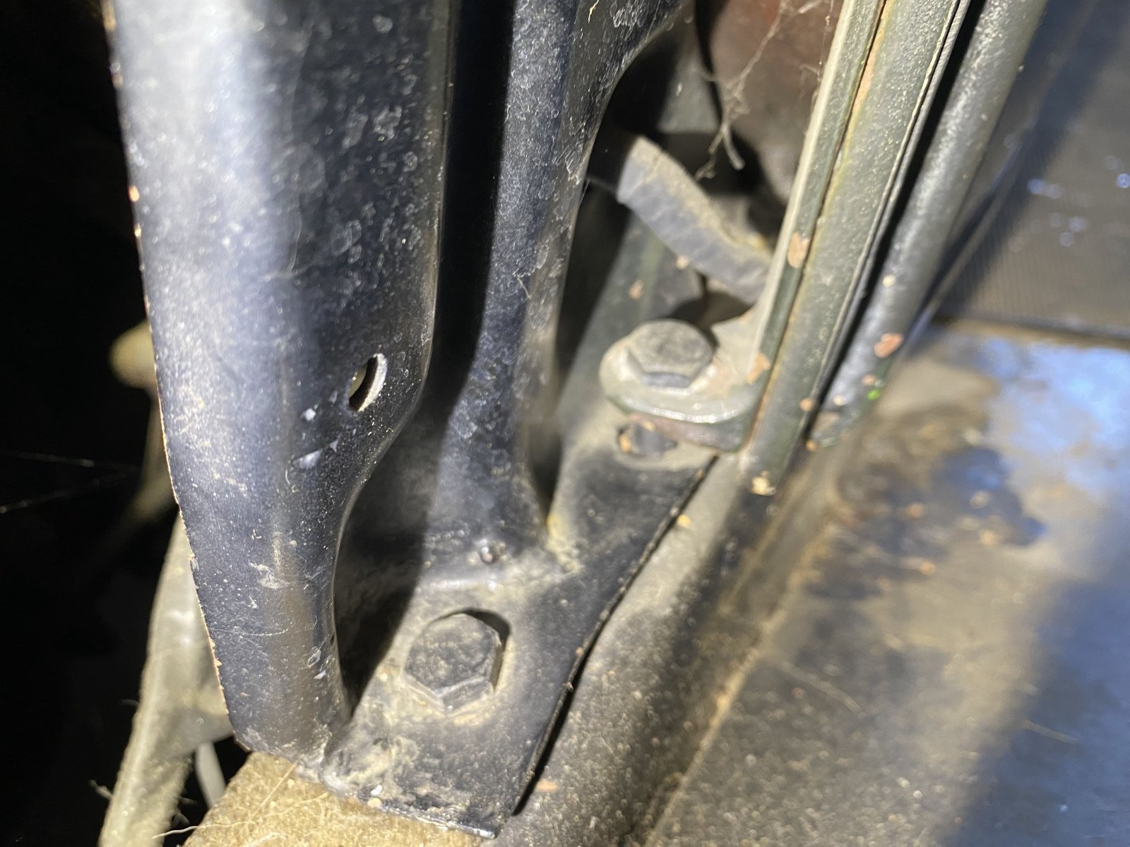

    I ***ume that you are ***embling a flat-pack Brookville 3 window. There are no factory fasteners where you have those clecos. The body to firewall fasteners comprise 4 in the top dead center of the cowl where the hood is attached with a body/cowl bracket and the bolt each side at the bottom of the cowl which goes from the cowl through the center hole in the firewall feet. And there is a rubber sealing strip between the firewall and cowl and you will need that in place to get it right.
  4. The ch***is came down the ***embly line and the body was installed. The body had a bracket. A bolt was installed thru the and the frame to pull the body down onto the firewall. There was a rubber gasket between the body and the firewall. The screws for the rear hood bracket also went thru both the firewall and the body but I don't believe that should be counted as holding the two together.

    The first thing to understand is that when Ford built 1932 Model 18, the 'firewall' was considered a ch***is part, not a body part. In fact it was called 'the dash' not 'firewall.'
    It was fixed to the ch***is and the body lowered over it. An L shaped bracket on the lower side of each cowl side bolted through angle holes on the frame top and clamped the cowl to the 'dash.' There are also a pair of bolts at the top centre which go through the cowl gutter and 'dash' to mount the hood hinge bracket.

    Mine has 5/16 18 slot screws at the body through the hood Center hinge bracket and 6 3/8 24 bolts at the feet (3 per foot)

    Mine is as explained , but I also drilled and machined slot head bolts 1/2 up on each side
