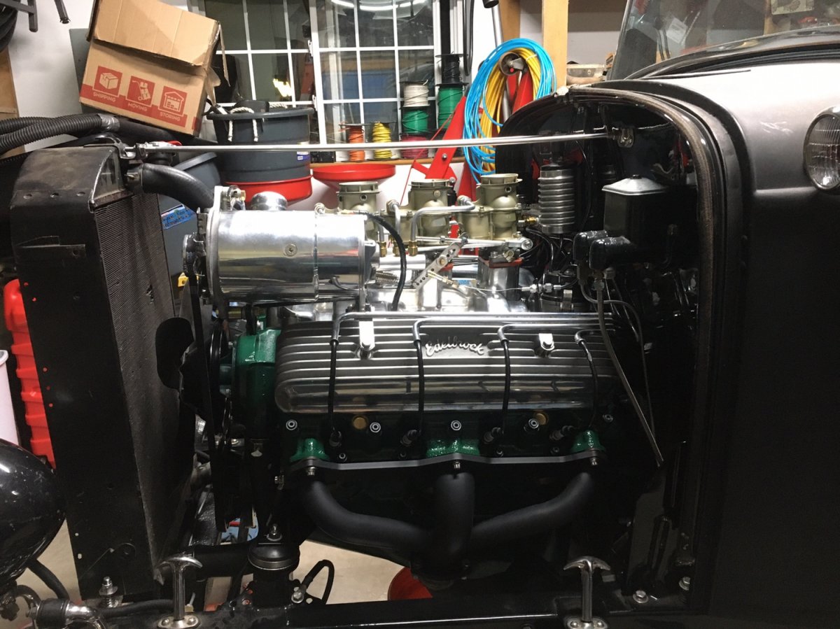

    Gave it hell until midnight Wednesday after work to get it fired up. Water pump is leaking from weep hole (probably from sitting for 2years & carbs not working so great. No oil leaks & good oil pressure though. Picked up 3 carb kits yesterday & ordered a reman water pump.

    Looks like you are running progressive.? Any air getting by the throttle plates in the secondaries at idle? They can be trying at times to get closed. ****ster sells the GM dope that was used on the tri powers back in the day. I used it on my 348 and it worked quite well fwiw.
    Looking good. Like those wire looms.

    Yeah, I’m running progressive linkage on 3 ford 94 carbs. The secondary carbs have no power valves or idle circuits & the ****erflies have been made to seal ***e with DAG or equivalent. I had them running great on my 303, only ran ethanol free fuel through them & drained before storing. These old carbs are definitely stressing me out.....

    Went through the carbs. They didn’t need it. I found a few rockers hitting the valve covers; thicker gaskets resolved that problem. Finished breaking in the camshaft & got a test drive in only running center carb. All went great.
    Going to redo my fuel lines & hook up secondaries.

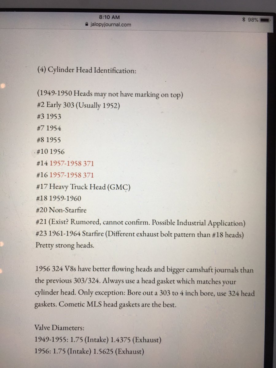

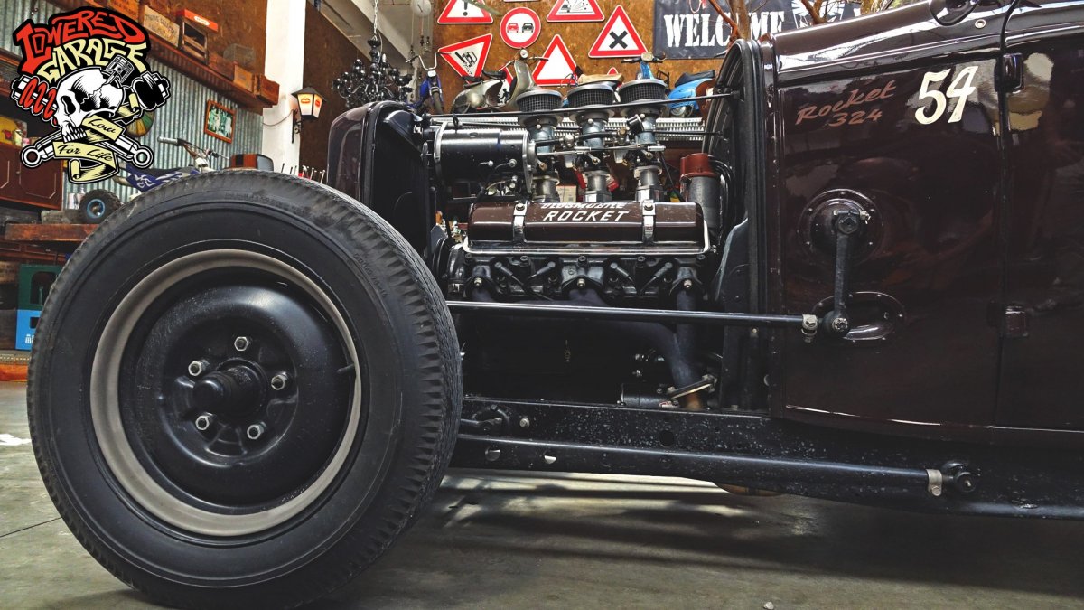

    Hi again.. I would like to understand the differens between the heads. I got nr 6 on my 324. 1954 62131708_2352821011464168_8885405312350158848_o.jpg

    ‘56 #10 heads have larger intake ports & are supposed to flow better than the earlier ones. IMG_1351.JPG

    Okej. I understand. most a matter of year than..
