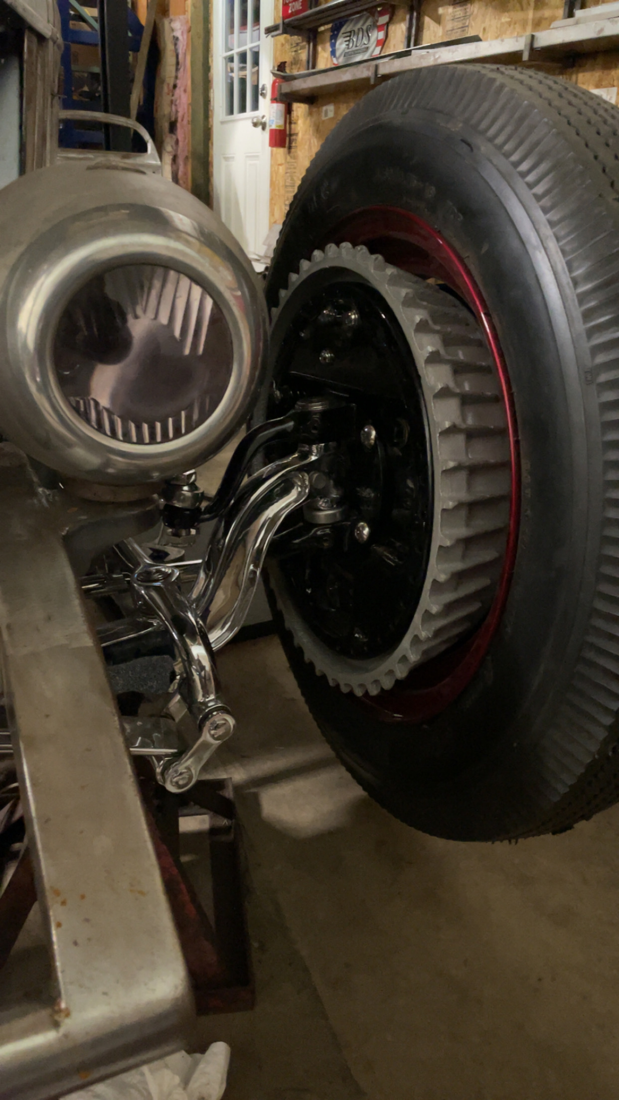

    What a beautiful job!! I’m wondering if you have figured out some sealed beams for the E&J’s.
    Kelly Burns likes this.
  2. I made new reflectors cups out of a thin sheet of stainless steel and positioned them at the halfway mark where the amber lens use to sit. I fully polished them, drilled a hole in the middle and added a halogen clip in style conversion.

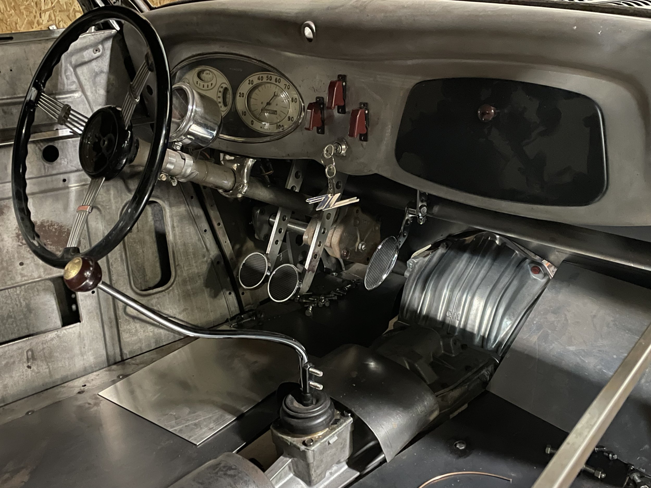

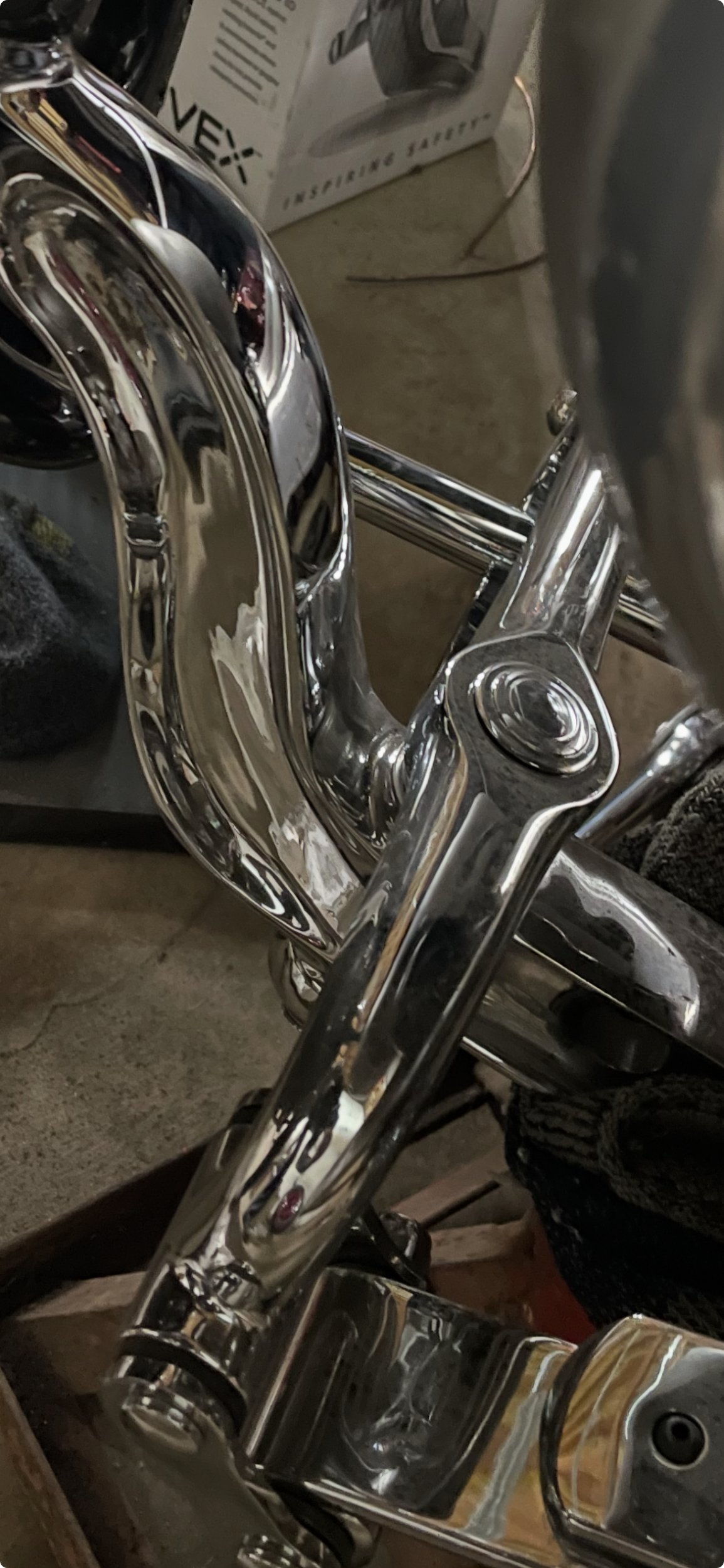

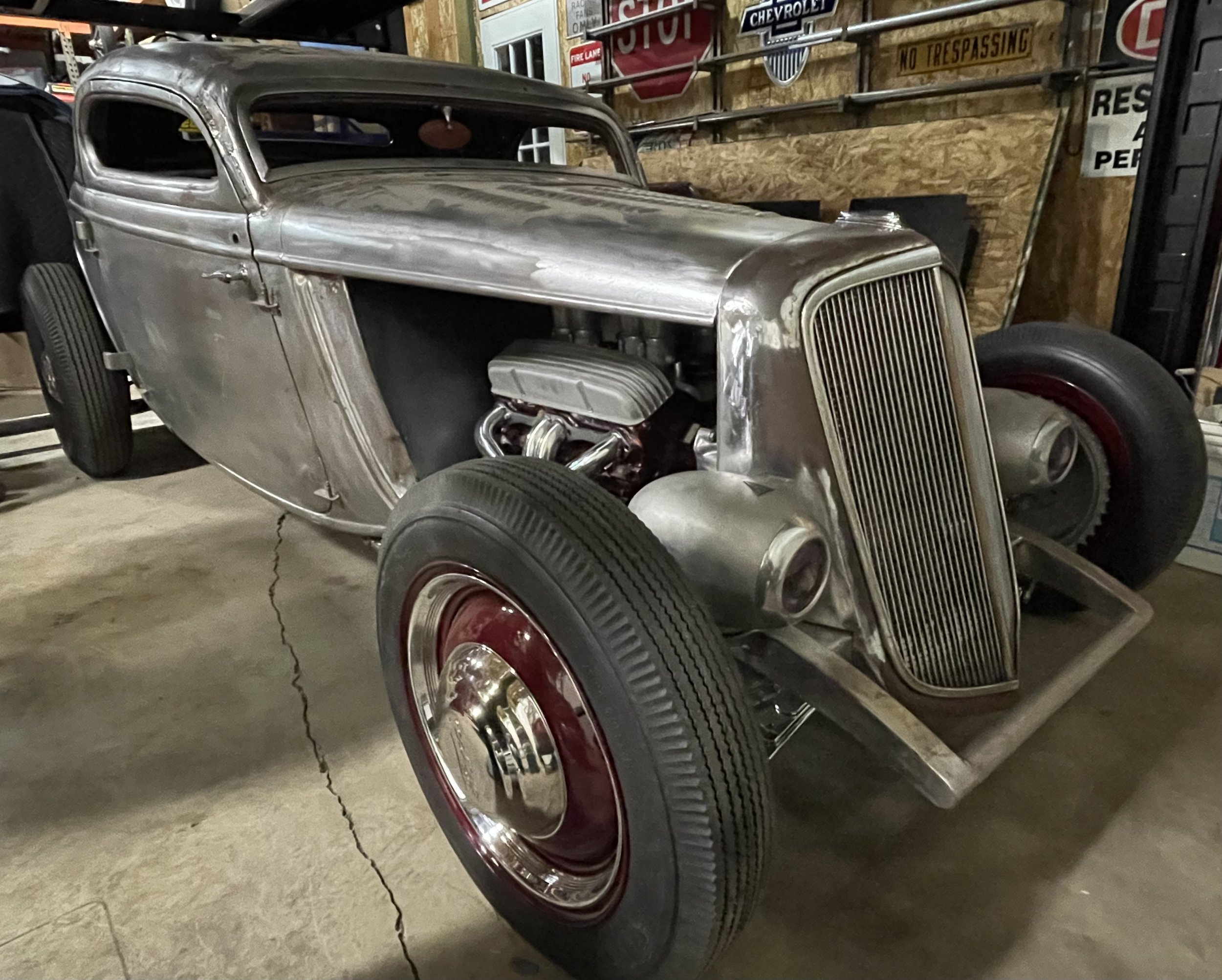

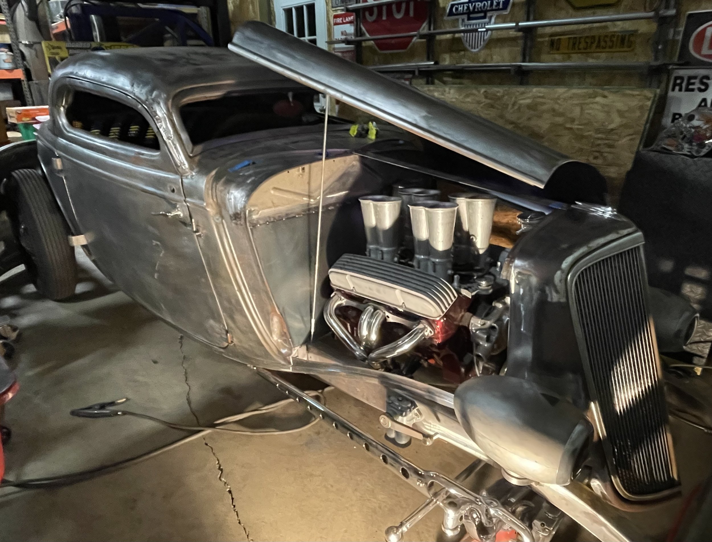

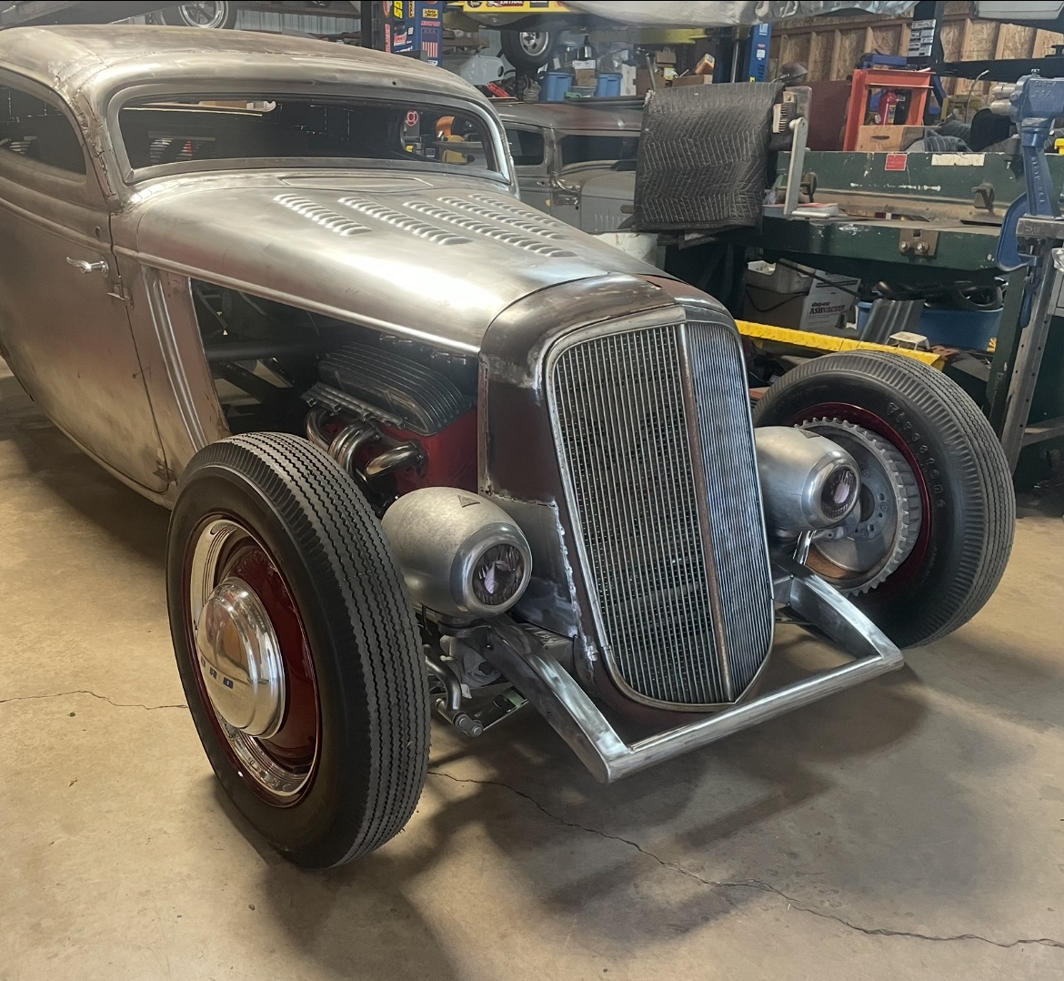

  3. A few progress pics of the Withers Special coming along. A lot of one off custom touches happening on this car. IMG_2673.jpeg IMG_2685.jpeg IMG_2330.jpeg IMG_2204.jpeg IMG_2157.jpeg
