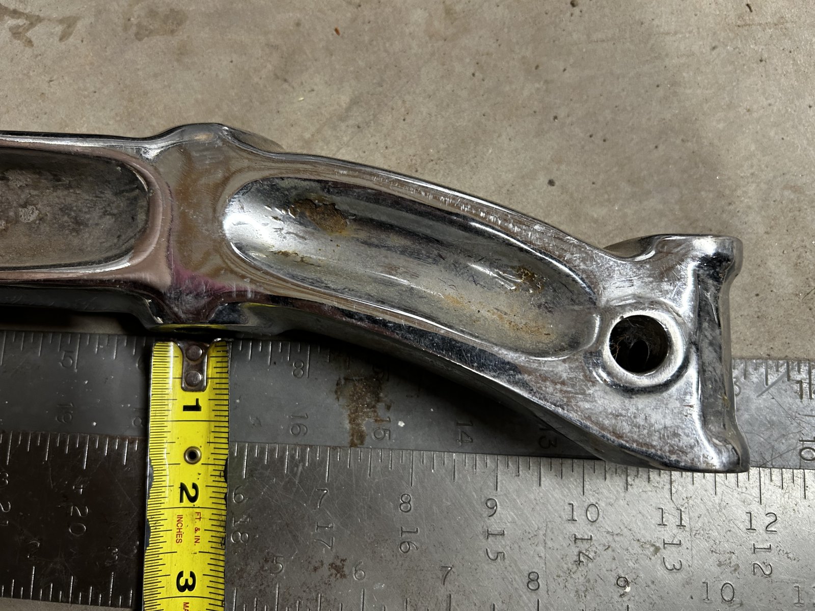

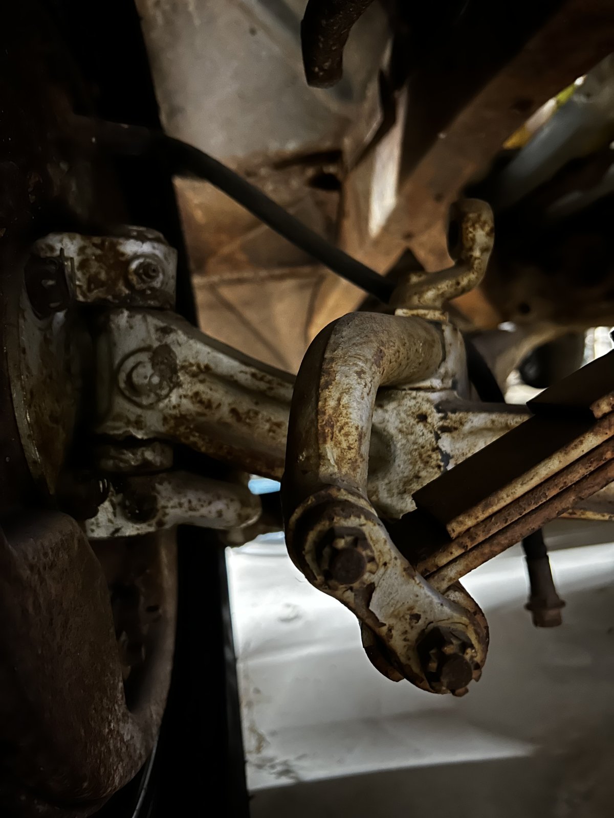

  7. guthriesmith
    Joined: Aug 17, 2006
    Posts: 11,909
    guthriesmith
    Best I can tell, it is only about 1-1/4” drop from perch boss to king pin boss on this stock axle which at least appears consistent with the one in my 40 Merc as well.
