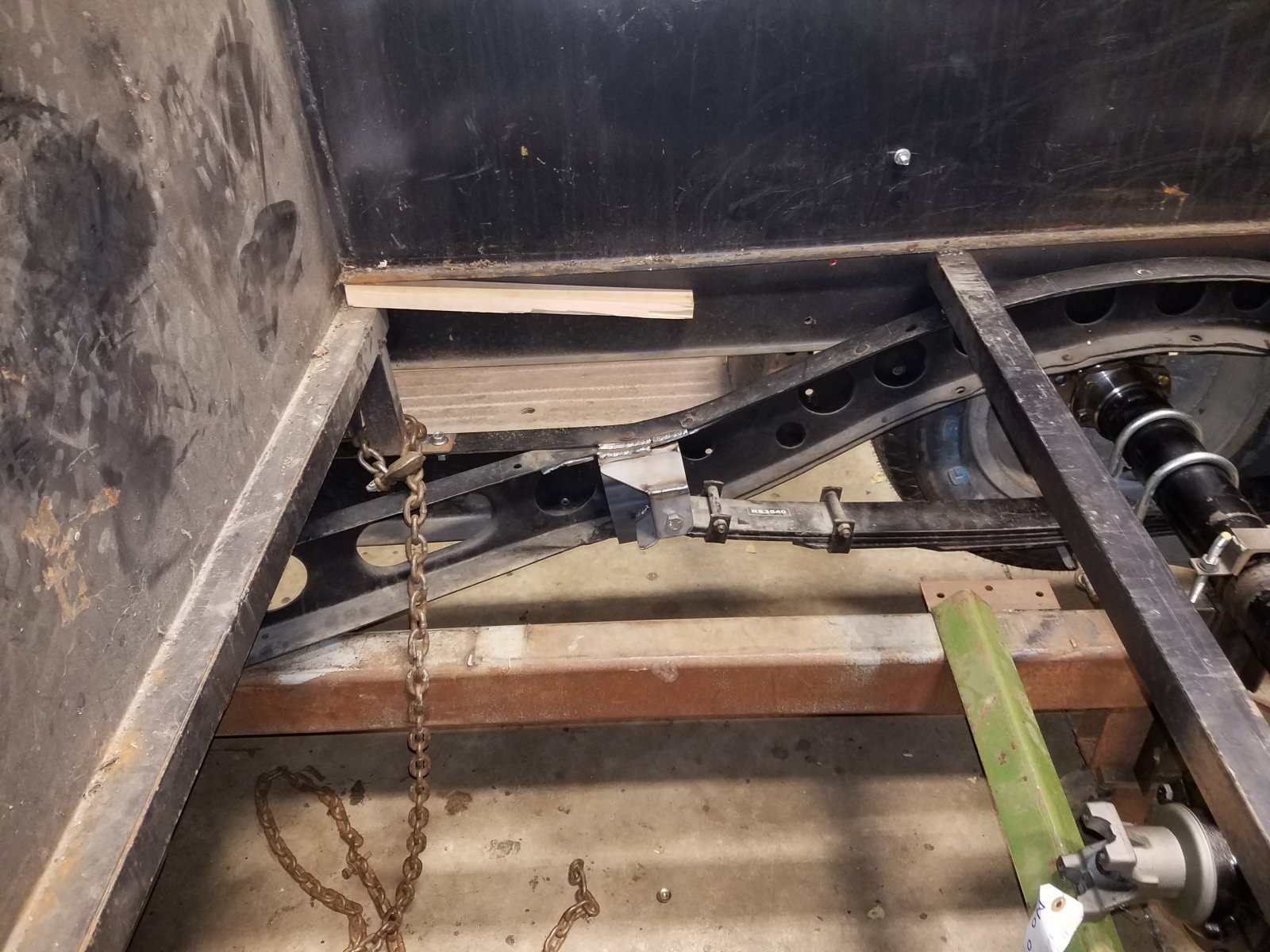

  7. We travel the same highway in life. My latest fix-er-upper is a 40 bought just last year. Mine has the stock rear spring also but was done with a P&J kit. I like it and it's staying. What I did do on mine is cut out the M-2 and replace it with a Dropped I-Beam and stock steering box as it should be. I have done several rear dual spring kits for Customers (these photos are of B-B's Hemi Powered truck) and found all of them needing lowering blocks to get rid of the Mile High rear stance. I detest lowering blocks! I don't follow the install instructions to avoid the Block issue. Being your already in Fab Mode here's a couple photos of how I do it. Works very well and ends Spring Wrap when you hammer it.
    I seem to have misplaced the photo of the rear shackle receiver going through the Frame Rail instead of under it. You can see how it goes in the top photo. I can probably find it if I search harder in my files. Yes there's room for the Gas Tank without any issues.

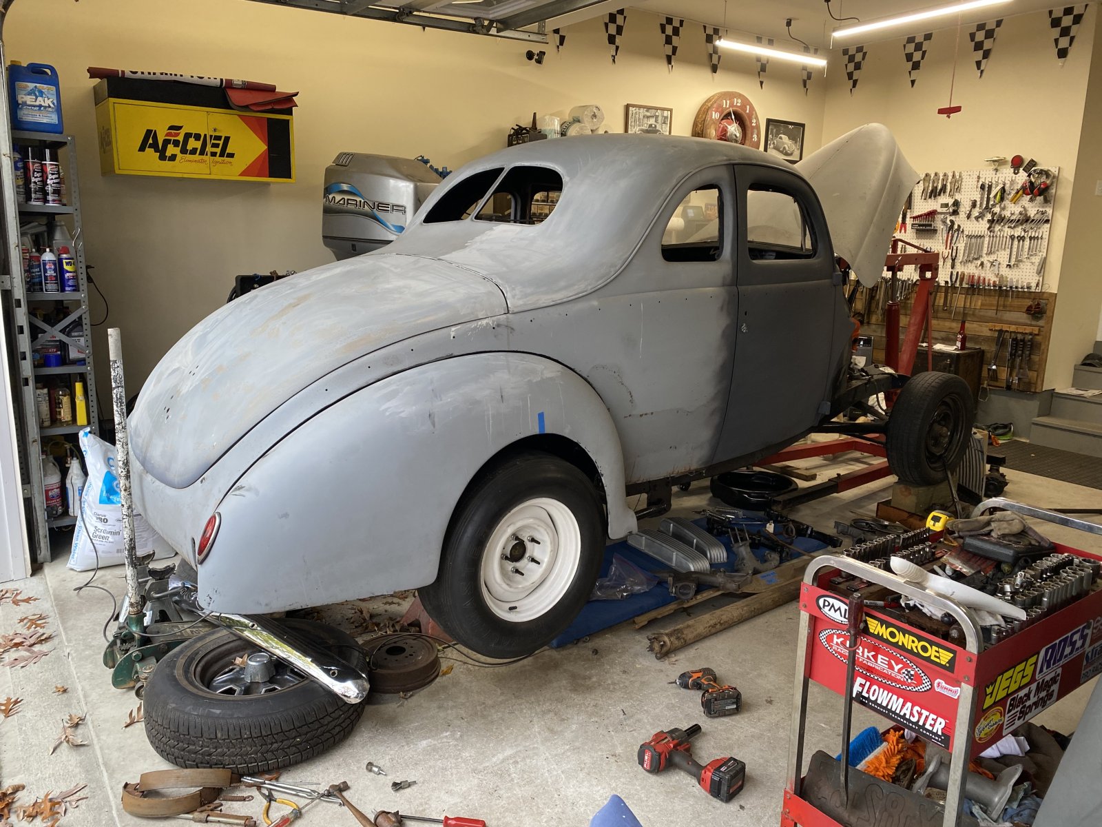

    Just finished installing the mounts for the parallel leaf springs. So yes I’ll keep going with the rear, I have to remove all the extra stuff that was booger welded to the axle tubes first. IMG_5495.jpeg

    Ok it took me quite a while using my plasma cutter, cut-off wheel, sawzall etc. but I finally got all that stuff off the rear. I still have some more grinding and flap disc work to do and hopefully the rear will still be true. Then I can get it up on the leaf springs and figure out the location of the spring perches. I left the shock mounts on the rear for now hoping that I can use them with the new setup. IMG_5527.jpeg

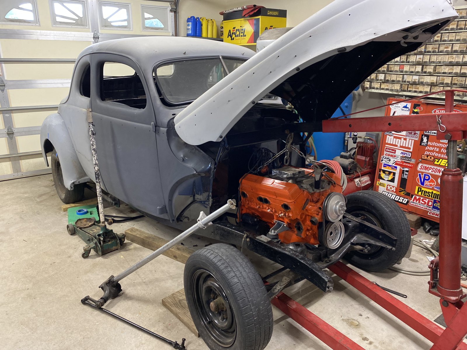

    I have the ‘55-56 Chevy rear installed. I have not yet welded in the spring perch’s because I’m trying to make sure the rear will be centered as close as possible to the center of the wheel opening. The posies kit gave me 2 options for the spring perch, the picture I’ve posted is with the perch in the most rearward position, but I think I’ll move it forward because the springs are currently hanging and once the car is on the ground it’ll obviously change. I put some 15” chrome steelies on it but I’m not real happy with how it looks. (Note: not I’m not gonna run with radials) The wheels are 7” wide and I was hoping they would fit within the fenders but it doesn’t look like that’ll work. I’ll try to find some narrower wheels. IMG_5558.jpeg
