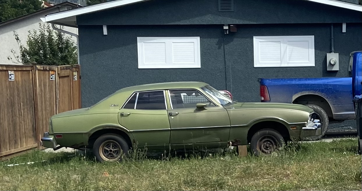

  27. OilSoakedLawn
    Joined: Jul 9, 2022
    Posts: 47
    OilSoakedLawn
    A few streets away from me is this derelict Maverick. How about that……
    Johnny Gee likes this.
  28. squirrel
    Joined: Sep 23, 2004
    Posts: 60,033
    squirrel
    5 lugs...it might work
    be sure to get video of you stealing the rear end from it. I mean, let us know how much you had to pay for the car.

  29. OilSoakedLawn
    Joined: Jul 9, 2022
    Posts: 47
    OilSoakedLawn
    Will do, my daily is a 1973 J10 with a winch. That thing does a nice high speed extraction Pharaohs style

  30. pprather
    Joined: Jan 10, 2007
    Posts: 9,013
    pprather
    If you get the Mav rear, I'd suggest you get the drive shaft also, for future use if you do an engine/trans swap.
