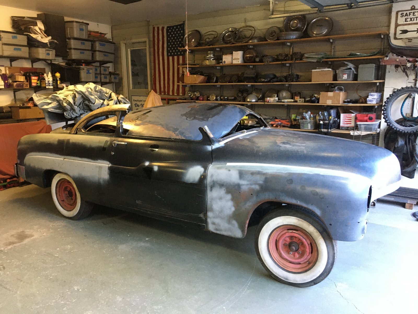

    So this one’s gonna take a little work…
    A-pillar welds didn’t do too much…
    Didn’t need a straight edge to see the B-pillars weren’t straight…
    And leaning back at that…
    Not much better on the C-pillars…
    So I guess it’s best to get to work. After a little head scratching.

    That's ugly but fixable. Establish some good reference locations, cut another inch out to even everything up, glue it back together for a truly slammed Merc.

  7. Well, at least he stopped. I don't see a big issue with taking over where it's at. For sure part off every weld and start over. When you do that about the only thing you don't have is a center line established from the beginning prior to any cuts. A bonus is you have a 49/50 back window opening to work with. It's hard to tell if there is any bracing in the inside, still not a big deal. If you weren't afraid to buy it, you probably already have a plan. Let's see what you end up with.

    Looks like a solid start. I'd start with four heavy duty casters, and build a dolly to set the car on. Take the tires off it, determine a ride height you like and fix the roof to match what you think looks right. Buying another roof isn't out of the question.

    They did not weld good or even lots. Too cold of a weld. Did not stagger cuts on pillars. Did not brace. Oh so many mistakes.

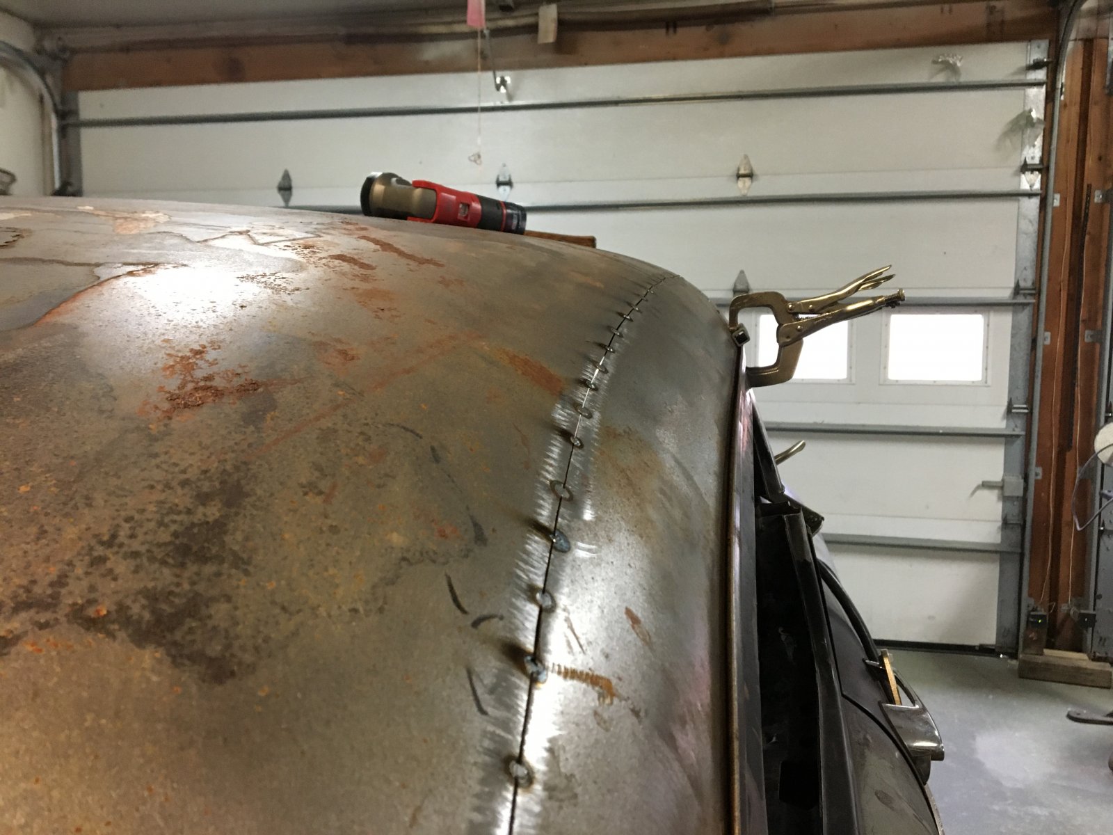

    First up getting the roof back up and somewhat where it's suppose to be. The rear quarter window pieces were hanging up. So I gave them a quick jiggle to break the tack welds and got them out of the way. Made some adjustable rods so I could move the roof up/down while getting it all in place...
    Then got to work putting them back in. Took a bit of fitting and t******* to get it all lined up...
    Starting with the most crucial piece, the drip rail...
    Then getting the roof section fit and tacked in...
