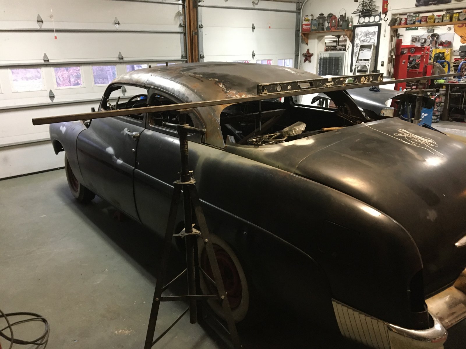

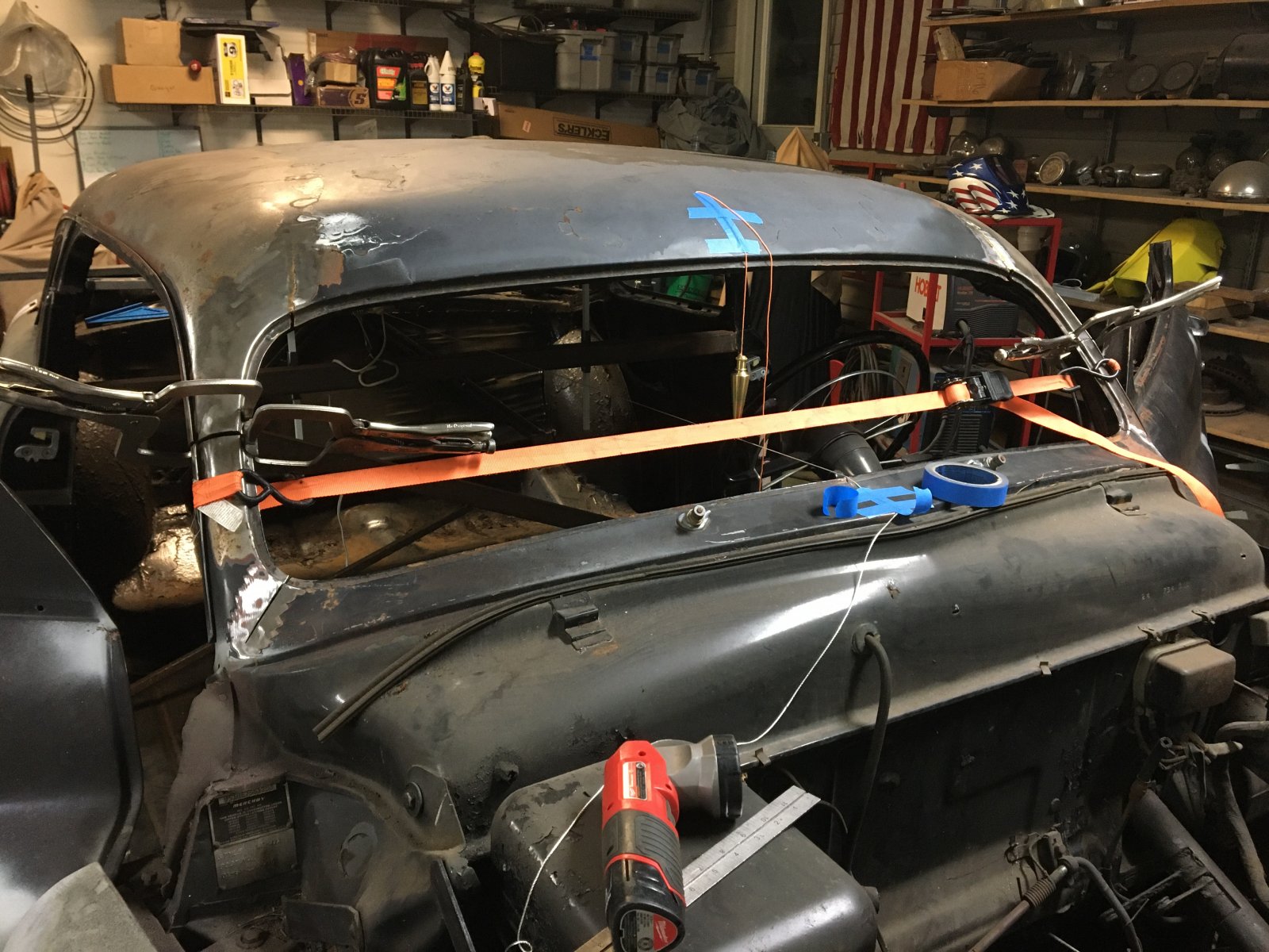

    Alrighty. Now where’d we leave off?
    Not knowing what was where and how it got there. I got the car leveled up…
    So I could run a string line and make sure everything was centered up…

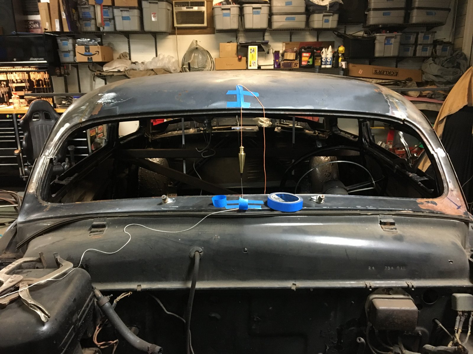

    Needed some work to get the post lined up once the roof was centered…
    Got it all lined up…

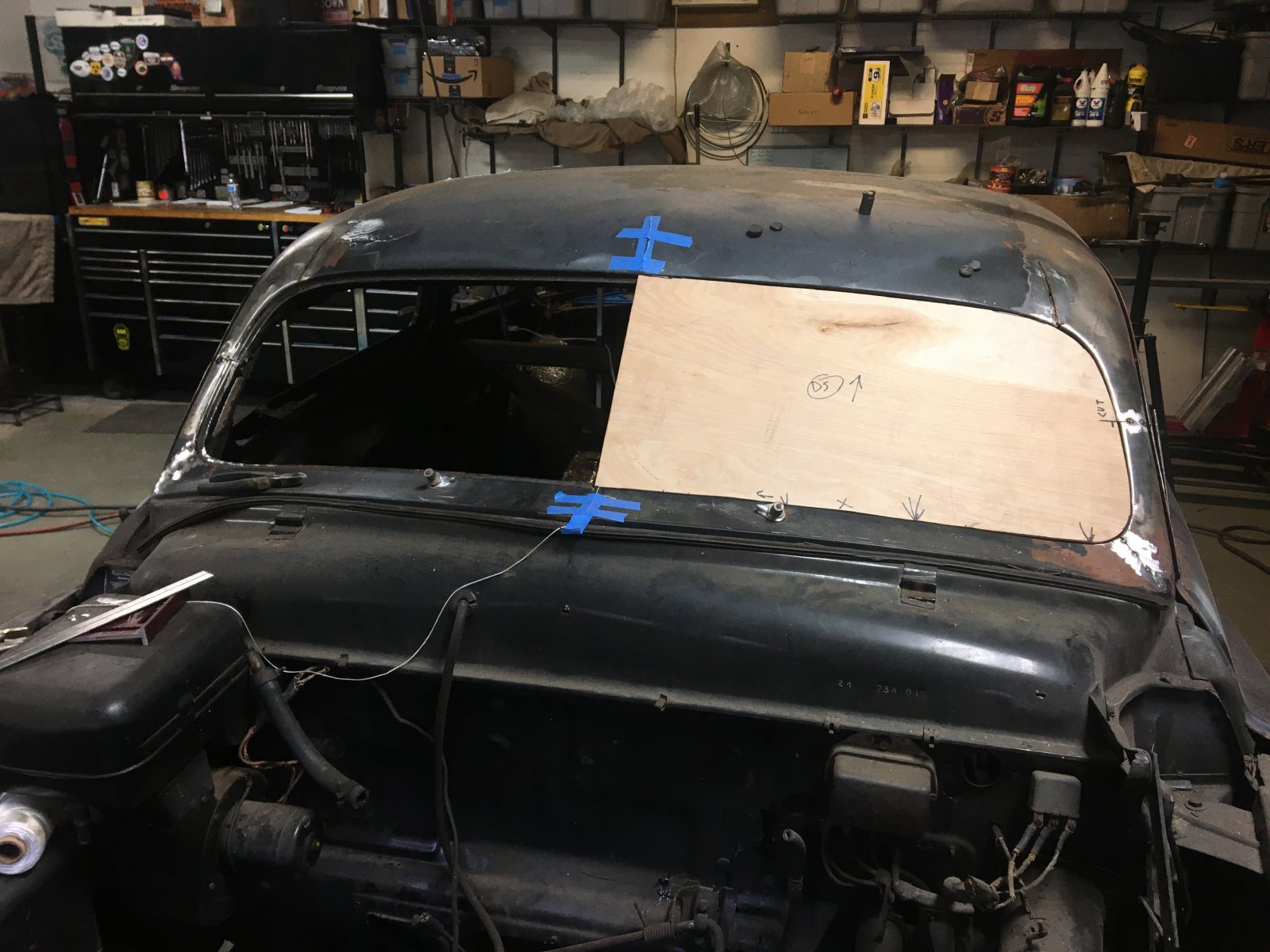

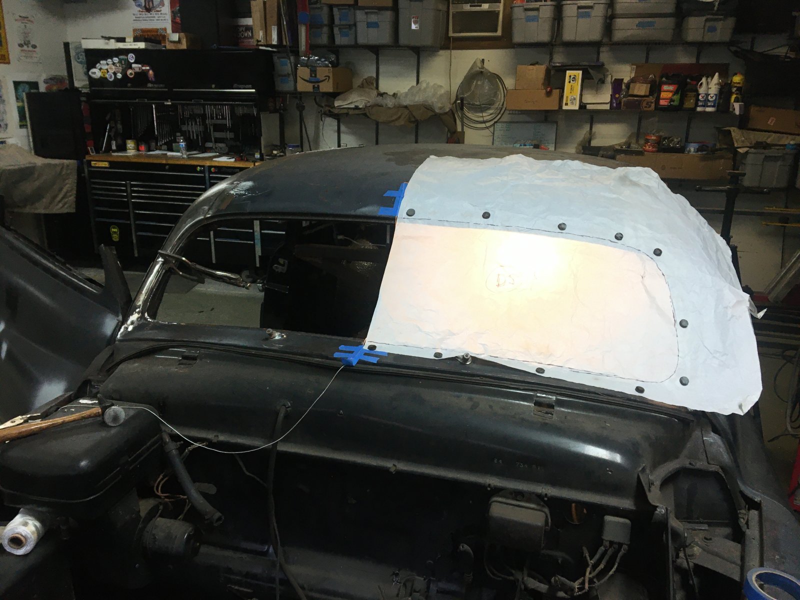

    Since I didn’t do the initial layout and cutting. I wanted to make sure that everything was the same side to side. So I made a paper template. And then transferred that to wood.
    With the wood template I can just flip it over to the other side of the opening and make sure they’re the same. And once they are the same side to side. They’re ready to tack in place…

    Solid update. The windshield gl*** template to check side to side is a great idea that I'm not sure I've seen before.

  14. Did it once on a 32. Made the WS template out of MDF. It was sturdy enough to hold the roof pieces in place. Template was made from an unchopped windshield frame but shorter. It was used during a brookville body ***embly and during construction chop. Centered the pattern with the body centerline (laser) this helped align both un-welded a-posts.

    That windshield opening template shot is one I am saving for the info file. With the Here is how Clutch dumpin Dan did it.

    Worth doing in my opinion. I like to double check everything is the same side to side when chopping a “round” car. And once the chop metal work is done the template gets trimmed down to use as a gl*** template.

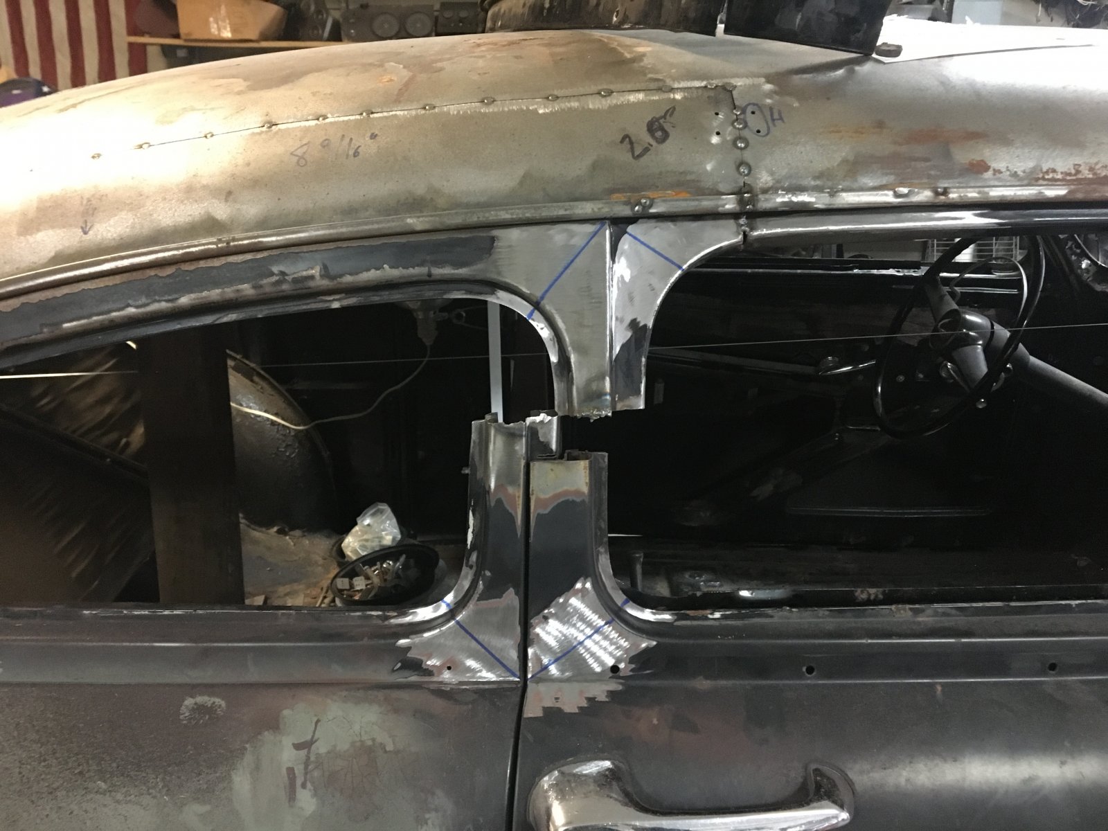

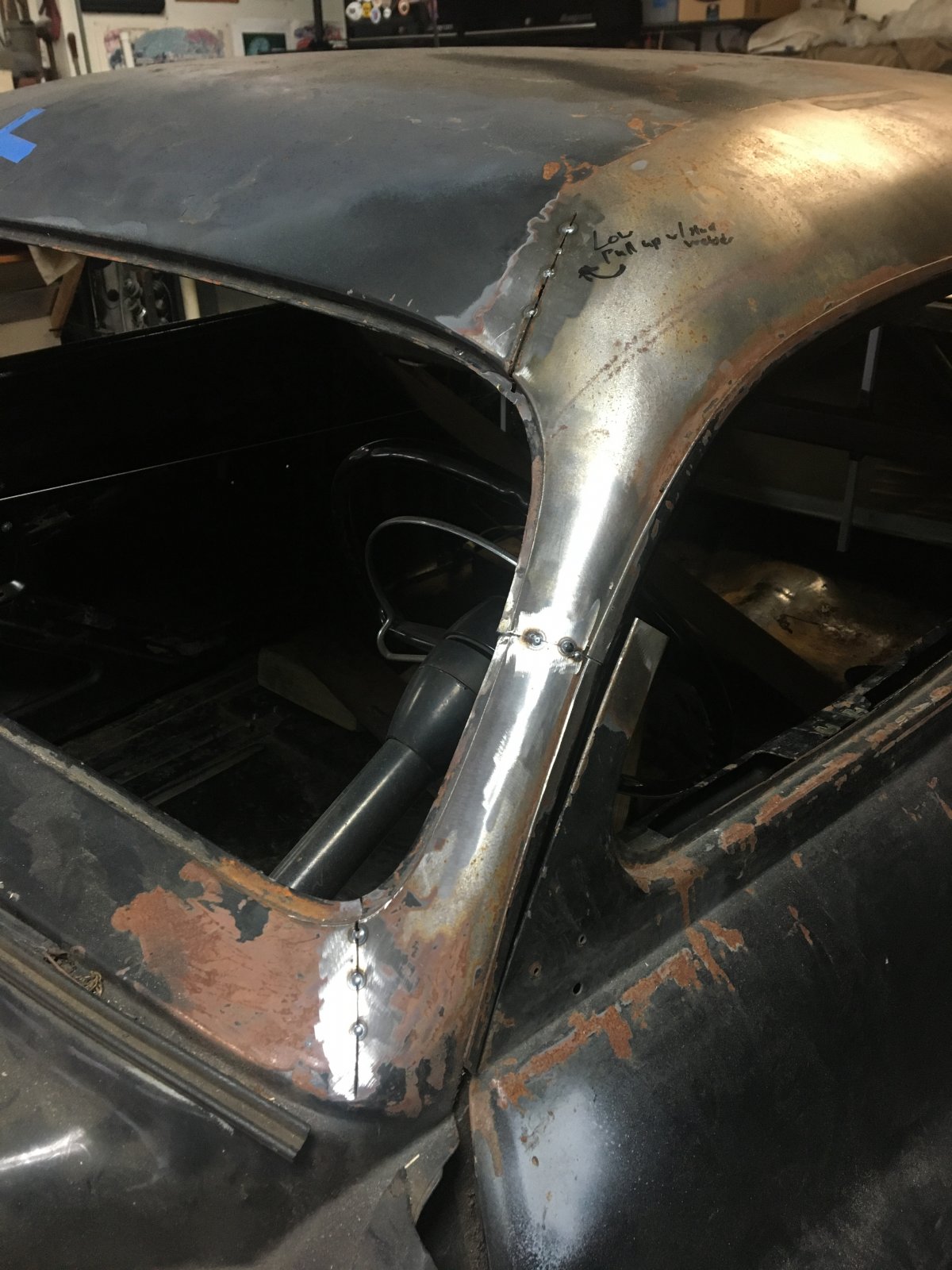

    So with the roof all centered up and tacked in place up front. I got the c-pillars trimmed and tacked in place. I made a wood template for the rear window openings like I did for the windshield. I’m glad I did as they were rather different. Some t******* off the c-pillar got them lined back up and even.

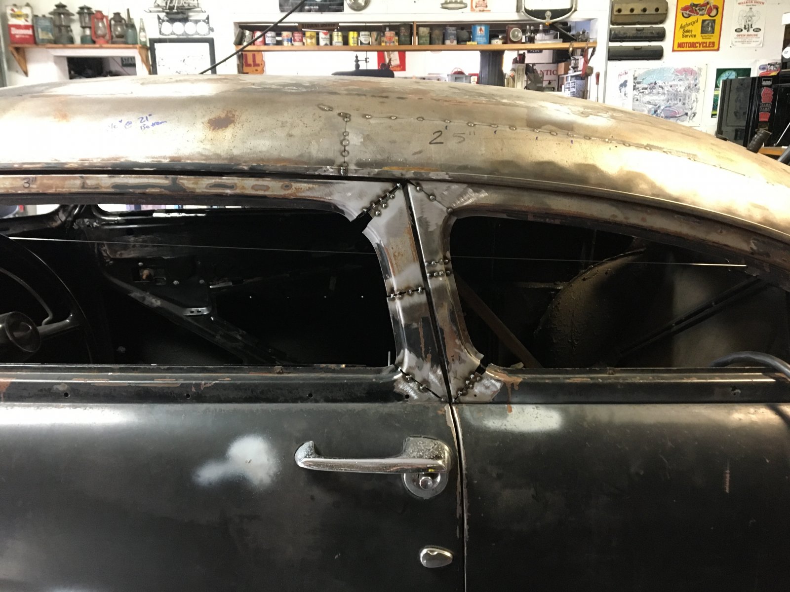

    With the roof in place and tacked in good. There was still some thinking about rear window openings and position going on. So I opted to keep things moving forward and went to work on the b-pillars…
    Got the doors fitted up decent. Then got the pillars slanted forward and tacked in place…
    And the same on the drivers side. I’ll come back and do the corner radiuses later…
