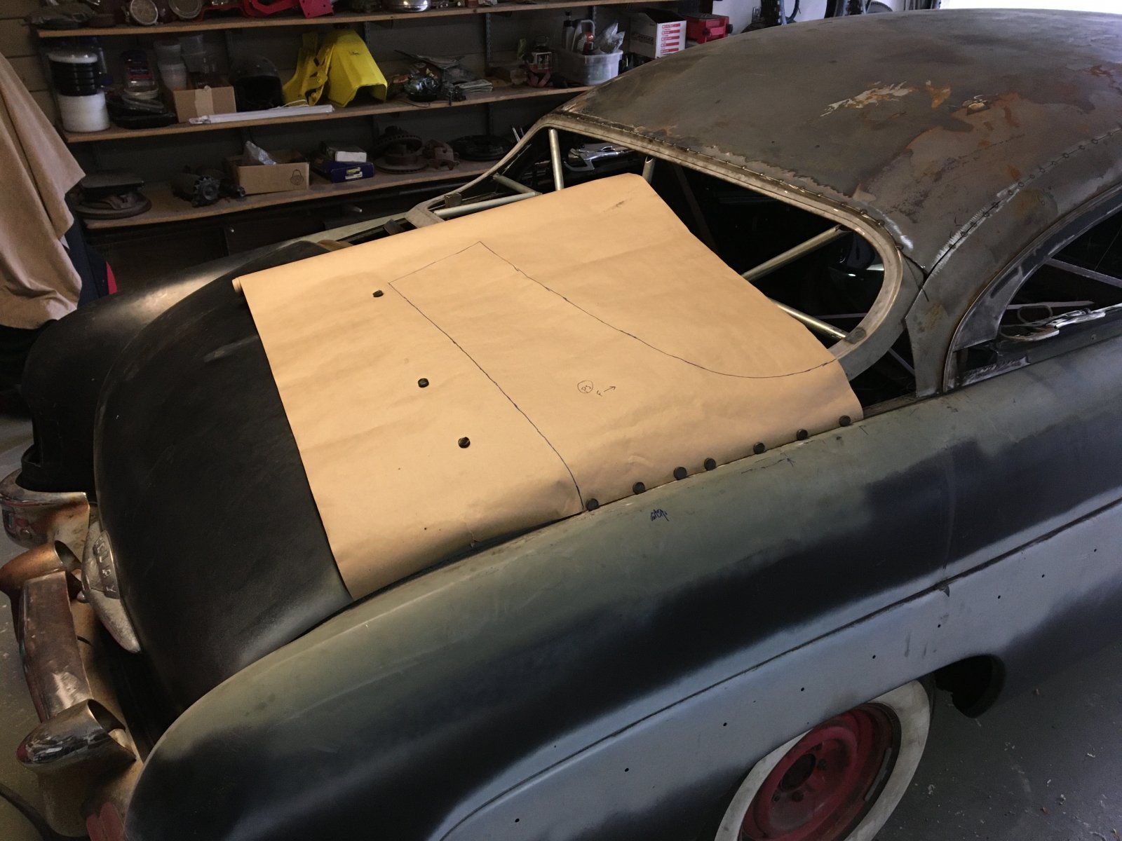

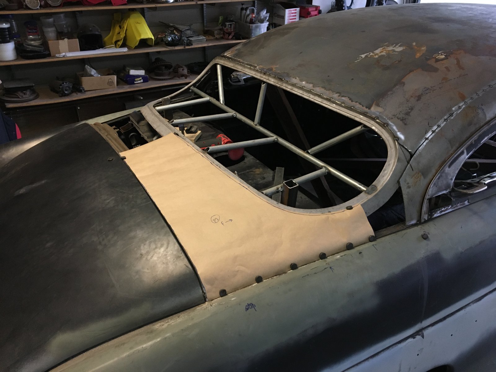

    So with the roof in place and tacked on. Time for the hardest part. Getting the rear window where it belongs o_O
    The car came to me with a ‘49-‘50 window frame and was the plan for the original chop. So that’s what I’ll be using. I like them a little more than chopped ‘51’s as well.
    First up was getting in centered and leveled and all that good stuff. Gave me a fight as I usually just go off the package tray. But upon tacking it in and stepping back to give it the eye ball inspection. It was way low on the p***enger side. Turns out the package tray is in the car pretty crooked and out of whack.
    Ah well, get fancy and do it from the top side…
    With it tacked in place…in the right place this time. It’s time to start on the filler panels. Always exciting getting to this point!
    I like to make a paper template and then flip it to the other side and compare. Sure it’s paper and will vary some. But it’ll still show if something is really screwed up and got over looked in the other steps.

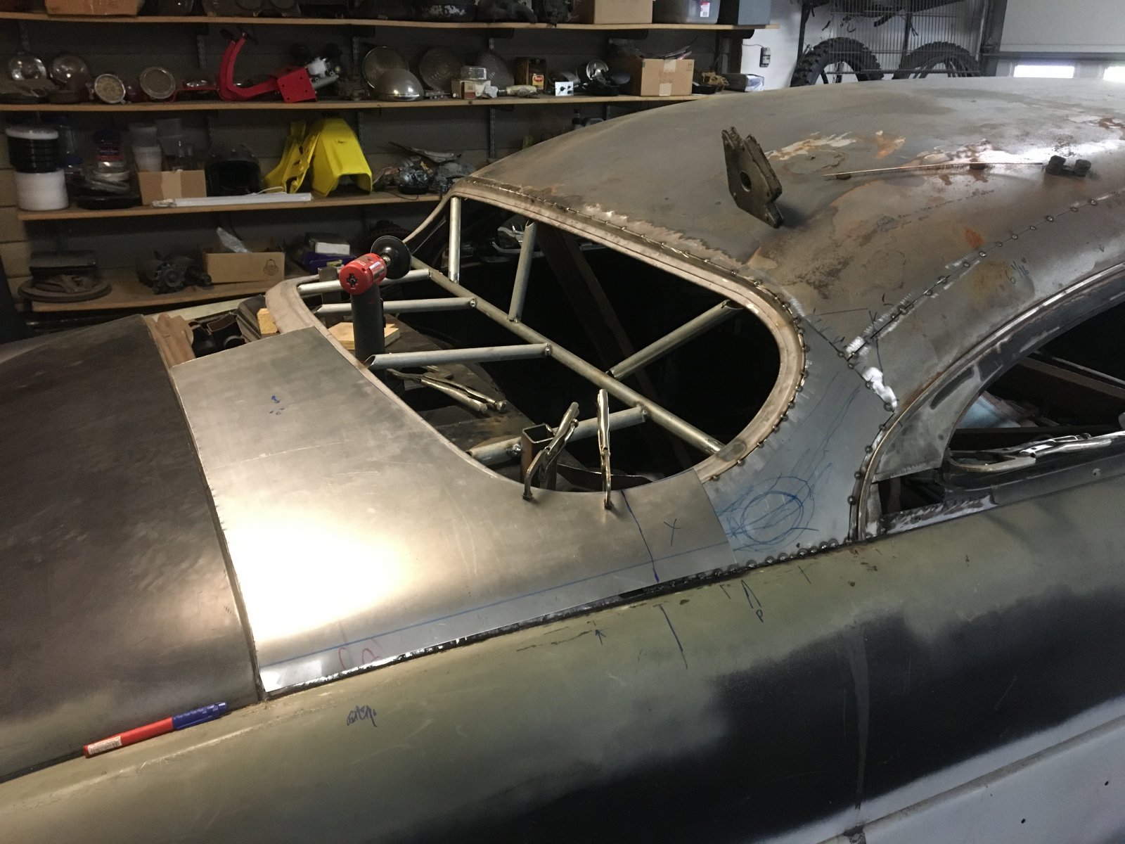

    Luckily all was well so I turned it into metal…
    After roughing in the lower panel I went ahead and made the upper panel and got that tacked in. Before final fit and t******* on the lower panel.
