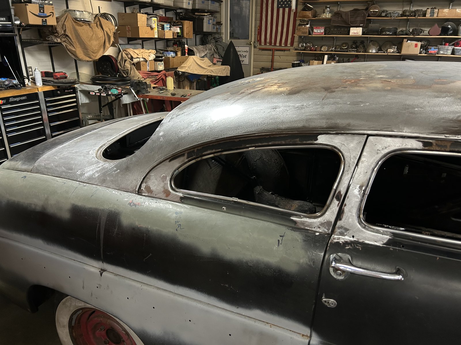

    I like what you did with the quarters. Slddnmatt did the same thing with mine, instead of the big radius on the stock window. It keeps a better balance between the door window and the quarter.

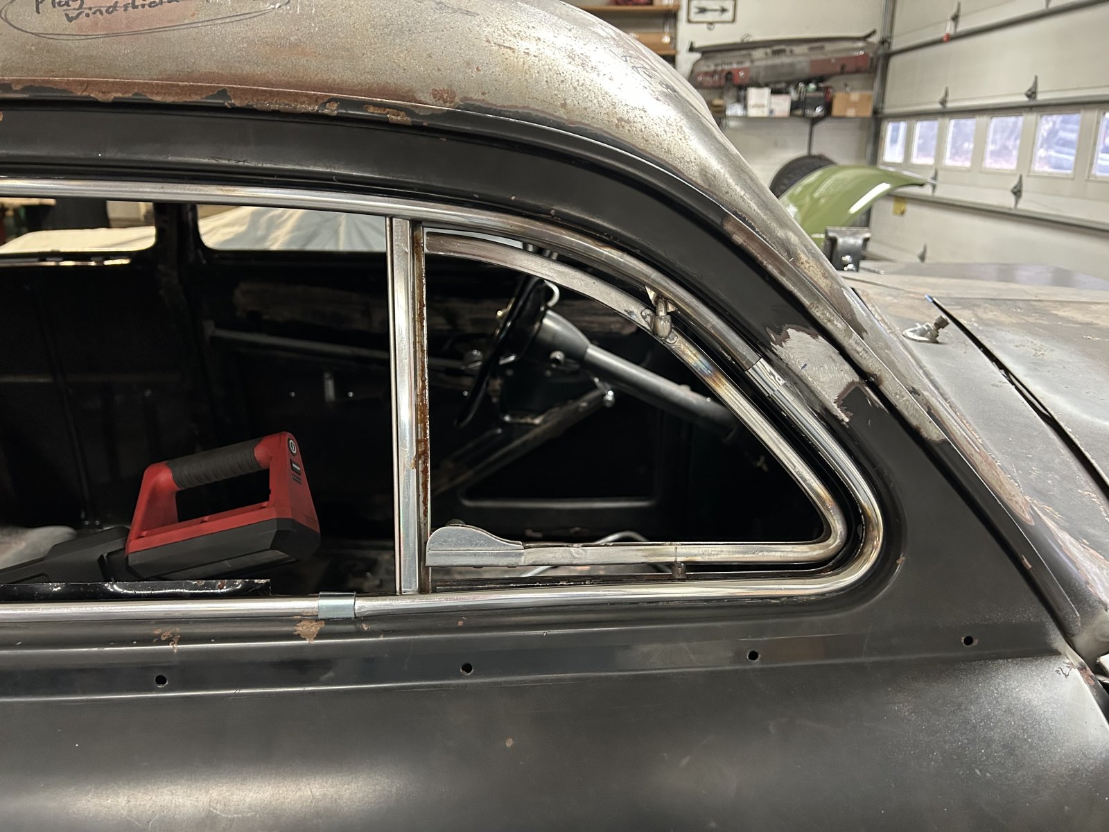

    And the window stainless and door corners are done!

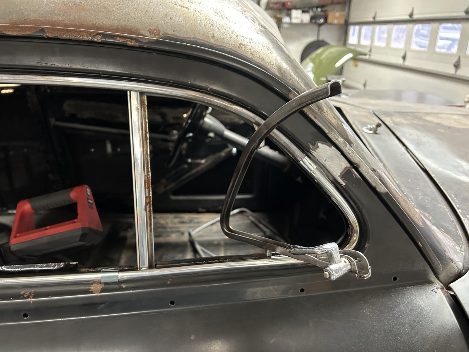

    One vent window done. One to go. Both the upper and lower pivots have been moved. And the frame shortened approx. 5/8” in length so the seals will fit in the original manner.

    ^The fiddly **** that makes a big difference.
  16. Jacksmith
    Joined: Sep 24, 2009
    Posts: 1,858
    Jacksmith
    from Aridzona
    The fact that you went to the trouble of retaining the vent windows shows cl***.

    And the p***enger side vent window is done. Time to finish up the exterior welds and do a little hammer and dolly work. Closing in on this one!

    Very kool! :cool: The vent windows look great!

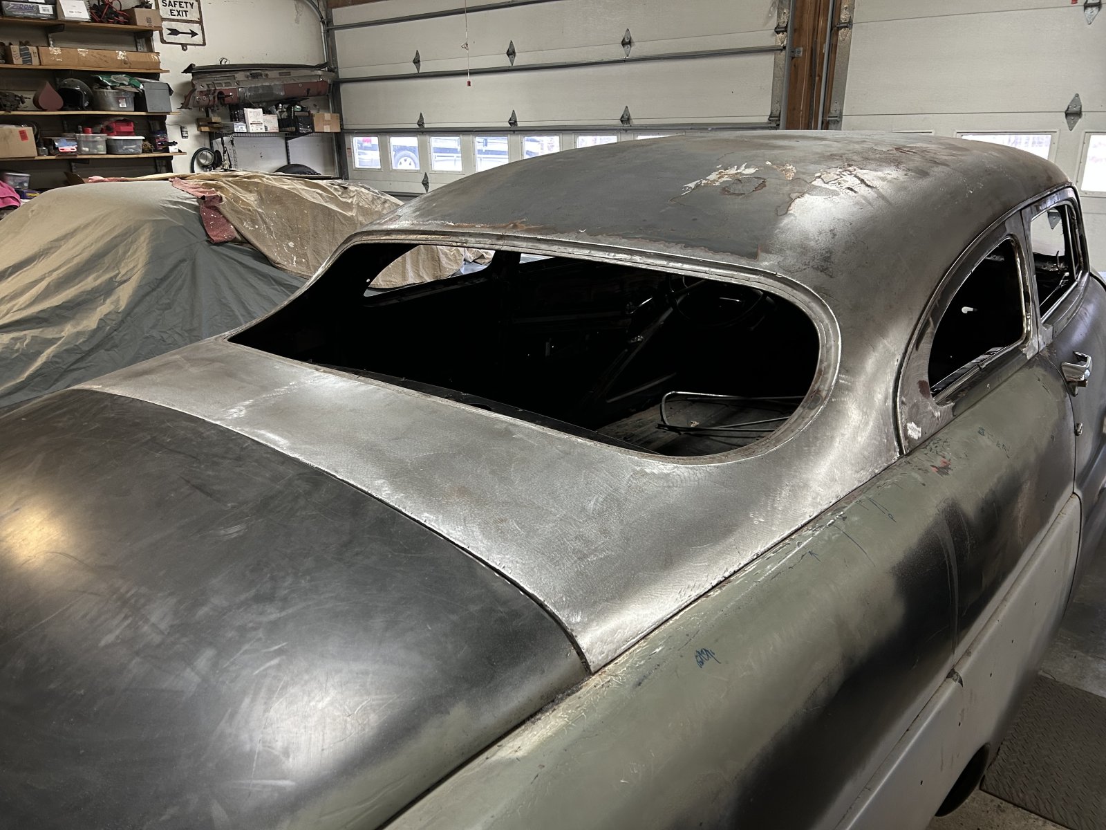

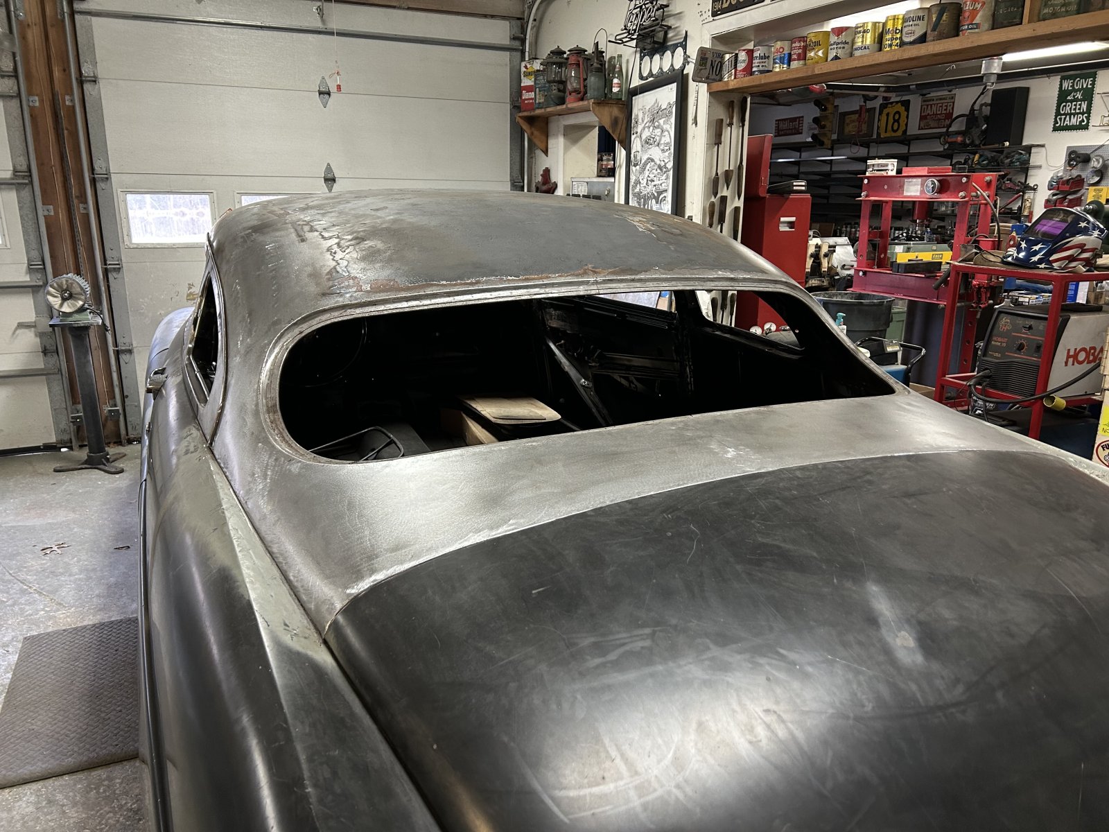

    And just like that, the exterior work is done! Pretty pleased with how this came out.
  22. guthriesmith
    Joined: Aug 17, 2006
    Posts: 12,030
    guthriesmith
    SO much better! :cool: Great save!

  24. The transition from the lower edge of the rear window frame to the trunk lid is especially nice and has very factory feel to it. Beautiful work and save.
