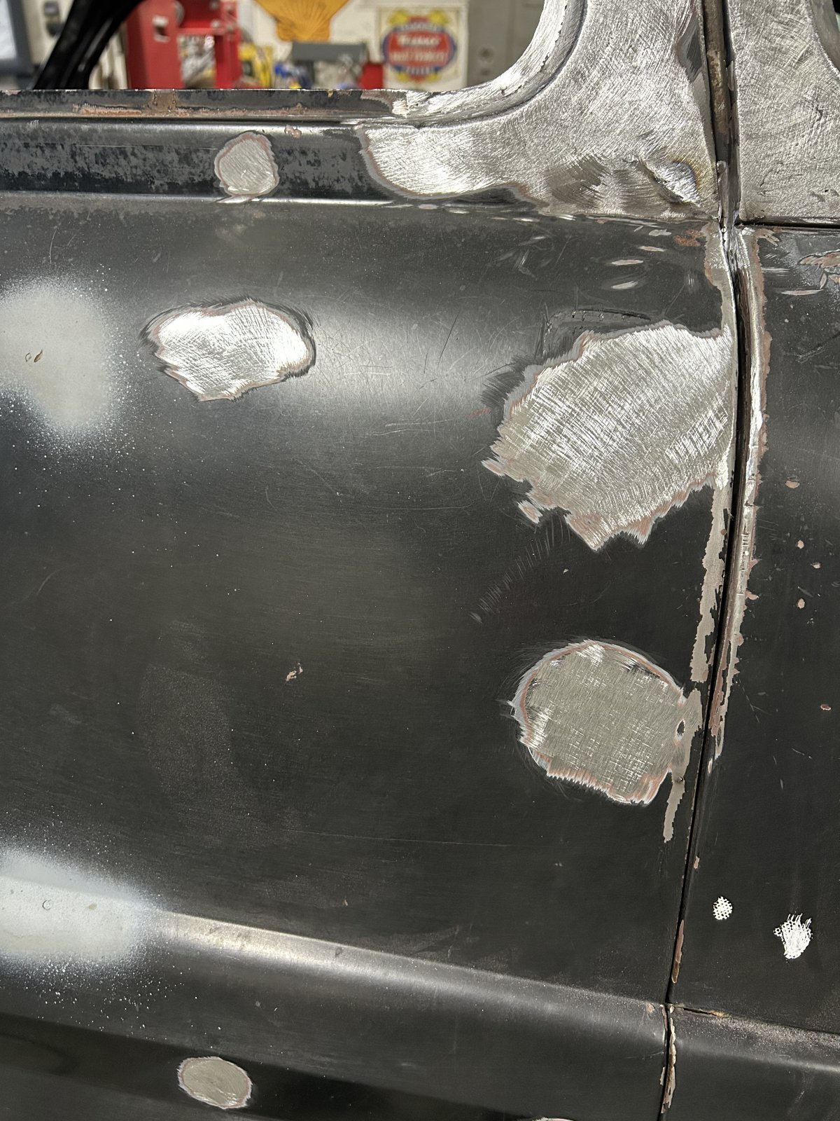

    P***enger side garnish moldings done! The upper door corner had to get reshaped for the slanted b-pillars. And the interior portion of the b-pillar had to get reshaped as well to fit the new shape of the door. Same thing for the driver side is up next.

    Driver side garnish moldings done...
    Stock vs. cut down
    Door handles shaved
    Trunk lid shaved
    Hood shaved
    All the side trim and belt line trim holes filled
    Roof was a rusted & pitted mess under the paint
    So it was media blasted all nice and clean
    A coat of epoxy primer on all the bare metal and this chop top is done!
