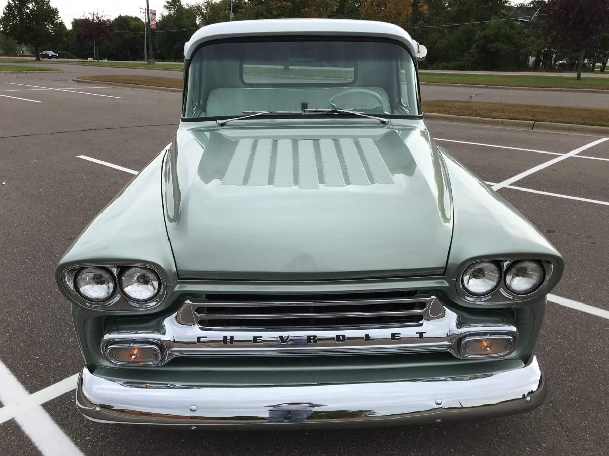

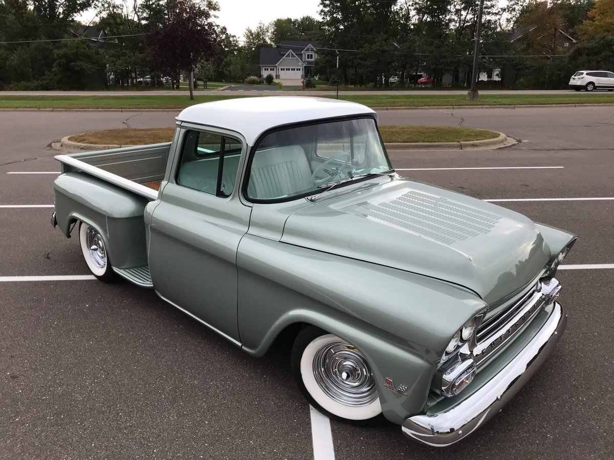

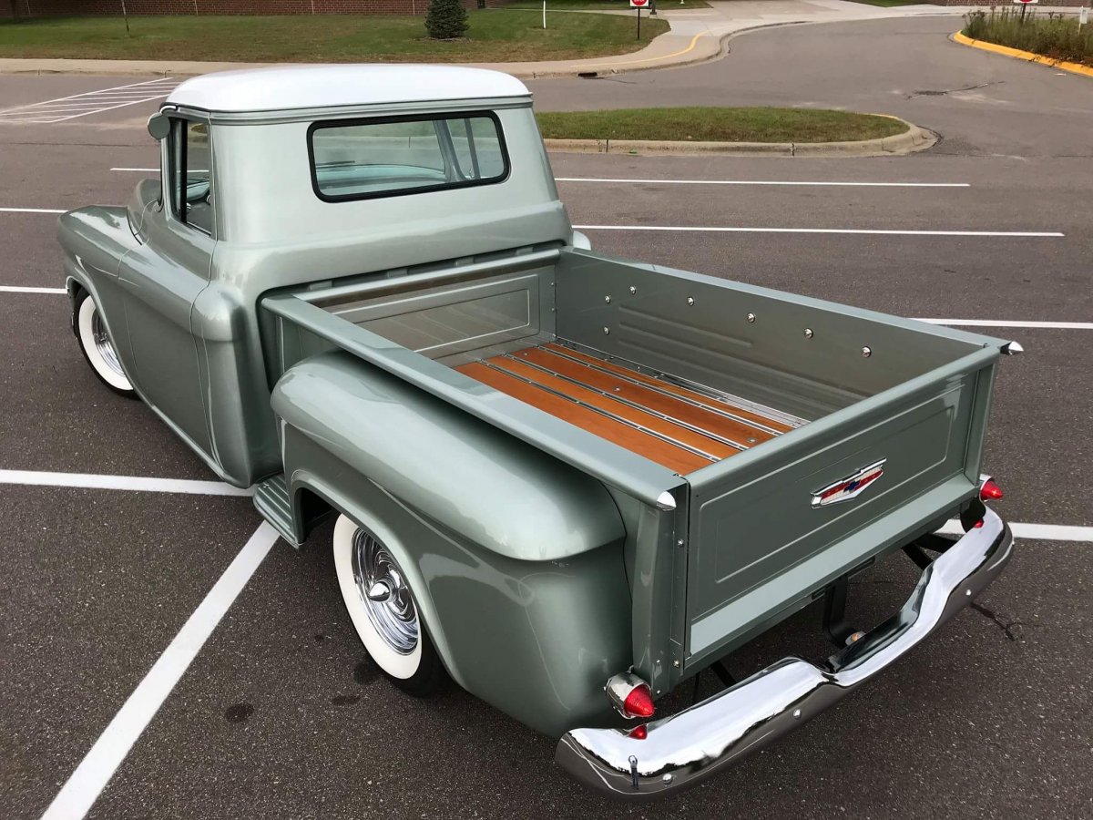

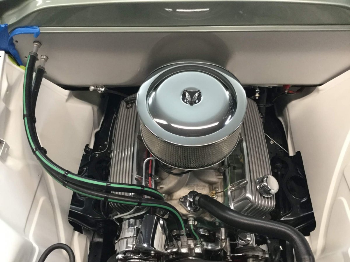

    I’ve been a member since 2010 but the bulk of my time here has been spent lurking. This past Sunday I took my most recent build on it’s maiden voyage, there’s still a few minor details to wrap up but it’s close enough to share with the HAMB.
    My vision of what a Sport Truck might look like if Chevrolet built one in 1958. It’s probably best described as a mild custom.
    The lowered stance comes from a ‘75 Nova front sub and an axle flip out back. The power train consists of a ‘74 454, TH400 and a Mopar 8.75 “Sure Grip” with 3.55 gears.
    The sheet metal is basically stock with shaved door handles, mirrors, emblems and cowl. The firewall and dash were also shaved. The paint is a ‘63 Chevrolet color called Laurel Green with Lexus pearl white on the roof.

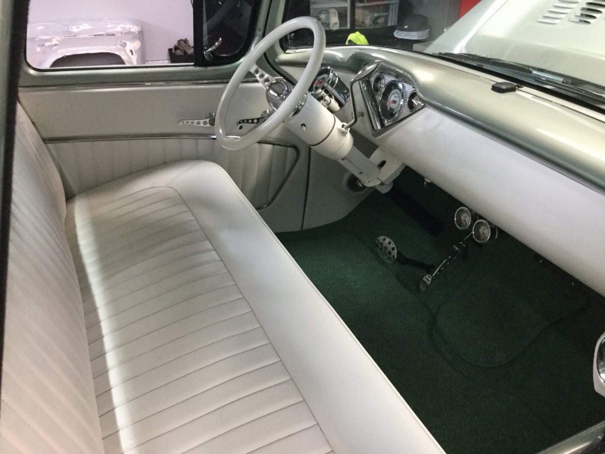

    The interior is fully custom. Other than the seat, everything was done at home in my garage.
    There’s far too many details to mention but feel free to ask if you have any questions.
    Enjoy...

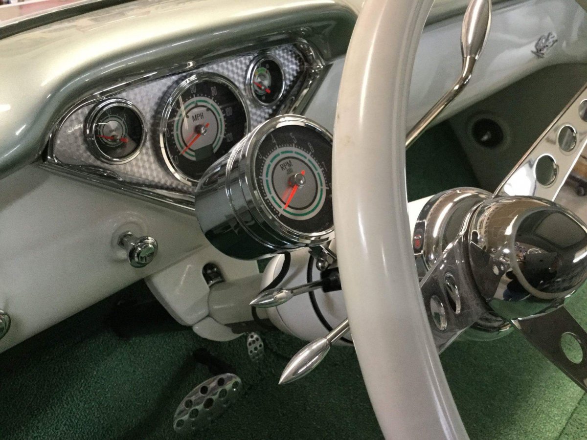

    By the way, I had one of those S/W tachs in the mid 70's that I bought used and could never get it to work, they were/are like a piece of art, just beautiful.
    I shed a tear the day I threw it in the garbage, wish I had saved it just to look at.
    Black_Sheep likes this.

    The tach is a modern piece made by Speedhut with custom artwork to match the retro SW Greenline gauges. Even with the added fee for custom artwork on the tach's face it was about half the price of the SW

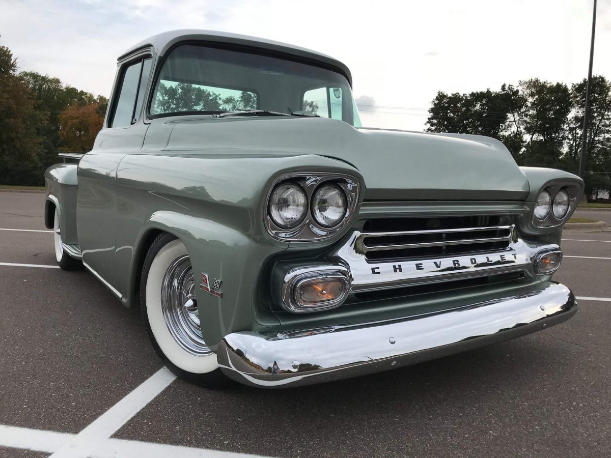

    Posts: 40,349
    What a beauty, also coming from a Ford fan. :)
    The "Big Block" call out flags on the front fenders are a nice touch.

    Black_Sheep
    They are stock ‘58 housings with 60-61 Chevy p***enger car lenses, modified to fit

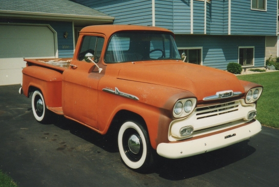

    ...that's the nicest 58 I've ever seen,...perfect, good job....(here's it's ugly cousin...gotta get back to work on it)
