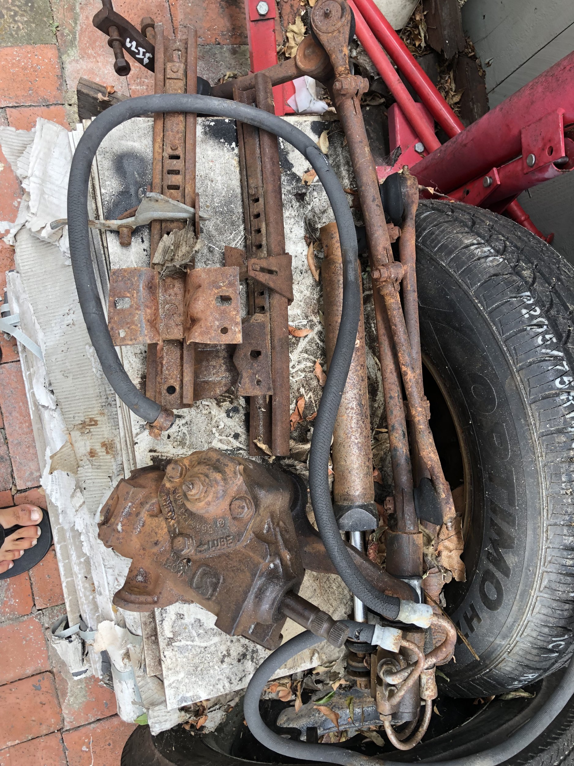

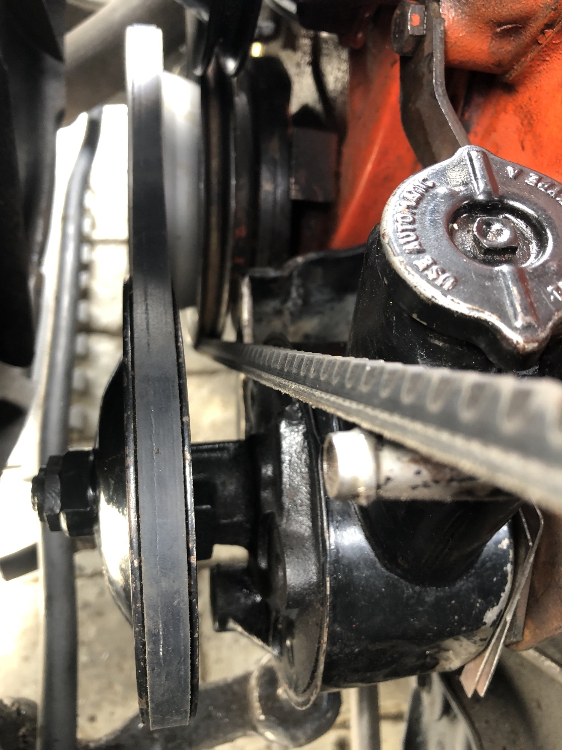

    IMG_8328.jpeg IMG_8328.jpeg IMG_8328.jpeg IMG_8329.jpeg I got an oem factory PS from a ‘60 impala that I’m modifying to fit the 63. Pump had to be shimmed to align the belt. As you can see the top hose fitting is too close to the alternator belt. I was thinking about using a MAPP torch and a metal rod to move it 15 degrees. What do you think about this idea? Any better suggestions?

    You don’t need a Cragar as a spare. Steel wheel and tire of same/similar diameter is all you need, maybe 5 different lug nuts.

    Pick up a single '55 -56 factory steel wheel. 15x5. Palm trees. Florida? Cali?

  21. Just Gary

    Can you pivot the pump a few degrees outward so the hose fitting rotates away from the belt?
    My vague memory says there's a slot on the back of the pump bracket that allows rotating it in order to tighten the belt.

    Yes it pivots to tighten but it’s at the tight zone already.

    Can you make the slot a bit longer so it pivots a few degrees more, without weakening the bracket?
    I'd be reluctant to heat the tube for fear of cracking it.

    you need either a longer ps belt or a shorter alt belt or both

    Exactly. Belt numbers are an indication of length. You need a longer belt on the PS if you have adjustment, or shorter on the alternator if you have adjustment that way.

    That’s a good idea . So the ps pump is from a ‘60 which uses a 44” belt. The belt I currently have is for a ‘63 which is 36”. That’s 8” difference. Seems like it would be too long ?

    it all depends on how much slot you have for the adjustment. a shorter alt belt will help too but you need to have enough adjustment

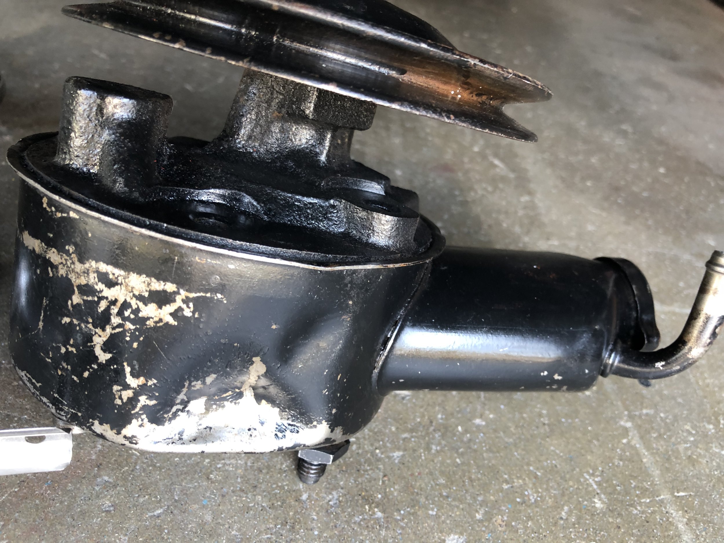

    IMG_8333.jpeg So I was able to use a pipe and get more leverage to rotate it. It’s clear now.
    Does anyone know how to remove the pump reservoir case? I put a dent in it and wanted to bang it out. Removed the big nut and reinstalled the smaller mounting nuts and pounded with a mallet but it didn’t budge. Should I just leave it and hope the inside wasn’t damaged?
