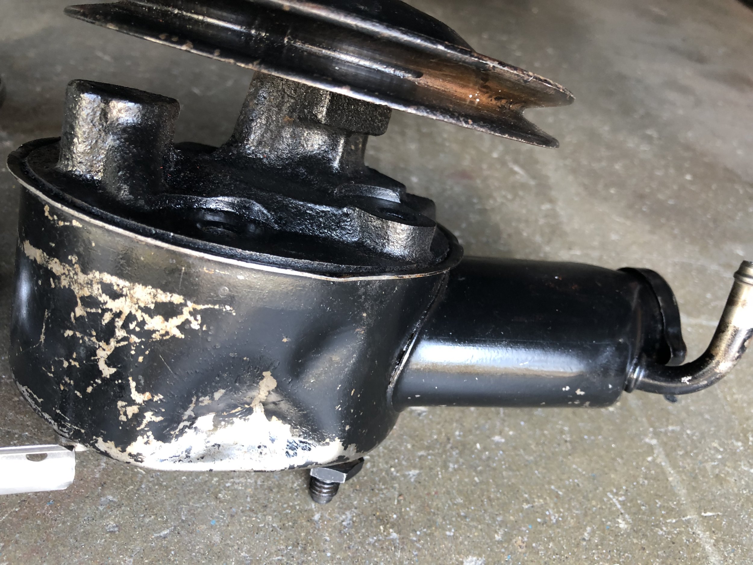

  4. Eth727
    Joined: Jun 20, 2024
    Posts: 327
    Eth727
    So what should I do about the dent?
  5. alchemy
    Joined: Sep 27, 2002
    Posts: 22,623
    alchemy
    Buy a different pump.

  7. Eth727
    Posts: 327
    Eth727
    Can we get back to the PS pump? I got the reservoir off and pounded out the dent. However while I was banging out the bolts the holes got wallowed out a little. I hammered them best I could to get them flat but it’s not a perfect circle. Where it bolts to the pump is a O-ring. I’m thinking of using RTV to seal up the mis shapen hole.
    And another thing: I just noticed the pulley has a wobble/runout. I should’ve noticed this earlier. Do you think the pulley is toast or something else?
  8. Moriarity
    Joined: Apr 11, 2001
    Posts: 37,214
    Moriarity
    SUPER MODERATOR
    yup, get a different pump. the dents you put in the can will more than likely cause it to leak at the o ring. prying on the housing is a no no.
  9. 05snopro440
    Joined: Mar 15, 2011
    Posts: 2,962
    05snopro440
    We all make mistakes and we all start somewhere, but you seem to keep going without knowing what you're doing next. Please, stop and educate yourself. Get yourself a new pump. Prying on it cost you a learning experience at the price of another pump.
    I don't know how much pressure that area of the pump is under, but GM power steering pumps put out as much as 1,350 psi. When you pried on the pump the first time and dented it, the steel was weakened. Bending it back and further deforming it weakened things again.
    Just like you shouldn't trust tires based on their tread, you shouldn't trust a component of a hydraulic system under pressure that has been yielded and cold bent back into shape.
  10. Eth727
    Posts: 327
    Eth727
    I’m curious on the pulley wobble. How do I determine the the source . I removed the pulley with a puller. The shaft seems straight .
  11. Moriarity
    Posts: 37,214
    Moriarity
    SUPER MODERATOR
    The pulley is probably bent. Get a different pump and it will come with a pulley
    klleetrucking and 05snopro440 like this.
