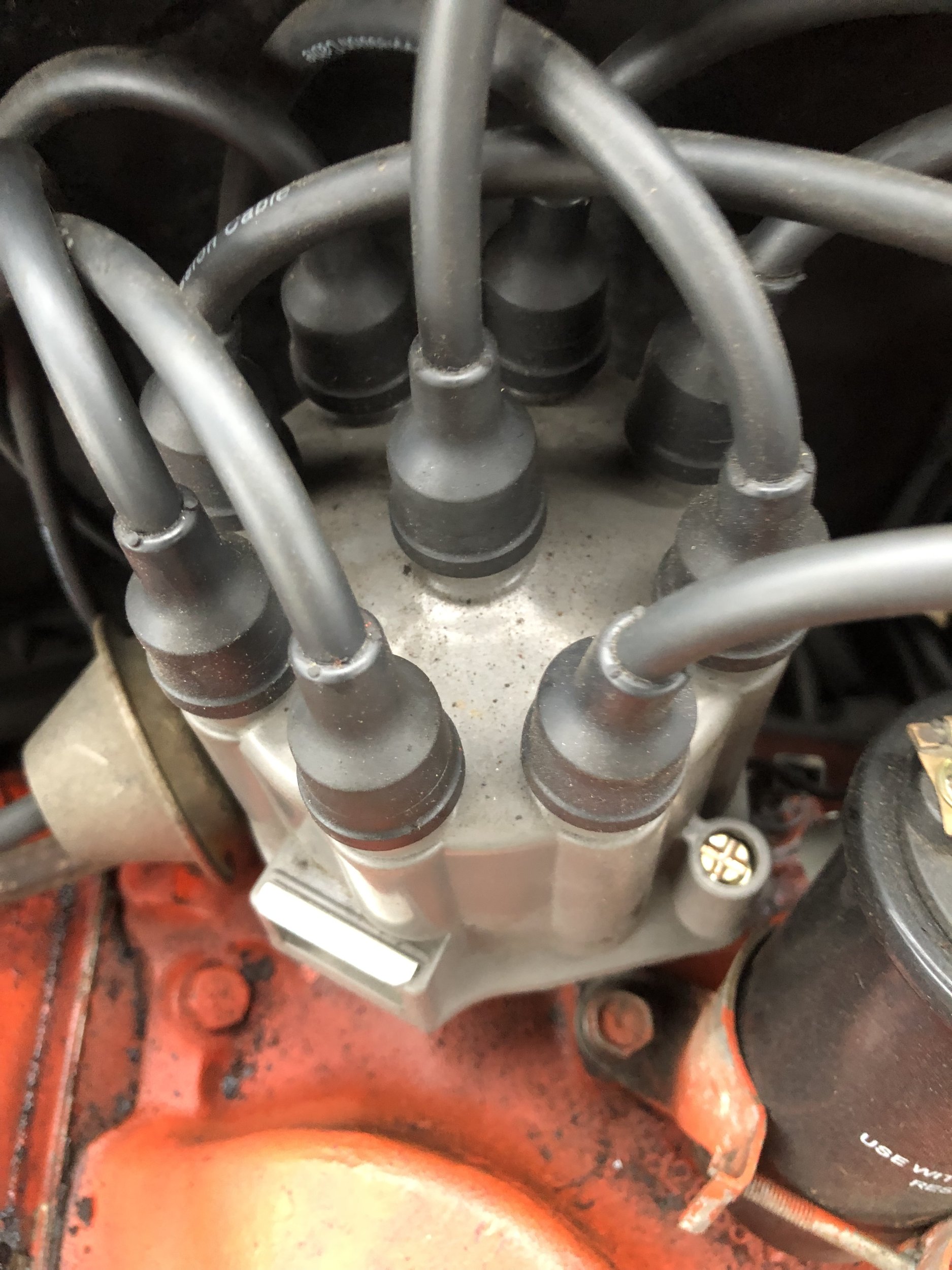

  10. Eth727
    Joined: Jun 20, 2024
    Posts: 338
    Eth727
  11. Eth727
    Posts: 338
    Eth727
    Can someone please edit my photo with cylinder numbers? Thanks
  12. wuga
    Joined: Sep 21, 2008
    Posts: 721
    wuga
    You cannot edit picture without knowing which one is cylinder one. Follow each wire back from the appropriate cylinder and tag the cap end with a numbered piece of masking tape. When all are marked, it should look like the picture above. If all else fails, take it back to the shop that messed it up and let them have a look.

  13. Fordors
    Joined: Sep 22, 2016
    Posts: 6,492
    Fordors
    Looking at the photo it appears this is your no. 1^.
    Going CW you should have 8-4 to p***enger side, 3 to drivers side, 6 p***., 5 dr., 7 p***., and 2 dr. side. As was mentioned earlier 5 and 7 are easy to cross if you’re not careful.
  14. Eth727
    Posts: 338
    Eth727
