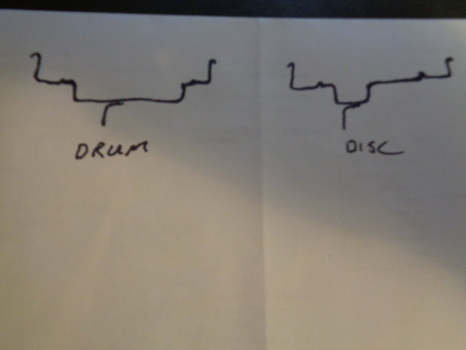

    Here is a crude sketch of why a stock wheel won't fit. To fit disc brakes they opened up the bell in the back of the rim and narrowed the drop center. You can use the wheels on the car to figure out what it needs. If the diameter is OK, you are done with that. If you want/need to go smaller, measure the space between the rim and the caliper. Every rim diameter smaller you go will reduce that space by 1/2". If the wheels on the car aren't hitting or rubbing anywhere, you've got a good starting point for rim width and backspacing.

    Full size Chevys from the early 70's to 76 had a 5x5 bolt pattern. The 77 & up down sized, full size sedans had the 5x4.75 bolt pattern. The station wagons kept the 5x5 pattern. Can't say for the other full size GM lines. The 70's & 80's RWD Malibu and Nova and their clones along with Camaro & Firebird had 5x4.75 bolt patterns. Also S-10 & Sonoma.
    Generally speaking, but not always, a 15" rim will clear a 12" and down rotor and a 14" rim will clear an 11" and down rotor.
