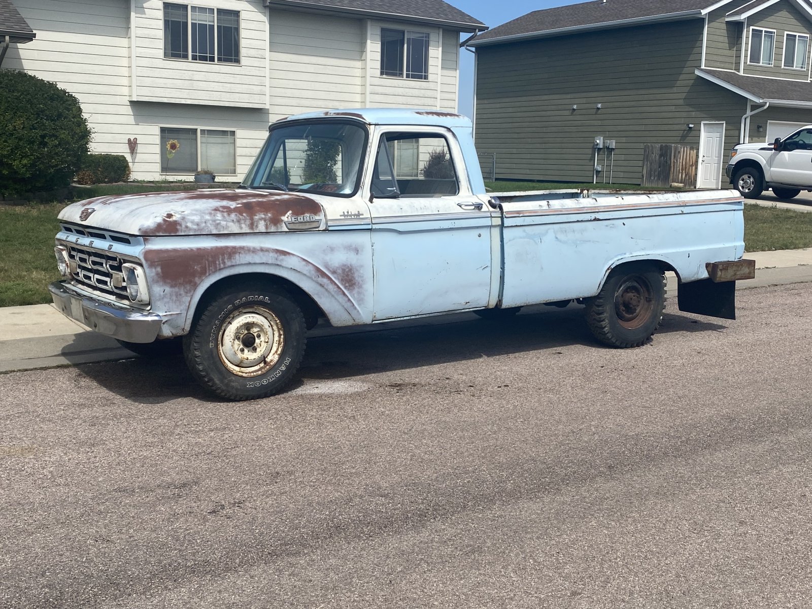

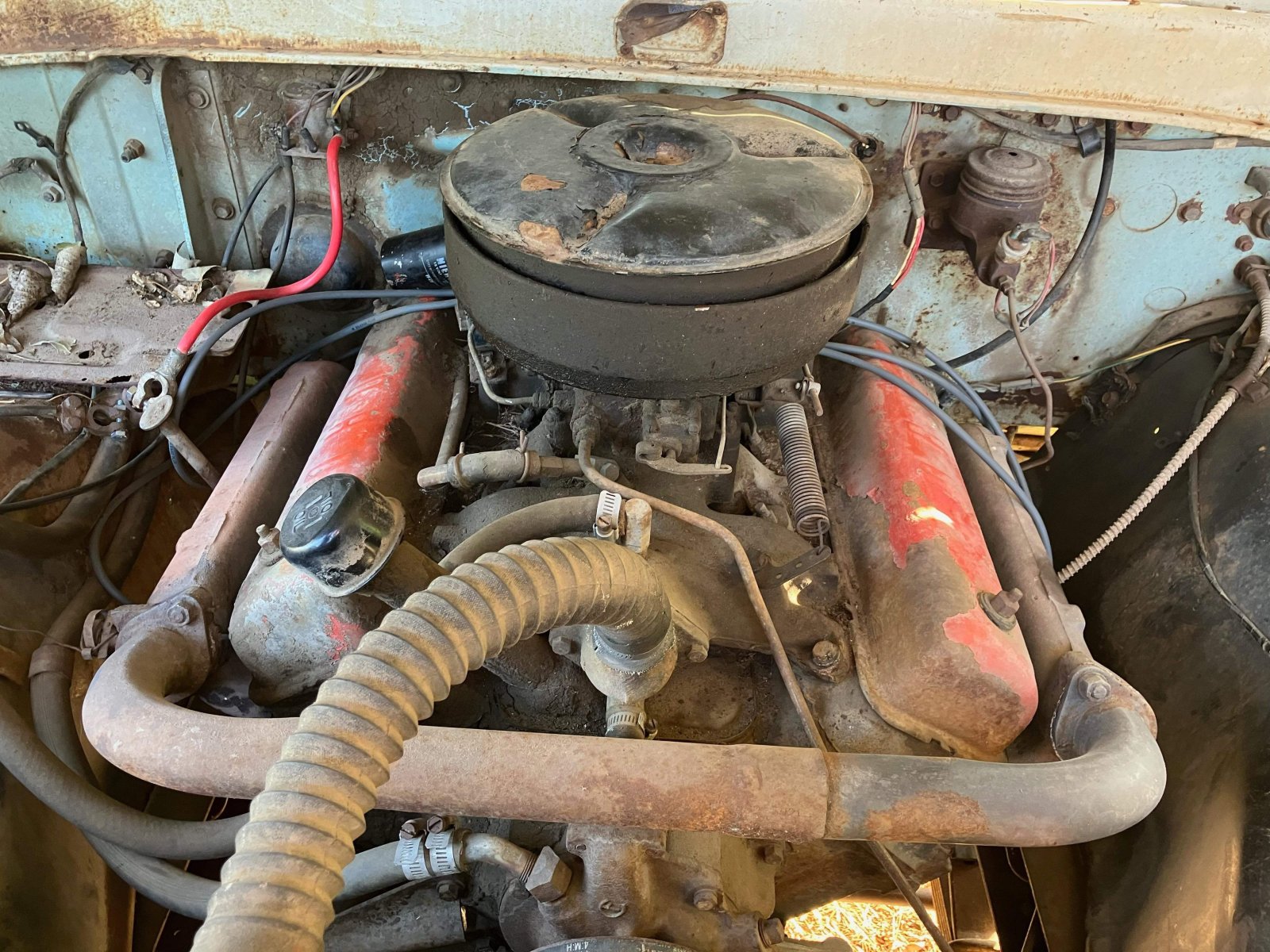

    Was on the look out for a unibody f100. Stumbled on to this one here locally. Been wanting a “daily driver “ older pickup for awhile. This thing is pretty clean. Someone put a ****py hood and p***enger door on it. Has 39k on the ticker. I honestly believe it is true mileage. It came from a farm in Hazen ND. Had a fancy grill guard and a less than fancy rear bumper on it. Motor was stuck. Plates were from ‘97. Has just a bit of rust in each floor board and some small bits in some normal unnoticeable areas. 292 Y-Block and a T-19 4 spd. 8 bolt limited slip Dana 60.

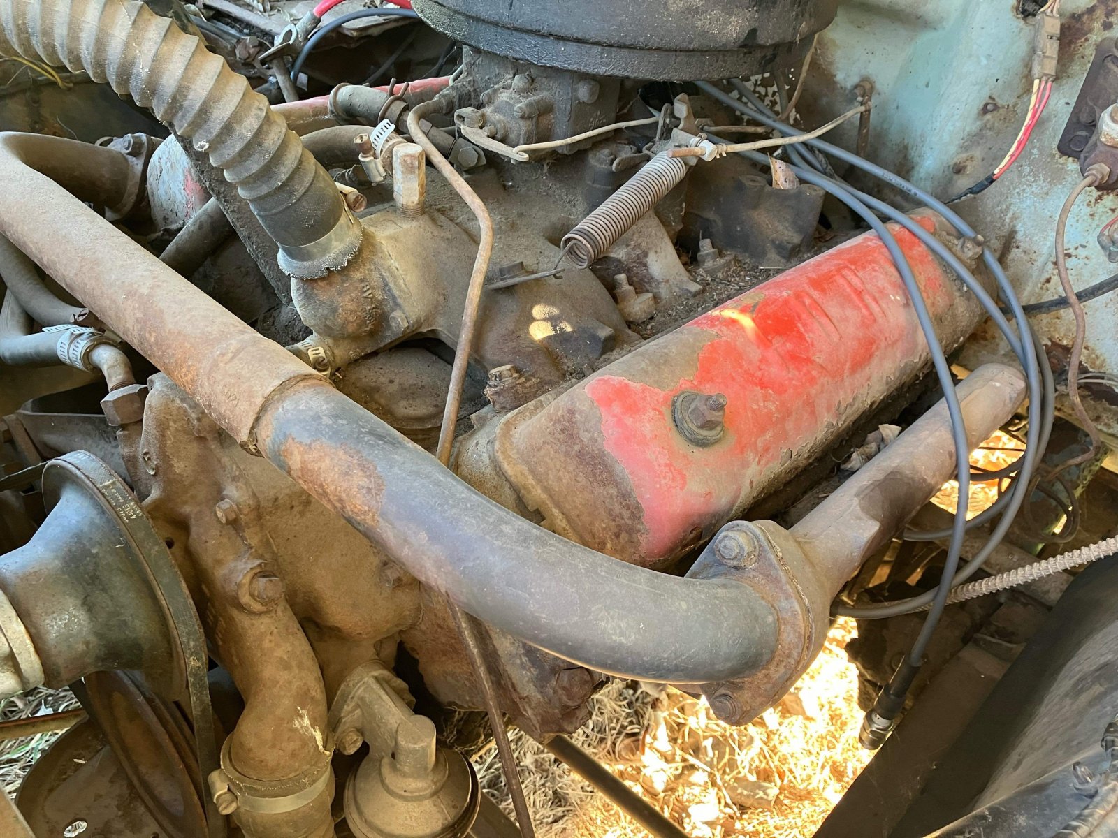

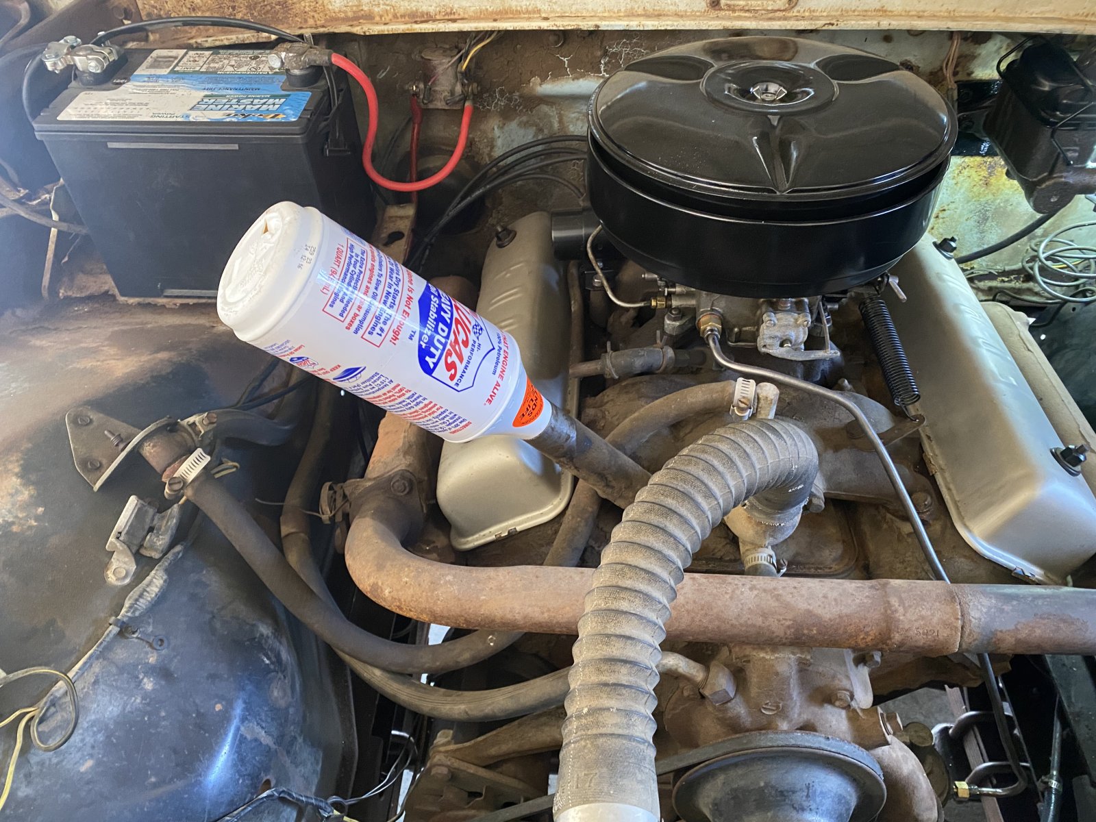

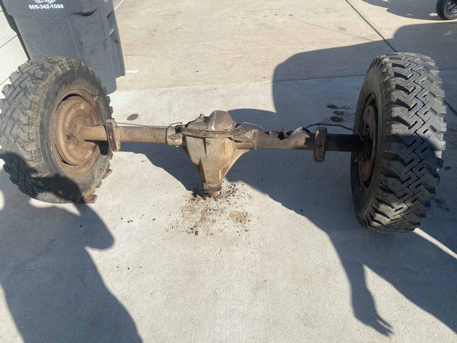

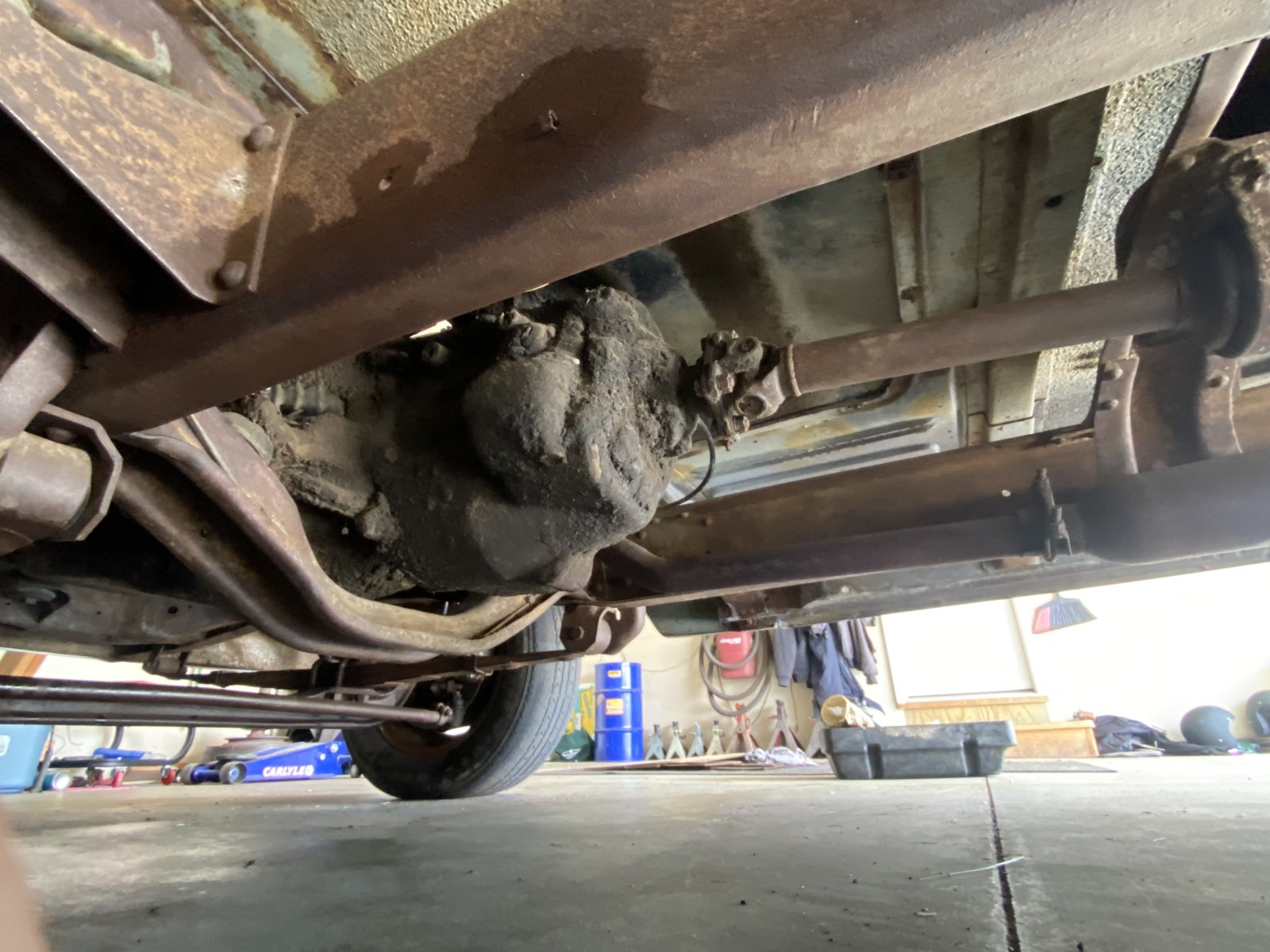

    Spent a few days getting it freed up and running. Rebuilt the carb. Runs really well. Put a cheap speedway disc brake kit on the front. Want to lower it a bit with some rubber rake on older 5 spokes, so needed to do something different for the 8 lug rear. Odd ball axle’s forced me to put in a clean 9”.

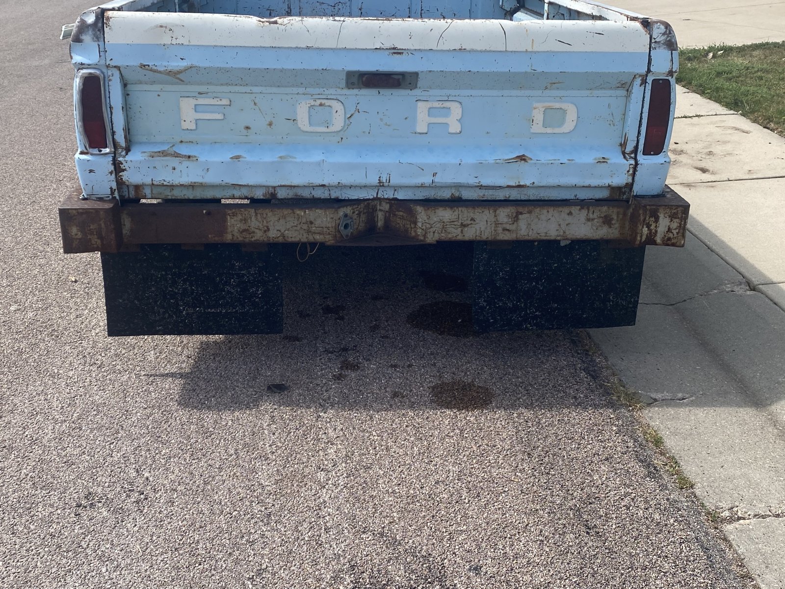

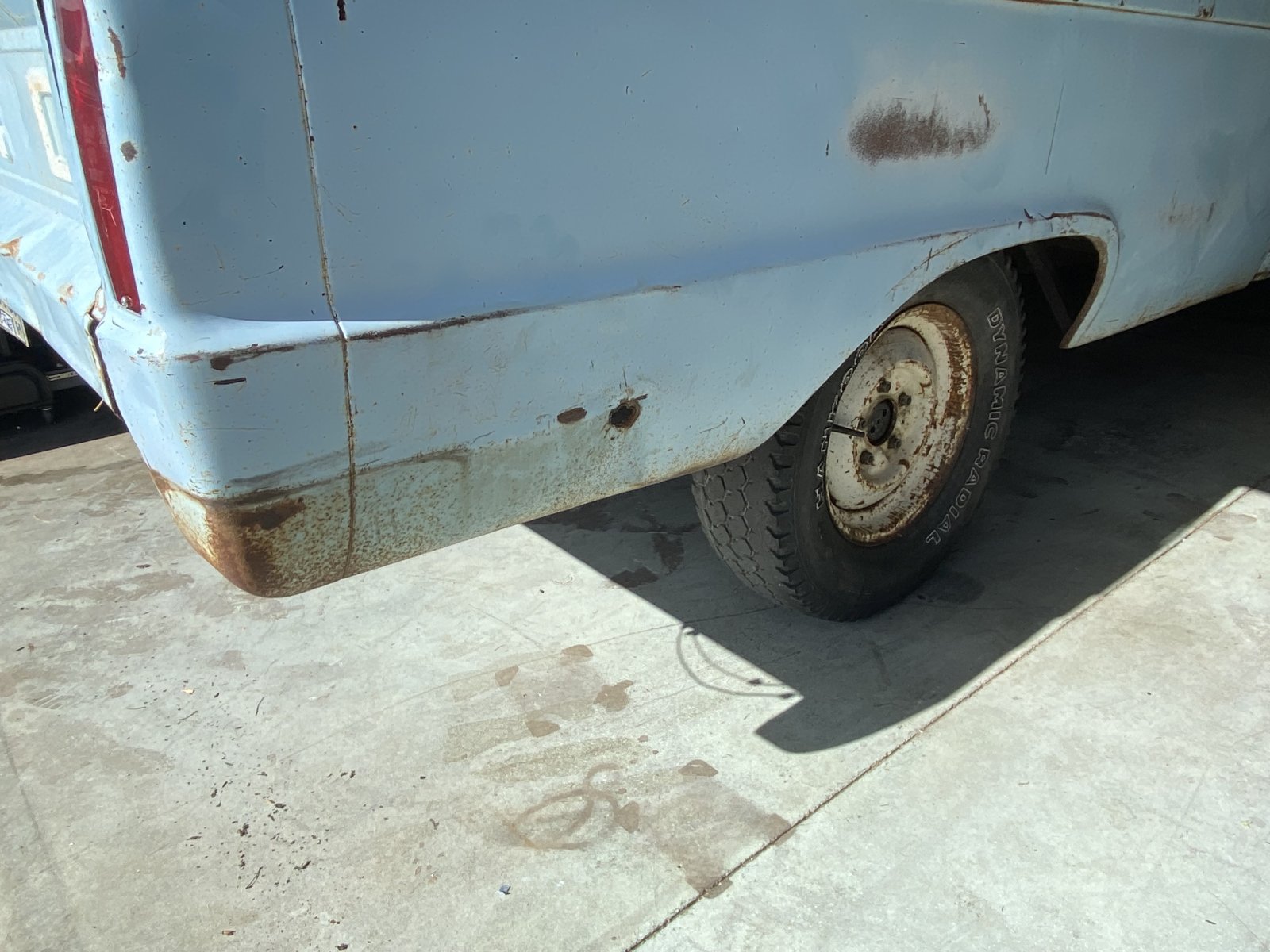

    Ditched both the grill guard and rear bumper. Looks like the ol boy used a torch to blow the hole’s through the rear quarter to mount the rear bumper. Dang it.

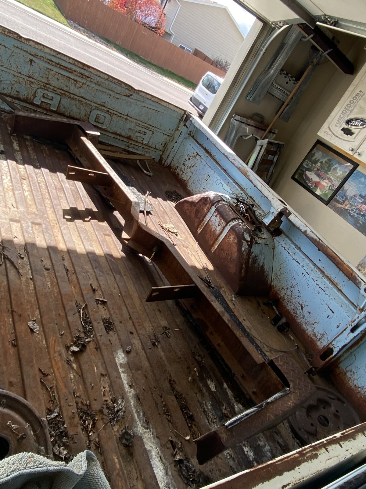

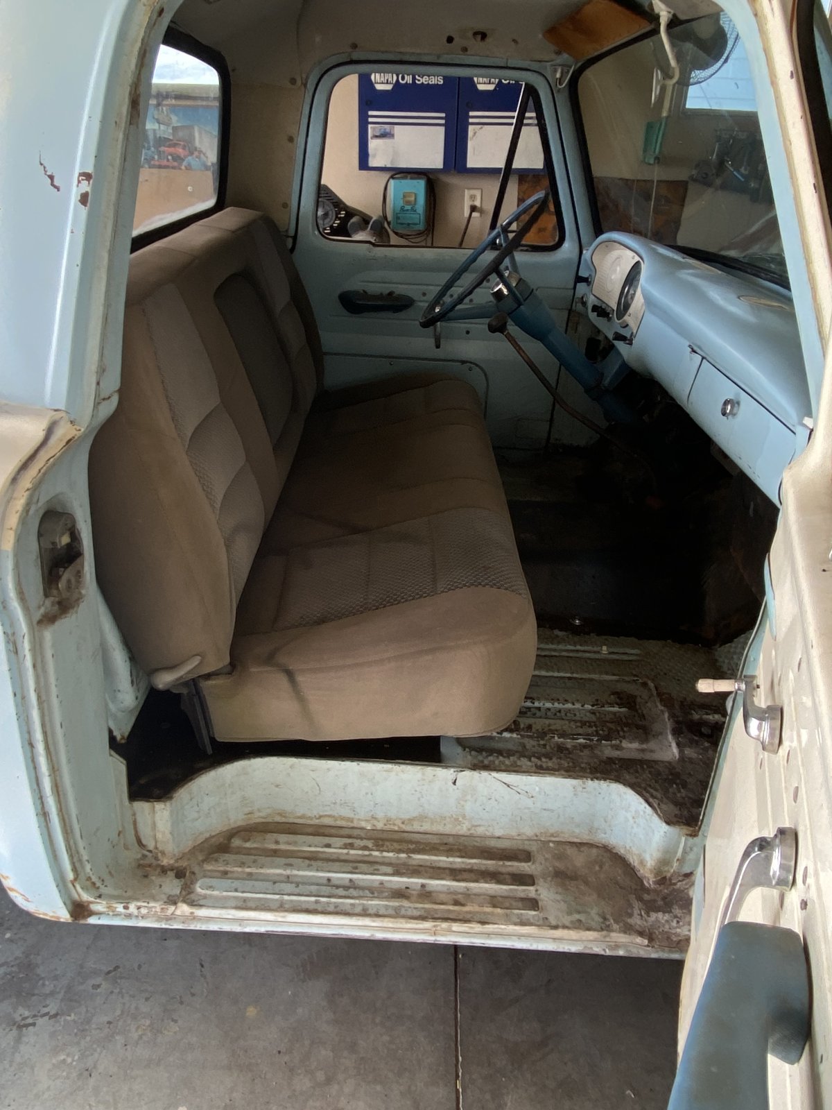

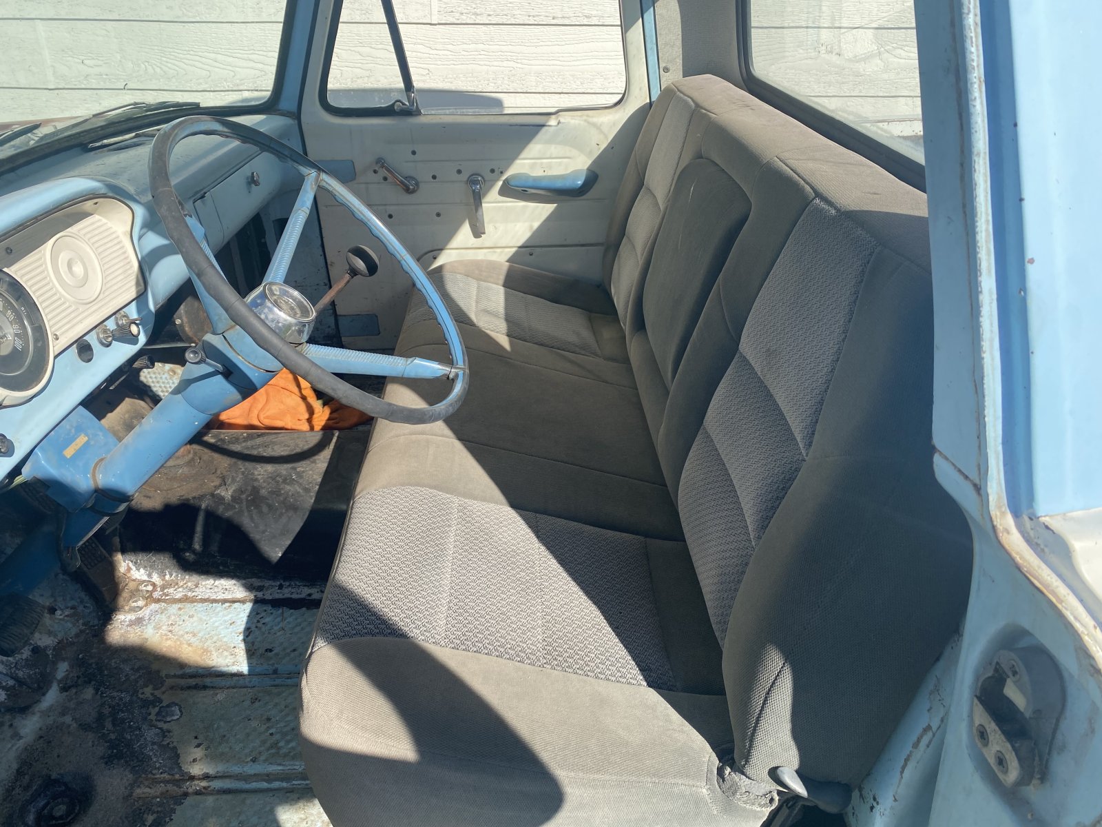

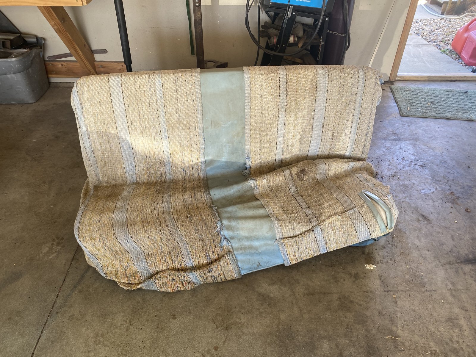

    Original seat was in terrible shape and paying to have interior done is beyond my ability. So after some research figured out a super duty ford rear bench seat goes in with kissy a bit of modification. I was able to use the adjustable runners off the old seat and mount the new seat in the original holes. I really hate late model interior upgrades. But this one seems to work better than most I’ve seen. I also pulled the tank, filled with vinegar and rocks and took a drive through the winders in the hills to clean it up. Ran the heated power washer through it and unplugged the pickup. Reinstalled after treating any surface rust on the floor, priming, and spraying with a cheap undercoating.

    IMG_3692.jpeg IMG_3696.jpeg I have since flipped the rear axle with a small C notch and pulled several leaves from the front. I plan on redoing the front. Will add leaves back in and flip the axle to gain some clearance I will probably have to do a small notch in front too. Put a set of 255/75/15s in the rear and 215/60/15s up front. I love a good rubber rake.

    That may be a T98. T98 was standard through 1964. Its my understanding that the T18 was introduced in 1965.
    I had a ‘63 250 with a 292, T98 4 speed and a Dana 60 with 4:56 gears.
    It was a freaking man!
    I loved it.
    I do believe that the Dana 60 was offered in the F100 as an option. I suppose that 5 lug Dana 60 axle shafts exist. It may be easier to convert those axle shafts to 5 lug if you ever wanted to run it.
    Nice truck!
  24. finn
    Joined: Jan 25, 2006
    Posts: 1,480
    finn
    Yes, a Dana 60 was available as part of the higher Gvw package on the F100. I think there were some Dana 44s in there for some years, but I’m not certain about that. Looks like that’s what this truck has, (a 60), five lugs and all.
    Only reason to pull the Dana in favor of a 9” is a wider selection gears in the cruising range to keep rpm down, although now that he has a T5, that may not be desirable.

    I did put a 9" in it. With way to tall of gear, I need to change to 4:10's so I can actually use 5th gear.
    But it fits well and allows a much better wheel choice

    Your seat looks like exactly like the one I have in my 56 F100- 2005 F250 king cab rear??? Works great in my truck!
