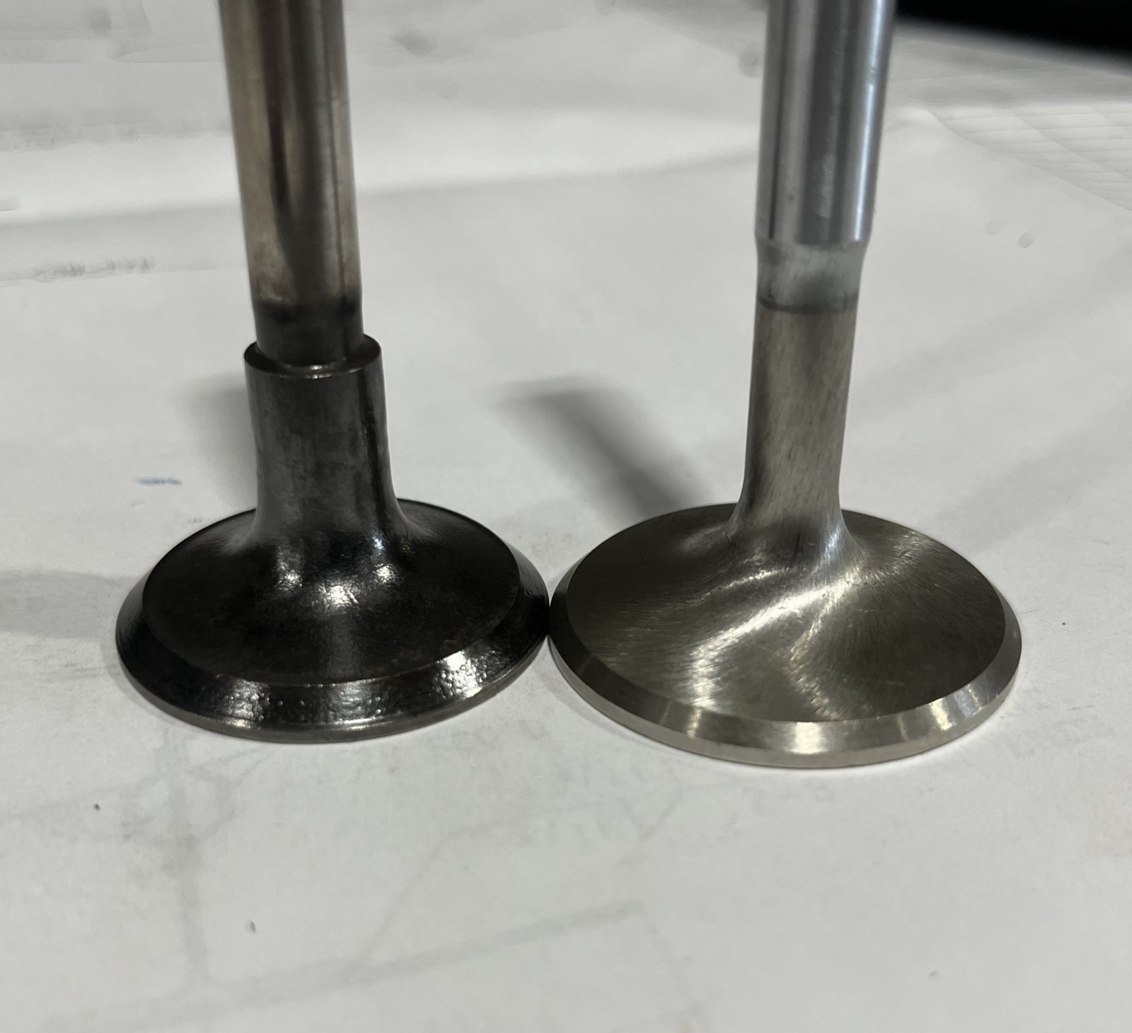

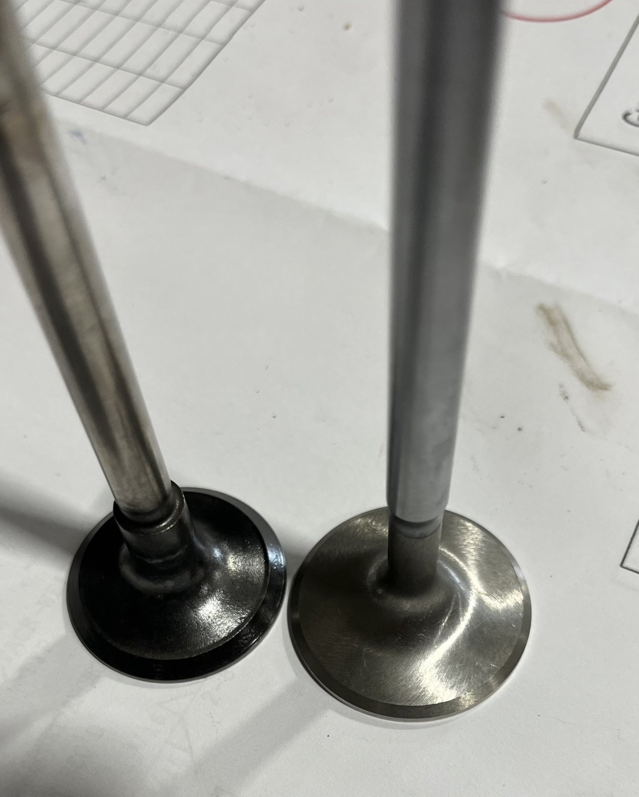

    30B09942-836A-4FAB-ACF7-217FF6098232.jpeg BDB3BDD7-B8F0-488F-ABE0-EFA2ED7AB047.jpeg I’m building a 296” flathead with Potvin super 3/8 cam. I’m thinking about using Manley Race Flo 1.6 for the intake and 1.5 for the exhaust.
    With the head .030 thinner that’s like getting free .030 more cam lift. The undercut stems seem like they would flow so much better.
    With the block fully ported, the biggest restriction on airflow are the stock valves and guides. What do you guys think?

    The valves will certainly help the engine perform better as you noted by the improvement in port flow due to the undercut stem. An additional bonus is the reduction in gram weight compared to the stock valves. Less weight on the valve train will help reduce lifter and lobe wear. Plus increase top end RPM which is always a good thing ;).

    From experience that line right below the taper is where they “can” part!

    Those valves are ok for a stock engine.
    They can be lightened considerably for longer life.
    They have 45 degree seats. That is not good for a performance flathead. 30 degree seats alone will improve flow 15% and last just as long.
    If you want more performance and longer valve train life, get friendly with a NASCAR or WORLD of OUTLAWS engine builder and buy some "take out" titanium valves from him.
    They change them out after X number of hours and they will last almost forever in a flathead. Be sure to specify ones that the head diameter will finish at 1.7".
    You will have to make guides for them but you should be doing that anyway.
