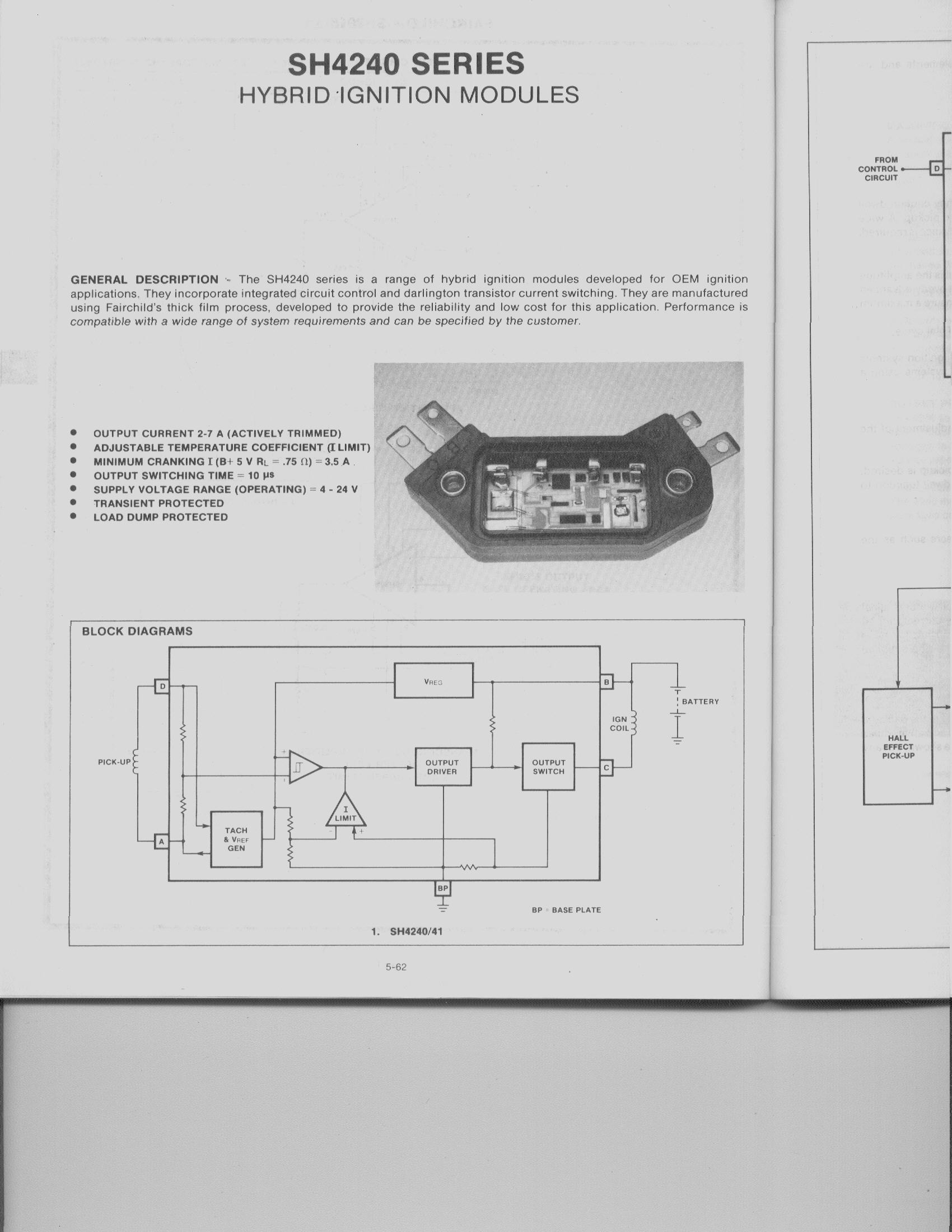

    There are as many solutions as there are circuit designers. One KISS solution is one NPN transistor and a few resistors. Use transistor as an ON/OFF switch; emitter to ground, collector to buzzer, other terminal of buzzer to V+, base to belt switch, R1 base to V+, R2 base to ground. When belt switch opens, (V+) * (R2/(R1+R2) ) needs to be enough voltage to t.urn the transistor ON; so R1 high resistance, R2 low resistance, and R1 small enough and R2 high enough to let enough base current to flow to turn it ON. Belt switch closed must have very low resistance to drag the base voltage down close to zero volts. So you start by picking a common transistor, get the spec sheet, then calc some good R values. Excel is your friend, or freeware Spice even better.
    Unfortunately, you might find the simplest circuits react to electrical noise, so then you need to filter the supply and add a voltage regulator, limit base voltage, or maybe you build two of them and one works fine but the other needs different R values. Maybe it switches a couple times OK, but we didnt know the buzzer was inductive and we get a spike which kills our transistor so you add flyback protection... an ounce of test is worth a ton of theory. Making something reliable and cheap to manufacture that lives in the automotive environment is challenging, especially if I expect it to last many, many years after being out of production.
    (I think a lot of you may wish you had skipped all of the above.)
    Hmmm...switch opens turns something on...I might start by stealing errrrr reviewing schematics for some of those 1970s circuit designs which transistor-switched an ignition coil using the original points. Bet there is a cheap COTS coil driver out there. Will look, edit if I find.
    edit - Yeah, some of those old coil driver/solenoid driver circuits became IC's with IGBT outputs instead of bipolar transistors. One example still available is Fairchild (now ONSemi) ISL9V20240. Cheap in reel qty, 2 to 3 bucks in single qty.
    VANDENPLAS likes this.
