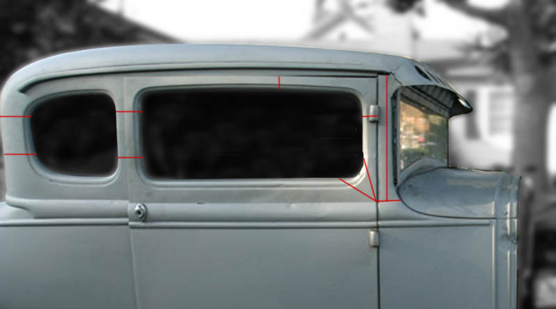

    Here's the deal. I want to get down to the real nuts and bolts on this thing as soon as we can and I'm trying to work out some problems I think we'll have with the chop.
    Now Photoshop is a fairly easy program to work and if you're using it to chop a picture it doesn't take long to learn the tricks to fudge fit, finish, and cut lines. And it's even more simple to just say "Give the roof an even chop and make sure it has a five inch windshield." Well here's where we make it hard. We want to take the bolt upright pillars of the model A and make them...not. Anyone following these threads has no doubt seen the Chrisman coupe? Good. Then you know where I'm headed with this.
    When you start really looking at the cowl of a model A you quickly realize that to really rake the pillars is going to be a lot of work. Maybe not so bad if you want something subtle but lets face it, subtlety won't give you a 200mph pass. These pillars are going to have to be leaned hard.
    I've got three pictures. 1) What we're starting with. 2) Where I've invisioned cutting the body. and 3) where I think it will get me.
    Here's the bone stock roof...alright, it's been chopped already but the shot worked perfectly for my purposes.

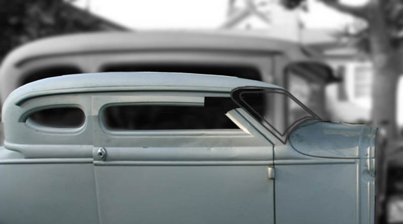

    Now here's where I've thought about cutting it. The best place? You tell me. I'll tell and show you what I was thinking next.

    Here's where it took me. I really did nothing but cut along the lines and rearrange pieces. No fudging. I know the back will need more work than I've shown - vertical relief cuts and whatnot - but we are concentrating on the A pillars so I didn't bother.
    The pie cut in the corner of the door gives the initial rake. The top corner is completely removed and will not be used on the car. Instead we will take a piece of the door frame left over from the chop and give it several relief cuts, giving it a curve and filling the gap you see in the photo. (I didn't want to take the time to Photoshop it.
    The A pillar will be split vertically...skinned for lack of a better term. And after the cut is made along the beltline to get the rake to match the door a completely new windshield surround will be installed. I think I heard the Chrisman car used somehing from an Oldsmobile? That can be worked on and discussed later.
    I know it seems unconventional and backwards to build the doors first but in this circumstance doesn't it make more sense to build solid, straight doors with a good shape and "lay" the windshield on top of them and blend it into the roof and cowl? I think door fit could be adjusted just as easy this way. What do you think?

    I think I have read somewhere that the Rule at the time of the Chrisman Coupe said that it had to have 7" of windshield.
    But it not say anything about raking it, so raking it was a loophole in the rules...
    Also it seems to me that the top of the windshield is cut higher into the roof than the sideglass, and the driprails are shaved, so the area over the side windows looks a little tall.
    If the car is going to be outside todays coupe classes, you dont have to worry about the minimum 5" of vertical windshield glass, so I would clean those areas up a little and I would chop it a lot more.
    Take what ever the amount the Chrisman Bros took out of their pillars, and take another inch ( or maybe two ) out of the area over the sidewindows...

    I have set here staring at your plans and can not come up with any reason why it would not work as you have it. Doing the doors first is not a bad idea at all. I did the same thing on 2 different chops that I have done.
    I am interested though to see how you work out the windshield. But you say you already have a idea about that as well. There will be a lot of force pushing on it at 220+.
