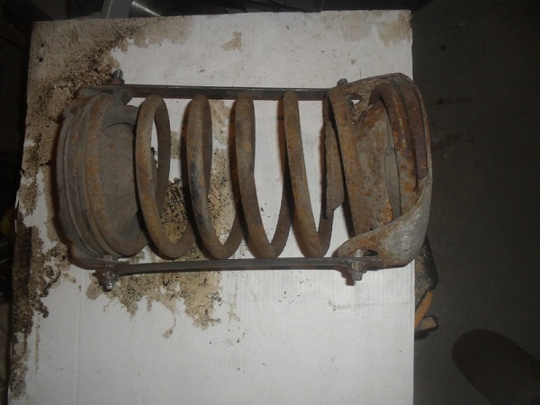

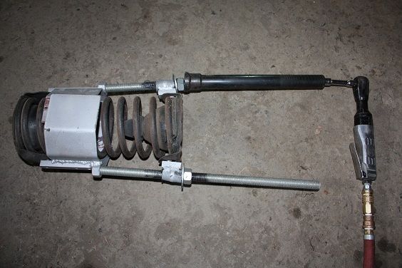

    Steve, Took your advice. Just returned from the hardware store. Couplings are 2-1/4" long, and the nuts I won't be using are only 5/8" long. I do need to weld a grade five 9/16" bolt to a slider(2" pipe that slides on the 3/4" threaded rod) for each side. The 9/16" bolt head needs a 3/16" gap to fit in the saddle of the coil spring. The coupling will move the slider compressing the coil spring about 5-1/2" making it possible to remove the coil spring.. Here is a scary picture of a removed coil spring being stored under compression. Notice the saddle hole openings for the 9/16" bolt heads to fit into. I did not make these trunnion coil spring compressors. Second picture shows how the nut will move the slider to compress the spring. No version of this tool was ever commercially manufactured. A coil spring compressor was never made for trunnion coil springs.
