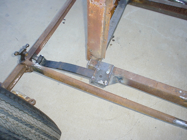

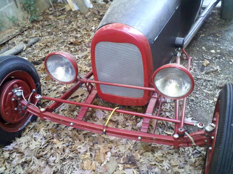

  19. Went to the shop and took some close-ups of two I have done. First is an altered. Second is my rail and has a single quarter elip. (The nylon strap is for my tow strap and since it doesnt interfere with anything I leave it there. )
    Don

  22. this set looks like it has some sag showing in the spring. ?

  26. rotten egg
    Joined: Dec 17, 2009
    Posts: 59
