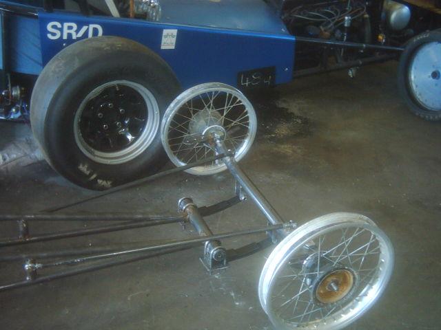

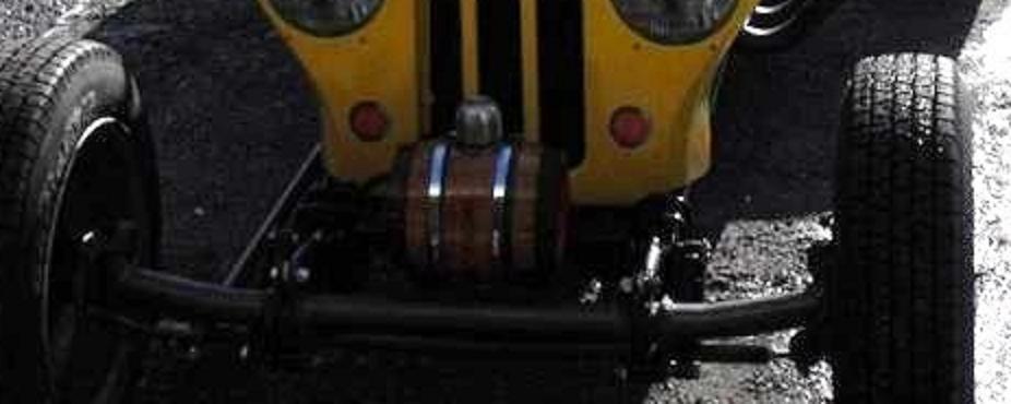

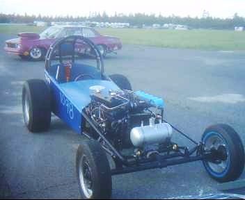

  13. Pictures? :) Sure, sorry, i was away for a couple of weeks.
    Dragster also to the left is a single 1/4 eliphtic. Run straight as an arrow whether i steer it or not.
    Yelow Jeep altered is a double. Dragster is a different style of 1/4 eliphtic but i think it wil turn out to be good as well. Very stable setup. A minumum of parts and a minimum of problems. (So far none. )Almost too simple which confuses most of us. Once you have used it you wonder why you didnt always use it.
    Don
    For a better look simply use the zoom feature to the right hand bottom of your screen (+100%)
