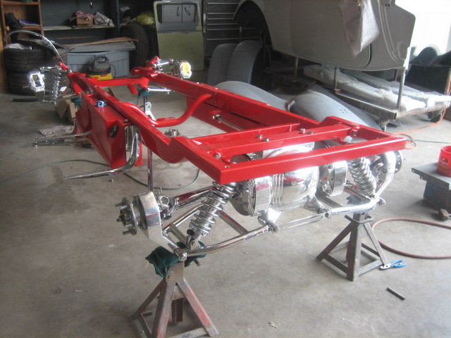

    I have used 11g on 2x4 frame rails but 11g 2x3 is a bit springy and twisty (engineering tech terms) to my liking. For the weight difference I think you'd be better off with the 3/16. Another option is to get one stick of 2x3 for the front and rear and a second stick of 2x4 for the long center section. You can fab up taper transition plates for the 3" to the 4" and make a very pretty frame that's also strong. Here is a couple shots of one for a 31 A coupe we made that actually goes down to 2x2 for the part behind the rear suspension since it just holds sheet metal and not subject to any torque.
  7. Mine has 3/16 2x4 and is solid as a rock!
