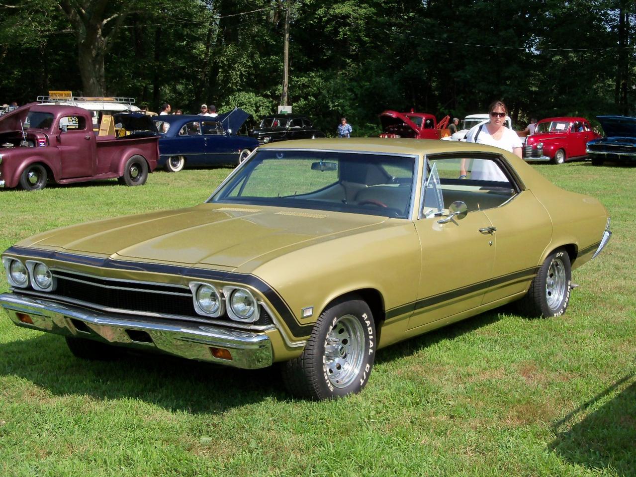

    Good feedback. That confirms everything I already assumed and always comes into play when considering 1.8 rockers with a modified engine. I'm hoping to get some feedback using the 1.8's in a stock application as a low budget alternative to a cam swap. Think of this 68 as a modern rat rod. It looks good from a distance but it's a daily driver that I rescued from the crusher as a parts car. Threw some paint and parts at it and wahla. If I can't make the parts I have work, I need to use other parts I have laying around or find them on the cheap (free is good). I'd leave the six in there if it were in better shape and got me out of traffic quicker.

    Good luck with your 68. Looks nice in the picture. A 454 should move that beast bone stock. Lots o torque :)

    Thanks 70D. For lack of better words - I can really polish a turd. Didn't even need any filler on this one. Could have dropped the FUZZ 454 in as is, but seemed a little boring to me. Got a vintage Edelbrock C396CJ intake out of stock and a free set of 71 heads that started this whole crusade. Top it with a 750 QJet and it's a recipe for a classic sleeper. Way better than the six straight shooter it in now.

    It should be a real nice sleeper/driver. Good luck man.
