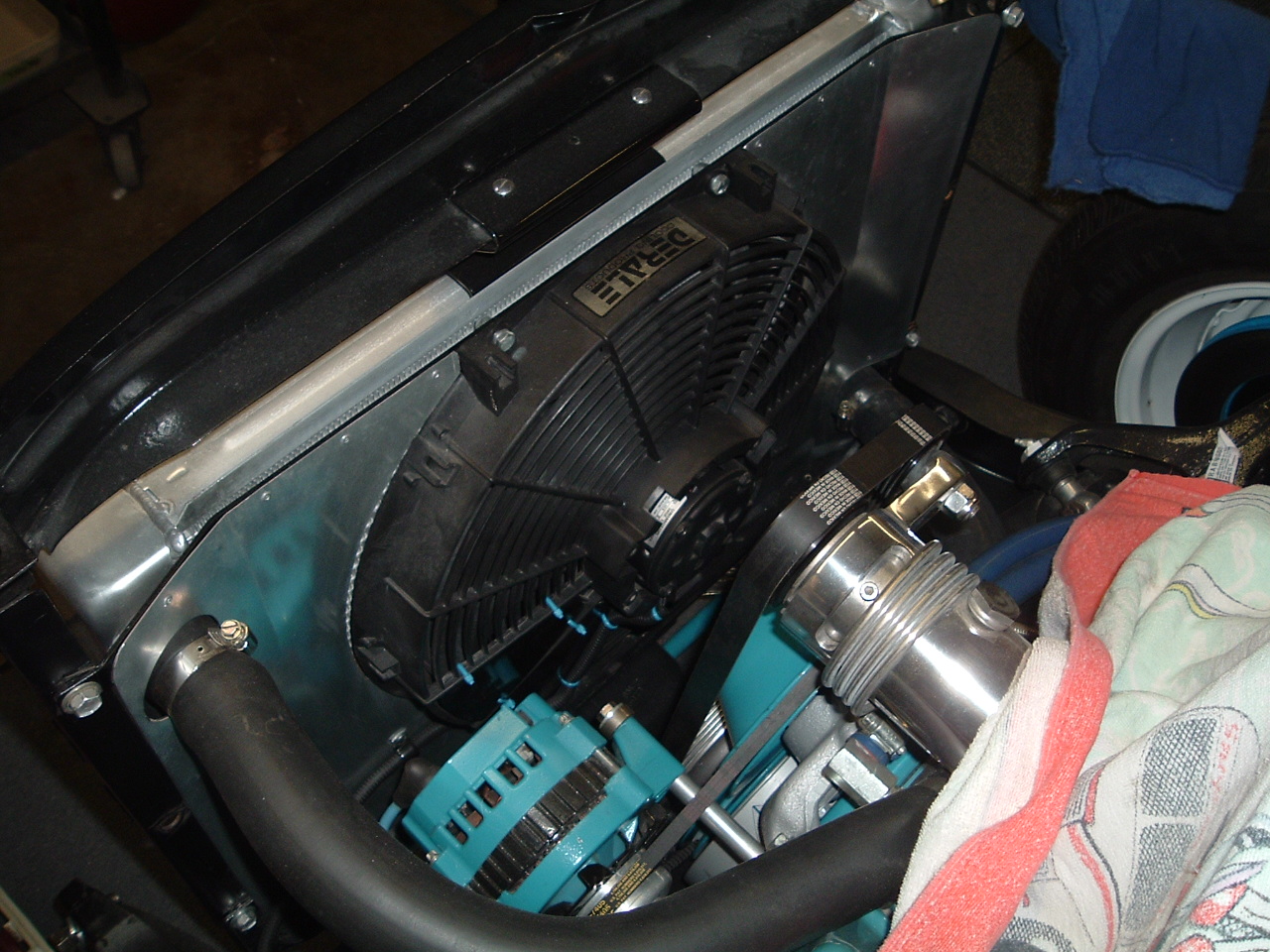

  1. I have 2 hot rods that have 1 wire alternators on them. on both cars when the car is started up the belt to the alt will slip and squeal no matter how much I tighten the belts One is 100 amp and the belt will stop squealing after about 60 seconds it doesn't do it if the battery is at 100 present charge only when it is at a point that it starts to charge is when it squeals . the other is a 150 amp alt and it squeals all the time and I can't get it to stop. I can live with the 100 amp but the 150 amp seems to be very hard to turn when hooked up and charging ' I can take the 8 gauge wire off the back of the alt and it doesn't slip at all . the belt is new and I have it so tight I am afraid it will eat up the alt bearings and it still slips.

    post pics of motor/belt set up. even if both pulleys V-belt style there may be a difference in the width of them - need to match. running a racing pulley? what does removing the primary wire have to do with belt slipping? pulleys painted or polished - can add to slip factor.

  12. A pic of your belt drive, I just run an a 1 wire 140 amp, and works fine. You need enough of the belt wraped around the pully.

    Backside idlers are not recommended on v-belts. You might want to try a belt having notched construction (sometimes called cogged) on the v side. This allows the belt to conform to the smaller diameter sheaves and provide greater contact. Increasing center distances by moving the alternater farther away from the other sheaves also increases the arc of contact.
