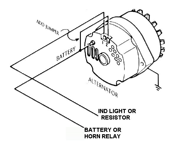

    If you have a generator light, then why on earth would you want to run a 1 wire alternator instead of a normal 3 wire alternator? Use the generator light as designed....

    The picture squirrel shows is a typical 10SI or 12SI wiring. If you leave the #1 wire off it's how they are converted to 1 wire. If you want the idiot light it's wired as above. Same alternator, either way.
  7. yes....use a three wire alternator and wire in the idiot light as shown in post #5
  8. American Autowire has a relay assembly that they sell so you can hook up a 1 wire alternator and have a functioning GEN light.
    The relay is set up so that the light will come on if the voltage drops to 11 Amps.

    The #2 terminal is voltage sensing, and if that wire is run along with the output cable to the main voltage distribution supply (not the battery) instead of jumping directly to the output , the alternator will perform better, and as designed. :)

    I used a junction block off a 70's GM pickup , which I mounted on the core support. ,( they are mounted on the firewall on the trucks). removed all but the main power feed(thick wire) from the generator feed and routed that to the junction box. I have a remote starter solenoid, so I ran the wire from my alternator to the solenoid positive. I then ran a wire from battery positive to the junction box, and added a voltmeter under the dash, wired to a keyed hot terminal off the fuse box. Has worked well for 10 years. That said, I will be adding a stock alternator,(10si) wired correctly, and will not run a one wire again. My wiring skills, and thinking are much better now then 10 years ago.
