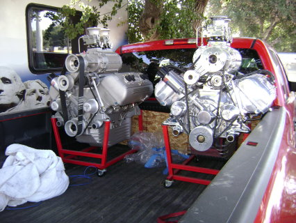

    Yup ....What bored and stroked said ....... if that front gear will fit in your slanty nose car
    I have an original SCoT set-up anyone can have for a lot less that $17,000
    Came from Neal East years ago. PM me .....OK NOT CHEAP but not $17k either
    My engine's on the left ...... Sorry I keep using the same photo it's the only one I have and it's a long trip to get another

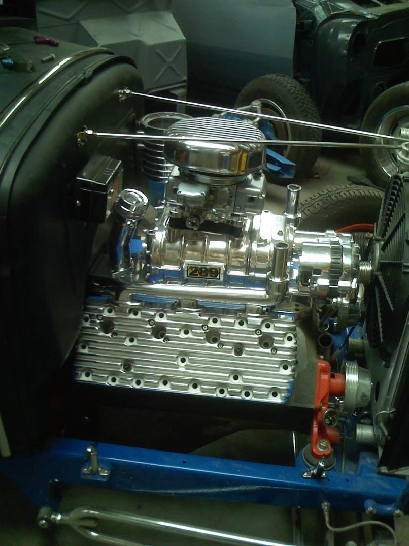

    MY buddys full fendered 32 roadster turned around 96 in the quarter with as I recall, a 296" flatty, sharp heads/3 pot, H&C mag, potvin eliminator cam, and 3:54 gear[Ansen built motor in 1954]what kind of horsepower would that be? It made a believer outta me,was sure fun on the street! Did 110 on the speedo thru santa ana canyon. If I had the money I would like to have a flatty that good.
