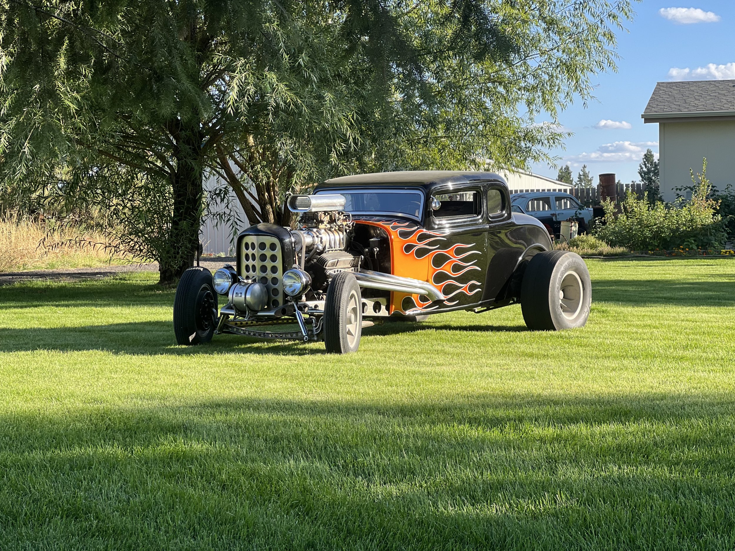

    I built my 32 ford 5w a little over 10 years ago. It is all steel, with a 475 horse blown small block and a muncie 4 speed. My best time in the quarter is 10.89 at 130 mph. My total cost in the build was $10,425.00. I know that this could bot be done today, but maybe with a model a body or a fibergl*** t you could do it and still have a cool car when you are done. IMG_2269.jpeg
