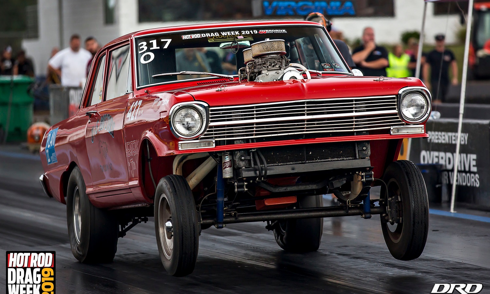

  10. squirrel
    Joined: Sep 23, 2004
    Posts: 59,983
    squirrel
    no, not everything cool is expensive. I built this car for $15k, it was pretty cool

  12. twenty8
    Joined: Apr 8, 2021
    Posts: 3,694
    twenty8
    And that's how the $10k mark comes and goes. You either spend it making everything strong enough to be trouble-free, or you eat it up quickly by constantly fixing things that break.
    The secret is to be able to do most of the work yourself, and to count your labour/time as free, like @squirrel does.

  18. squirrel
    Posts: 59,983
    squirrel
    I don't think so, there are a whole bunch of really good builders here. It's more a matter of figuring out what the requirements are for the car, and how to meet those requirements with the least cost. Basically, it's called "engineering". Yeah, I went to engineering school, but I also did my first big block engine swap while I was in high school, mostly using info from reading magazines (there was no youtube in the 1970s, you know)
    Most guys get into the habit of thinking that the only way to get go-fast parts is to buy the stuff that everyone else buys. There usually are a lot of different ways to do things. Just gotta be creative, and do some research.
    But learning to make stuff, or make other stuff work, is an acquired skill. And it's acquired by doing, not watching.
