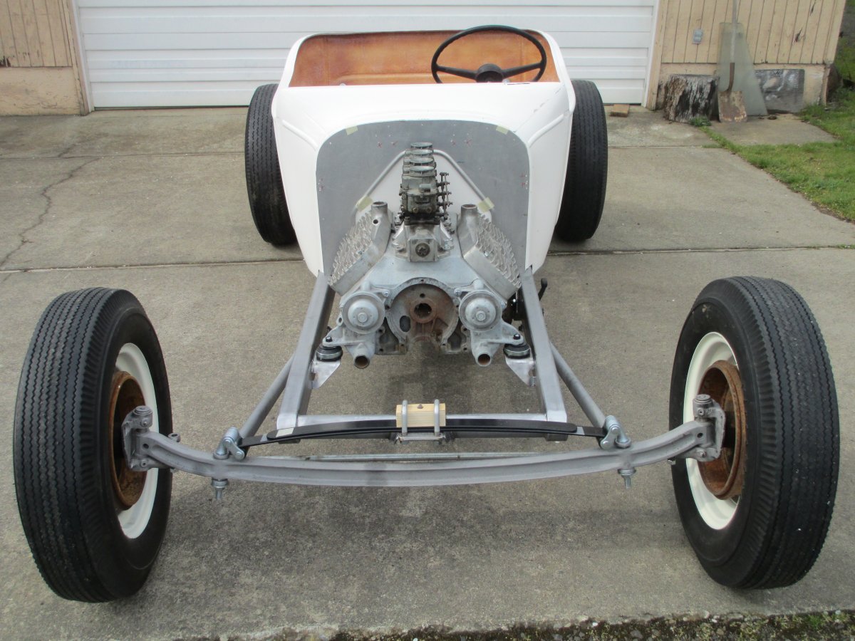

    Great build love the cars. Have you ever checked corner weights or just front & back with that engine set back?
  3. Marty Strode
    Joined: Apr 28, 2011
    Posts: 9,710
    Marty Strode
    Good luck with your project, it's coming along nicely.
  4. Marty Strode
    Posts: 9,710
    Marty Strode

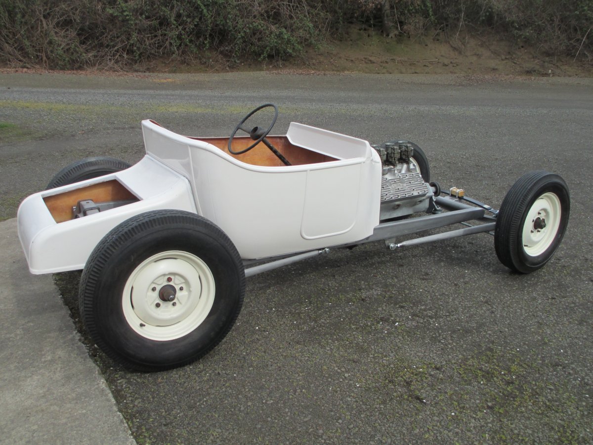

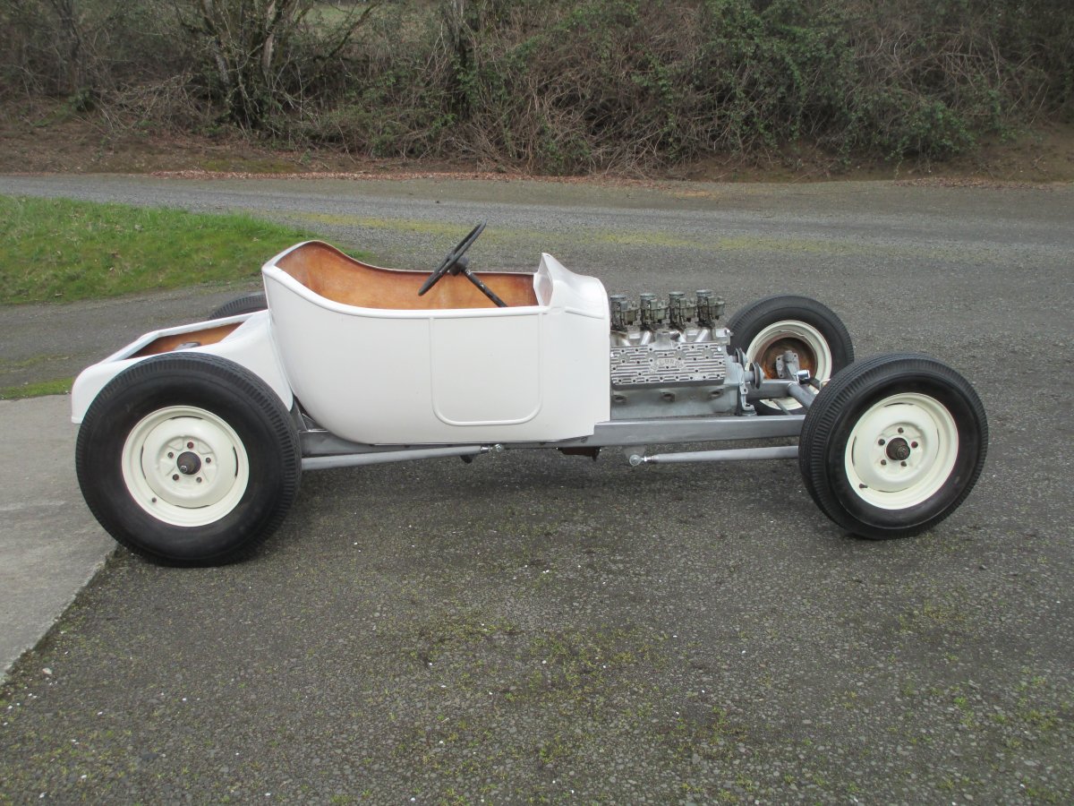

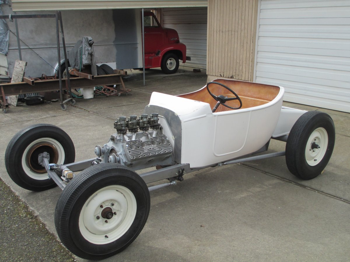

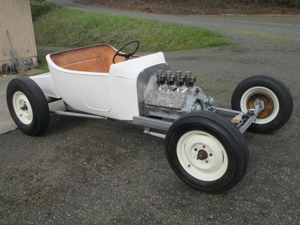

    Mike, to tell the truth, I don't remember putting one of these on 4 corner scales, so I don't have any numbers. On a highway truck scale, my #7 weighed between 18 and 19 hundred. Not exact, because it rounded to the next even hundred, I was told. We did weigh the Spalding Car with me in the seat, not totally complete, but pretty close, and no fluids, IMG_2631.JPG IMG_2635.JPG here are the numbers. Being a 4 torsion bar setup it is very adjustable. Right side heavy in these photos.

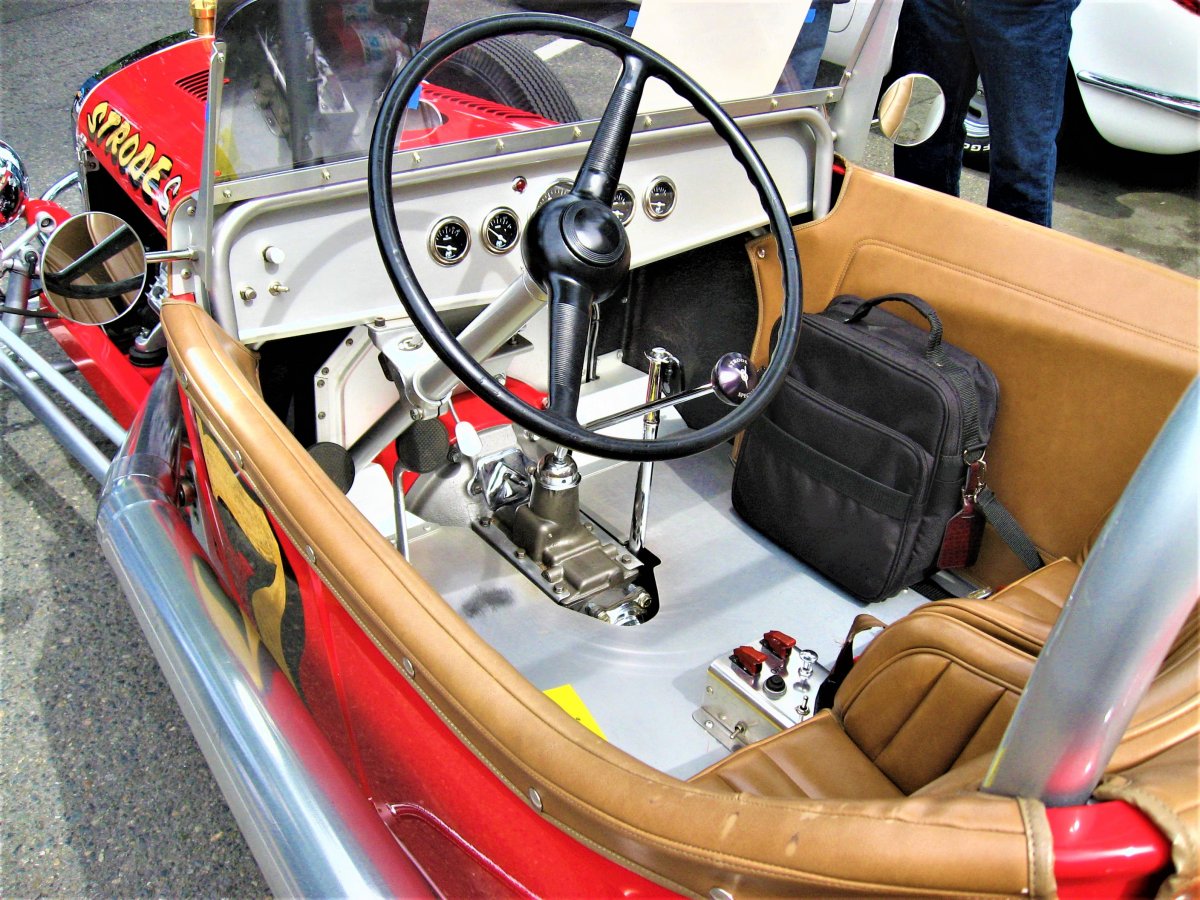

  11. 41 GMC K-18
    Joined: Jun 27, 2019
    Posts: 5,269
    41 GMC K-18

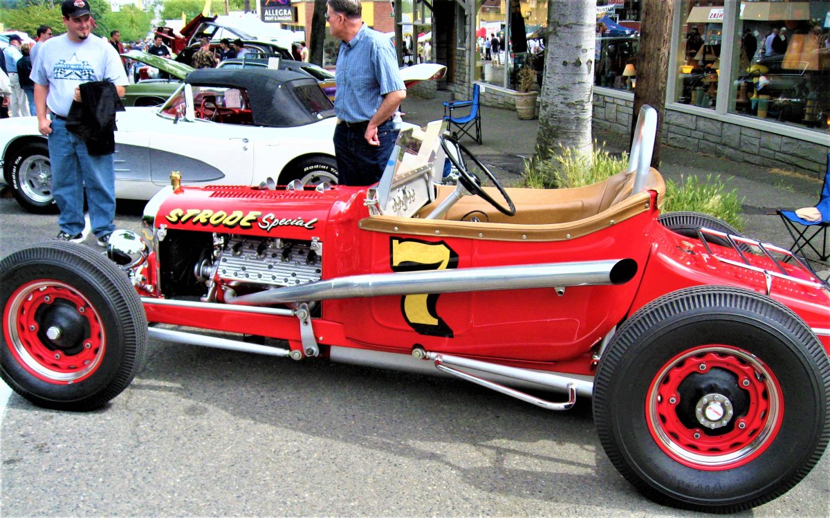

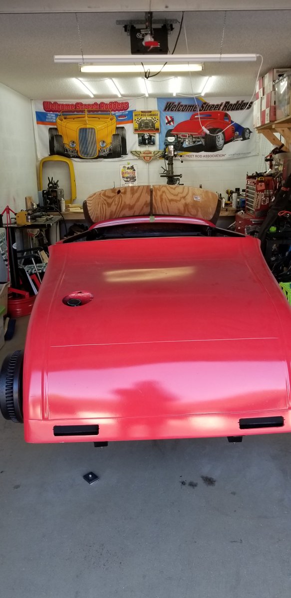

    I always thought that this is a very cool piece of workmanship, flawless indeed! STRODE 1 (2).JPG IMG_1340 (3).JPG STRODE 3.JPG
    catdad49, pitman, Jet96 and 12 others like this.
  12. Marty Strode
    Posts: 9,710
    Marty Strode
    Thanks for posting those shots, old #7 never looked better, and has a great home with the Freeman Family ! The proof is in this video !

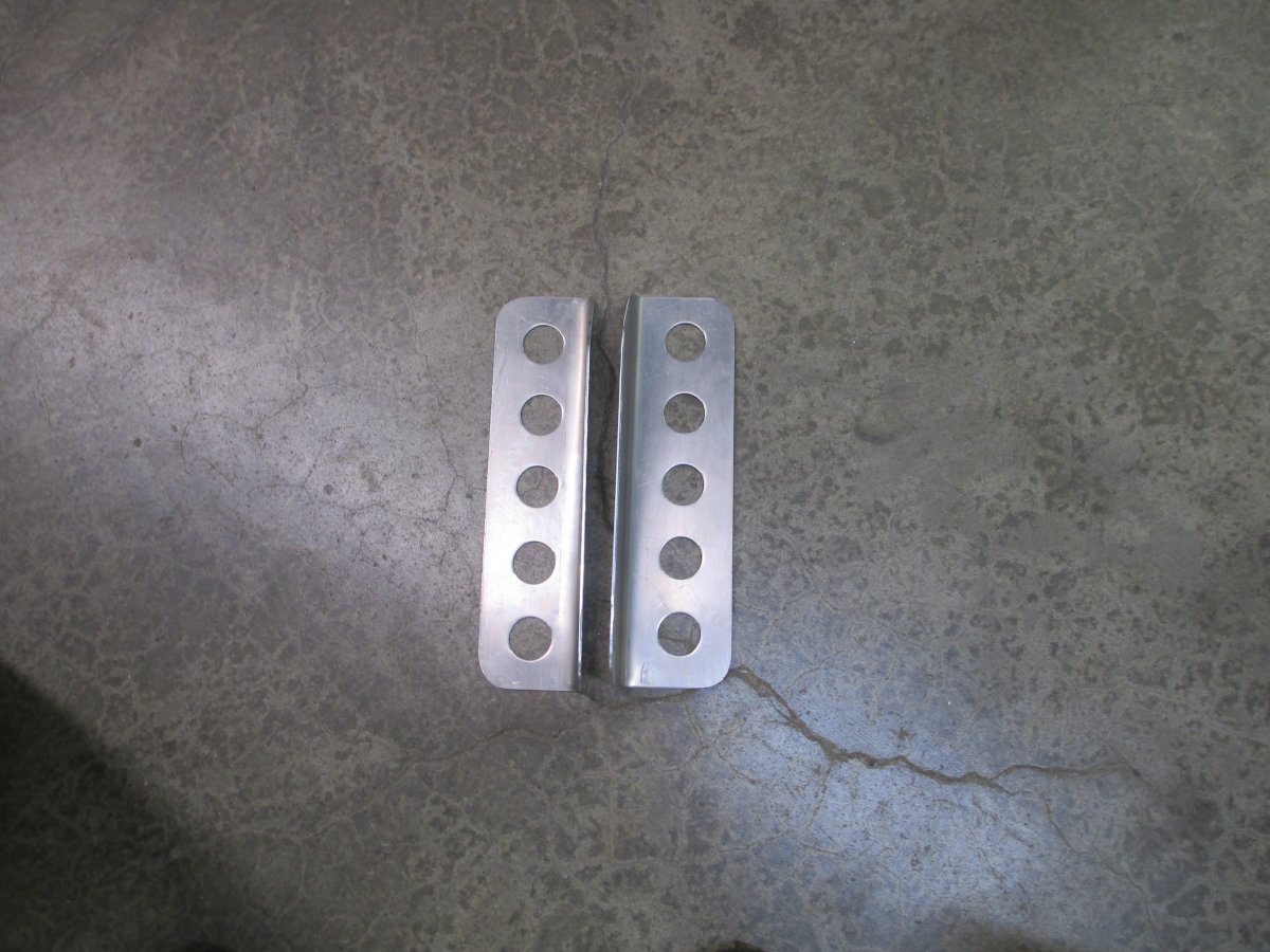

  13. Marty Strode
    Posts: 9,710
    Marty Strode

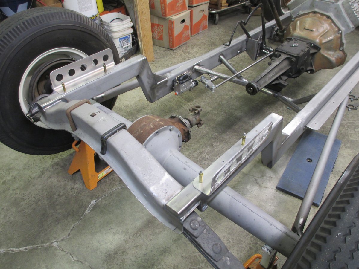

    I am started back on the project, fabbed the turtle deck mounts today, using .090- 5052 aluminum. The bonding work will be done by a friend, a master with fibergl***. The mounts will be secured to the frame rails with (3) 1/4" bolts on each side, via nut certs. IMG_4739.JPG IMG_4740.JPG IMG_4741.JPG IMG_4743.JPG IMG_4745.JPG IMG_4746.JPG IMG_4747.JPG

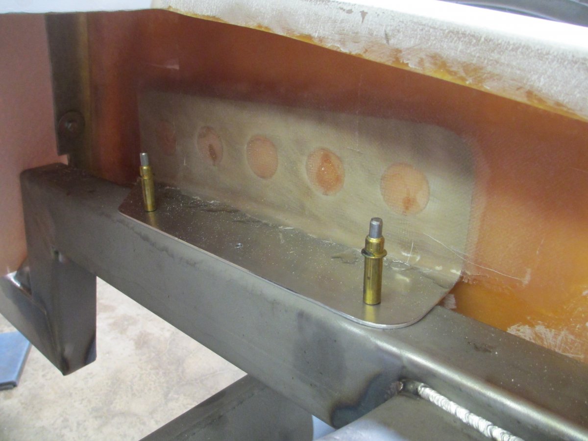

  16. Marty Strode
    Posts: 9,710
    Marty Strode
    My friend Leighton found the time to laminate the turtle deck mounts to the body. He uses a product called Peel Ply, a release agent he applies to the final coat, leaving an incredibly smooth surface. The exhaust parts for this project and the RPU should be here today, so there will be more progress soon ! IMG_4751.JPG IMG_4756.JPG IMG_4757.JPG IMG_4759.JPG IMG_4758.JPG IMG_4762.JPG

  22. DDDenny
    Posts: 22,562
    Marty
    I made this aluminum trunk riser for my roadster with plans (still not done) of gl***ing the flanges to the fibergl***, wasn't real jazzed about it so I called Carl Wescott and asked his thoughts and he said to use a Methacrylate adhesive specifically for bonding dissimilar materials, by my memory he said they use one of these from Devcon/Plexus.
    https://itwperformancepolymers.com/products/plexus
    catdad49, dwollam and OFT like this.
  23. Marty Strode
    Posts: 9,710
    Marty Strode
    Doug, that turned out real nice. I took the approach of the way Funny Car bodies were mounted. With the large holes, the bond was fibergl*** to fibergl***, with the the metal sandwiched between. It's been working very well. You took the correct route for your application. Take care,old friend.

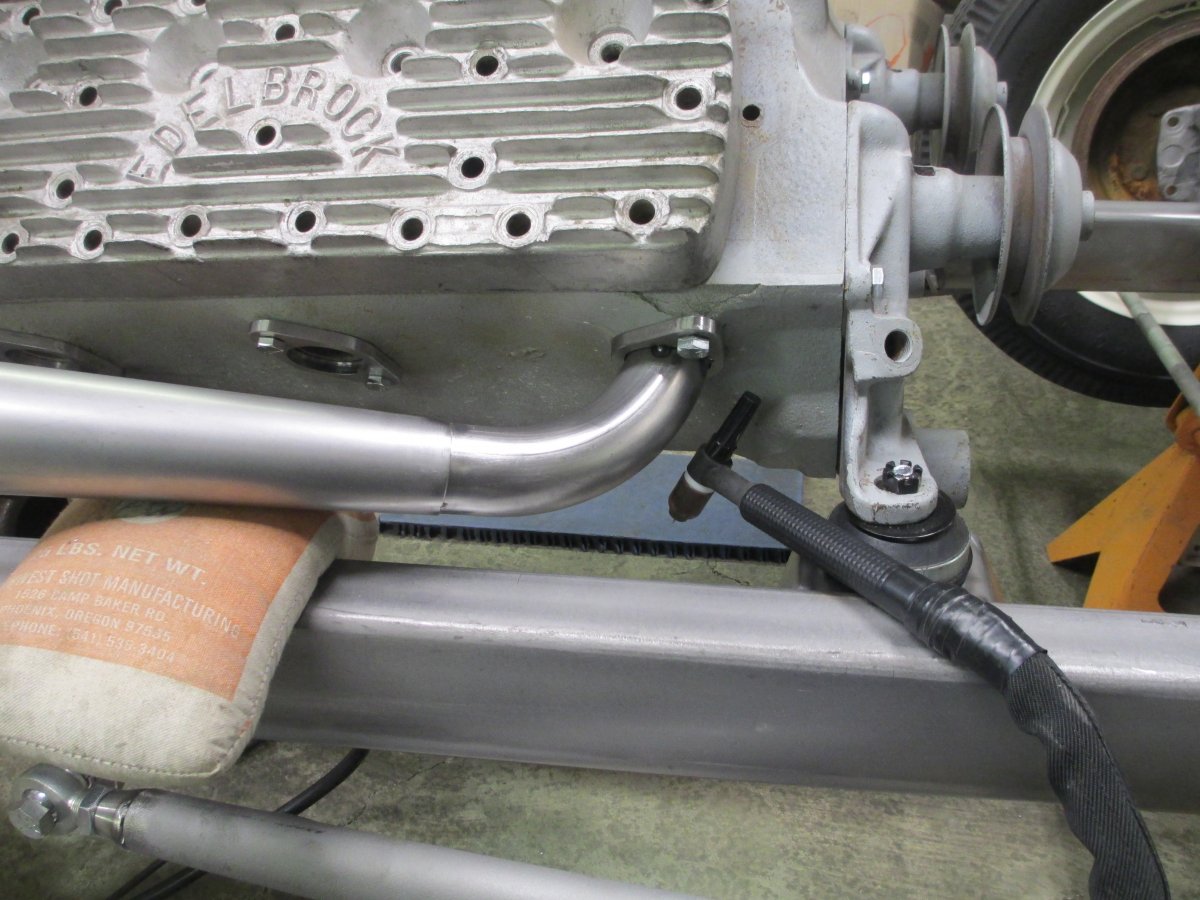

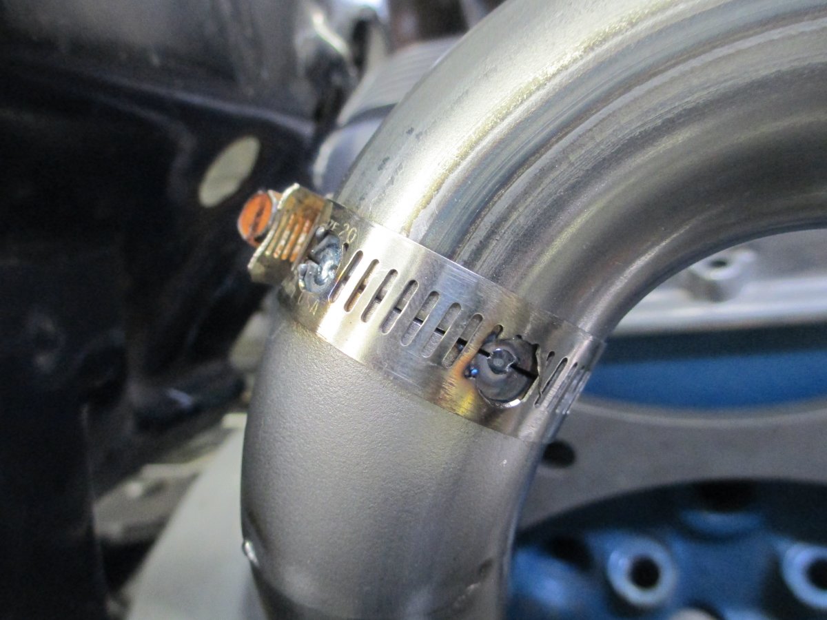

    Worked on the rest of the pipes today. Once I get the u-bends sawed, coped, and fit up, the knotted wire wheel does a nice job de-burring the inside. I use lacquer thinner and paper towels, along with the ram rod treatment, to clean the grease from the mandrel bending process. After tack welding the 2 piece tubes together, I mock up the ***embly to mark the holes in the megaphones, to rough cut them with a plasma cutter. Now for the final fit on the driver side. IMG_4799.JPG IMG_4800.JPG IMG_4802.JPG IMG_4804.JPG IMG_4805.JPG IMG_4806.JPG IMG_4821.JPG IMG_4822.JPG IMG_4824.JPG IMG_4825.JPG

    I noticed you used a SS hose clamp with a couple holes in the strap to line up two tubes with the hole giving access for placing a tack weld. I've used that method too and it's a cool way to line things up and the cost is almost nothing. Maybe you've pointed it out before on other builds, but thought it was worthy of drawing people's attention to it who might have the need to do likewise.
    Nice work.
    Lynn
  29. Marty Strode
    Posts: 9,710
    Marty Strode
    Lynn, looks like great minds think a like ! On a serious note, this is what I showed on the RPU build, certainly a major ***ist while building headers. IMG_4768.JPG IMG_4770.JPG
