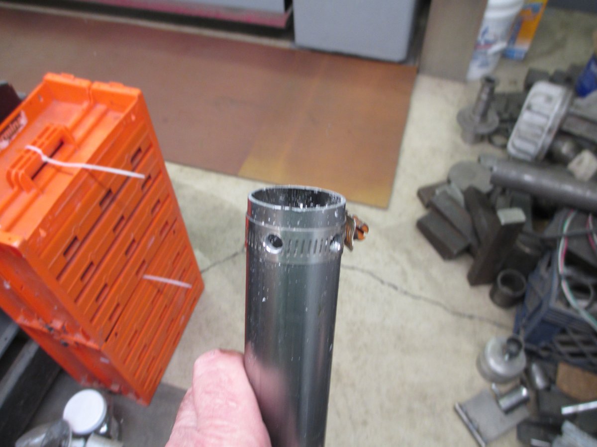

    Looking at your hose clamp, wondered if you drill the hole or ? I am trying to figure out how you hold it while drilling. Will a drill press vise hold it? Seems a bit scary to me:eek:
  6. lake_harley
    Joined: Jun 4, 2017
    Posts: 2,419
    lake_harley
    I won't try to answer for Marty, and I really can't remember how I got holes in the SS hose clamps I used to tack tubes, but one idea would be to tighten the clamp on a length of tubing and then clamp the tube secure to hold it while drilling the hole through the clamp strap using the tube as a "base". That would minimize the clamp from getting snagged by the drill bit and getting twisted or slung around. Since it's SS, a good, really sharp drill bit is required.

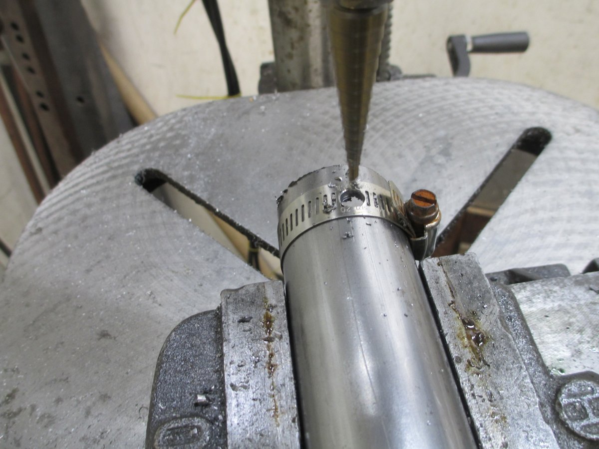

    Bruce, I showed this on the RPU Thread, and I don't usually use current buzz phrases, but here goes, a Harbor Freight step drill, makes it "Easy Peasy". IMG_4765.JPG IMG_4766.JPG

    I don't know how I missed that. I usually study all your pics pretty thoroughly. That is a very slick way to do it. I could imagine twisting it all up trying to hold it in a drill press vise.

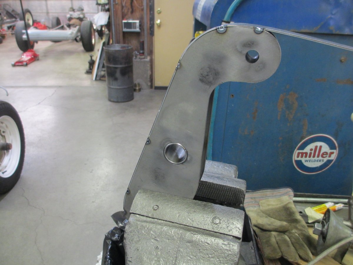

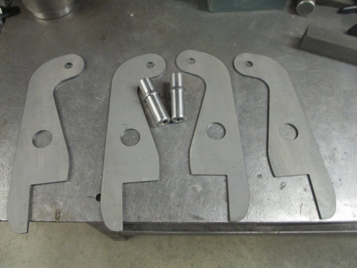

    I worked on the front shock towers today, that also serve as bumper and headlight mounts. This process is a derivative of the the ones that I built for Dwarf Cars, numbering in the hundreds. Having some of the laser cut plates, along with CNC bumper bungs in stock, certainly saves time. A u-shaped bracket, welded to the wishbone will be the lower shock mount. IMG_4865.JPG IMG_4866.JPG IMG_4868.JPG IMG_4869.JPG IMG_4870.JPG IMG_4872.JPG IMG_4873.JPG IMG_4875.JPG IMG_4880.JPG IMG_4882.JPG

    Those are some cl***y looking shock mounts! I like the use of a socket to pull the outer skin into the inside radius for welding.

    Graham, the tough part is keeping the boxing strip centered during all of those inside, and outside curves, in the 21" of length. A bit of a challenge, always makes it fun !

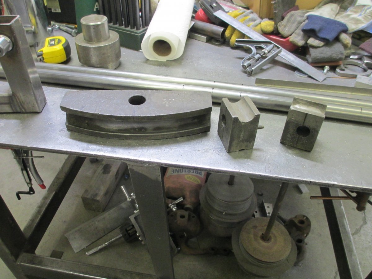

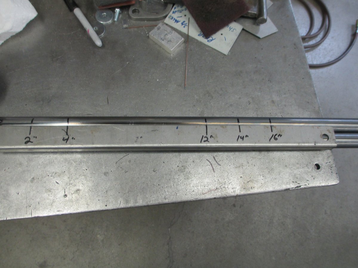

    Now for the front bumper/nerf bar. I have a tube roller, but the "feed along"die in the bender has served me well, and I had the layout and fixture for the fabrication. Lots of steps, but the coping of the curved upper bar, takes the longest. IMG_4891.JPG IMG_4892.JPG IMG_4893.JPG IMG_4895.JPG IMG_4896.JPG IMG_4900.JPG IMG_4903.JPG IMG_4904.JPG

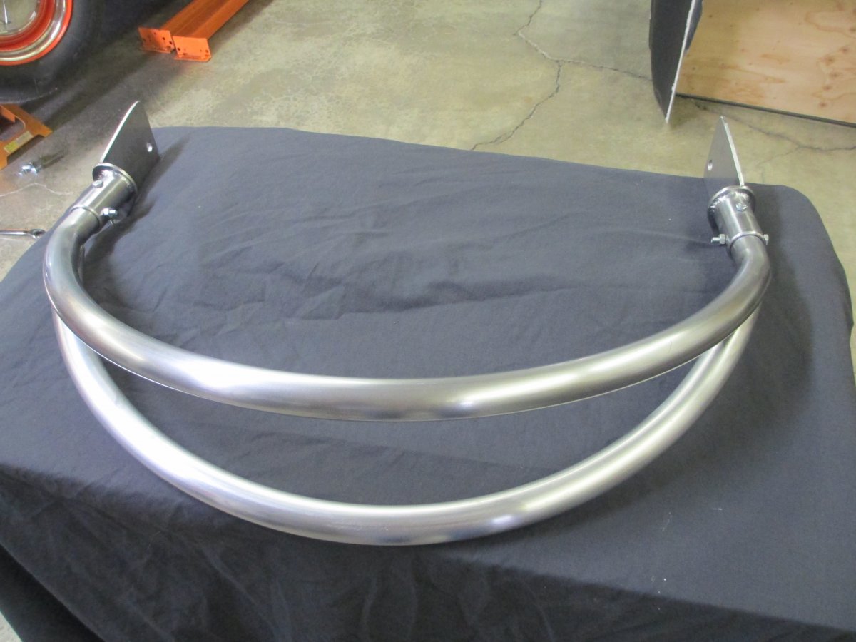

    Some shots of the rear fit, and mounted on the car. Once we decide on what design will be in the center, post, letter, or other, I will re-install it in the fixture and complete the welding. IMG_4906.JPG IMG_4910.JPG IMG_4912.JPG IMG_4914.JPG

    That's magic!

    Put an "M" in the middle of the nerf bar - when people asks if it stands for "Marty" or "Magic" just smile and walk away.

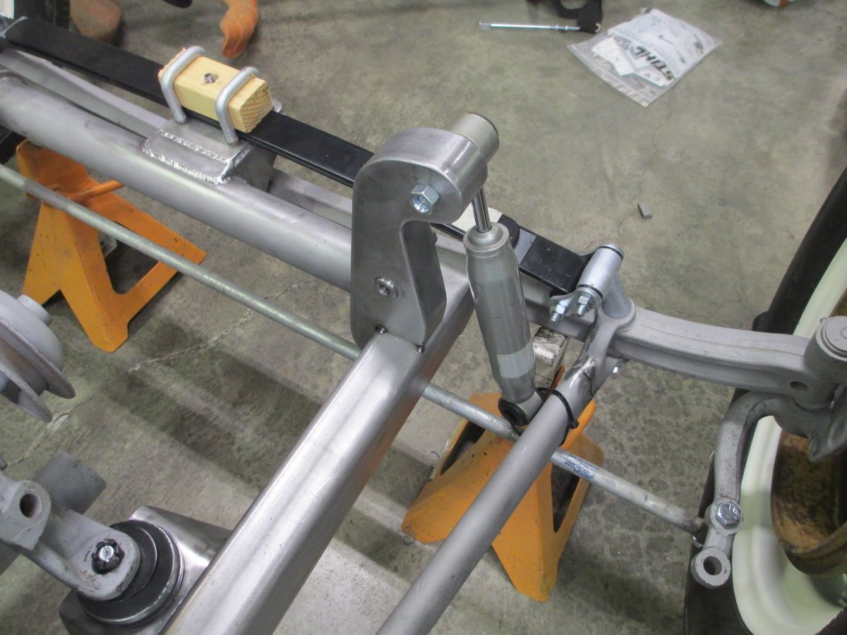

    I really like the shock brackets. Did you consider putting the shock in between the plates in double shear, or is that too street roddy?

    Very cool! I'm also a fan of the feed-along tooling. I have a few different dies for my Hossfeld. I haven't used a roller much, but these make more sense to me, much easier to put bends where you want them in a length of tube. The bad part is needing different dies to make big changes in the radius...though after I talked about how to use them with Rollie at Hossfeld, each die does a pretty big range of radii.

    Bruce, when I used a similar tower on the Dwarf Car front suspensions, the coil-over shock was nestled between the plates, but that was carrying the weight of the car. In this case, I moved the the shock to the front side, to be closer to the axle, for more control. Another reason is, with the angle of the radius rods, moving it back, stands the shock up straighter, and is more crowded in that area. Also, there would be more of a conflict between the shock and the slingshot, bolt-on headlight mount. Plus, I like the shock more exposed, from a visual standpoint. If you look close, you can see the headlight bracket in this photo, with the three AMBR winners. This shot is # 7's first outing at the '98 Portland Roadster Show. I always enjoy your questions Bruce, keep them coming. img20200604_0006.jpg

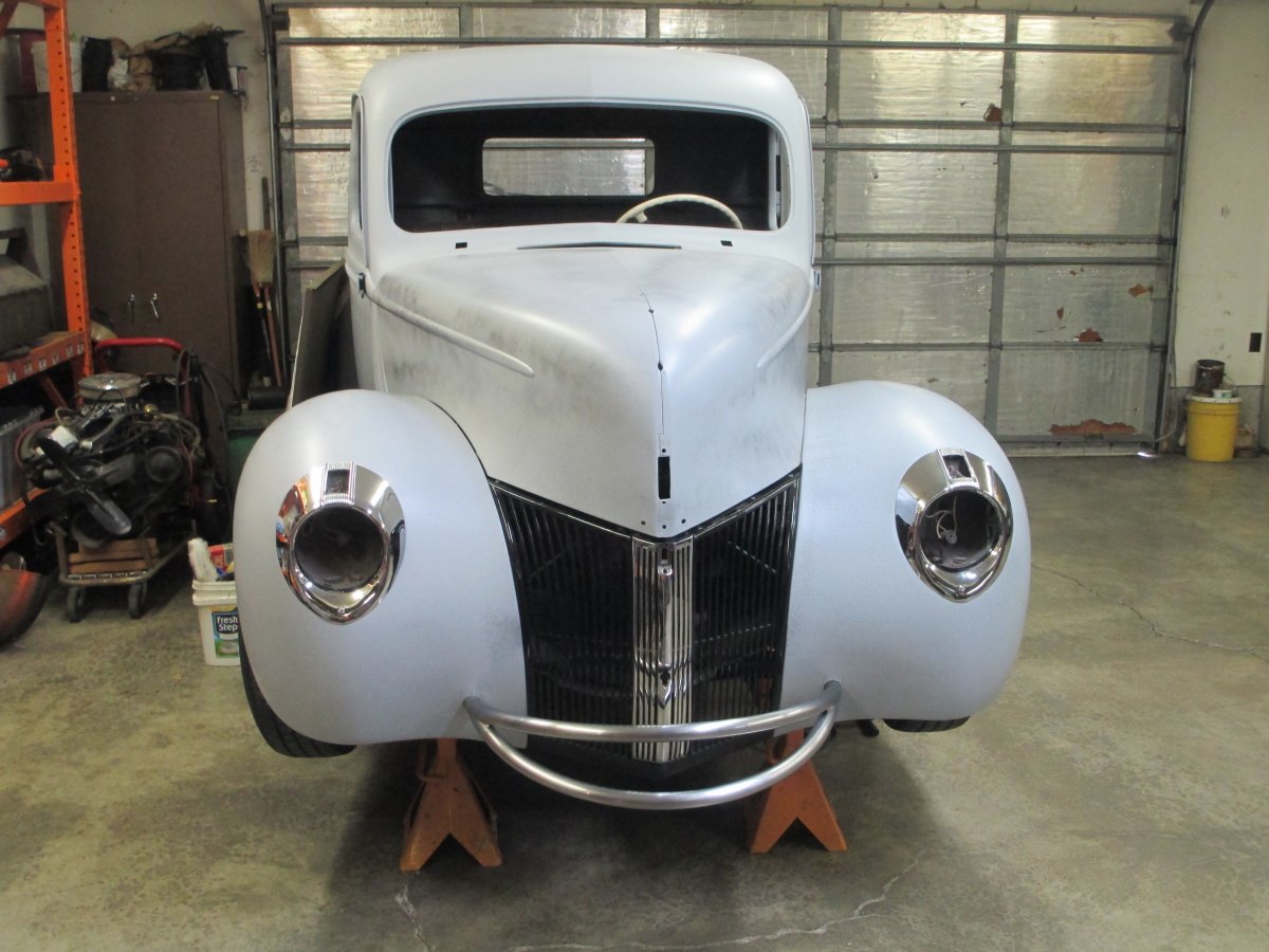

    Graham, those feed-along dies make an amazingly smooth bend, considering those hoops have 17 bends in each one. I have a HF roller, with Swag dies, and used it when I did the bumper for my '40 pu, mainly because it needed to be 1-1/4" for proper proportions. IMG_1206.JPG IMG_1207.JPG

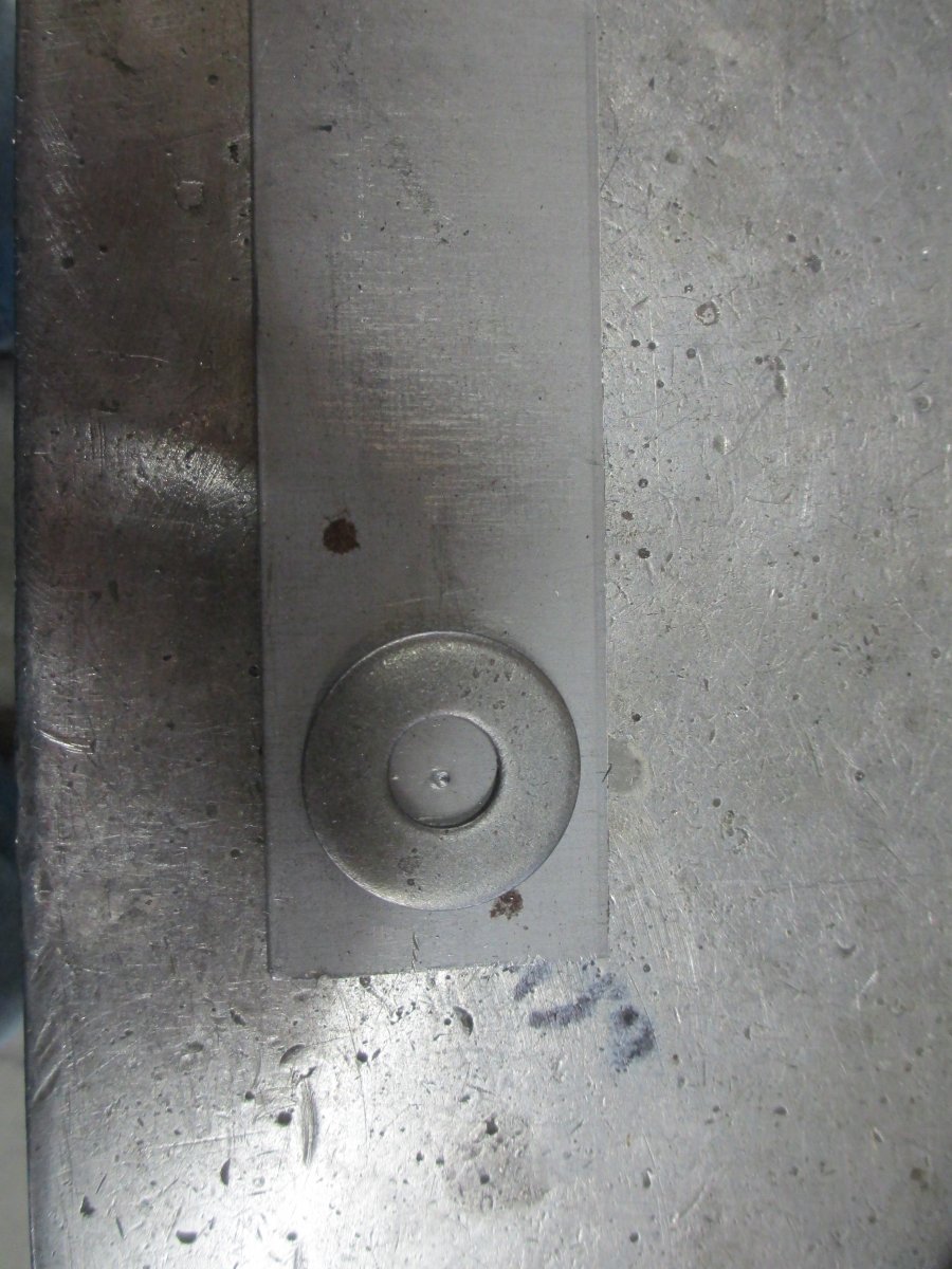

    The lower shock brackets are tacked in place. Using 10 ga with a 7/16 plain finish cut washer added to double the thickness, around the lower bolt. Rather than cut and weld flat plate brackets, I like bending, and t******* most of the foot off, to add a slight curl the joint, for looks I guess. Also, during setup I always use thin spacers between the brackets and what is bolted, to make clearance for paint and ease of ***embly. IMG_4962.JPG IMG_4964.JPG IMG_4966.JPG IMG_4969.JPG IMG_4970.JPG IMG_4973.JPG IMG_4974.JPG IMG_4976.JPG IMG_4977.JPG

  29. Once again when I’m looking at your build I learn a trick, I would have never thought of using my fab magnets to keep my soft parts out of the spinning wheel of death!

    I added that photo for just that reason, the magnet comes in handy using the belt sander as well, I like my fingernails right where they are !
