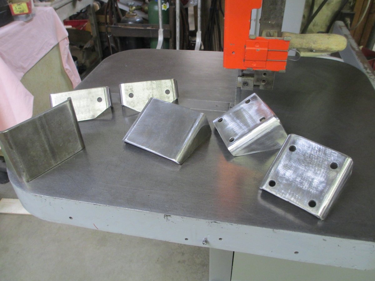

    Working off templates, I drilled and sawed out the 4 base brackets for the roll bar mountings. Also the platforms to carry the upper rear shock/ rear bumper attach points. Next week, bending and installing the roll bar, and fab the rear bumper, is the plan. IMG_4978.JPG IMG_4980.JPG IMG_4984.JPG IMG_4987.JPG IMG_4989.JPG

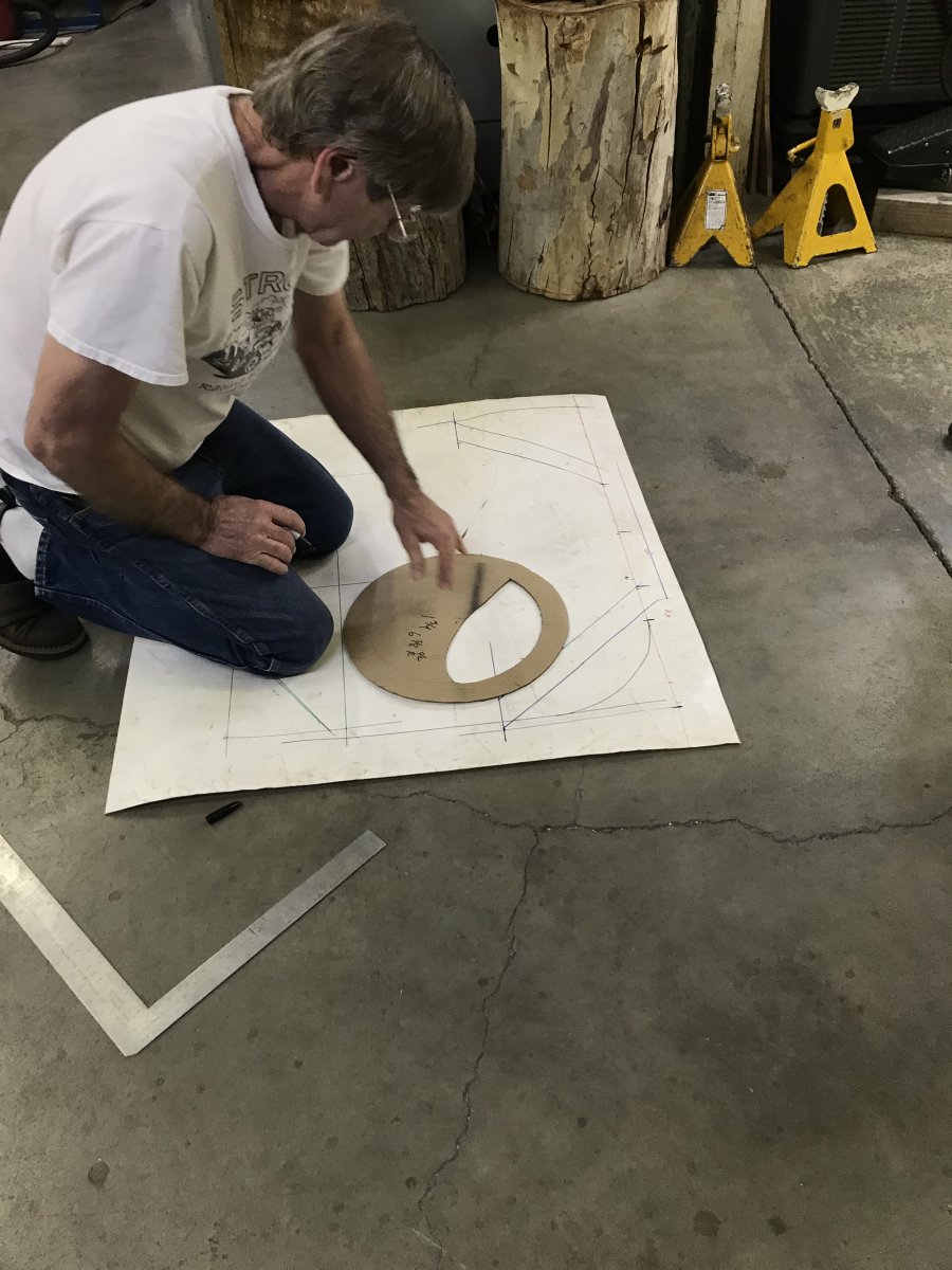

    I hate to admit making a mistake, but it's such a rare occurrence, I will still put the best face on it. Having not used most of the templates for this car, in 15 years, I got confused on the brackets for the rear of the roll bar mounting. The template with "roll cage base" didn't jive, as it should have been "roll bar", and the template on the far left in the first photo, is the one I used making the base brackets a couple of weeks ago. I could't find the paper tracing pattern, to make the cutouts in the body for the roll bar to drop through. My body man friend who owns one of the Roadsters, is doing the final prep for paint on my '40 pu, and I needed to deliver some parts, so I planned on taking a paper template off of his car. To my surprise, the mounts on his car were the size of the roll cage plate, (smaller), and it hit me, I had mounted a roll cage in #7 in it's early fabrication stages, hence the wrong labeling of the template. So I came home and made the correct base mounts, with plates, and will install the roll bar, early this week. If I don't hustle and get this thing finished, I might be wearing "paper slippers" before it is done ! IMG_5055.JPG IMG_5056.JPG img20161106_16190320.jpg

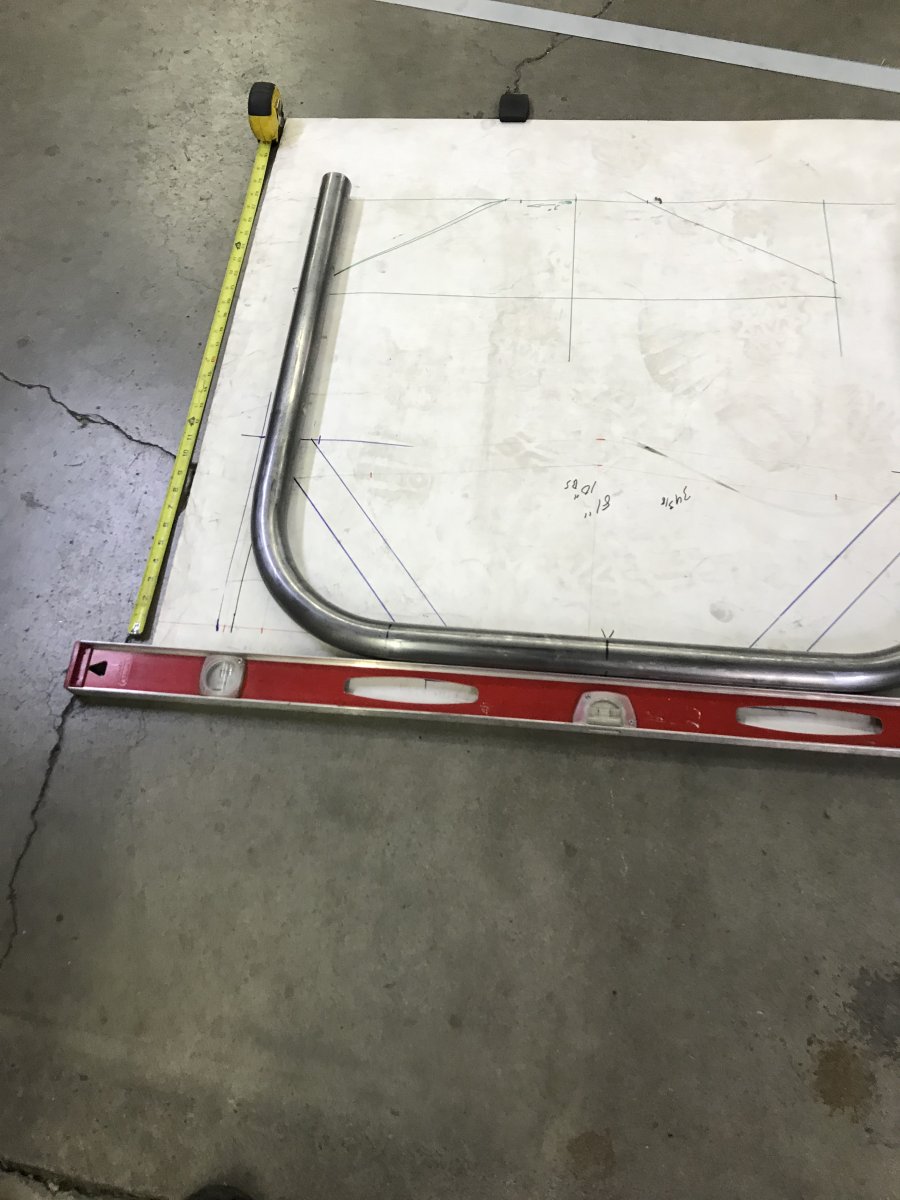

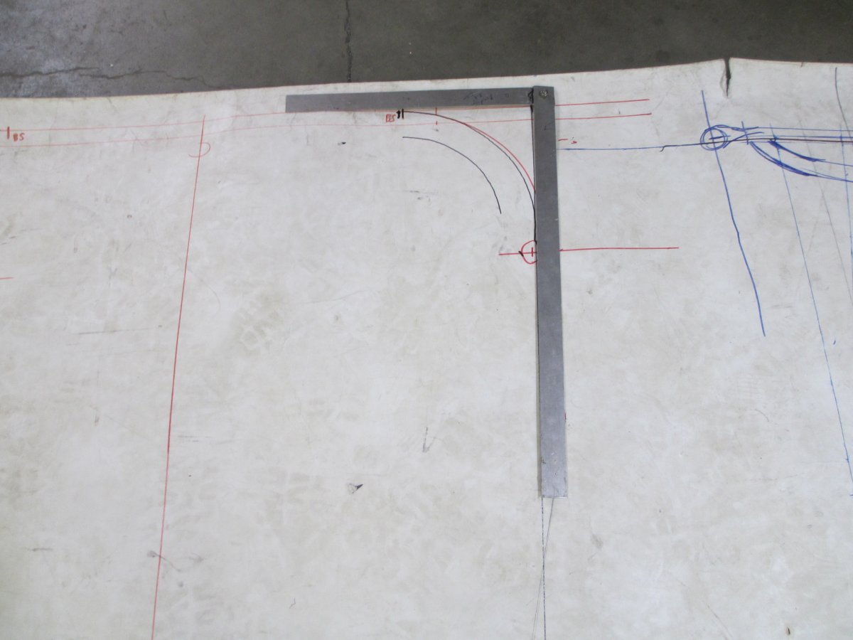

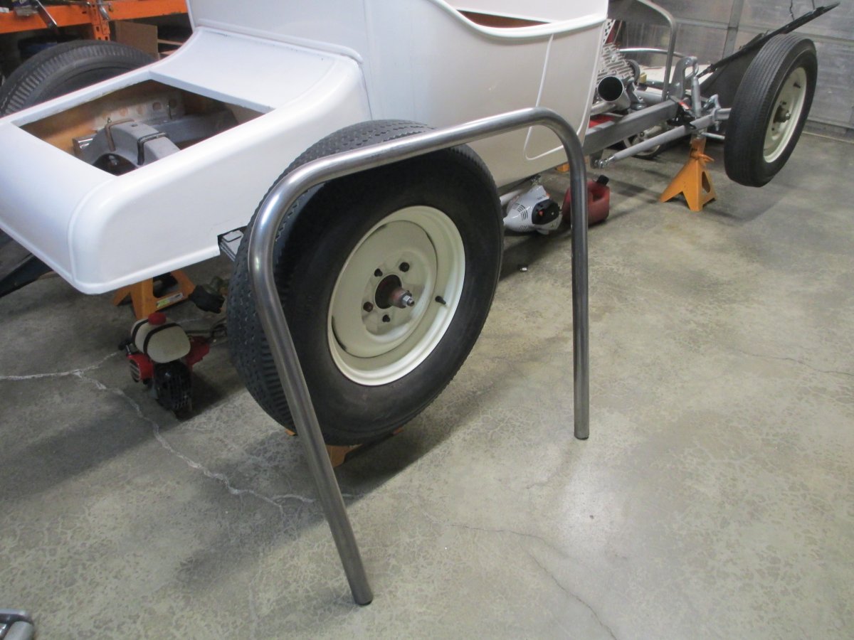

    OK *****, you built a fire under me. I laid out and bent the roll bar today. Starting with a half layout, on my well used white paper. Material, 1-3/4".120 wall ERW. Side bars soon. IMG_5113.JPG IMG_5116.JPG IMG_5115.JPG IMG_5117.JPG IMG_5118.JPG IMG_5120.JPG IMG_5122.JPG
    Graham08, dwollam, Hotrodmyk and 10 others like this.

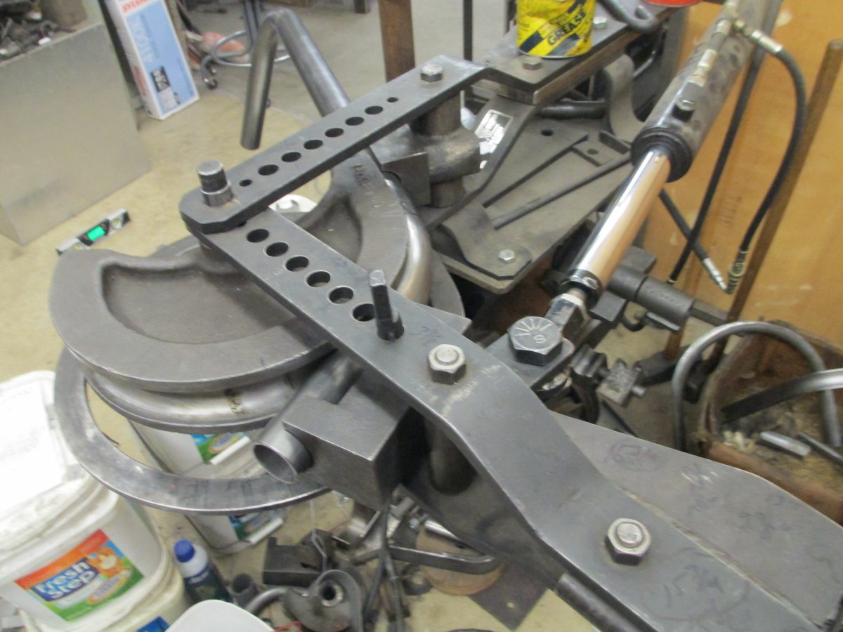

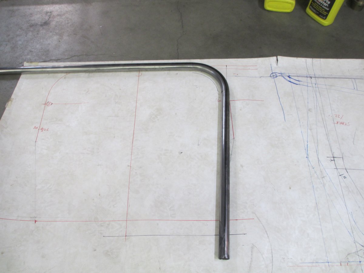

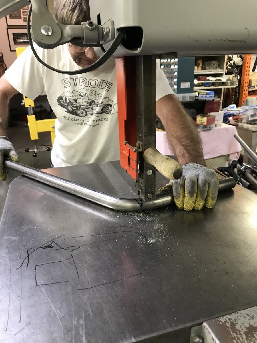

    Bent the side bars today. I saved a pattern that I made out of exhaust tubing, along with some notes concerning bend starts, and ram extension measurements. To allow for the clocking of the 2 bends, I installed the sample in the bender, with one bend in the die, and record the angle. Just have to remember to bend RH and LH bars. Should get it installed in a day or so. IMG_5123.JPG IMG_5124.JPG IMG_5125.JPG IMG_5126.JPG IMG_5127.JPG IMG_5129.JPG IMG_5130.JPG IMG_5131.JPG
    Stogy, Gotgas, Graham08 and 6 others like this.

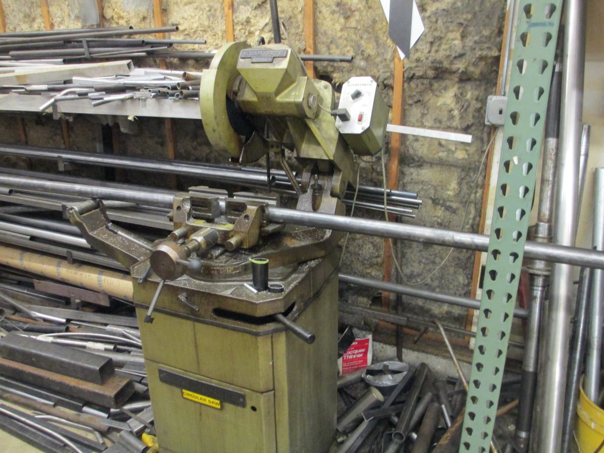

    Dean, my Brother Tom had 2 cats, and furnished me quite a supply of buckets. Most of those buckets store remnant pieces of round tube, sorted by size. The funny thing is, I hardly ever even look in them. Just hate to throw anything way. Sadly, all of my cats and dogs have p***ed, too old to get more.

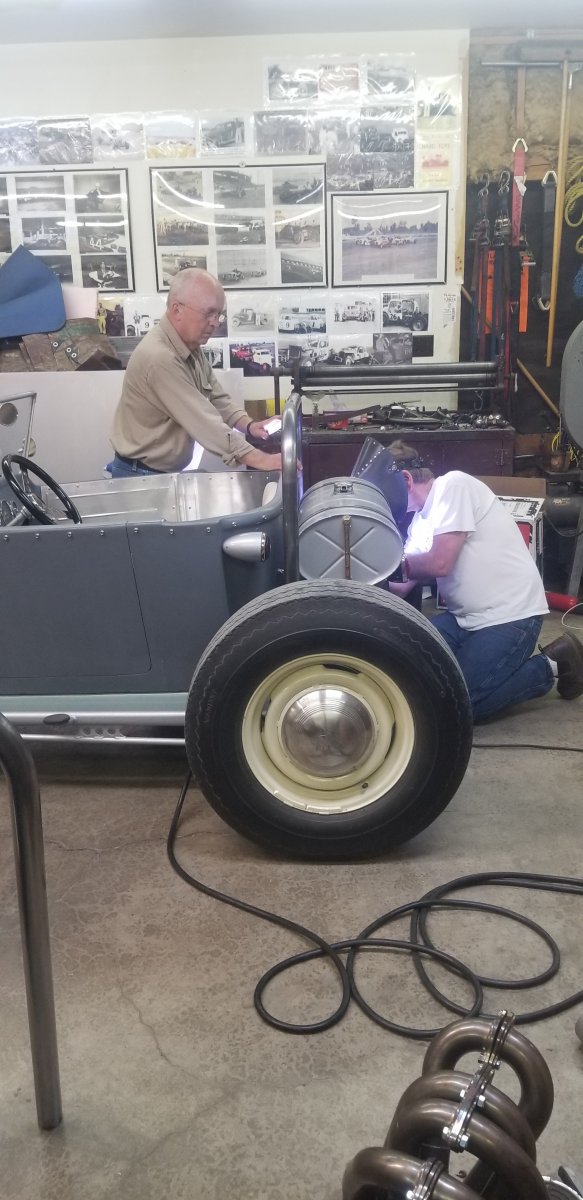

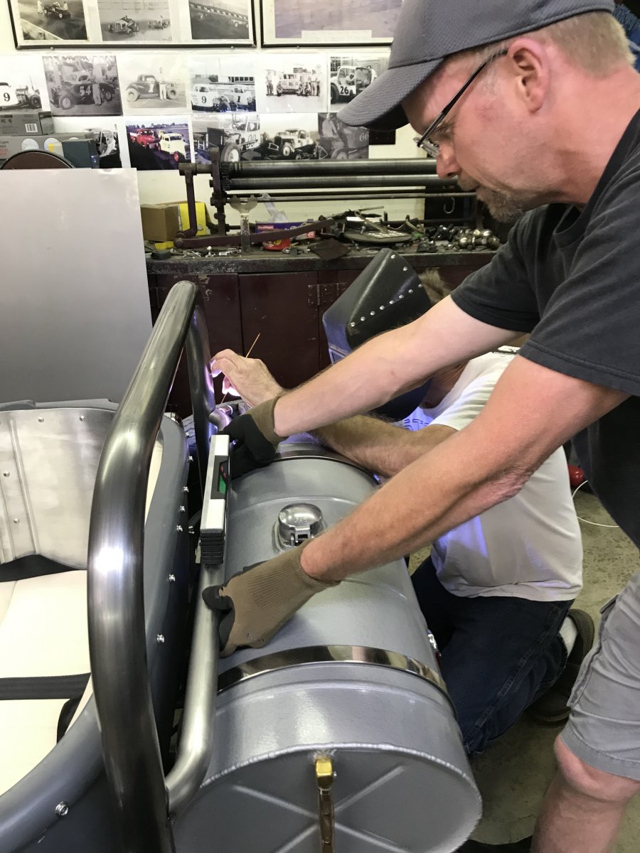

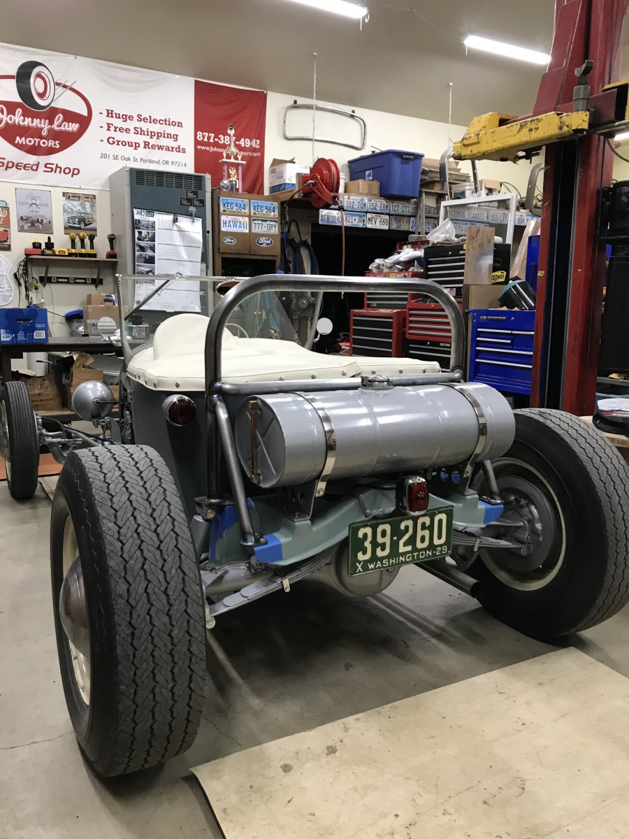

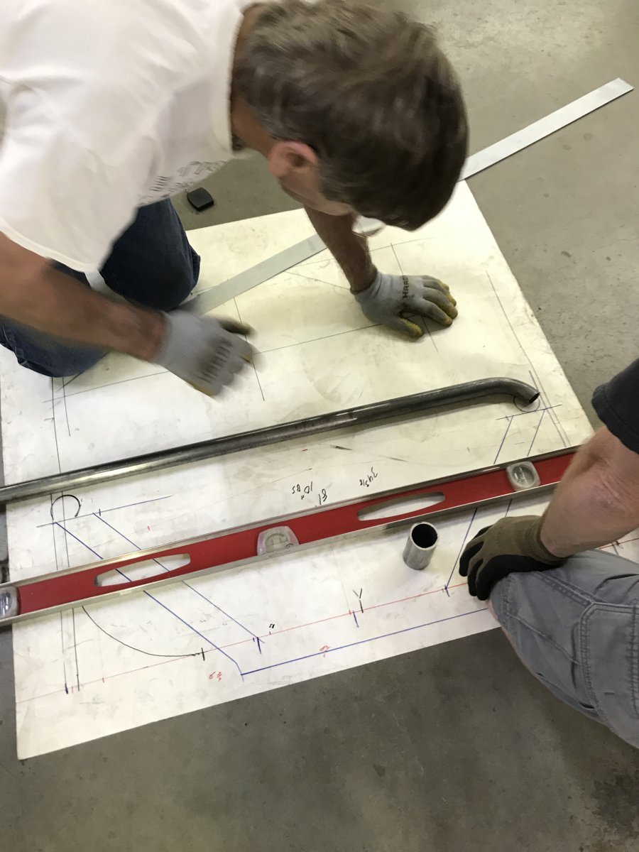

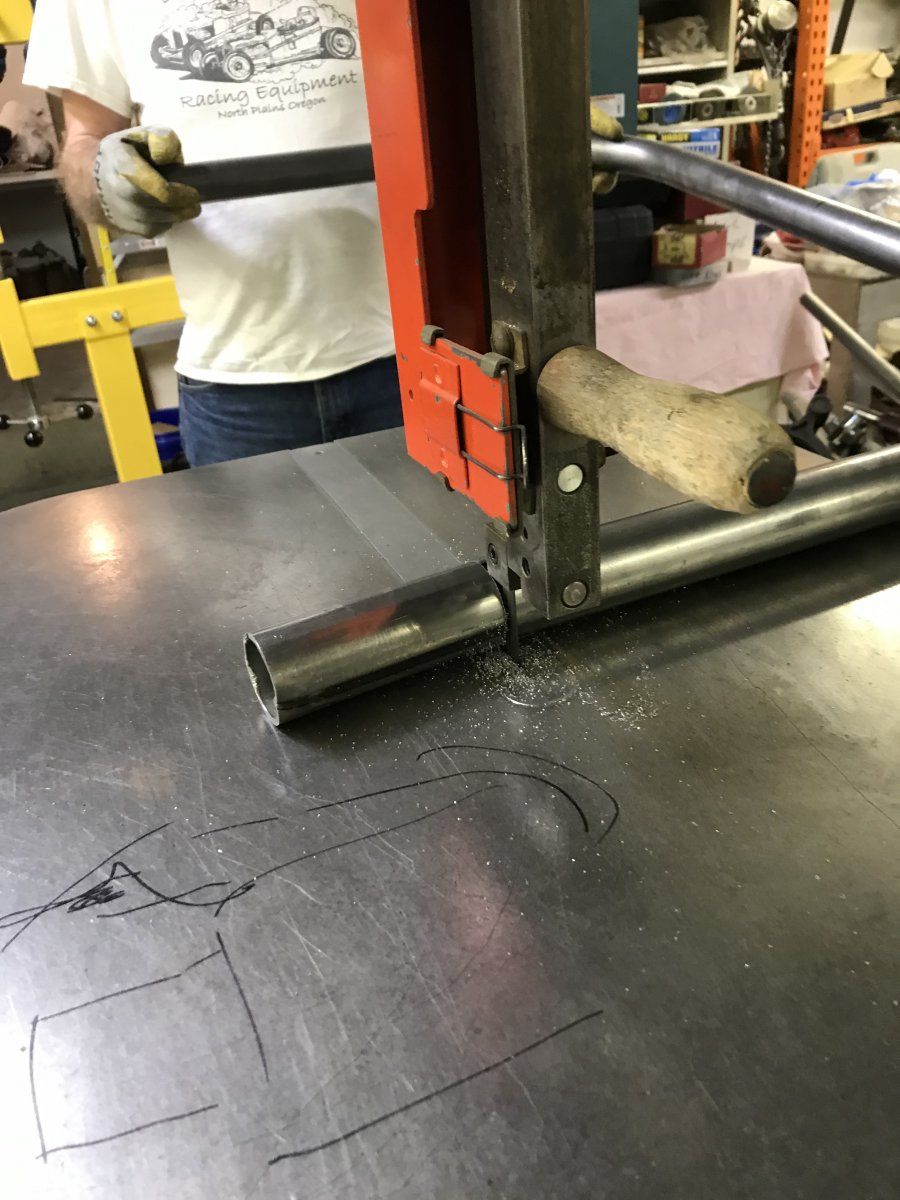

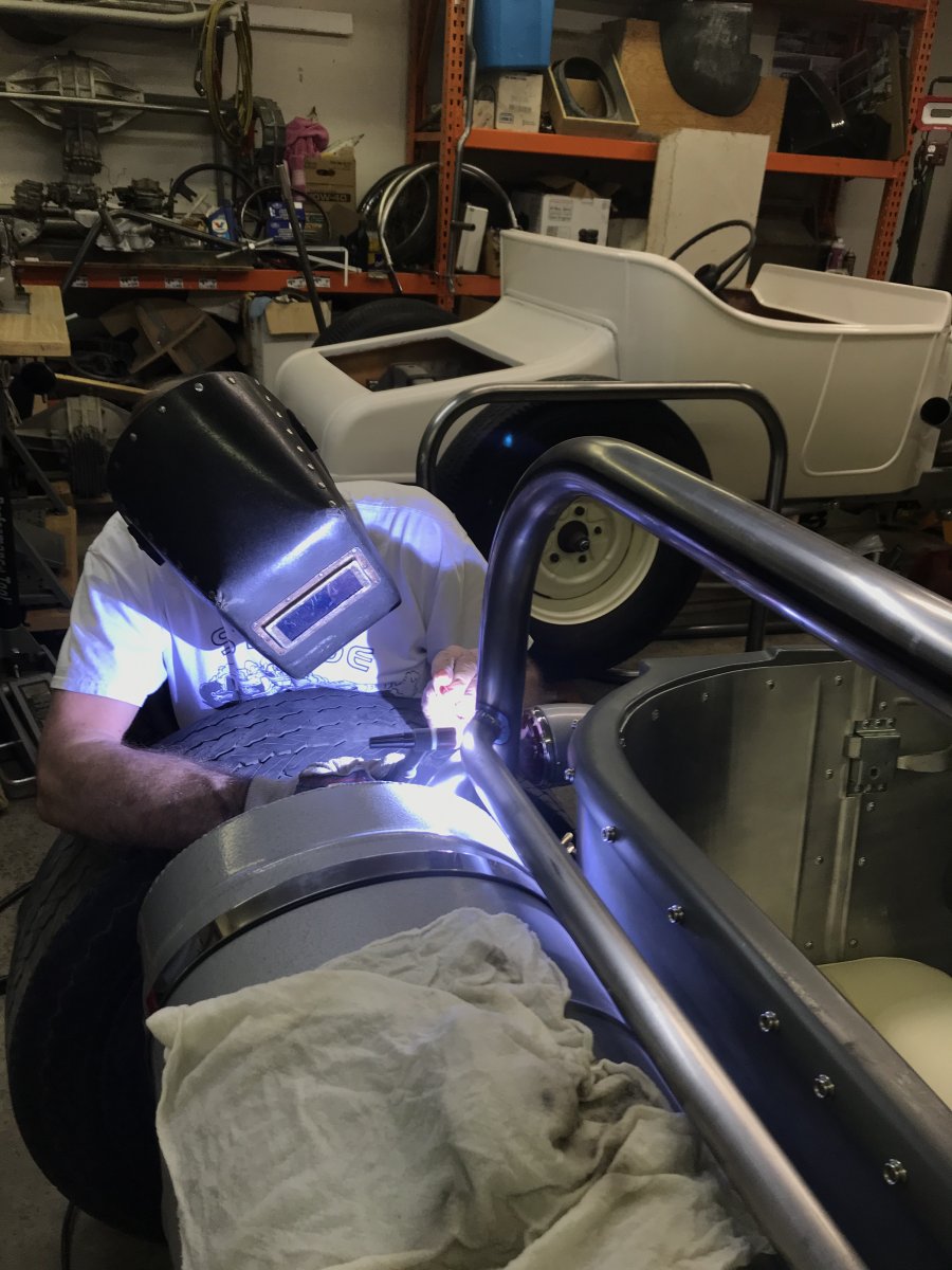

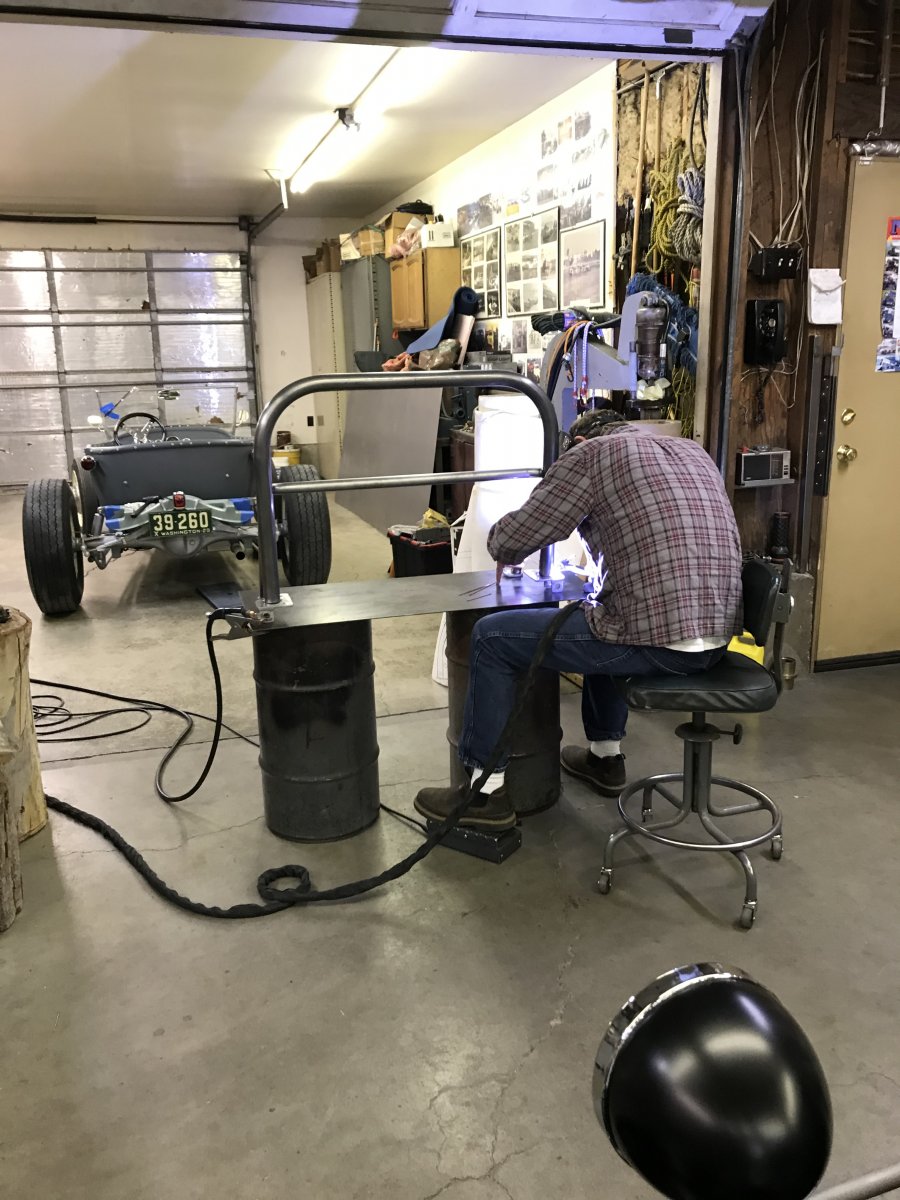

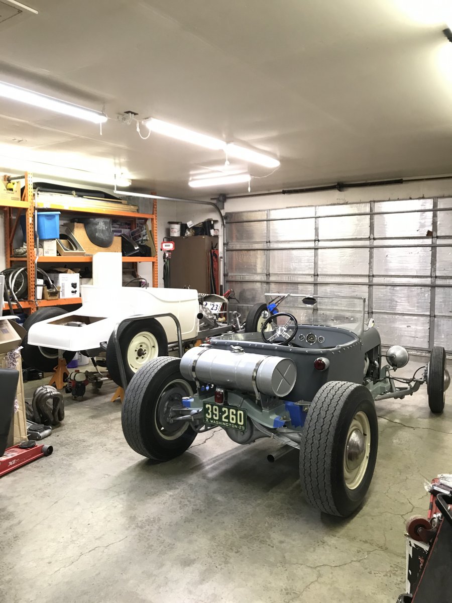

    With Marty's permission I'm posting some photos here from yesterday. Sorry they are somewhat out of sequence. My brother Erik and I had the privilege of spending the day at his shop to fab and install the roll bar for my avatar. He allowed us to work right along with him, sharing his knowledge and tricks. We are very appreciative for this as he certainly is a master craftsman as you all know.
    Rich
    9am
    Marty at the layout table....my knees hurt watching him kneel on the floor!
    Final welding
    Back home at 4:30
    My only wish is that we were a bit closer, 60 miles one way.
    Thanks Marty for taking the time with us!
    ps. I'm extremely happy with the roll bar as it adds so much to the character
    of the car.
