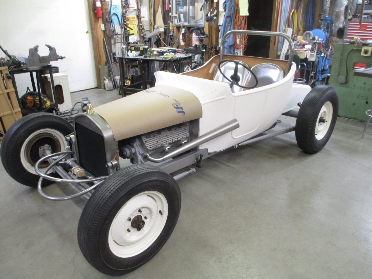

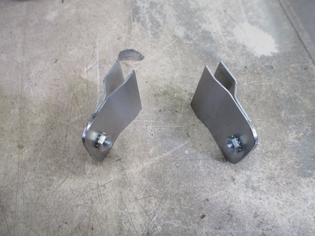

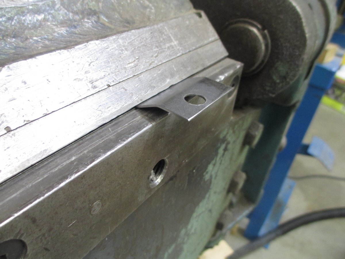

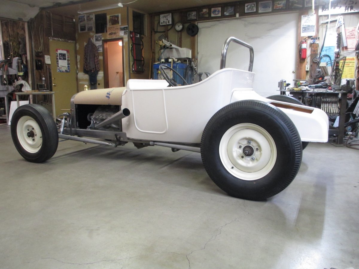

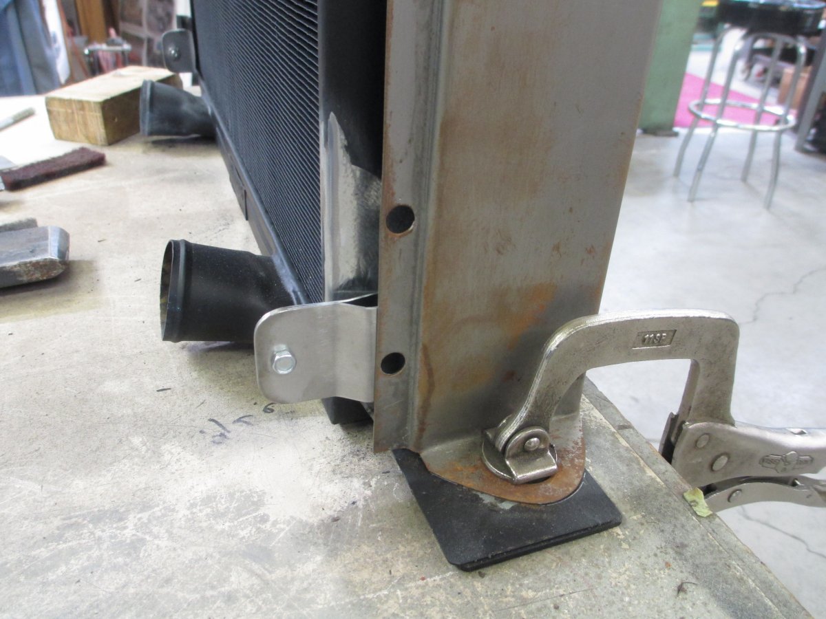

    After a long hiatus, I have started back, first by mounting the grille shell to the radiator. Then, set it in place, mock up, and make the hood pattern. The grille shell brackets are 18 ga cold rolled steel, and weld to the shell and the radiator. The upper mounts will also carry the front hood latches. IMG_5817.JPG IMG_5818.JPG IMG_5819.JPG IMG_5823.JPG IMG_5826.JPG IMG_5828.JPG IMG_5829.JPG

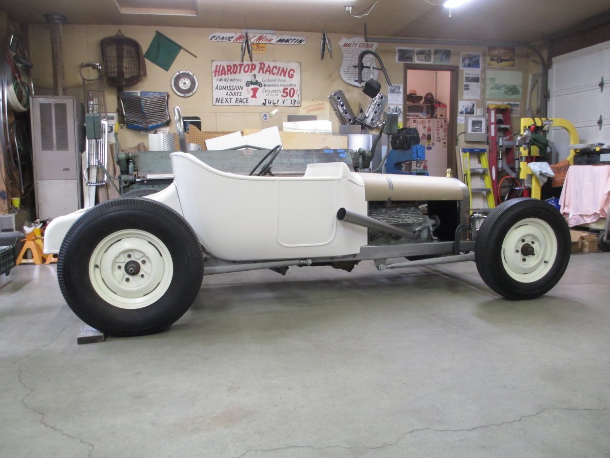

    Since my progress is slow, I uncovered some pics of #7 when it was new, thought I would share them. I really enjoyed shooting pics with a Pentax with real film. The last one is my old buddy, Spike Parham, lettering the hood. img20201215_0030.jpg img20201215_0031.jpg img20201215_0032.jpg img20201215_0033.jpg img20201215_0035.jpg
