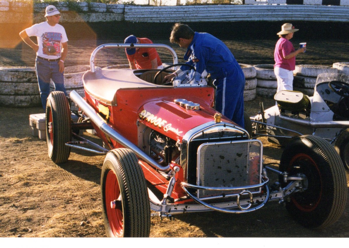

    And meeting new friends, Blackie, Mike Bishop, and Jack Pieknik, along with Ernie Martin and I at the track. img20201215_0041.jpg img20201215_0040.jpg img20201215_0042.jpg img20201215_0043.jpg

    Very very nice even got a little dirt on that gold leaf. Your work is excellent Marty.

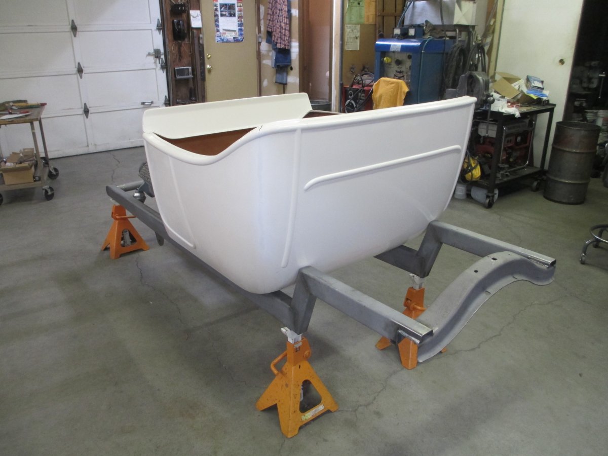

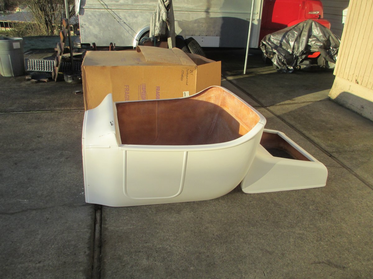

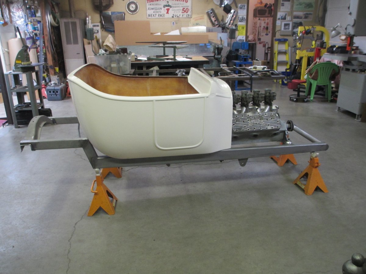

    Marty, I'm a little stuck on my poor efforts. I think you have reinspired me to use a t body. A question: how far back from the kickup is your rear axle centerline? I might haveto movemine back to get the proportions correct. Easy to do now, harder down the road.
    catdad49, loudbang and Stogy like this.
  6. Marty Strode
    Joined: Apr 28, 2011
    Posts: 9,676
    Marty Strode
    On the T coupe chassis, it is 9" from the front of the kickup to axle centerline. I would get the body first, to avoid any confusion, in your case.

    Thanks Marty. That dimension is what I needed. Based on your car and some measurements I made, I should be able to put a t bucket like you did w/o moving the rear axle. I can move the engine ahead 2 to 3 inches as well to clear the firewall if necessary.

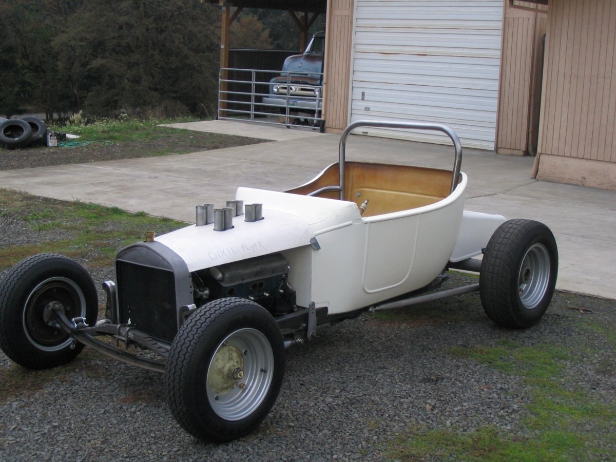

    Marty, did you have to stretch the frame at all for the Chevy or did the frame rail dimensions remain the same? I bet that one was a wild ride!

    It was the standard 100" wheel base. As a matter of fact, I built the chassis for a young friend, just up the road from me, set up for Flathead and later trans like # 10. He was raising a couple young children, and decided he wouldn't have enough seats for the family. About that same time, Rolla was wanting me to build him a car, so I arranged the deal for him to buy the car. I changed the front engine mounts to Chevy. This is how I would have finished it, had it been mine ! 046_46.JPG

    Marty how high is the kick up on the backend? Looks close to 9”?

    The frame converts from 4" to 3" at the kick up. From the top of the main rail, to the bottom of the rear section is 4". From the top of the main rail, to the top of the rear section is 7".

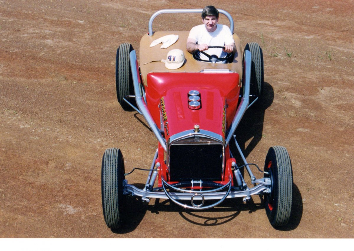

    Thank you Marty...scored a 37 front axle, and purchasing frame material next week. On the car you sold to Rolla, were the rear bones up to the task? I’ll make no where near 650 HP from my little 283 but I like the look and simplicity of the rear bone setup.

    In the photo of Rolla's car, I had some mock-up arms (42-48) passenger car. I ended up using 35-36 arms, similar to the black #2, and don't recommend high horsepower, and especially wide rear tires. #2 has around 28,000 miles, without any problems, I would suggest using 35-36 arms. P1010119.JPG
