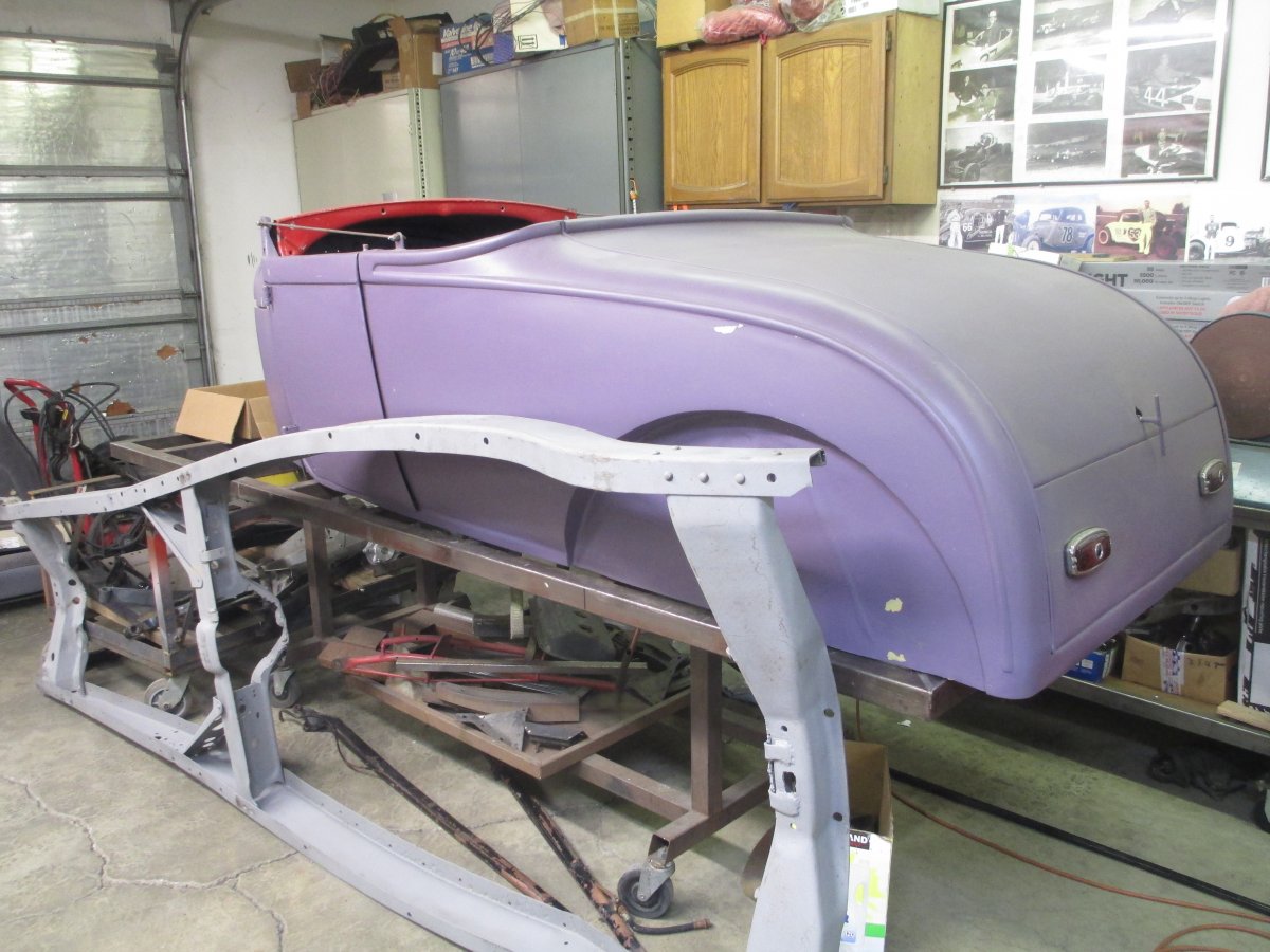

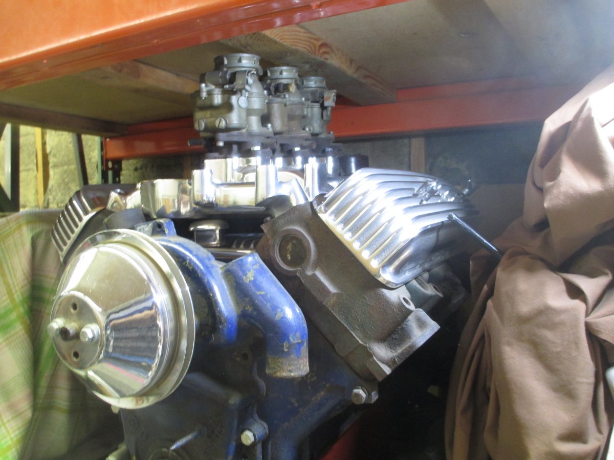

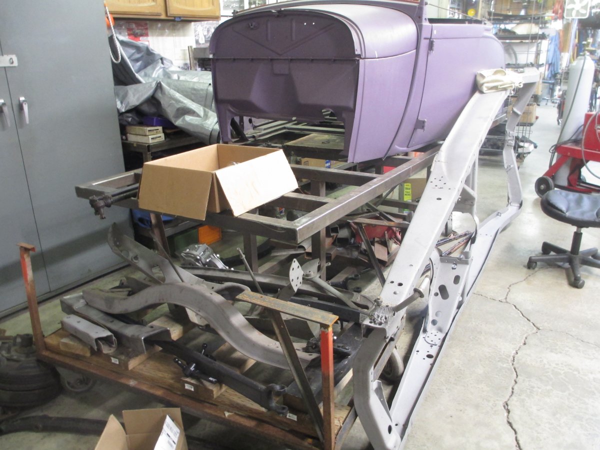

    Dave, The projects are stacking up, getting ready to build a '29 Roadster on Deuce rails, with one of my early Olds engines, for a buddy. It will get a V-8 QC as well. Sorry to hear about your back, I have been there ! IMG_6589.JPG IMG_6591.JPG IMG_6593.JPG

    Nice! It looks like you have a good foundation for it. Buick drums? 3 deuces? Looking forward to a new project.

    No plans for Buick drums, but I have a pair, maybe I can talk him into it.

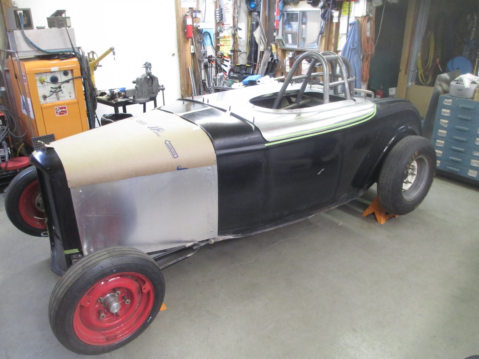

    Hello Dave, my internet has been down since last night, sorry for the slow reply. I use .063-3003 alloy, and it forms a little easier with the grain. If you can find some medium thickness paper for your template, it certainly will make the fitting quite easy. Some friends of mine have connections at a paper mill, and are able to get the ends of the rolls, and it has a curl in it already. IMG_6675.JPG IMG_7136.JPG

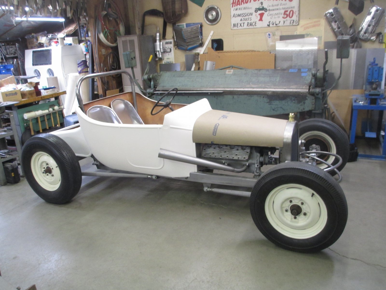

    Dave, if I had this project done, I would build the hood for # 10, to show my process, but I won't be done for a couple of weeks ! IMG_7369.JPG

    Not a problem! That's a neat project. Will it be SCTA legal when finished? I'm going to have to p*** that picture along to 2 of my friends back here. They picked up 2 drop tanks about 2 or 3 years ago. They haven't started on them yet. Finishing up on a 37 flat back 2 door. Electronic fuel injection on a 59A. Best of the old and the new...
