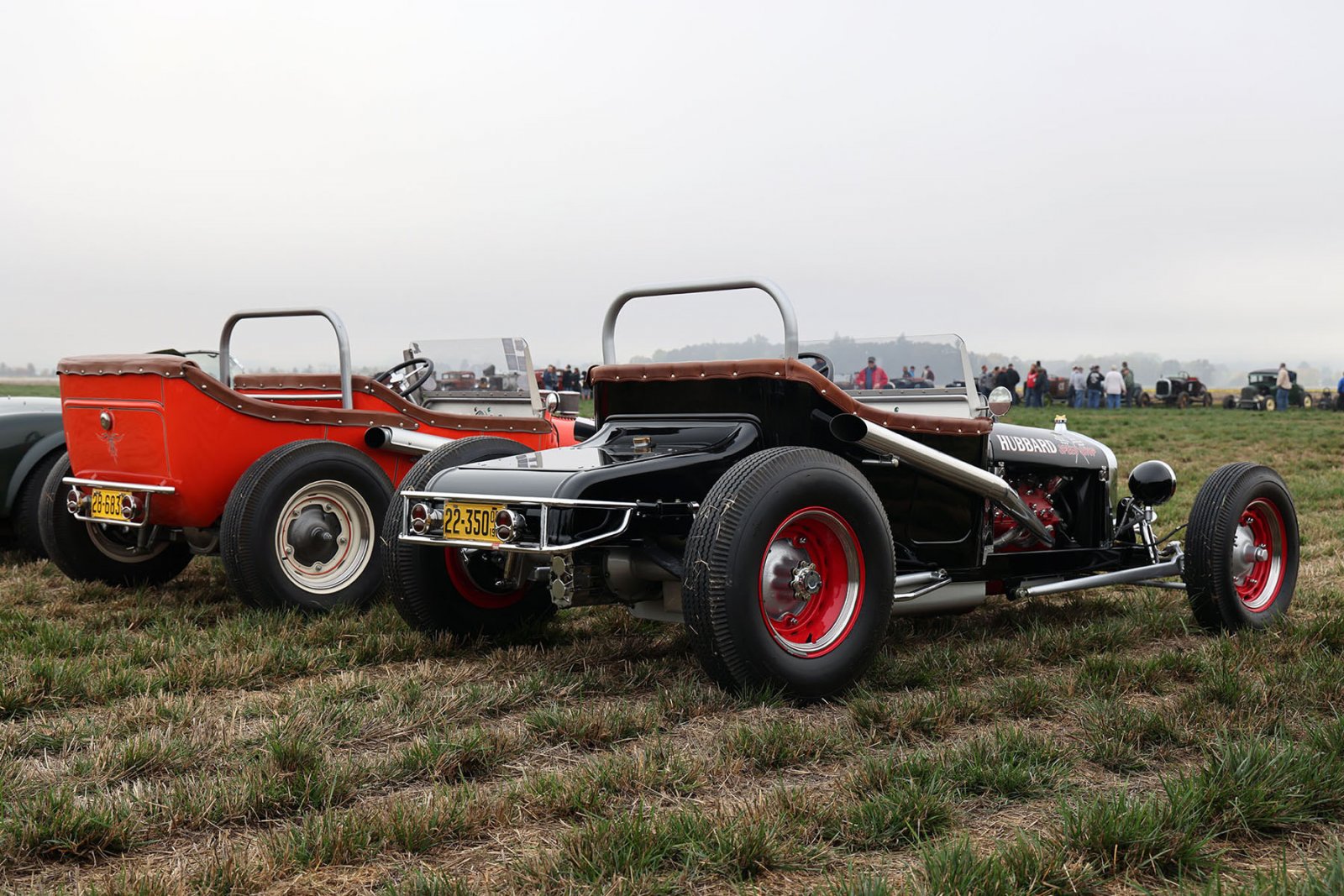

    Terry, Brent's car is #3 of the series, he did a hell of job finishing it. The orange Tub was my personal ride from a decade ago. It was nice to see them together.

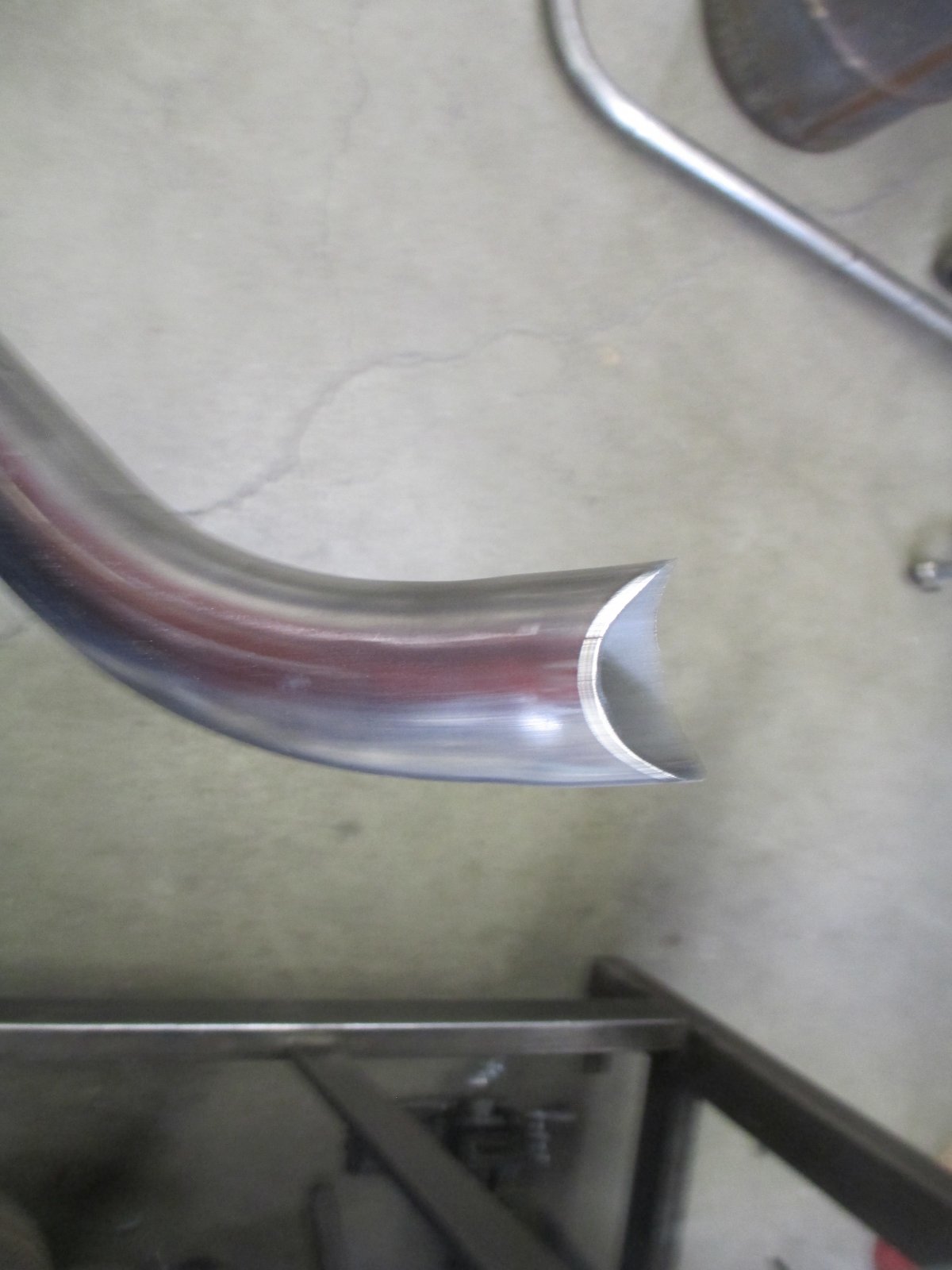

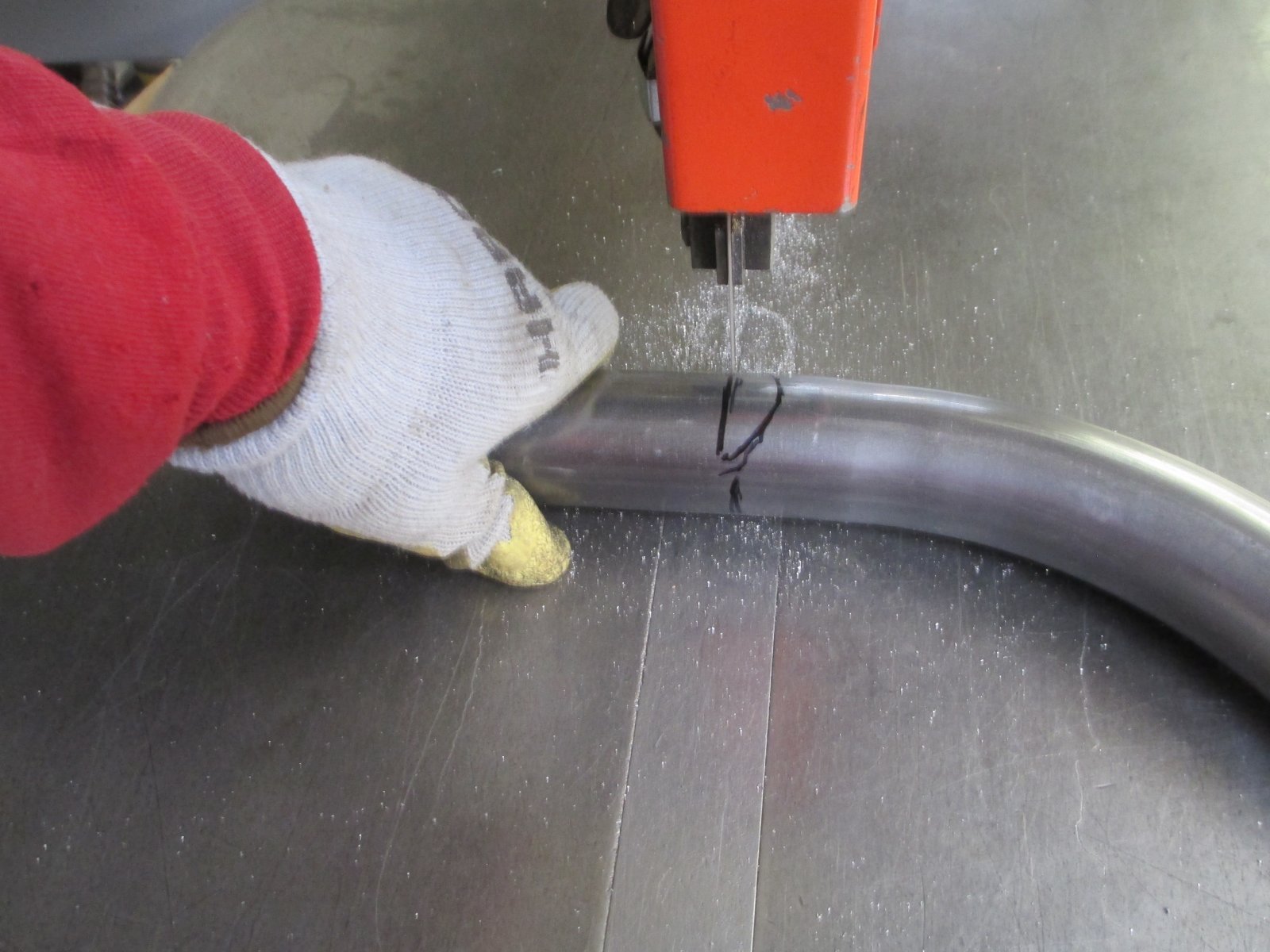

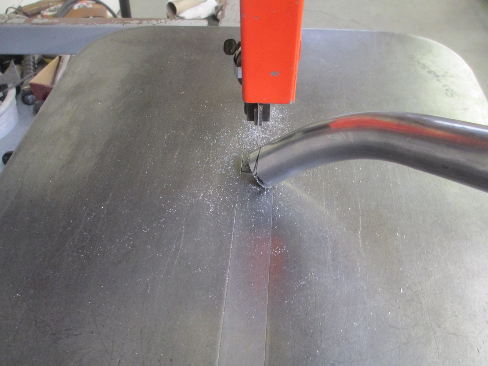

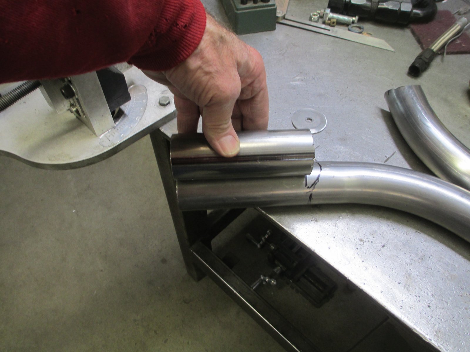

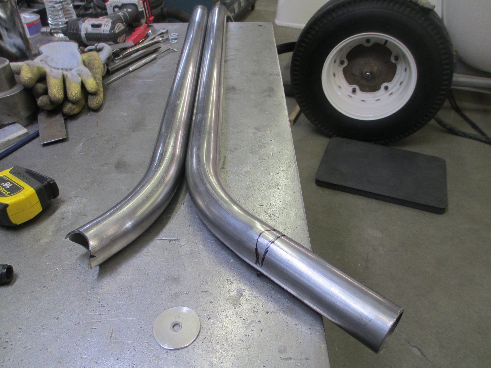

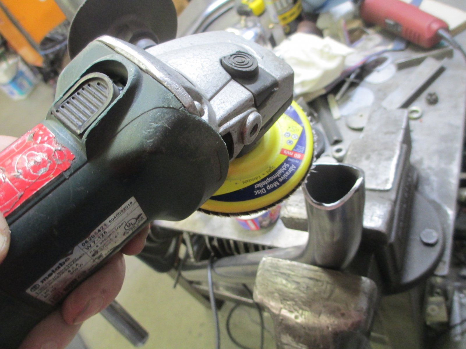

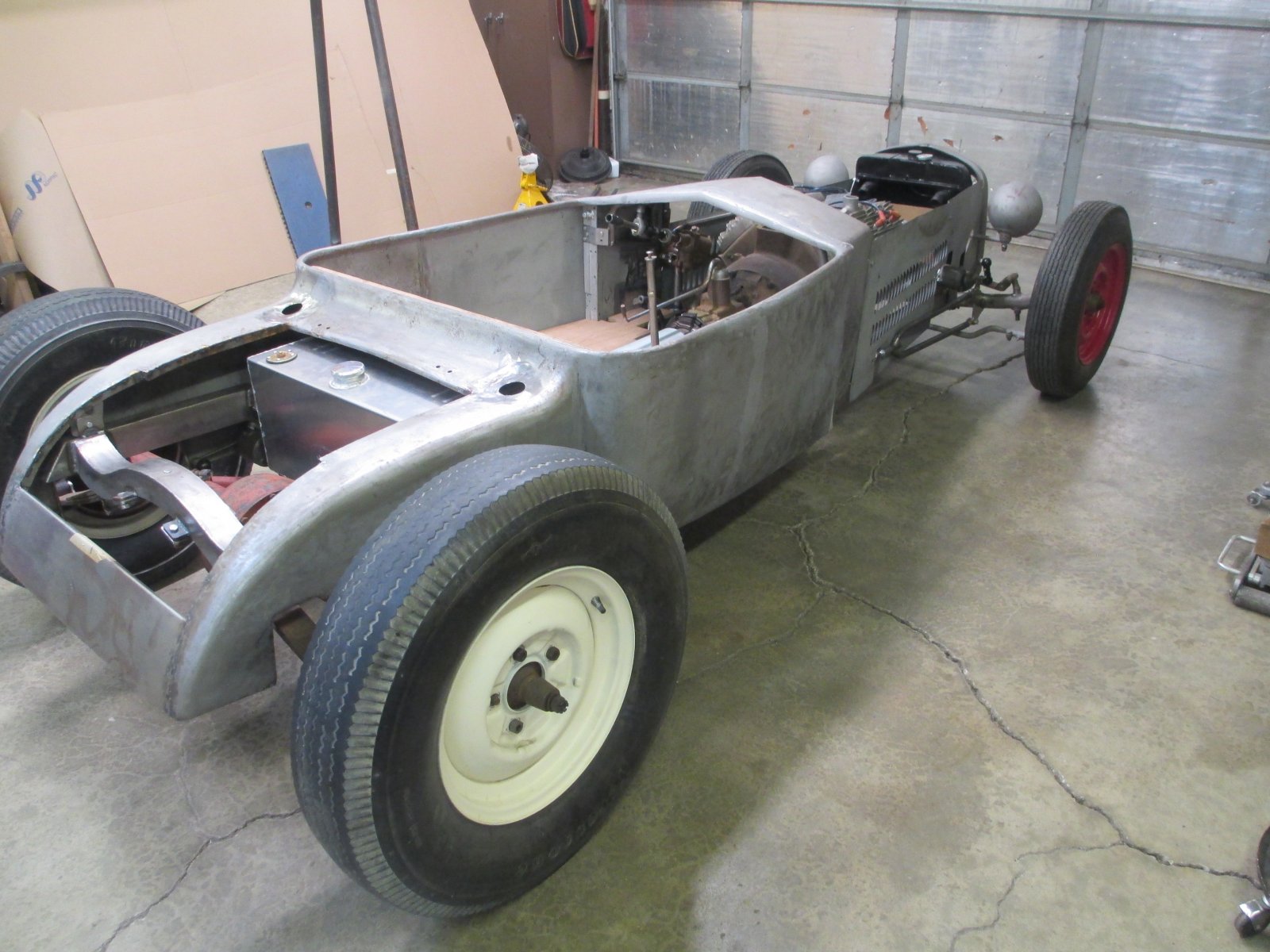

    Well, it's been over a year since I worked on this one, others got in the way. After vacuuming a years worth of dust off the car, and mopping the floor, it time to spend some time on # 10. I had fitted the roll bar, and bent the side bars, and today I trimmed and fitted the side bars. I have a sample tube that made out of exhaust tubing that fits the RH side, with the needed coping. I use it as a baseline to get started, with ink marks showing where to trim. The bandsaw is handy, but a little awkward to use making the rough cuts, however it works OK. After a quick check, and some more ink marks, I use a mop disc on a 4-1/2" Metabo grinder to finish the joints. The next thing will be pulling body and notching the bottom flange on the body, to clear the front mounting brackets. IMG_8130.JPG IMG_8131.JPG IMG_8132.JPG IMG_8133.JPG IMG_8134.JPG IMG_8135.JPG IMG_8129.JPG IMG_8128.JPG

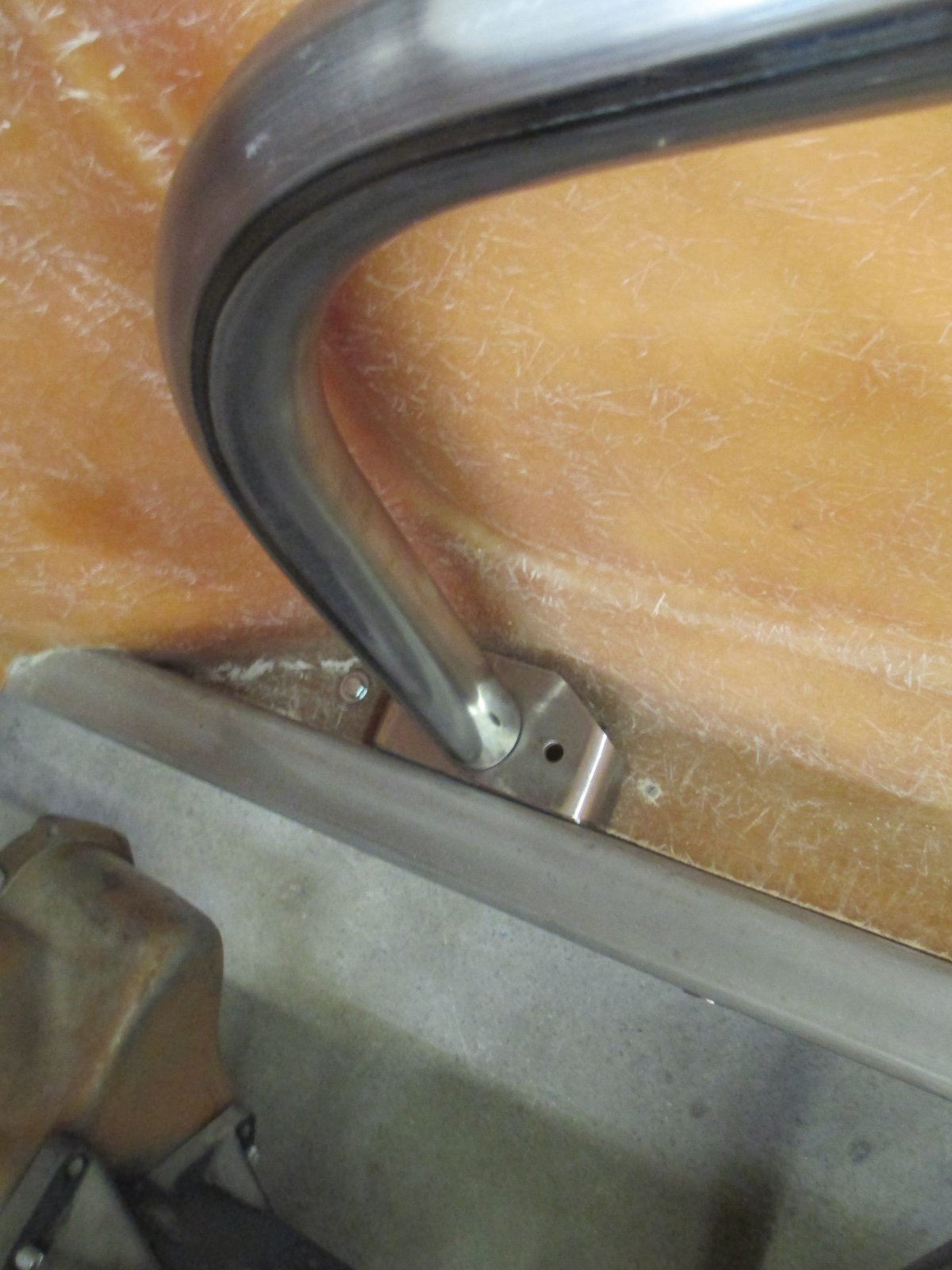

    Thanks for the excellent pictures Marty. I've been holding off doing this step on the Whatever project because I couldn't visualize how to get to the frame, and this shows perfectly.
    Just one question: what thickness is the mounting bracket material?

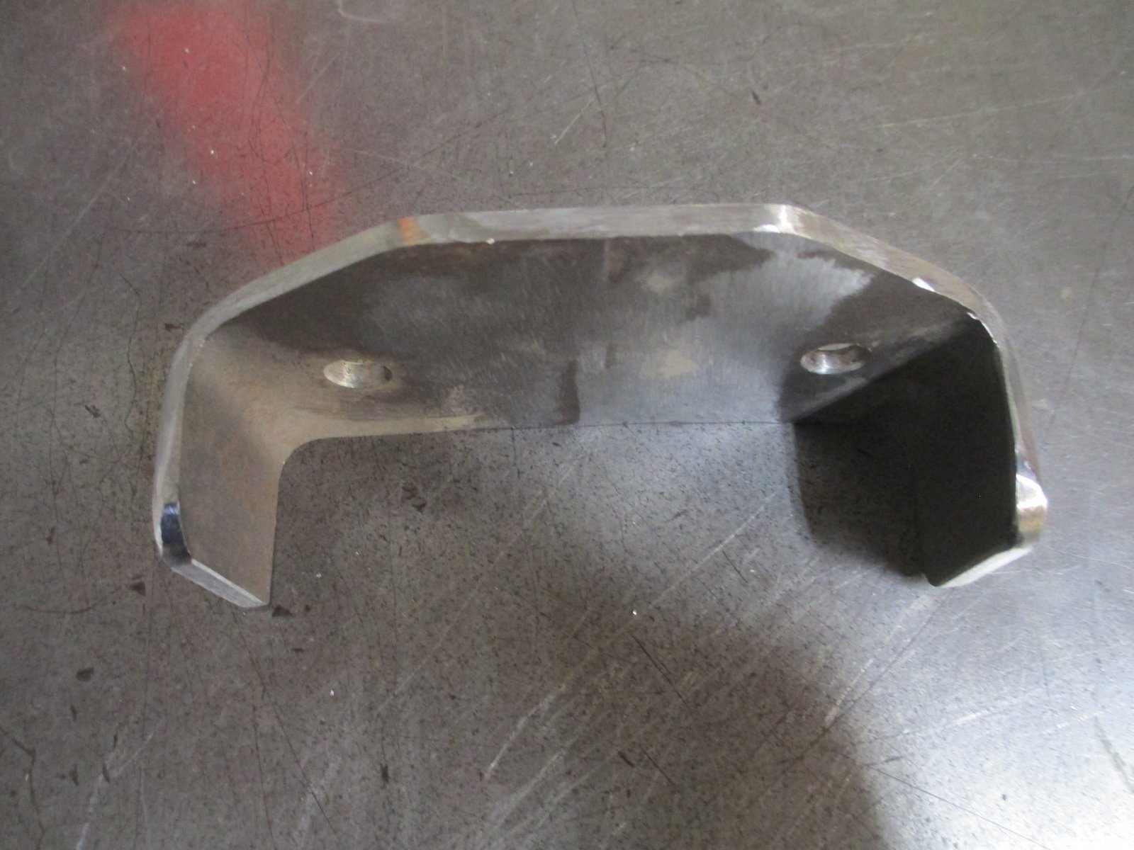

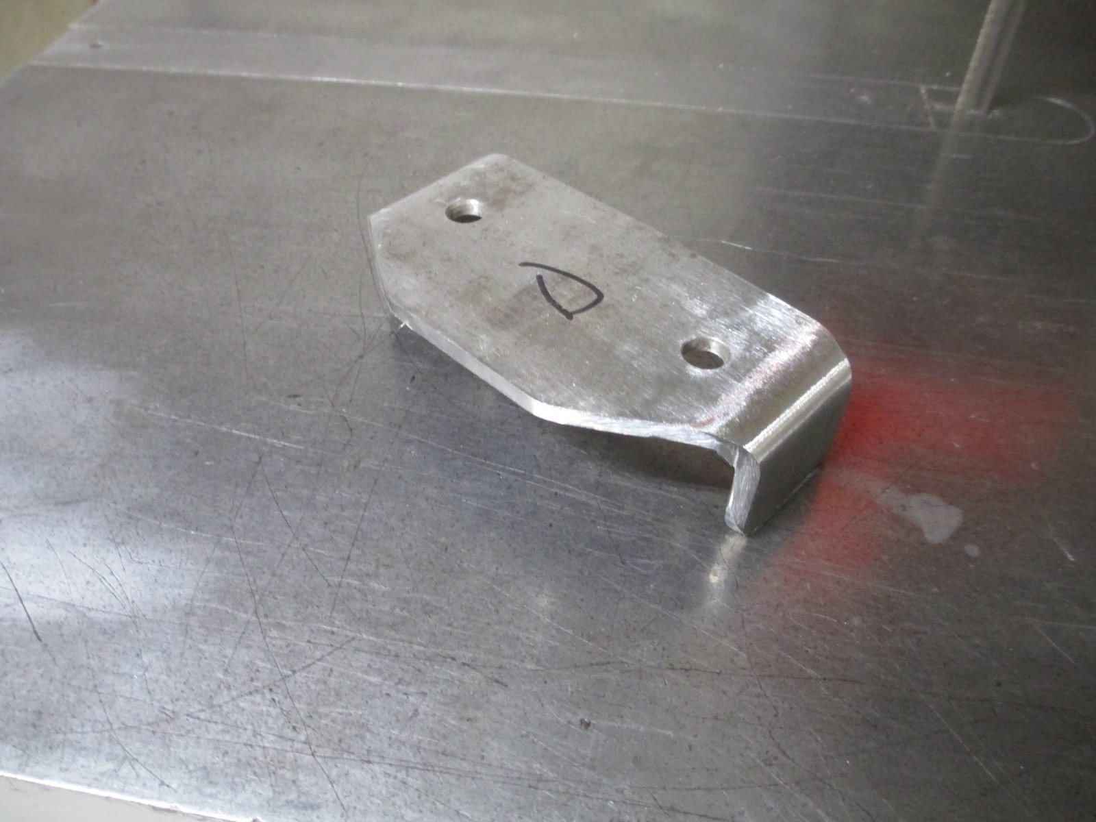

    Dave, Here are the frame brackets for the side bar mounting, I cut them out of 3/16" wall rectangle tubing. Now I am making some 3/16" diamond shaped plates the weld the bar to. IMG_8137.JPG IMG_8138.JPG

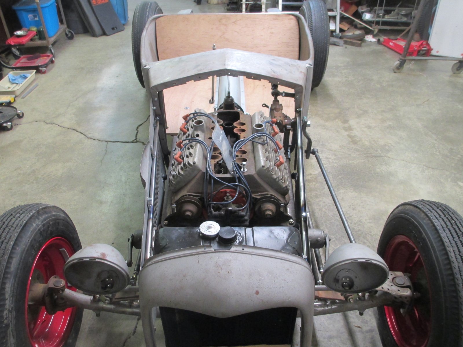

    Progress report ; I got the side bars fit and tacked in tonight. It required a slight amount of additional bending to hit the centers on the front mounts. Once that was completed, I laid out the bar that will span the distance across the back, to support the seats. The ends have to be curled to get the offset needed. I lay out the centers, and the amount of offset needed, and using a cardboard template that fits the radius of the die I will will be using. The tube will be 1-1/4" with a 3" centerline radius. I should be able to get that bar, bent, fit, and tacked in place in the morning. Then it will be time to mount the seats. IMG_8183.JPG IMG_8190.JPG IMG_8191.JPG IMG_8185.JPG IMG_8186.JPG IMG_8187.JPG IMG_8189.JPG

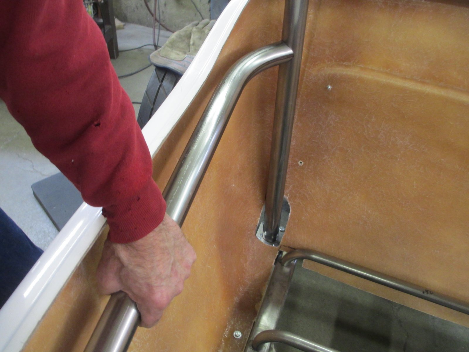

    Marty, I wondered why you used such a large access hole and flat mount for the bottom of the main roll hoop? Did you ever consider a slip-in inside bung welded to the frame, so the body access hole is just a round hole and the bar slides over it and attaches with a bolt or two through the side? Or maybe kick the hoops a bit forward in the bottom foot and have them attach all inside the body?
    Or am I being to street roddy?
