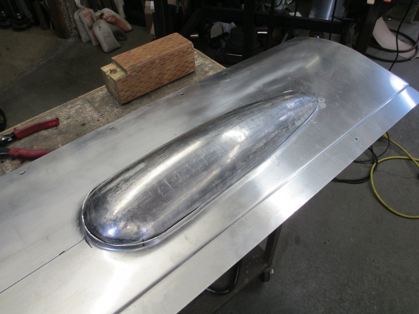

    I like the seats! I am trying to make seats for my track T, what I am doing is not working. You mentioned making a hood, well that is another thing I need to do but with a big bulge to clear the valve cover with my big 4 cyl, and I have not a clue how to start. I can see myself wasting a couple sheets of metal and still not have anything usable! I see making a hood then a bulge and welding the two together with another skill I am not that good at!

    I bought the seats from Speedway, they are not the quality of the Hunt Seats, that they used to sell, but they will be fine. Why don't you post a picture of your car to give us an idea, of where the bulge will need to be. If it doesn't fall in the area where the top meets the sides (if in fact you are running sides) you could do something along the lines of what I did on the Lakester to clear the plug wires. IMG_1580.JPG IMG_1581.JPG IMG_1583.JPG IMG_1584.JPG IMG_1585.JPG IMG_1591.JPG IMG_1592.JPG IMG_1600.JPG IMG_1602.JPG IMG_1603.JPG IMG_1604.JPG IMG_1614.JPG

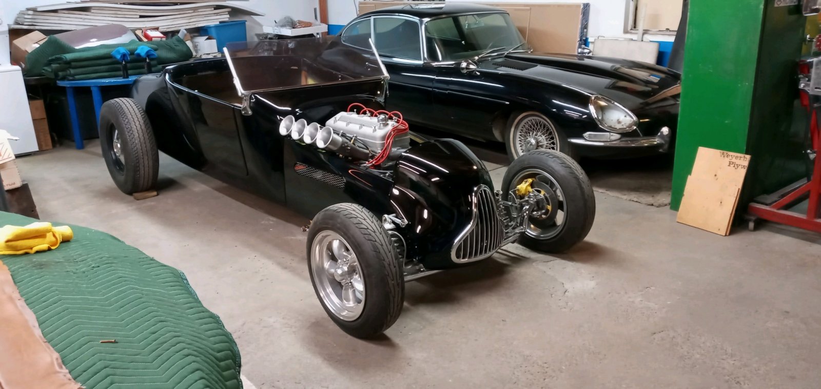

    Another from the front. Still thinking maybe picking the engine up maybe a 1/2 inch, as the pan is lower then the axle. trackt4.jpg
  9. Stan Back
    Joined: Mar 9, 2007
    Posts: 2,722
    Stan Back
    Looks like with a little work you could cut up that Jaguar hood to fit . . . ?
  10. Marty Strode
    Joined: Apr 28, 2011
    Posts: 9,685
    Marty Strode
    That looks like one of Jim Sandlin's kits, with the 26-27 back end, and the early cowl. I would raise the engine to the desired height, mount it, and then decide on the height and rough shape, of the hood bubble, making a template gauge. Remove the engine, and probably form and fit a new hood, out of 3003, .063 aluminum. You could then, make a wooden mockup with the shape and contours fore an aft. I have a tucking stump I made out of oak, with a couple of pockets, and modified a wooden Baseball bat, to use as a hammer. Another tool I use, to go along with the English wheel, is an inexpensive Planishing Hammer, to smooth out some of the minor lumps. I think you will be amazed at what you can do after annealing the metal. The thing to remember is, the bubble you are forming is just raw metal, not an expensive part to replace. If you are not happy with the first one make another, until you are satisfied. If you use 1100 welding rod, it will be easier to file finish. I am not an expert at anything, including shaping aluminum, but for being mostly self taught, my work is at least "paint grade". I have a friend who is a master, Chris Kopp, who taught me how to file, and gets me out of jams ! Good Luck and keep us posted on your progress, IMG_1698.JPG IMG_1699.JPG IMG_1702.JPG IMG_1703.JPG IMG_1704.JPG IMG_1731.JPG IMG_2936.JPG 069.JPG One more thing, you will need a set of stretcher-shrinkers. Good luck !

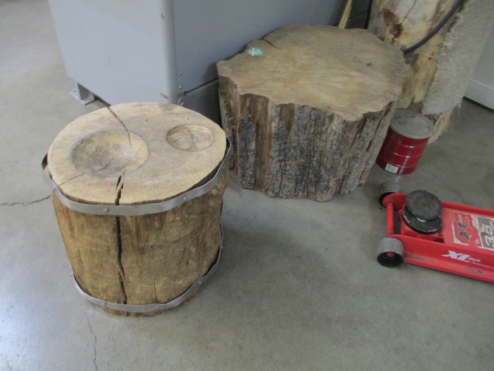

    Glad you mentioned the 'shrinking stump'. My son is clearing his property and I have my choice of oak or hickory stumps. My limited woodworking tells me that hickory is harder. Is that a good thing? How big in diameter should I shoot for? And what is a good working height? I know I don't want to bend over any more that I have to. Elbow height? Finally, does a guy want to band the stump to slow down the tendency to split?

    Bruce, if hickory is harder that's what I would use. My current stump is Oak and around 14" in diameter. I like a working height of around 30", if you can get a full height piece of wood, I would do that instead of setting it on a stand. Rocky Phillips @Toymaker, brought me a chunk of Chinese Elm, that I will be bowling out soon, and I will wrap it with plumber's tape. IMG_8237.JPG IMG_8238.JPG IMG_8240.JPG

    Is your oak red or white? I would look for white as it is tougher than red. I wouldn't use the hickory for something like a shrinking stump as it's brittle. It has a lot of strength and flexibility along the line of the grain which makes it great for axe and hammer handles but if you hit it on the end, it can shatter and you'll have a mess of splinters. Since you're using stumps, look at the end grain. First pic is red oak, second is white. Hope this helps.

    After reading your post I did a Google search on identifying oak trees. I'm pretty sure that the majority of oak trees around here are in the 'Red' oak family. I will definitely look at the trees that have to come down and put my tag on the best candidate.
    Not to be contrary, because these are free logs, I will probably have him cut me a hickory one too. Can't hurt to have a big chunk of wood around.

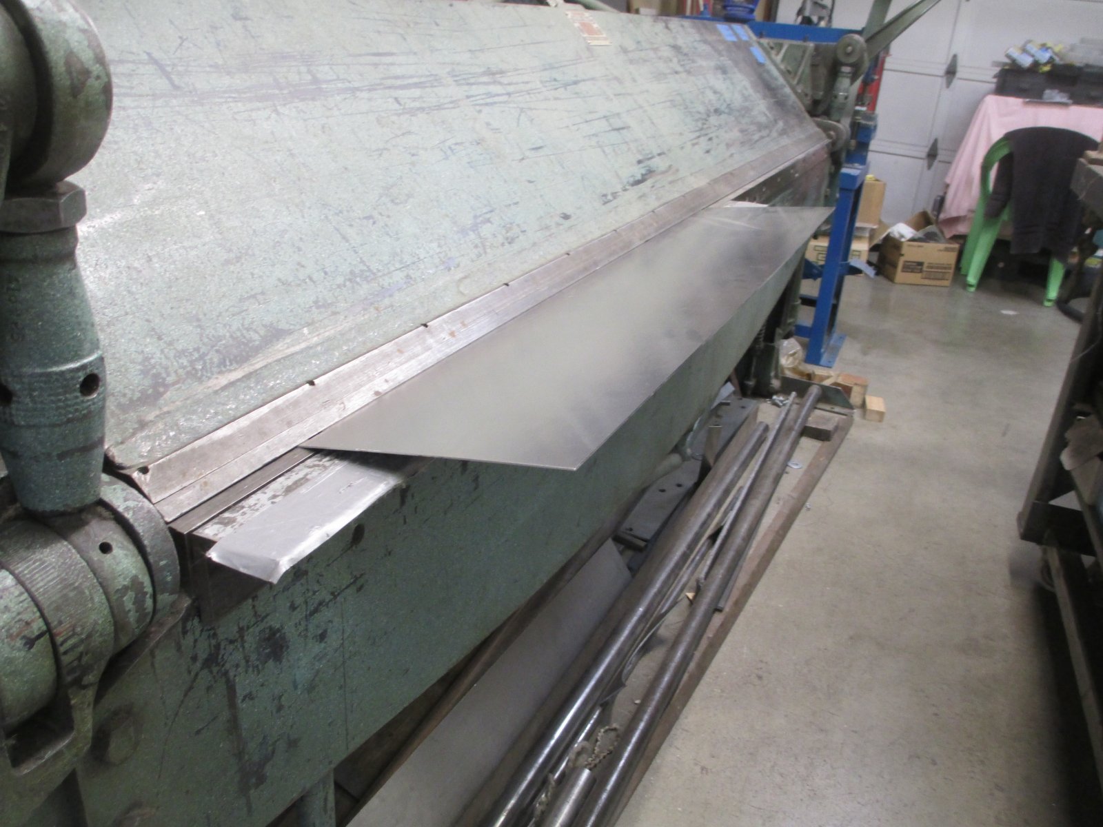

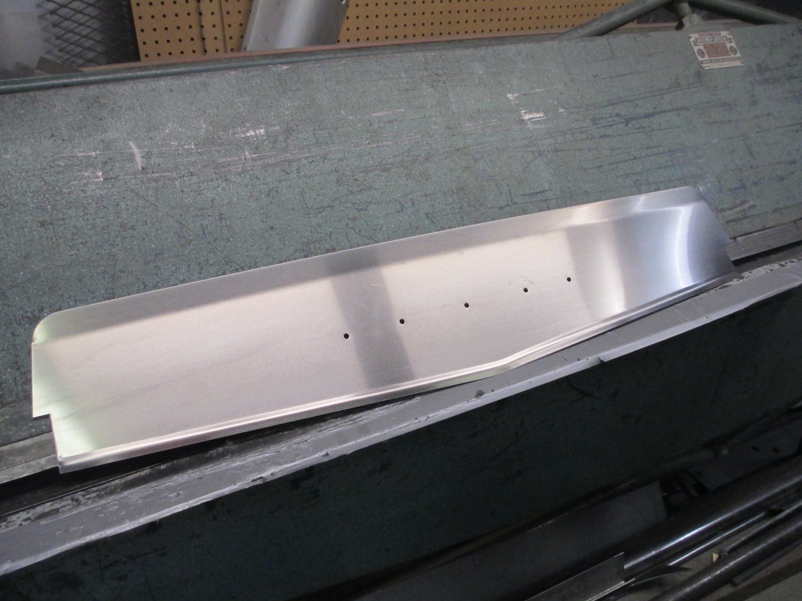

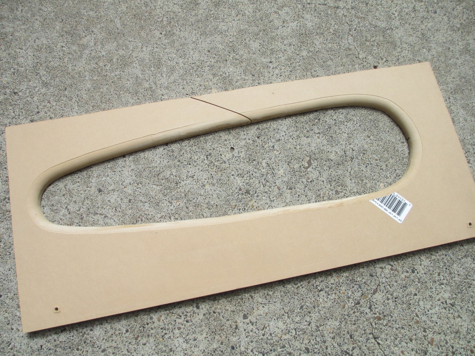

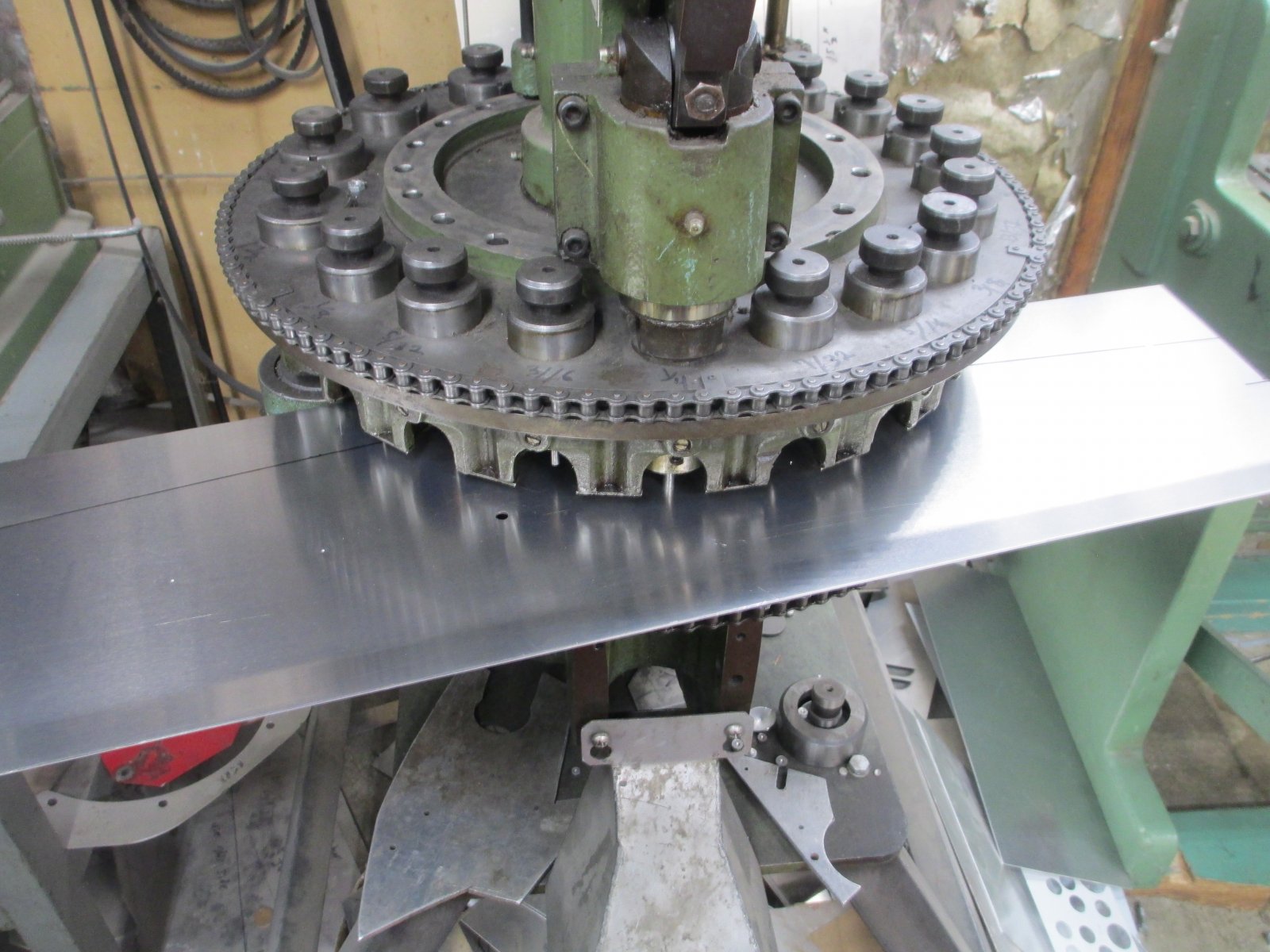

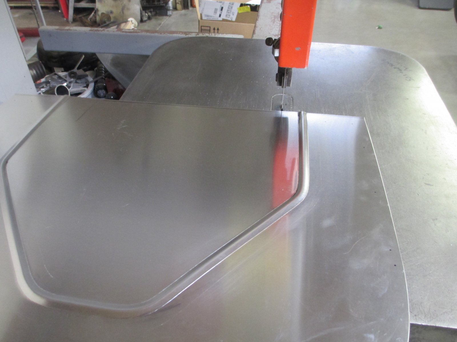

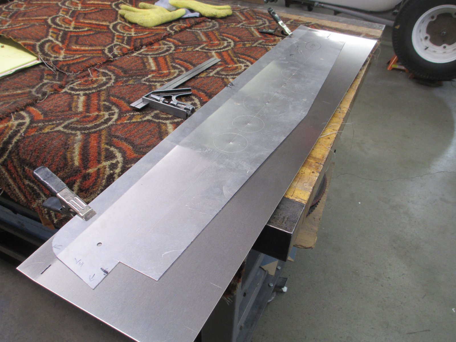

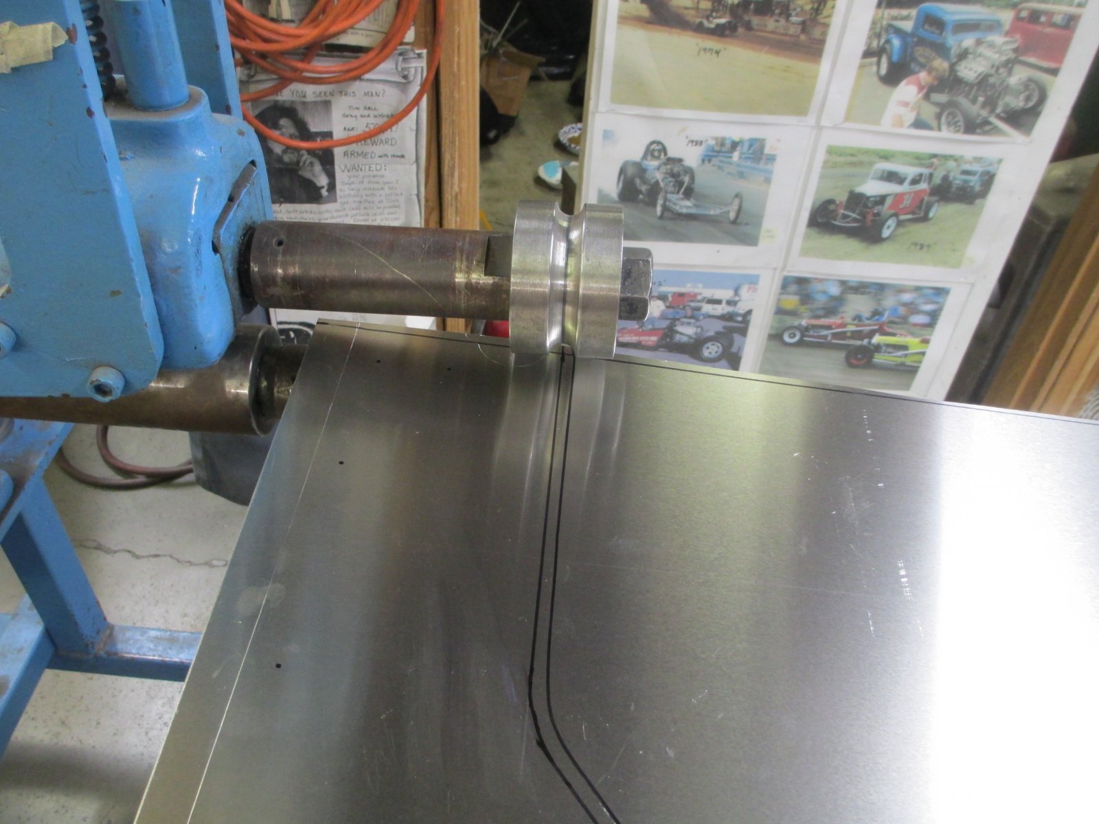

    Today I fabbed a dash and a firewall skin. Here are the steps, using my template. IMG_8277.JPG IMG_8278.JPG IMG_8279.JPG IMG_8280.JPG IMG_8281.JPG IMG_8283.JPG IMG_8284.JPG IMG_8285.JPG IMG_8286.JPG IMG_8288.JPG

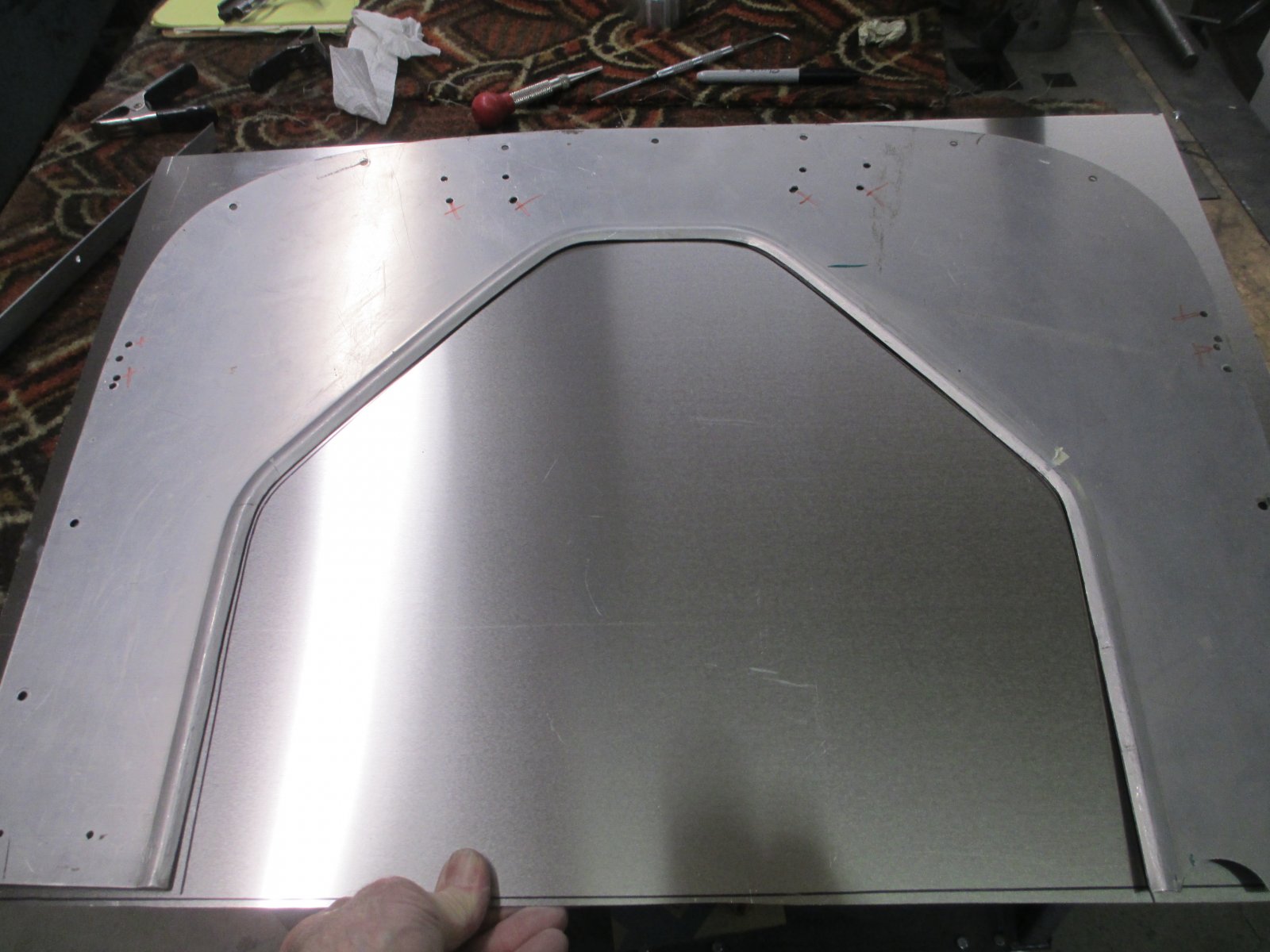

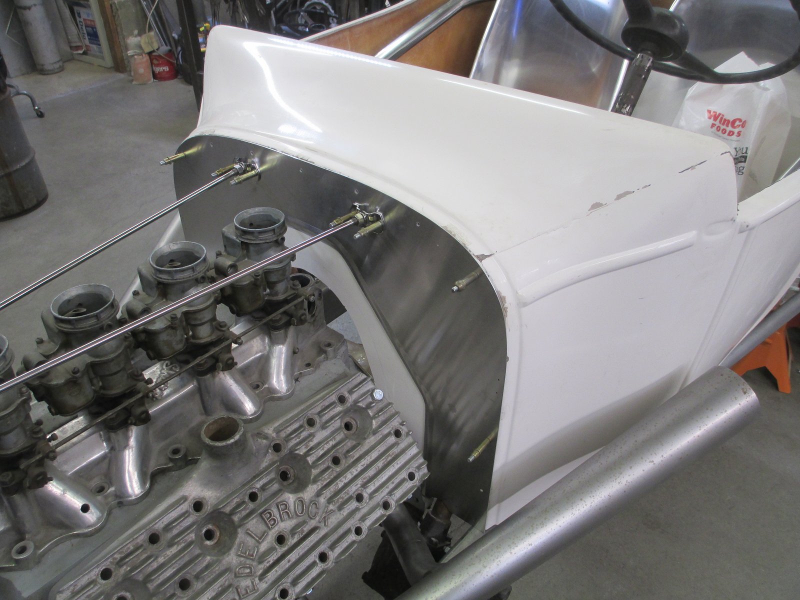

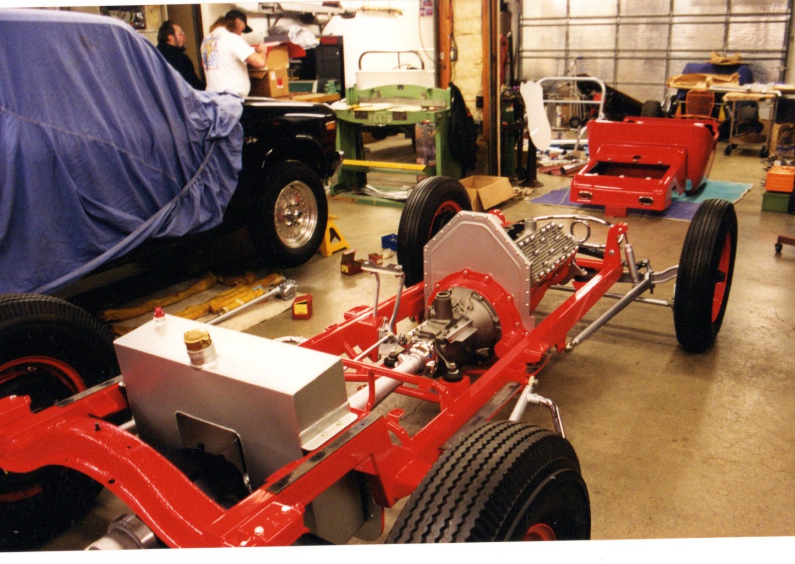

    Here are the steps for the firewall skin. There will be a another .050 plate sandwiched between the bellhousing and the block, that allows a seal, and floats. IMG_8290.JPG IMG_8291.JPG IMG_8292.JPG IMG_8294.JPG IMG_8295.JPG IMG_8296.JPG IMG_8297.JPG IMG_8298.JPG
