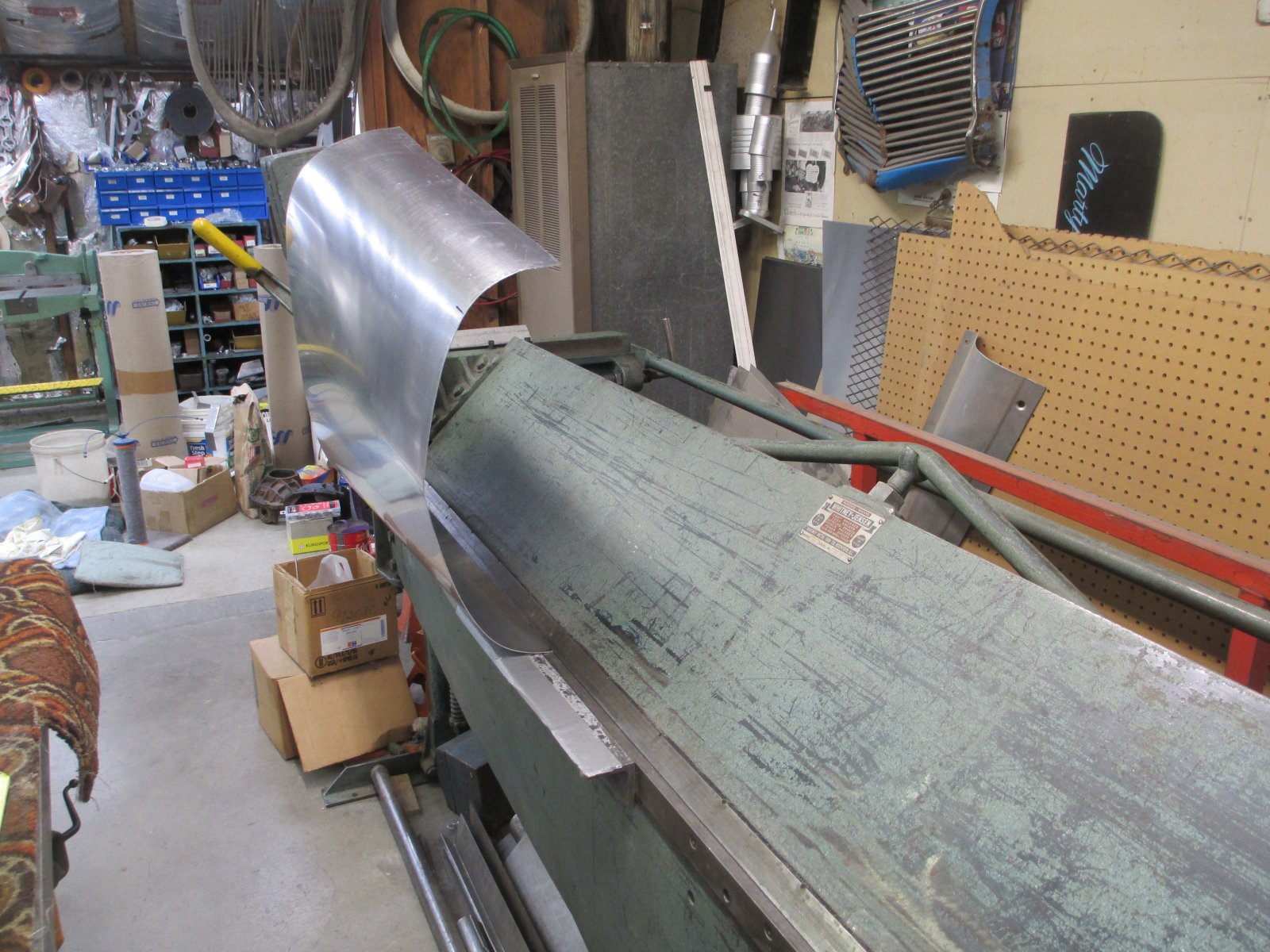

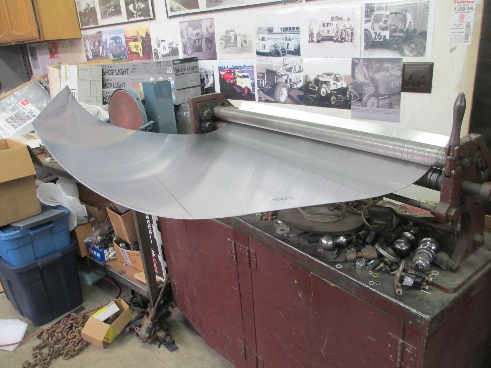

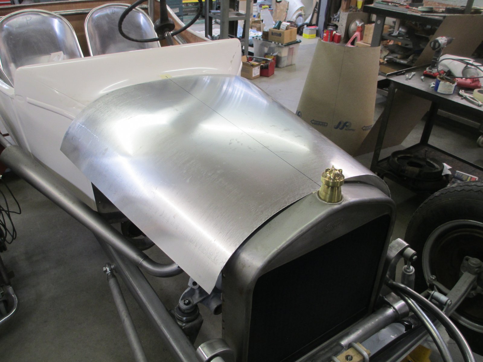

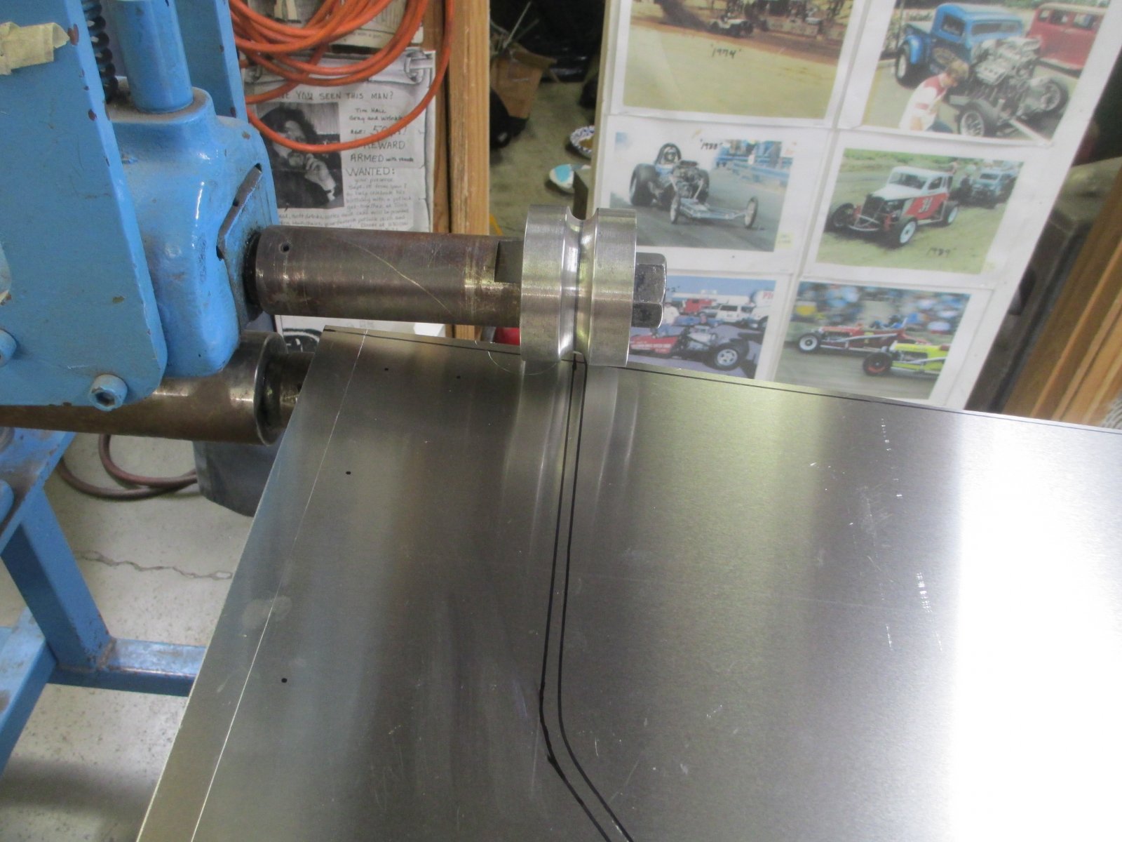

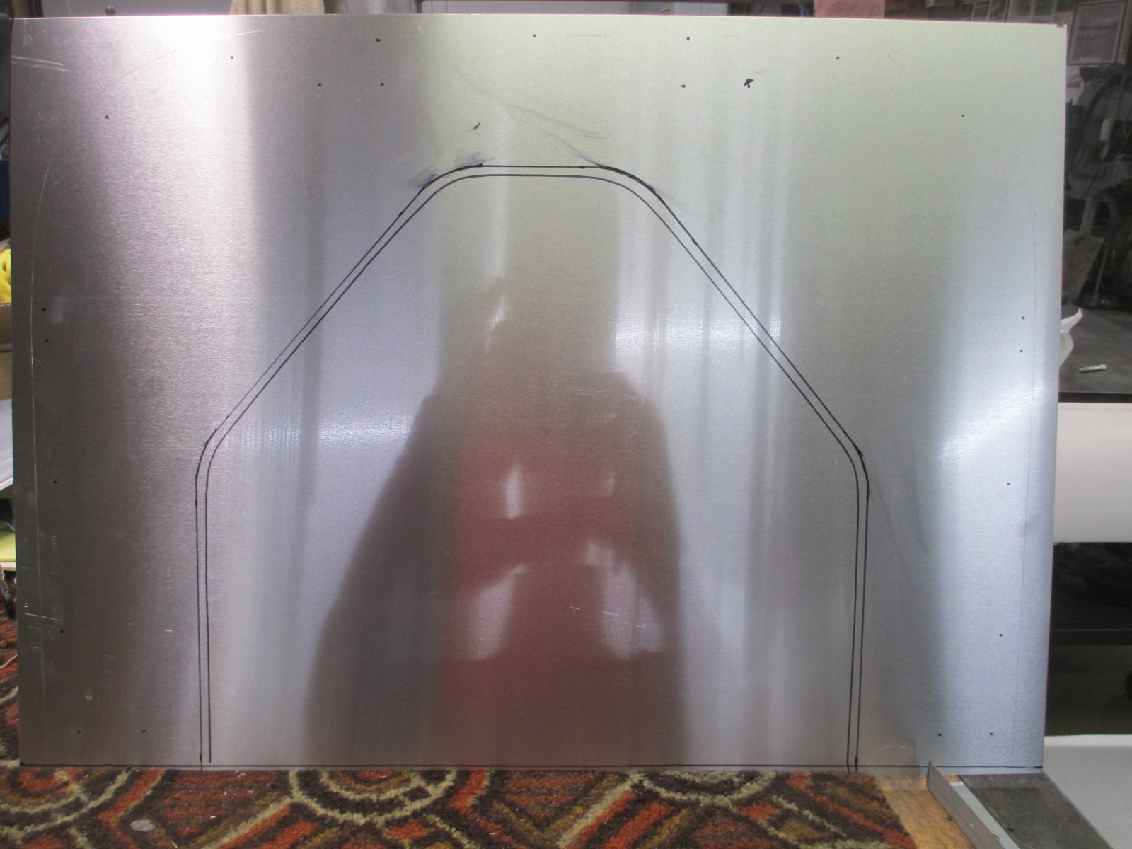

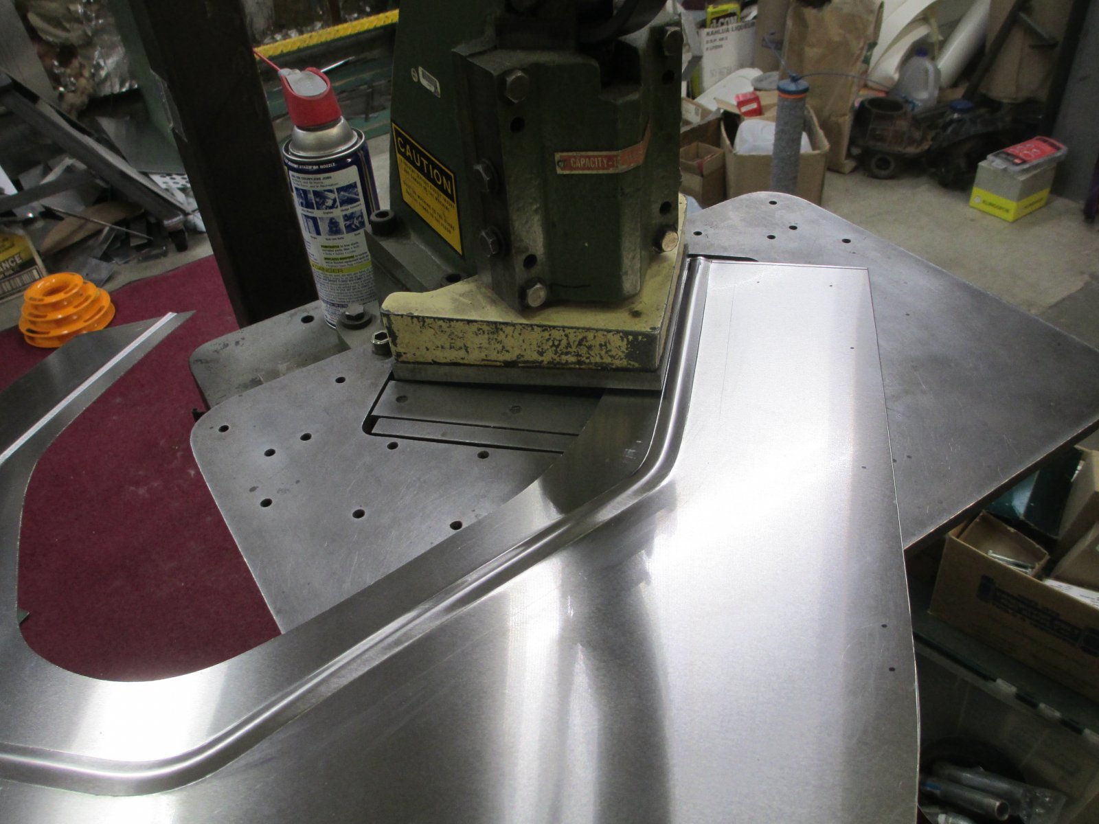

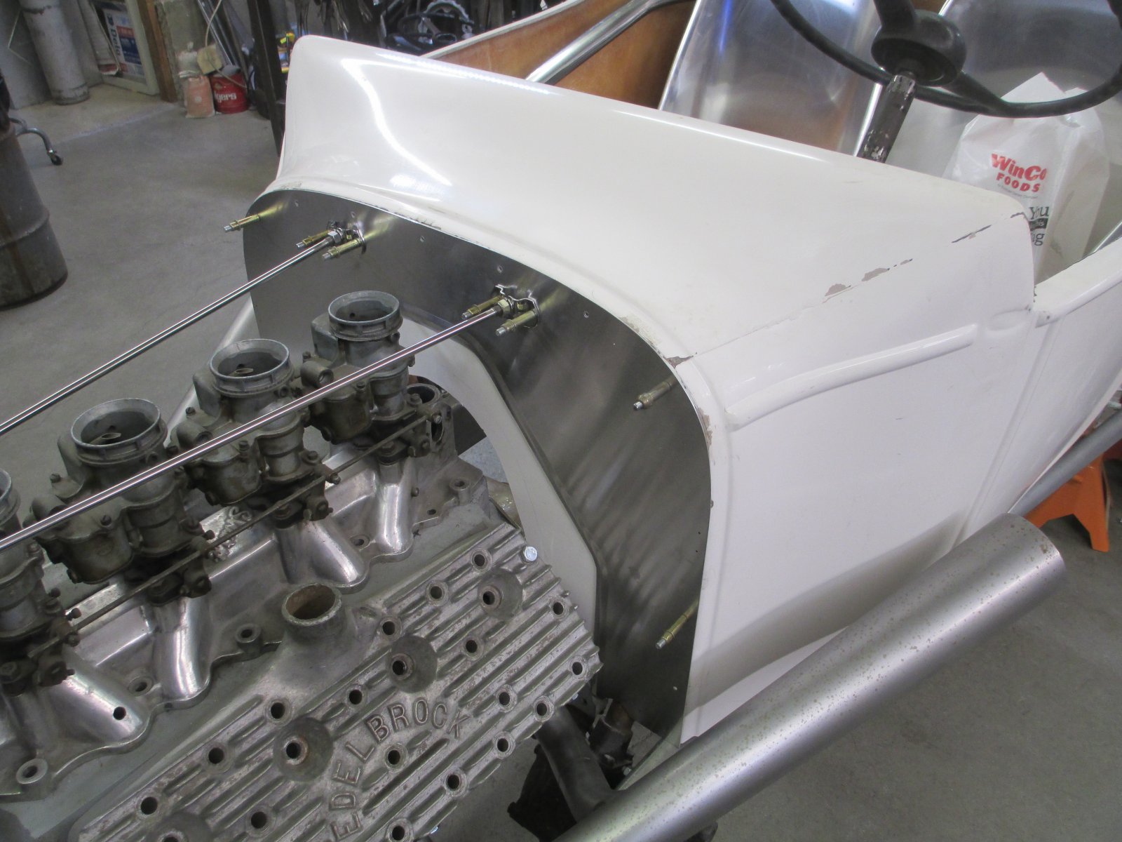

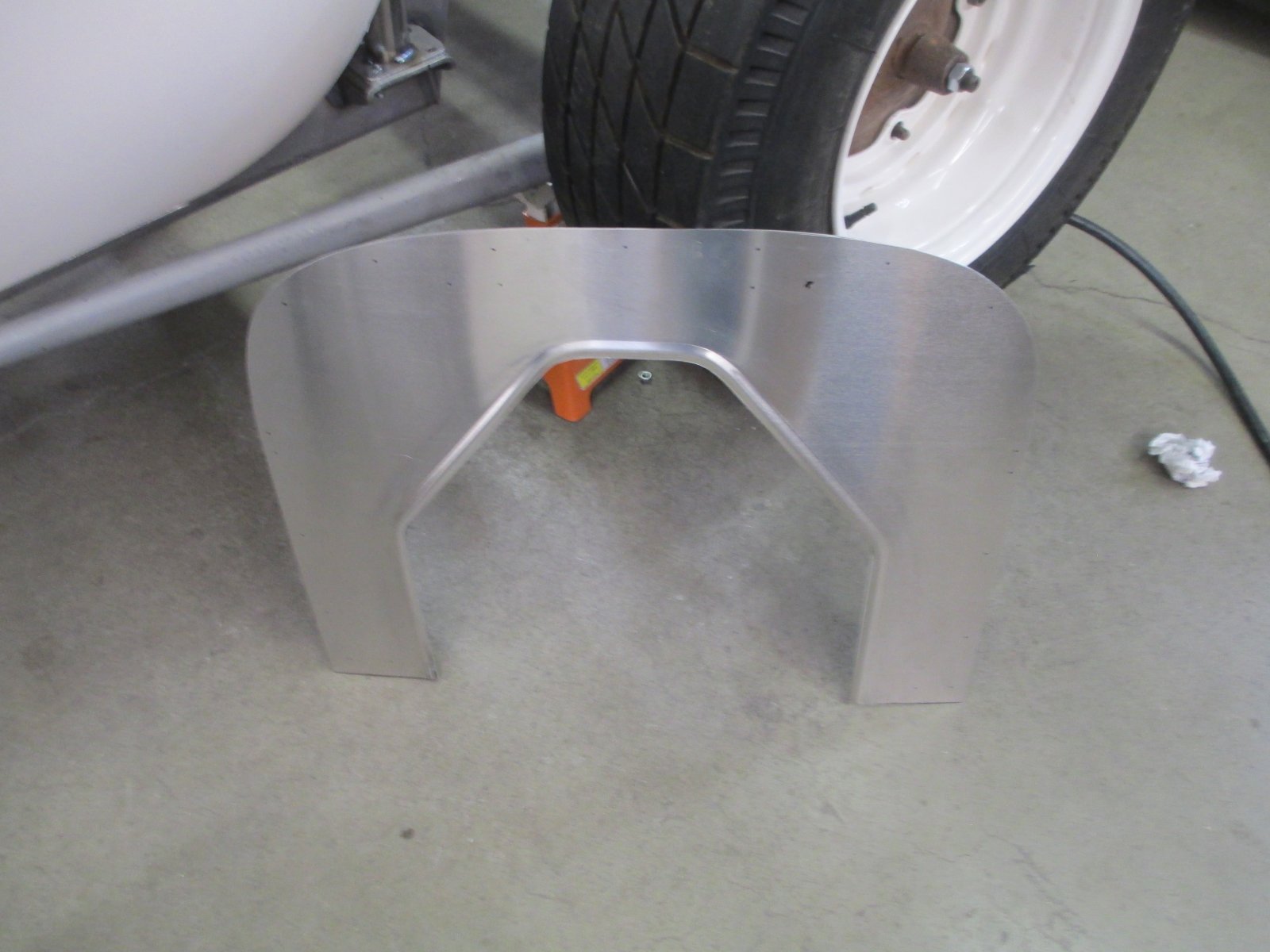

    I roughed in the hood this evening, went pretty well, for an hour and a half. I start with an ink centerline on the inside and outside of the raw aluminum, and mark centers on the grille shell and cowl. That way I have a guide to go back to, during the forming process, and can tell where the additional shaping is required. The first thing I start with is the slip roll, and get the shape started. T hoods, have quite a difference in the radius, at the grille and cowl, and I go slowly, adding shape here and there. I have found, clamping it in the brake, and doing the forming, with my armpit and hands, work pretty well. I even bend it over my knee. To go further, I need to add the upper mounting brackets to the shell, to the radiator side channel, to get the final fit and trim. IMG_8306.JPG IMG_8307.JPG IMG_8308.JPG IMG_8310.JPG IMG_8312.JPG IMG_8313.JPG IMG_8314.JPG IMG_8316.JPG IMG_8318.JPG IMG_8319.JPG IMG_8320.JPG IMG_8321.JPG

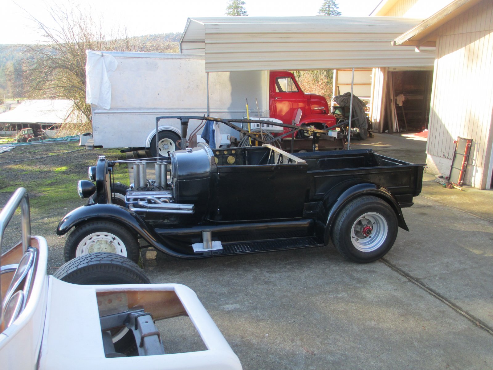

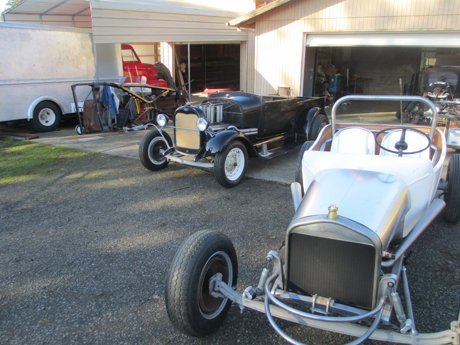

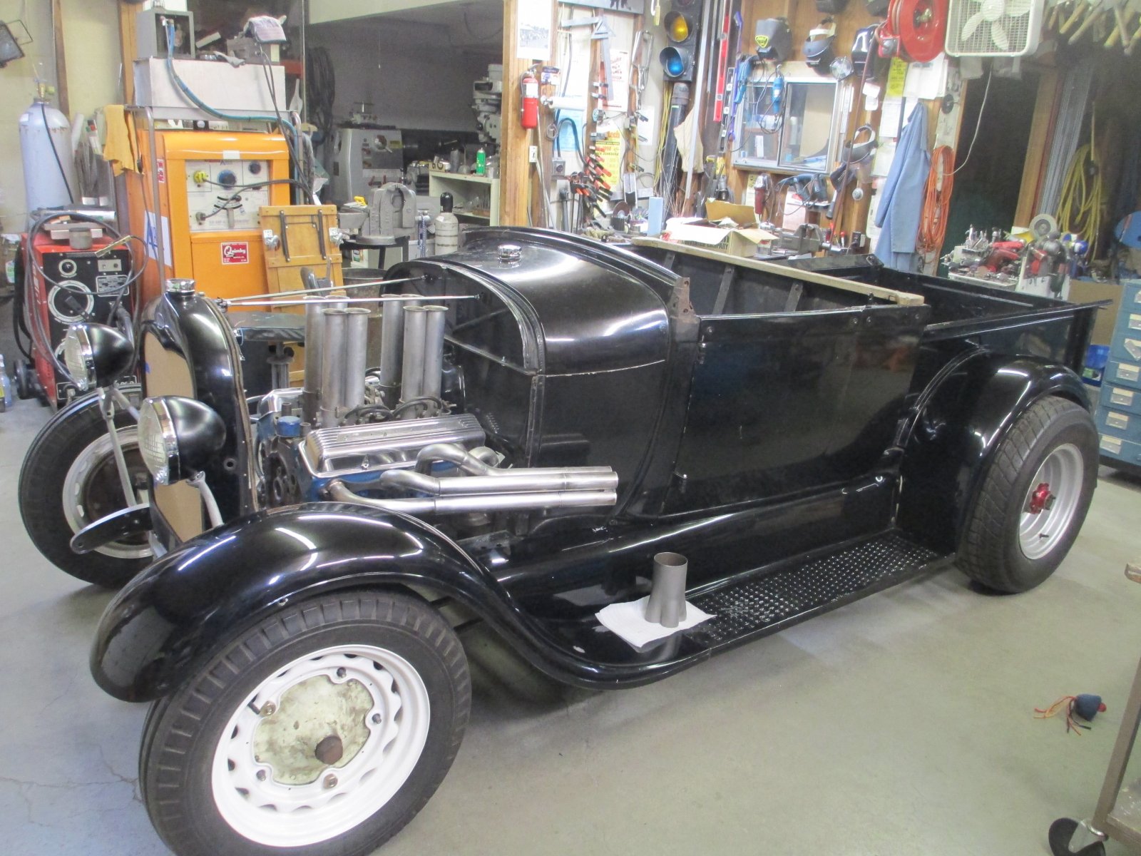

    This project will have to go on ice for a while, and allow me to make progress on the other 3 projects I am juggling. I moved it on the lift and pulled my 29 RP out of mothballs on Saturday. Some outside and underside shots. IMG_8350.JPG IMG_8358.JPG IMG_8361.JPG IMG_8362.JPG

    Dean, during the m*** move on Saturday, to get the '29 off the lift, and the TR on, I took a few shots for inspiration. I hated to sideline the project, but the Belly Tank took preference. It took me 9 months to complete the tank, and get it to the dry lake, being one of the last customer projects for a while. Now, I can focus on the RP and the COE to haul it. It has given me some time to re-engineer a couple of things, like the possibility of changing to a straddle engine mount, and adding a mid-mount at the bellhousing. That, along with going to hanging pedals, will in my mind, work better for my application. I am excited about returning to that project, it is center stage, and I plan to hustle to get it ready for this Summer. IMG_8351.JPG IMG_8352.JPG IMG_8360.JPG

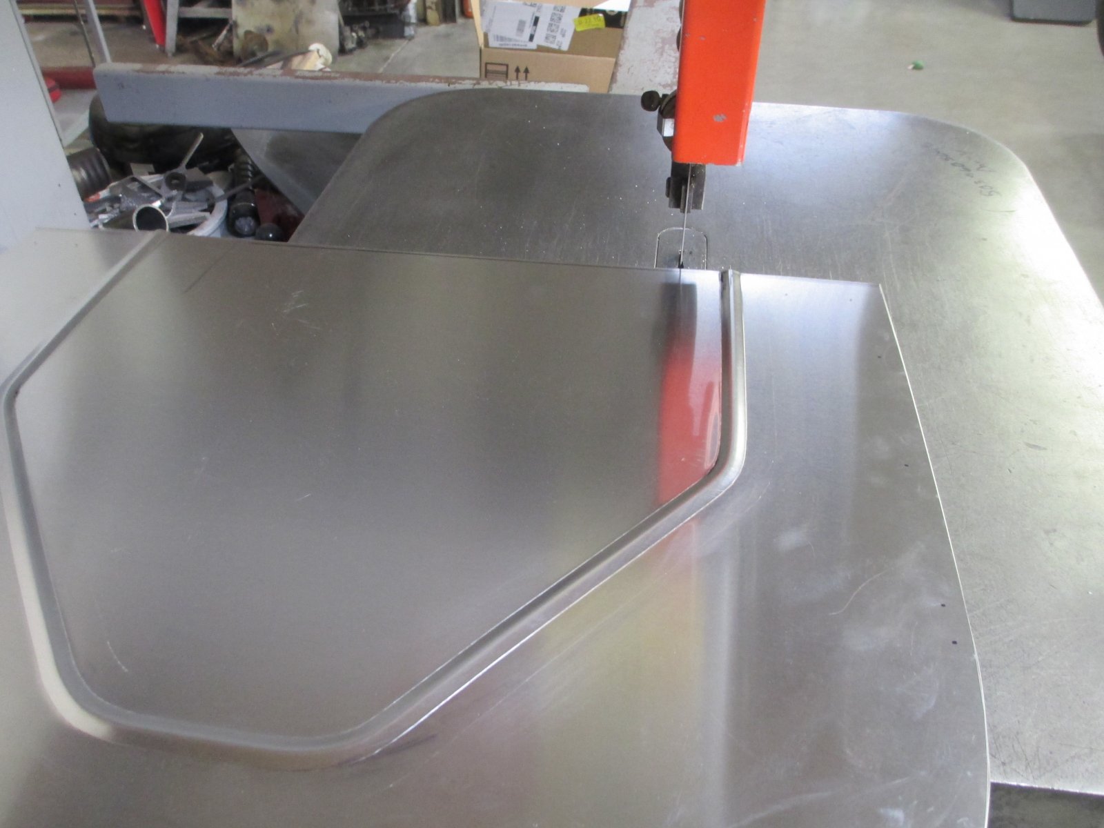

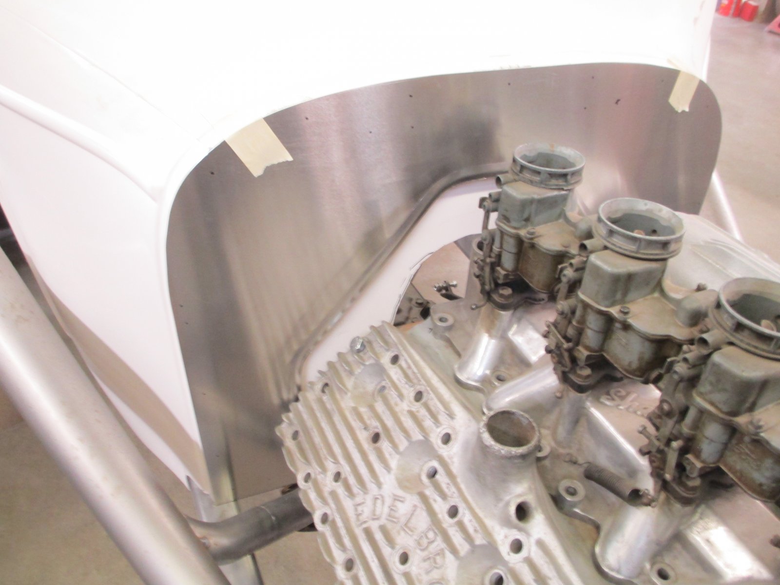

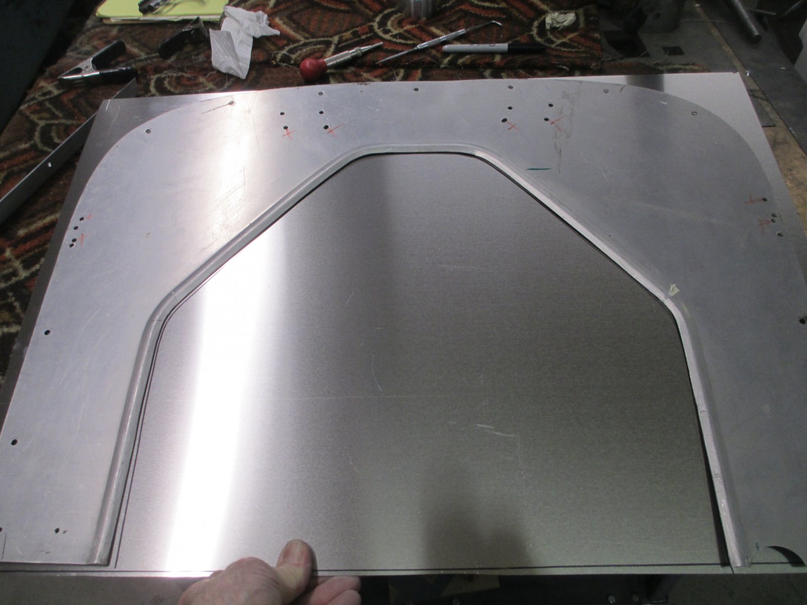

    Hi Marty. I found the pictures of how you did the inner structure, but it lead to the firewall. I'm going to try to build a firewall like you have, however there's a little bit of an issue. My engine isn't square to the firewall. There's around 5 degrees of tilt relative to the frame and firewall, which are essentially square to each other. Any suggestions?
  15. Marty Strode
    Joined: Apr 28, 2011
    Posts: 9,685
    Marty Strode
    Dave, is the back of the block behind the firewall ? As long as the split between the bellhousing and the block is behind the firewall, you can make up the difference in angle by tapering the sides of the divider. img20170201_15133302.jpg
    Dean Lowe, bymanr, Hotrodmyk and 2 others like this.
  16. Dave G in Gansevoort
    Joined: Mar 28, 2019
    Posts: 3,744
    from Upstate NY
    Brilliant! Thanks Marty. The split is about an inch in front of the firewall. I also just realized that I can still do it like you do, because the engine is solid mounted at the bellhousing (well it will be once it's finished) and I can make spacers to angle the part bolted to the engine. The bellhousing is completely round and 1/4 inch thick steel, so l could even weld tabs to it to bolt that to.
    And the picture tells it all for the inner structure. I can do it now... no more than 2 tries....

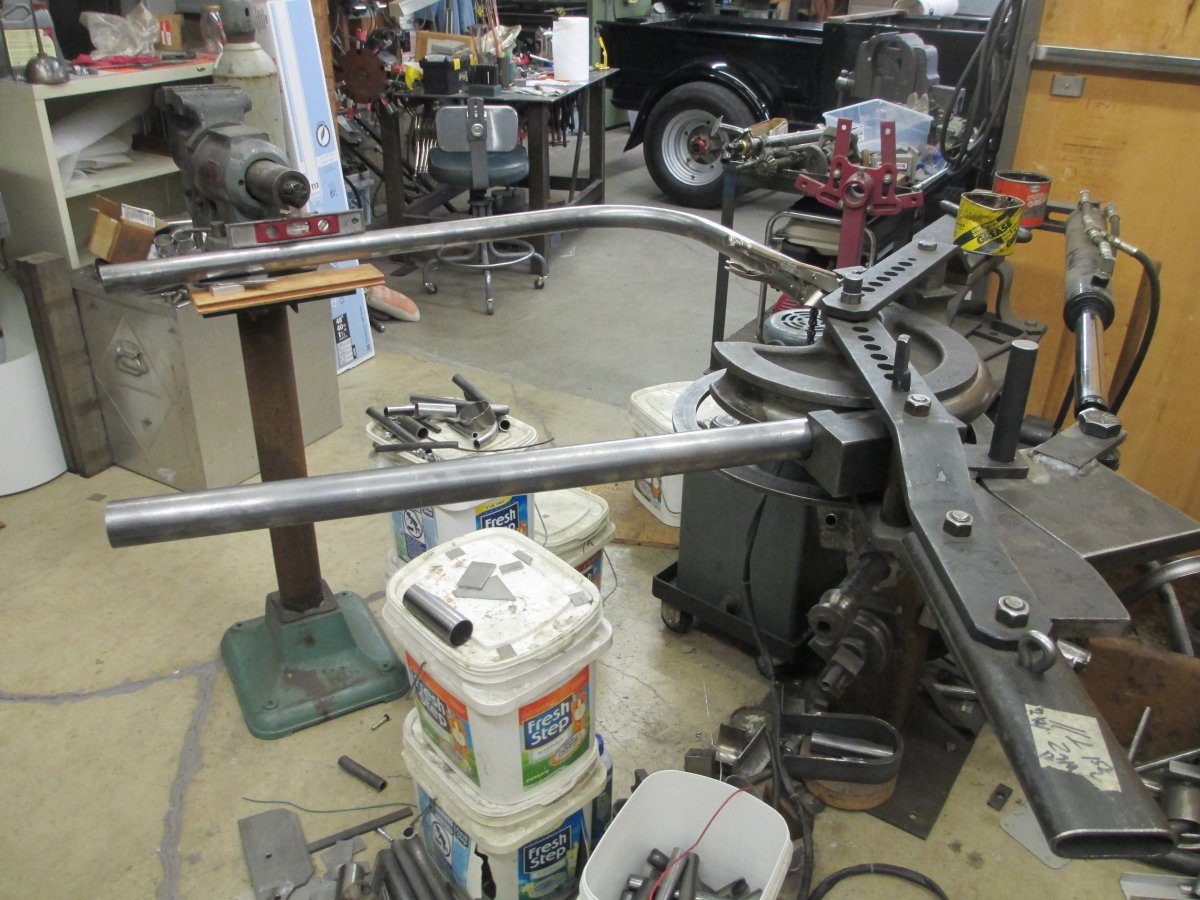

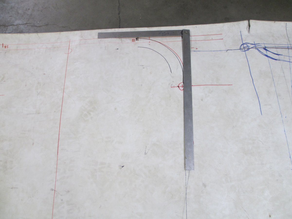

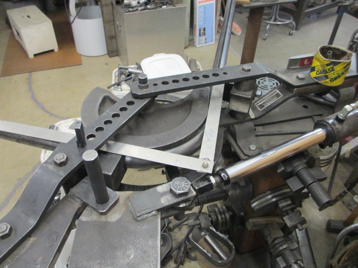

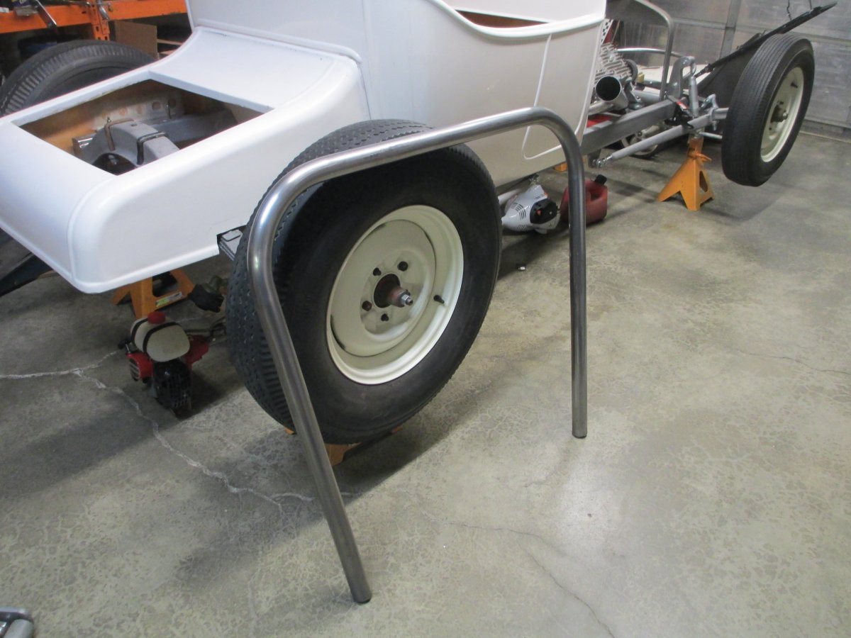

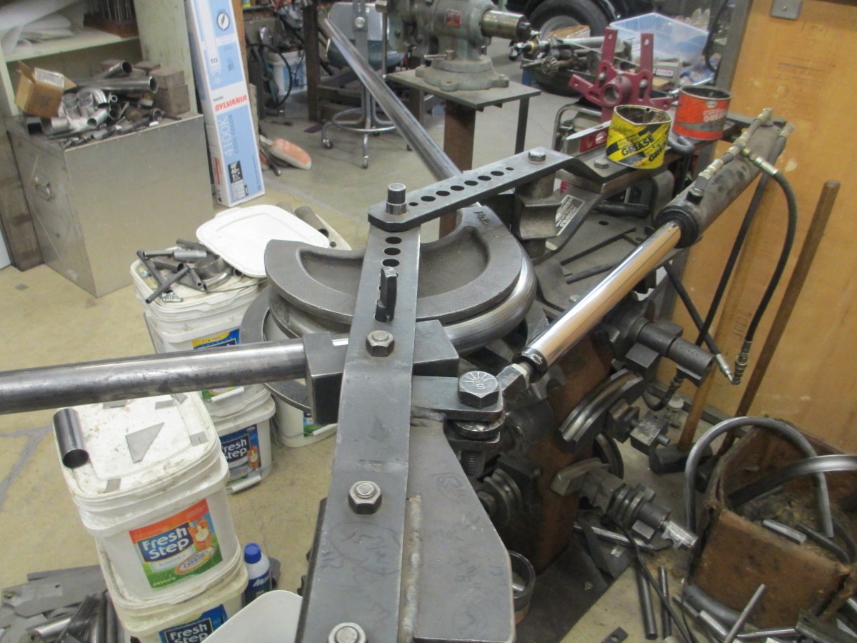

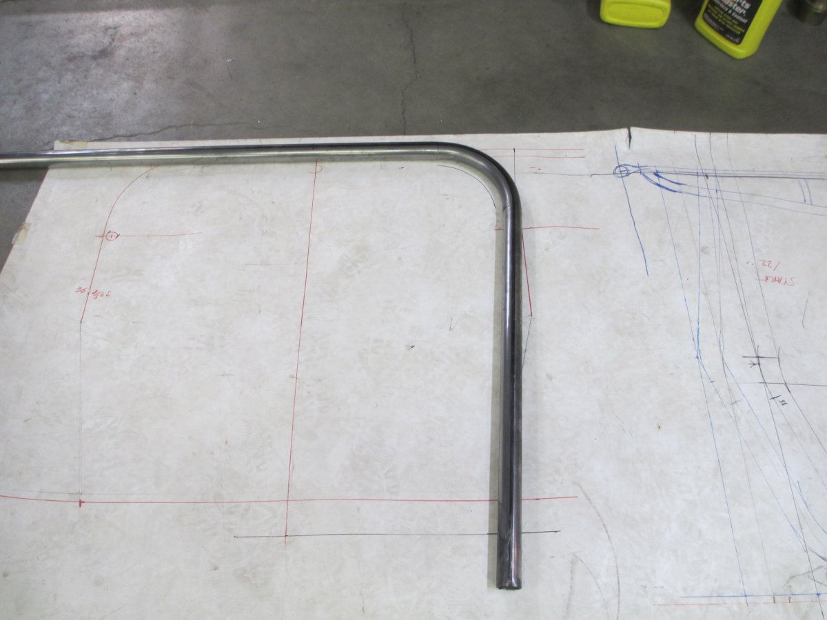

    Just got done reviewing your complete thread for inspiration, and a bit of guidance. Came back to this post where you made the rollbar. I noticed on your layout what appears to be 2 different layouts for the bends. The original appears to be 90 degree bends for the top bends, and very slight bends maybe 5 to 10 degrees to get the legs to the frame. However, the final hoop appears to be over 90 degrees at the upper bends, and then just straight legs to the frame.
    I'm going to lay out the rollbar for the Whatever project full scale over the weekend and would be interested in the pros and cons of each option. Once it's on paper I'm going to use some leftover bends and short sections to make a mockup of a hoop, but I'll wait for your recommendation. Thanks...
  20. Marty Strode
    Posts: 9,685
    Marty Strode
    OK Dave, there are only 2 bends in the roll bar. I use a 6-5/8" centerline die, and bend it slightly over 90 degrees. Hopefully you can decipher the layout on my drawing. IMG_8777.JPG
    Tim, bymanr, Dean Lowe and 2 others like this.
  21. Dave G in Gansevoort
    Posts: 3,744
    from Upstate NY
    Thanks Marty. Yes it's clear to me. I'll only have to adjust for the 6 inch centerline die that I have. I'll draw it out full size and get the angles.
