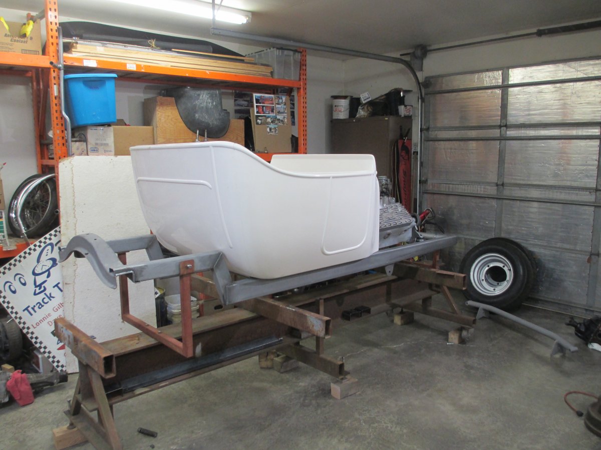

    I pulled the Speedway body out of a long storage, having bought it in 2003. After a rough cutout in the firewall area, and the body placed on the frame, it is time to layout the notches in the cowl and the bottom of the body. It will be dropped over the frame 2" at the cowl. Itchy work ! IMG_4067.JPG IMG_4068.JPG IMG_4070.JPG IMG_4071.JPG IMG_4073.JPG

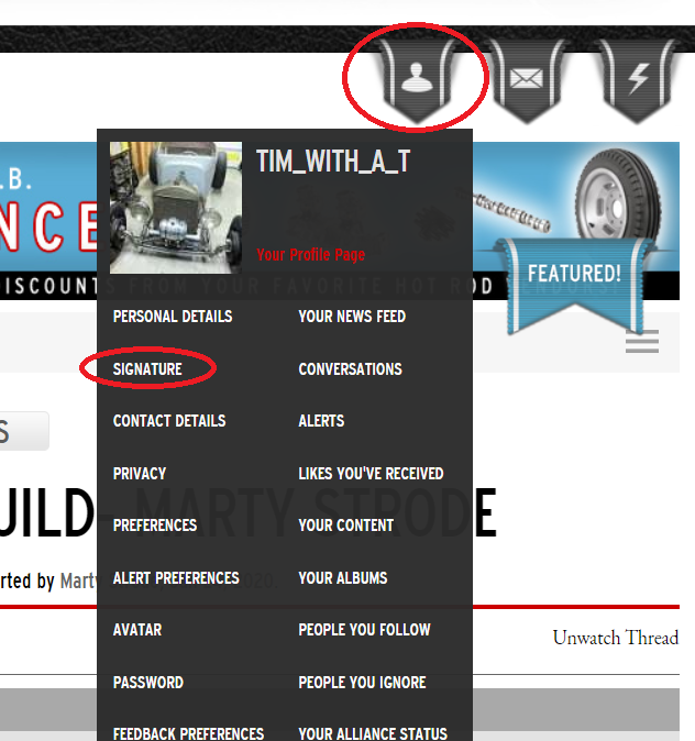

    Should be able to add the link using the signature feature. It is available in your personal profile

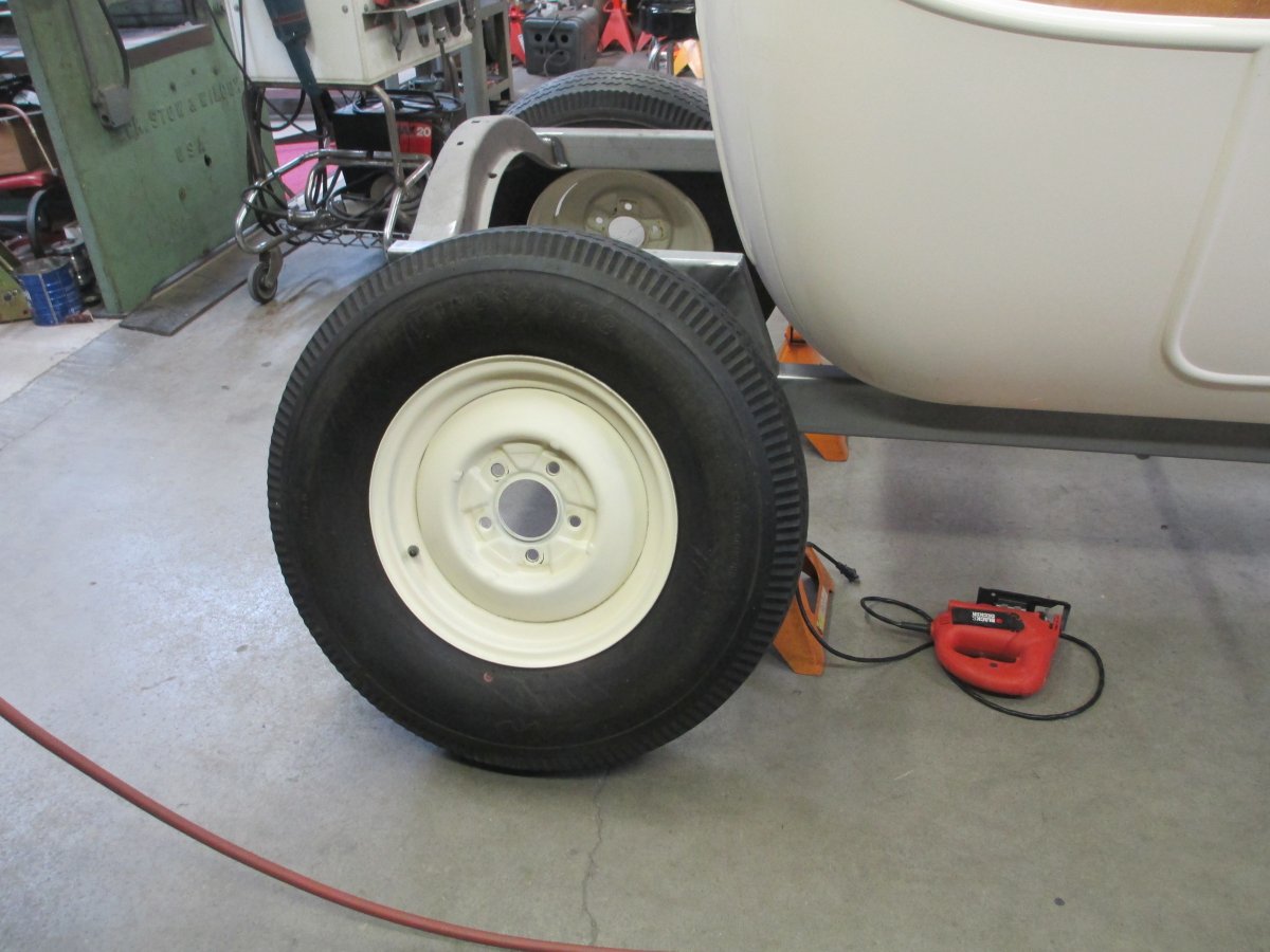

    While rounding up all the parts to get it on wheels, I placed an order from Speedway, and painted a pair of 16X4 wheels for the front, to match the 750x16 rears that were used on the Spalding. IMG_4079.JPG IMG_4081.JPG

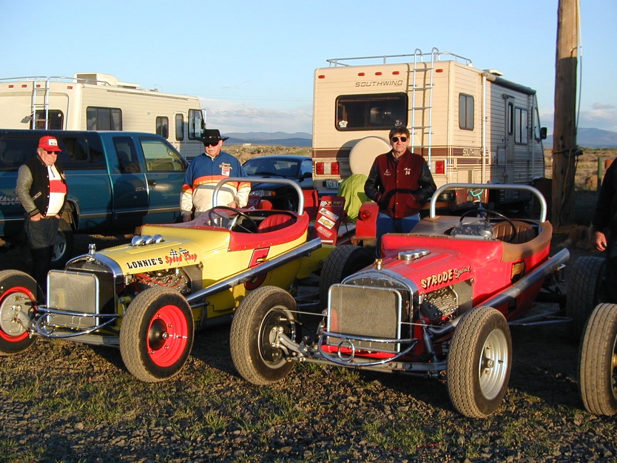

    Dave, you did see my car, along with Lonnie Gilbertson's there, and a selection of great open wheel vintage racers. It was Lonnie's first time out in his new car, back in 2001. P4270030.JPG P4270056.JPG P4270051.JPG

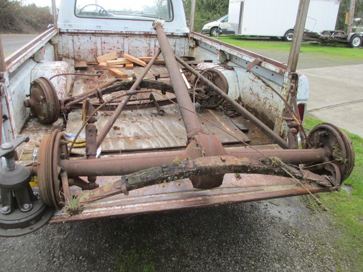

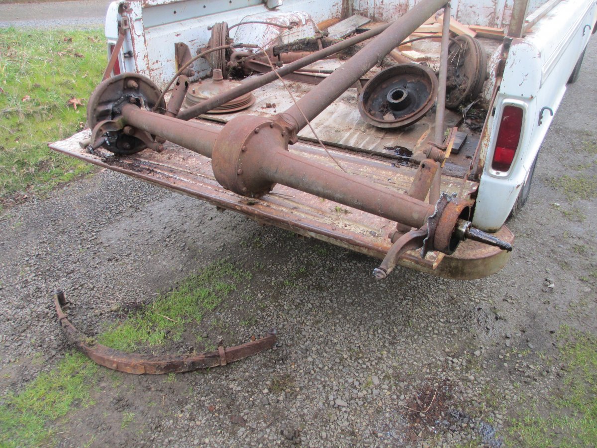

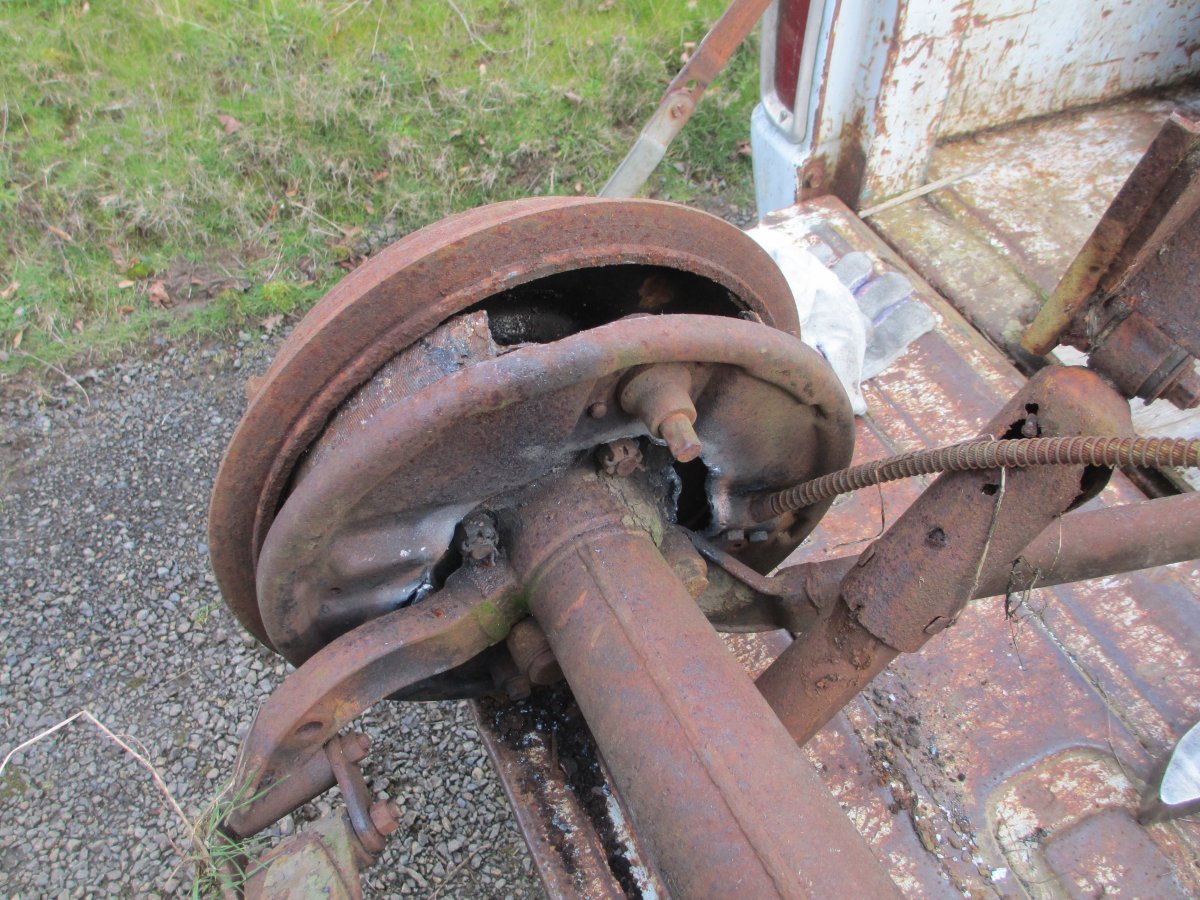

    Well, today I tackled the dirty aspect of the job. Around 20 years ago, I bought the underpinnings out of a clean 37 Ford coupe, and put the front and rear axles behind the shop, knowing I would tear them apart to use on the Track Roadsters. I forgot how heavy the complete rear end was, the young guy helping, didn't have a problem picking up his half, but it was a certainly a strain on this old man ! Knowing the hubs would be locked onto the brakes, I used my pal Ernie's, killer hub puller. I built an adapter to fit the wide 5 stuff, years ago. It also required torching the backing plates, for removal, they were mechanical units anyway. Anyone who has fiddled with early Ford rear ends, knows just how hard it is to find housings with nice bearing races at the ends, these are perfect ! You should have been here when I torched those shackles, YOWSER !!!! IMG_4171.JPG IMG_4172.JPG IMG_4173.JPG IMG_4175.JPG IMG_4178.JPG

    A 'light' duty puller! :eek:
