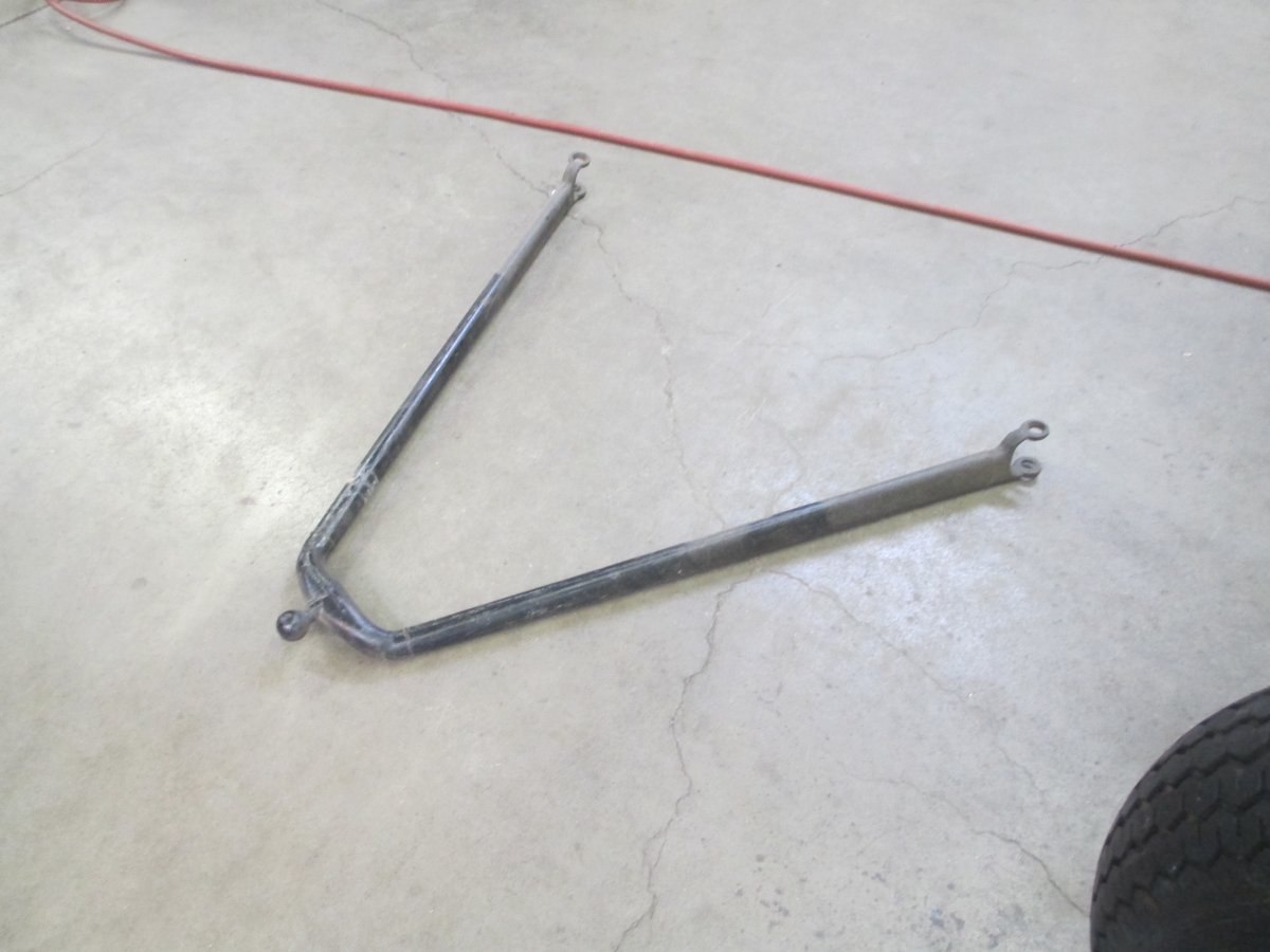

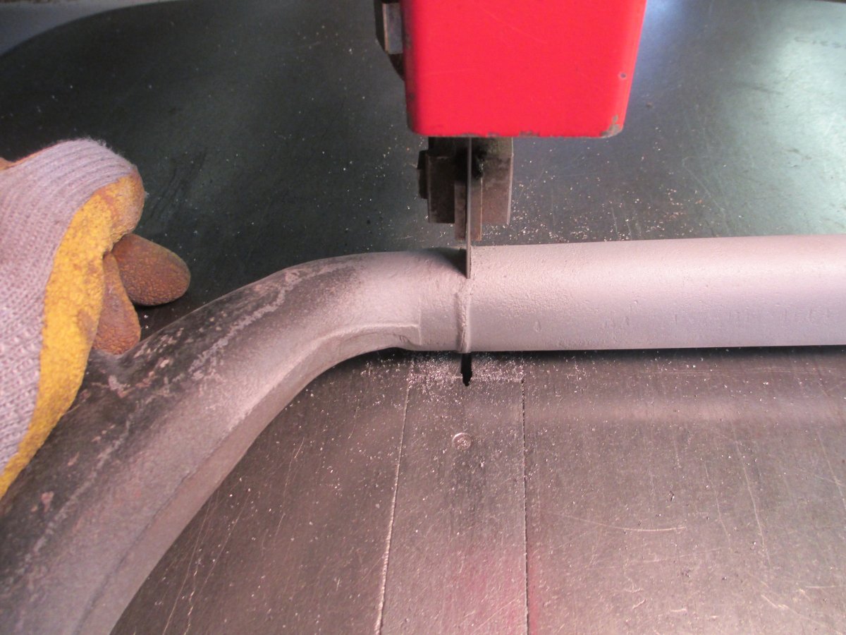

    IMG_4212.JPG The Sandblaster got the wishbone cleaned up and it's a really nice one. Model A bones don't have much caster built in, so I will cut, tip and re-weld later. I thought I had a correct spring for this application, but it looks like I need to order one, to complete this phase on construction. Meanwhile, I can mount the master cyl and pedals. Tomorrow I will be hopping back to the 29 RPU. IMG_4204.JPG IMG_4206.JPG IMG_4207.JPG IMG_4209.JPG IMG_4210.JPG

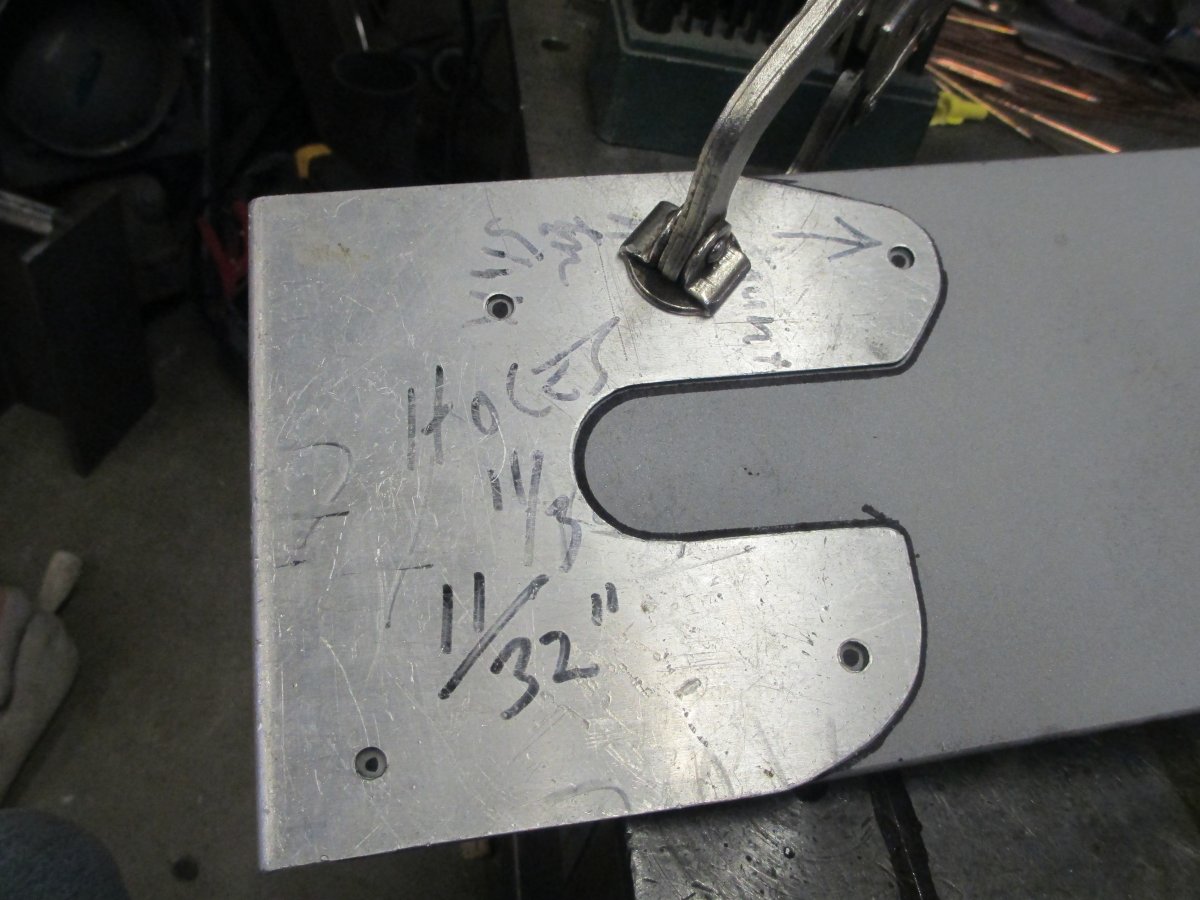

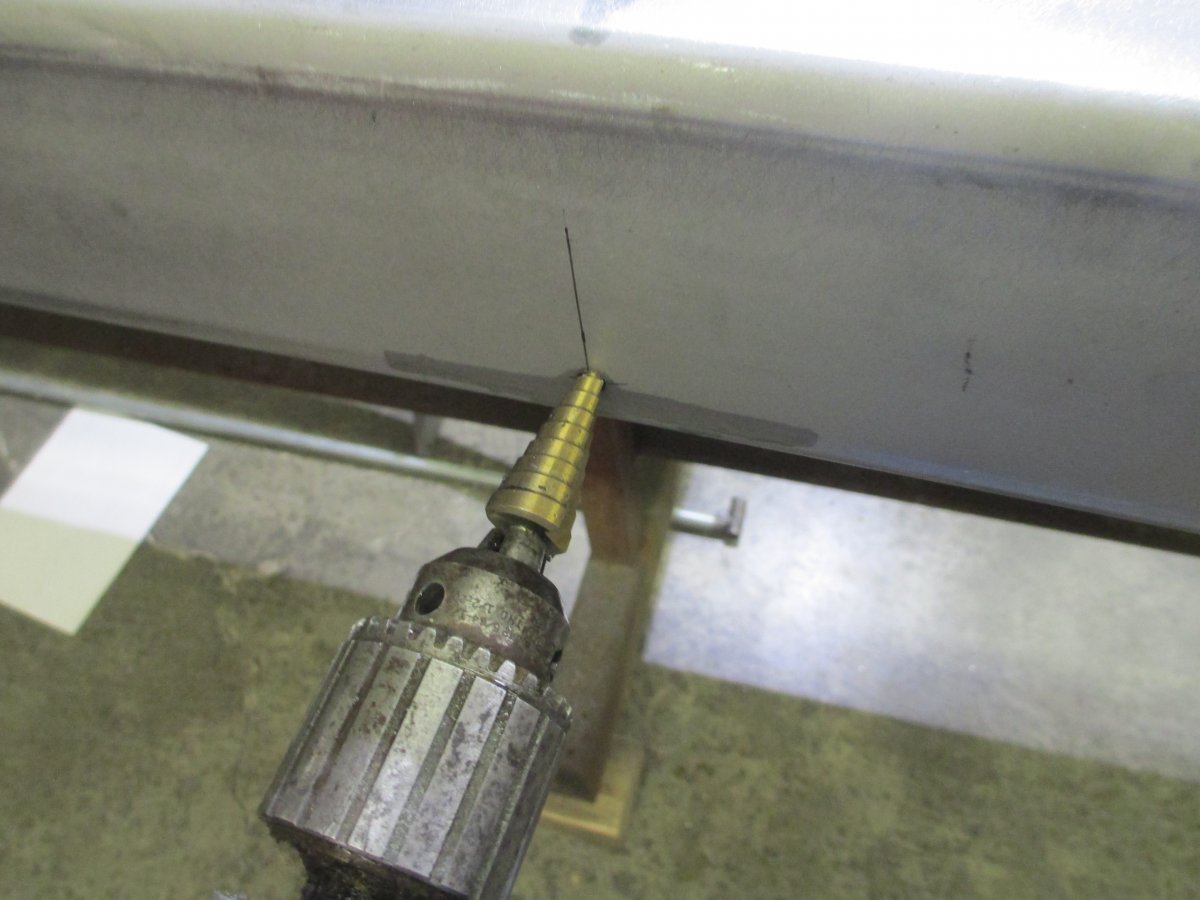

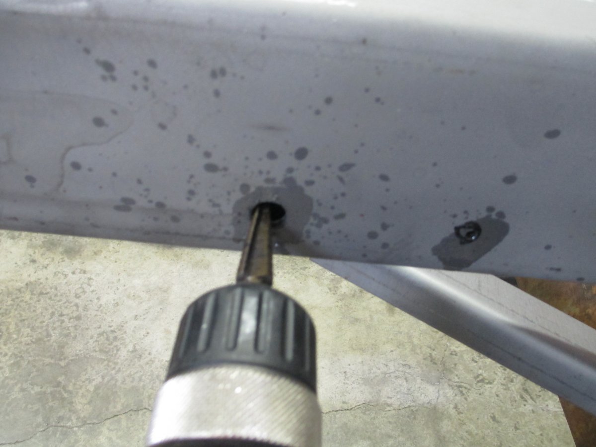

    It was time to install the sleeves for the rear suspension arms. The sleeves are 1" OD with a 5/8" bore, that are angled through the frame rail to allow for the angle of the arms. I made the clamp on drill guide to drill a 1/4" hole for a pilot on both sides, and followed up with step drills to bore 1" holes. IMG_4250.JPG IMG_4251.JPG IMG_4252.JPG IMG_4254.JPG IMG_4256.JPG IMG_4264.JPG

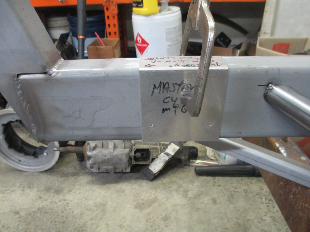

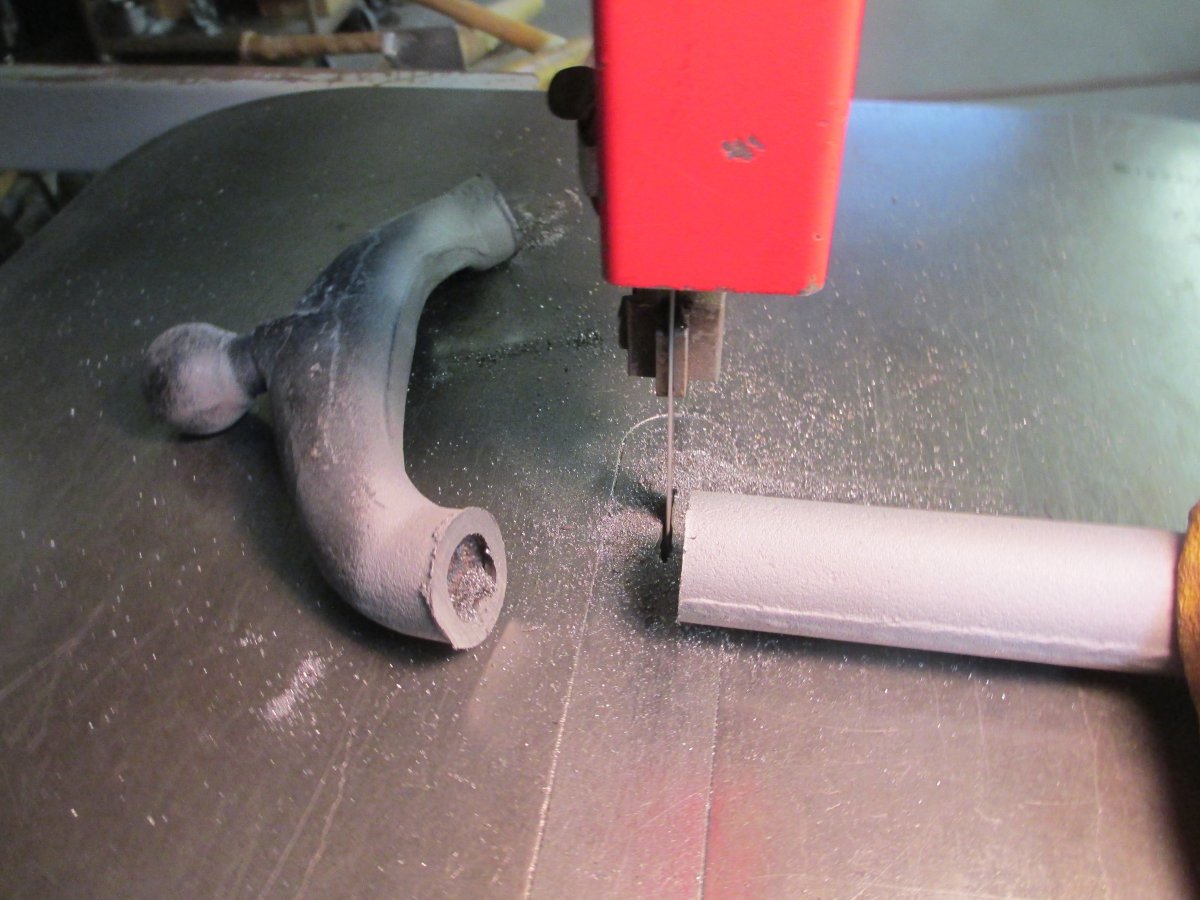

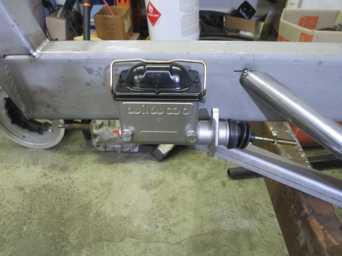

    While working in the same area, it was natural to mount the master cyl. Here again, the center punch template, made the job simple. The front spring arrived today, so the next move will be cutting and welding the bones for caster correction. IMG_4255.JPG IMG_4262.JPG IMG_4263.JPG IMG_4265.JPG

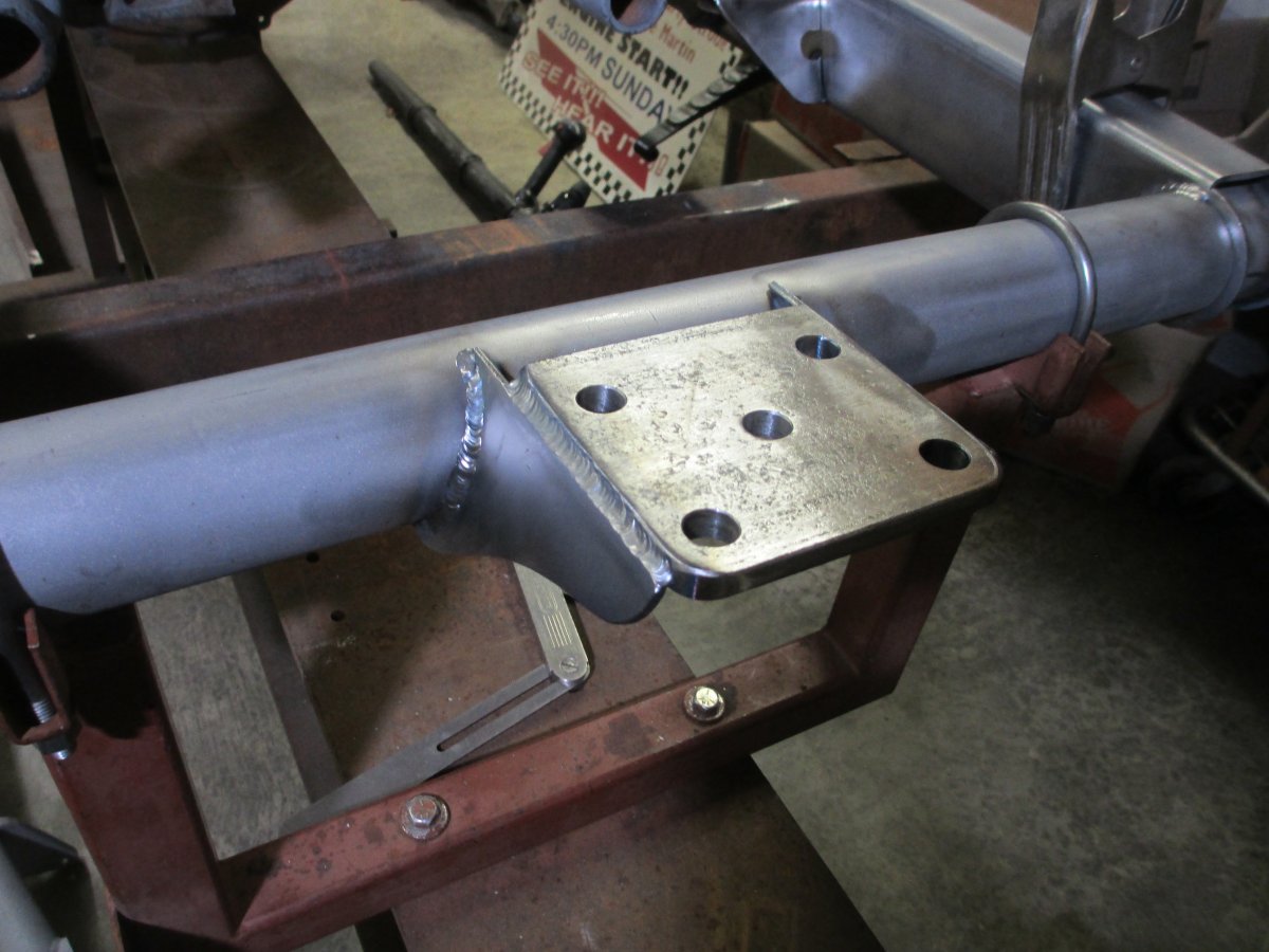

    Today, I got the body mounting rails fabbed and fit in place, and ready to s***ch weld to the side of the frame. When final ***embled there will be 1/8" neoprene rubber sandwiched between the body and mounting flange. IMG_4272.JPG IMG_4273.JPG IMG_4270.JPG IMG_4274.JPG IMG_4269.JPG

    I like your templates, how many did you build before you started using these?
    loudbang and Stogy like this.

    When I started the first one (red#7) I had hopes of building more than the first two, so that is when the template making started. Ironically, in the basic car, the only change I made was moving the pedals 1" forward from the location on the first two cars.

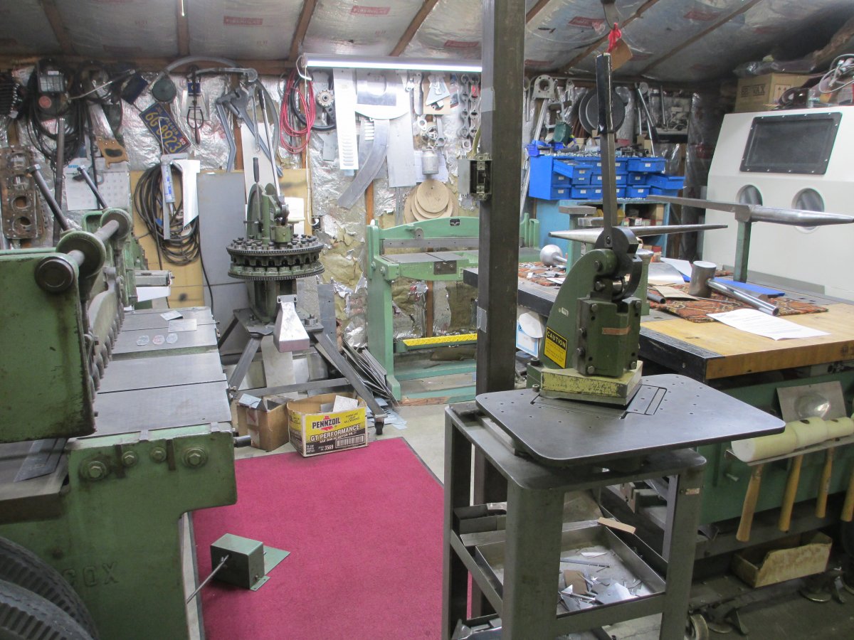

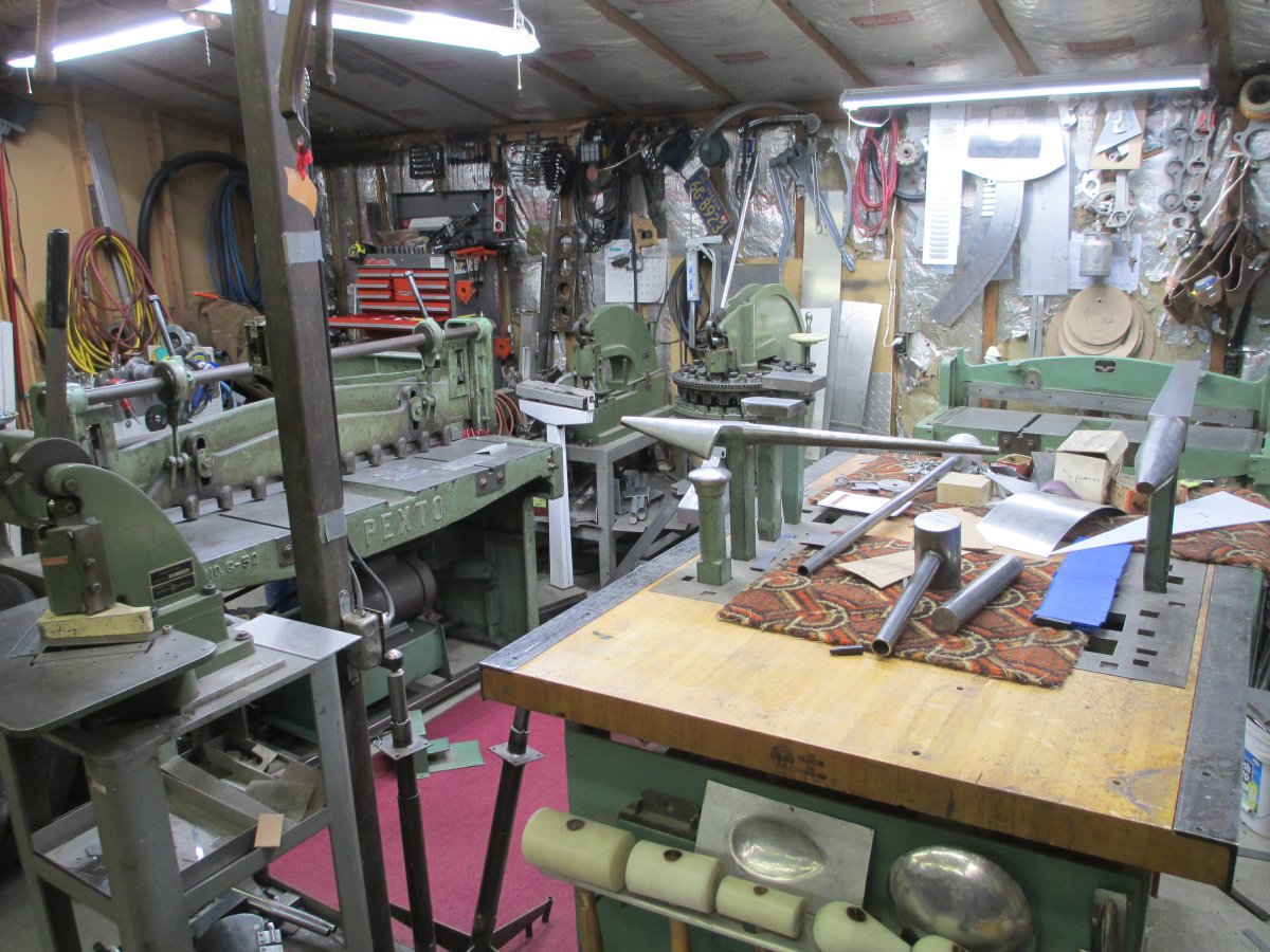

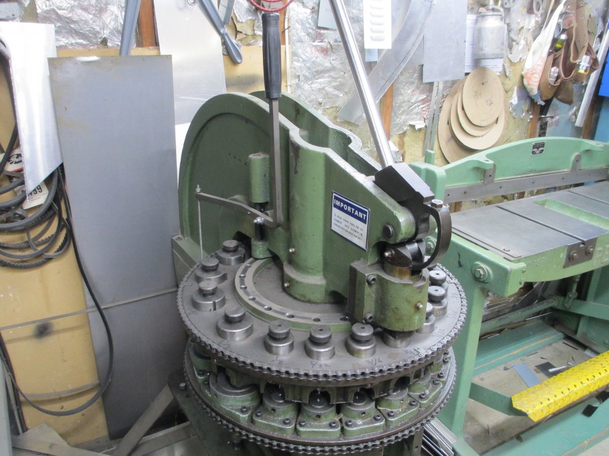

    What is the machine in this photo used for? I never saw one before.
  19. Graham08
    Joined: Oct 2, 2007
    Posts: 154
    Graham08
    It's a turret punch. That one looks like a DiAcro. They're a huge time saver in a a fab shop because they have 12 or 16 punch sizes that you can quickly change between without tools. I wish I had one!

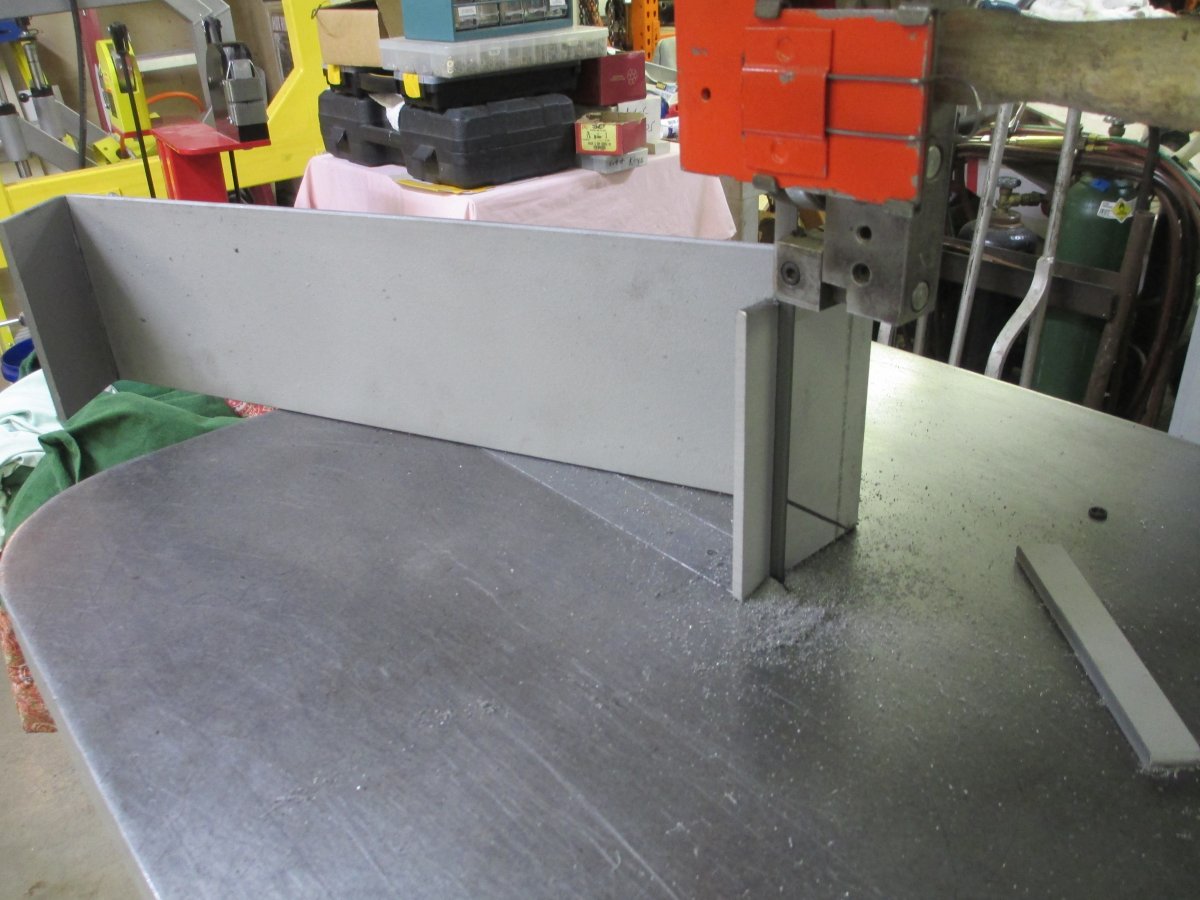

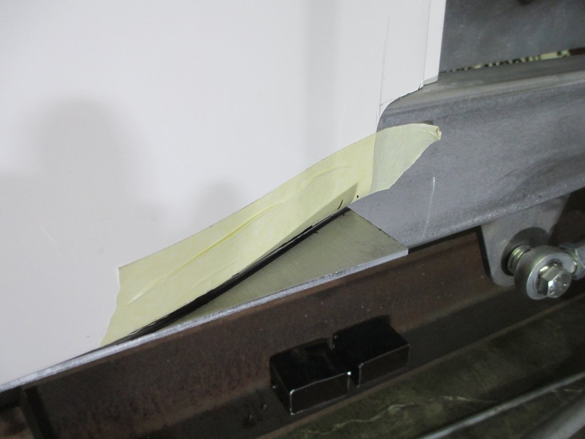

    You are correct Graham, it is a Di-Acro Houdaille Turret Punch, with 18 stations and an 18" throat. The 6" notcher in the foreground is the same manufacture, and they are 2 of the most time saving machines I have. They really shine at prototyping brackets out of light sheet metal, to be reproduced from the desired metal thickness for the job. And the article in Rodders Journal #10 was a dream come true, and put Pat and I back in contact after nearly a decade, and eventually led to the building of the Spalding Copy. As far as building one of these cars, you won't build a car any cheaper, or have as much fun for the money as one of these, providing you build it your self. Thank you all for your interest ! IMG_4284.JPG IMG_4282.JPG IMG_4285.JPG

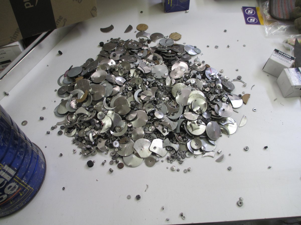

  26. alchemy
    Joined: Sep 27, 2002
    Posts: 22,705
    alchemy
    Do you keep all the plugs from the puncher to fill holes in old frames and stuff?

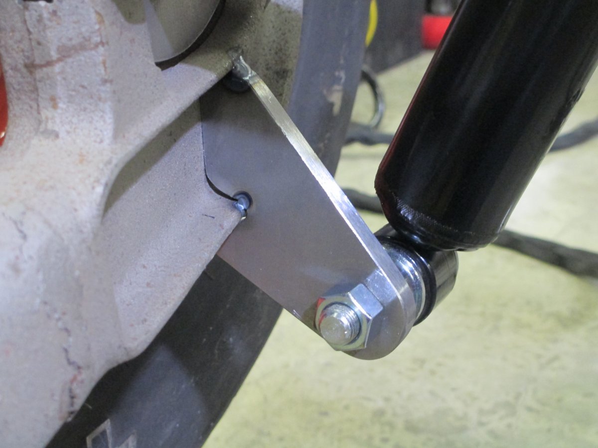

    I certainly do, they come in handy for plugging holes in firewalls, fenders and frames. Also, since my earlier post, I cut out a couple of lower shock mounting brackets for my 40 Pu, using that process. IMG_4301.JPG IMG_4294.JPG IMG_4302.JPG IMG_4303.JPG
