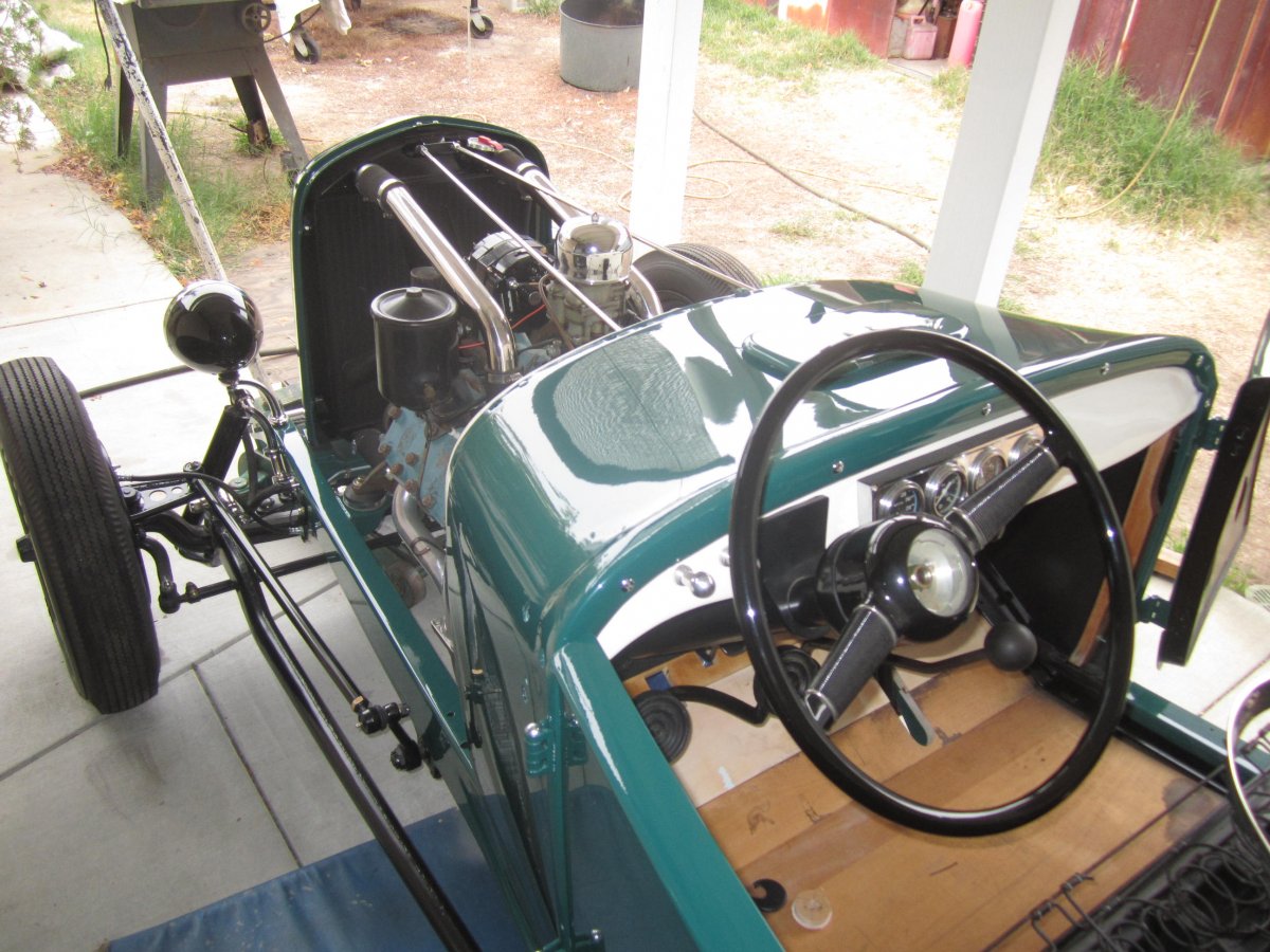

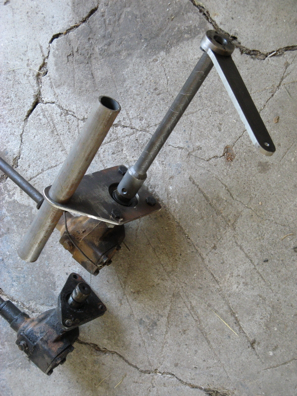

    Frenchtown, this is a street car, seating 2 people and this is the best setup I have found with very minimal bump steer, clearance around the engine, 2013-03-29 204602.jpg 2013-03-29 204642.jpg

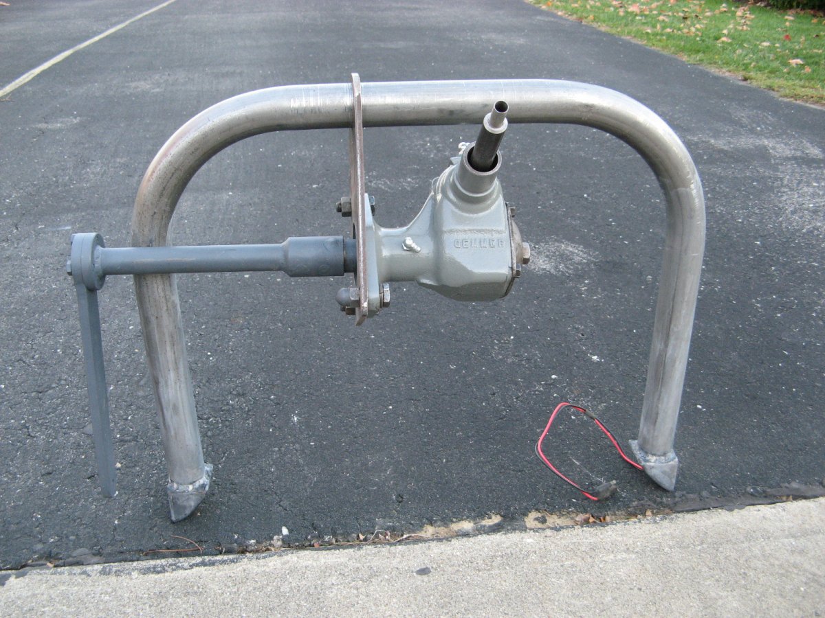

    Marty, what years are the VW steering boxes out of? Do they have to be reversed or can you use them straight out of the box? Thanks.

  3. studebakerjoe
    Joined: Jul 7, 2015
    Posts: 1,177
    studebakerjoe
    alan, I'm sure Marty will answer but I can tell you they're most likely 55-67 boxes. In 68 they didn't have the long steering shaft.
  4. Marty Strode
    Joined: Apr 28, 2011
    Posts: 9,689
    Marty Strode
    Alan, Joe is correct, 67 and older, with the V-split windshield. I have been using them for 50 years, probably had 20 or so, only one steered backward, so I used it when building this fellas 29, with the arm down. IMG_3394.JPG

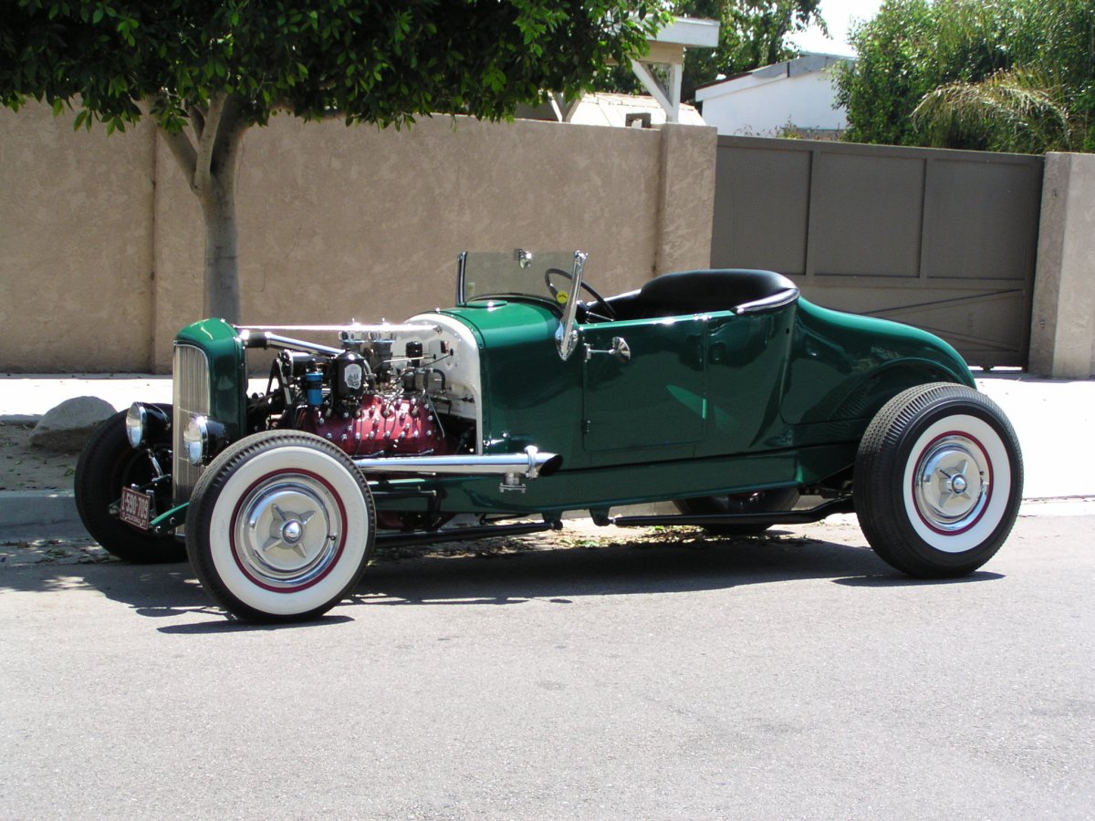

  5. ZZLEGEND

    Marty, that's the same one i used. Getting harder to find. Hope you don't mind me posting.

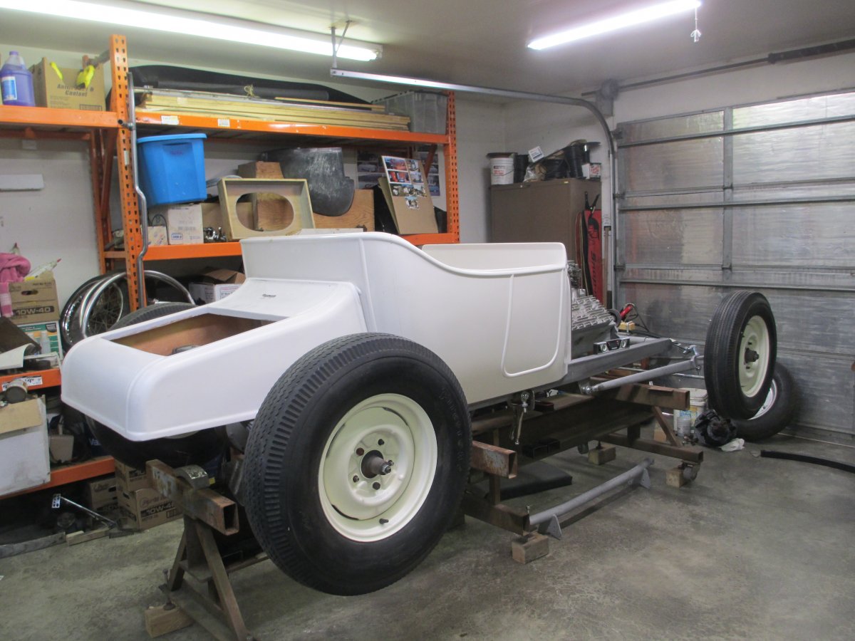

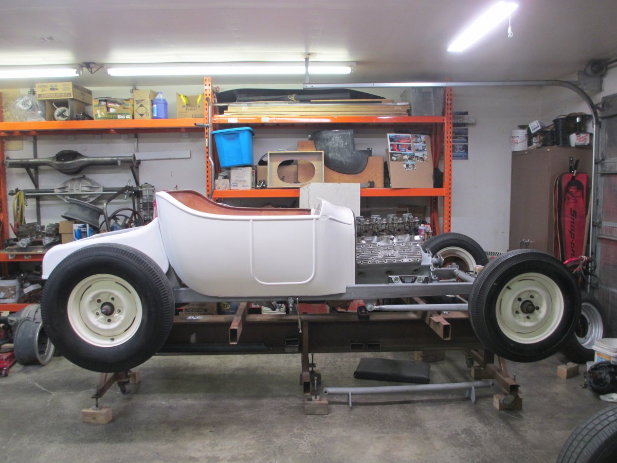

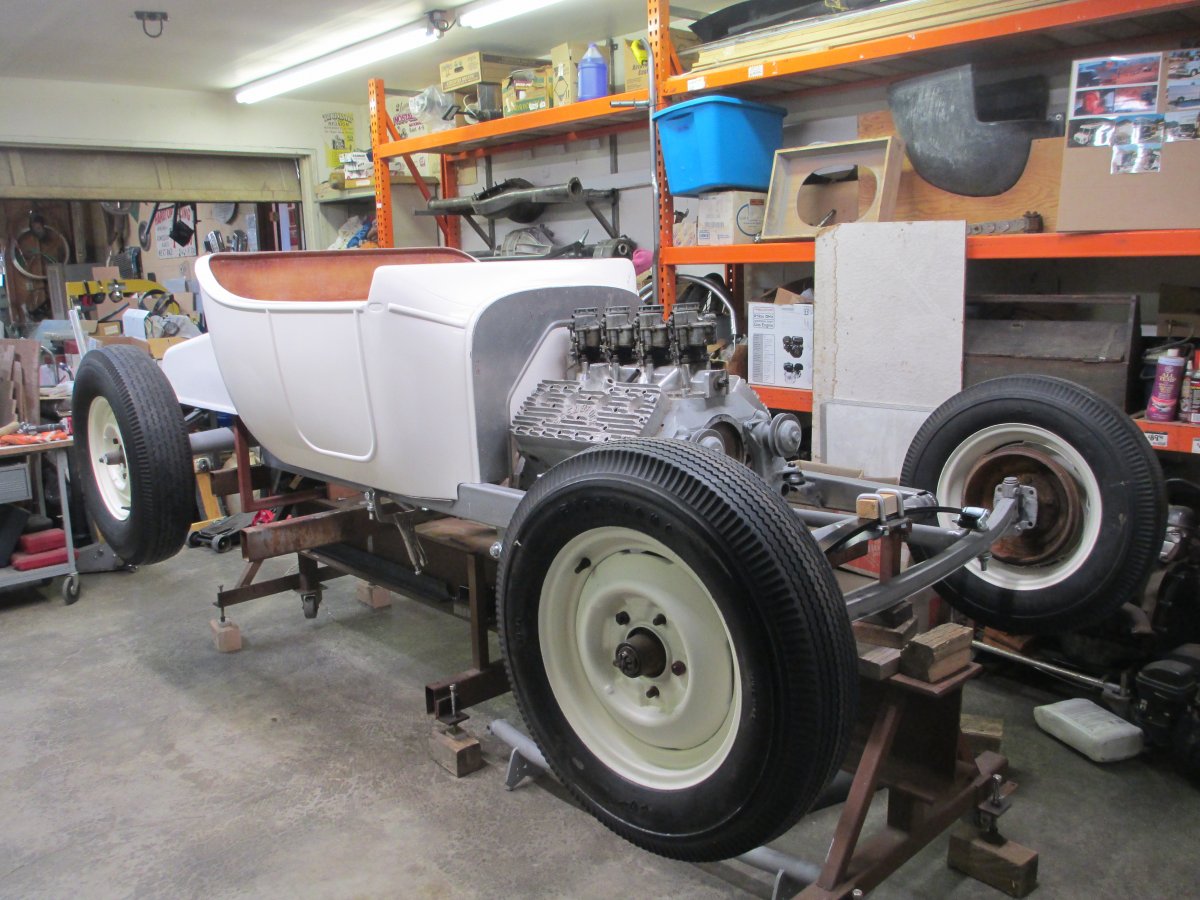

    Now that I am pretty much done with the '40, I put on hubs, wheels and tires on #10 for perspective. The turtle deck needs t******* for axle housing and spring clearance. With luck, it should be sitting on the floor, by the end of the week, at proper ride height. IMG_4398.JPG IMG_4399.JPG IMG_4400.JPG
