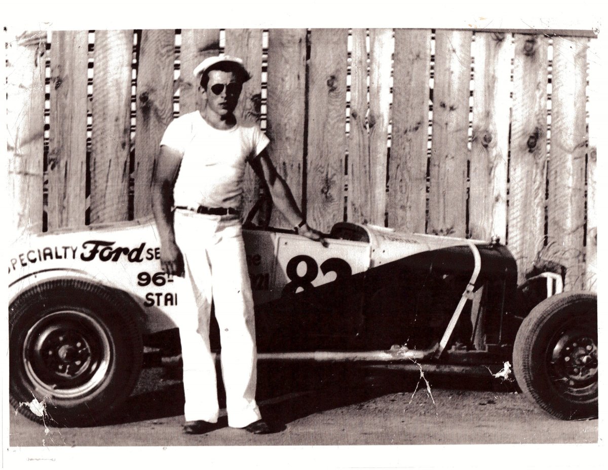

  29. Marty Strode
    Joined: Apr 28, 2011
    Posts: 9,686
    Marty Strode
    Lynn, your figures couldn't be much closer, the 25 and older bodied cars have 100" wb, like a stock "T". The 26-27 ch***is I built was 103.5 like a model A. The big difference being, on a 26-27, the body dictates the rear axle location, whereas on the early ones the rear axle can shuffle forward, and look OK. I started out with a 27 steel body, and wanted something similar to the Don Turner car pictured below, for the street, but with the amount of engine set back, I couldn't make it work. 2012-07-10 180022.jpg
