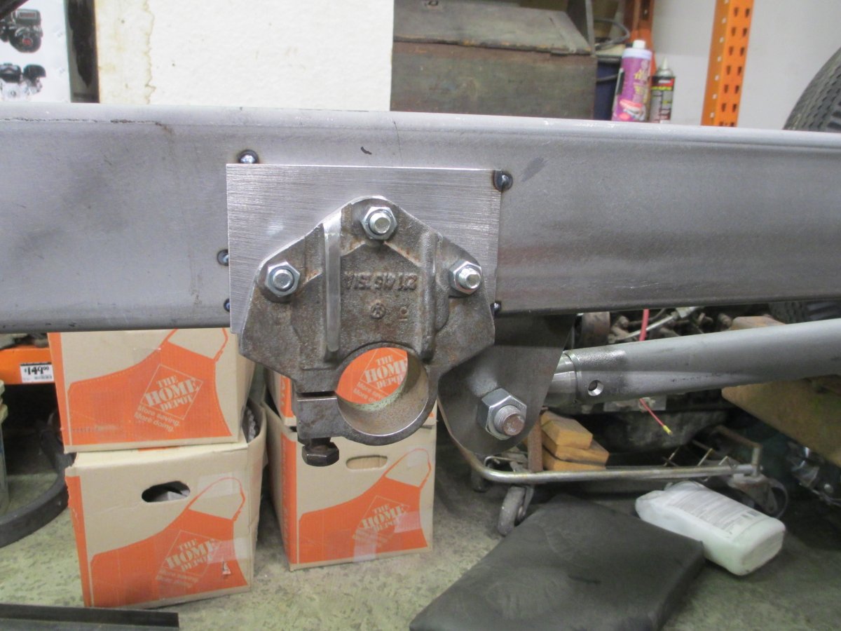

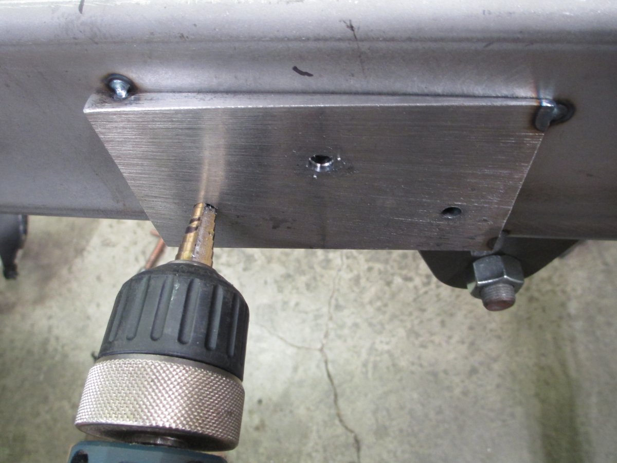

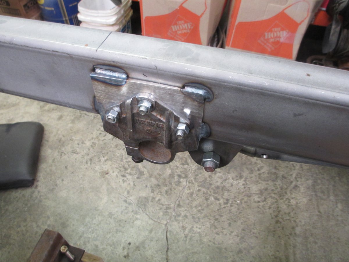

    Here is the rough steering box install. I weld a wedge plate on the inside of the rail, to tip the column inboard at the wheel. After clamping the mounting bracket , with the plate sandwiched between, I tack the plate to the frame. After transfer punching the hole pattern, I drill 5/32 pilot holes, followed with a 1/4" drill. The drill guide with the angled foot, allows drilling through the rail, using a long bit. I enlarged the holes to 3/8" and bolted on the bracket. Next will come, drilling the holes to 1/2" all the way through, to install sleeves, to prevent squeezing the rail, when fully tight. There will also be a bung welded in the bottom rail, for an additional 3/8" bolt. The neat aspect of this box and bracket arrangement is the dual pinch bolt, to pivot the box, changing the angle of the mast, before installing the mount under the dash. IMG_4480.JPG IMG_4481.JPG IMG_4473.JPG IMG_4474.JPG IMG_4475.JPG IMG_4476.JPG IMG_4477.JPG IMG_4479.JPG

    To finish the steering mount install, it required a few extra steps. The VW mount had .430 dia holes, and needed to be sleeved down for 3/8 bolts. So I drilled the mount out to 31/64" and turned down some 1/2" tube, and tacked the sleeves with silicone bronze, and ground both sides flush. Using a step drill, the frame holes were enlarged to 1/2" and sleeves were fully welded through the frame. I used a .010 over reamer to get a final fit on the holes. Notice the slot I milled in the lower mount, it allows for a 3/8" Allen bolt to secure the mount from the bottom. Back to the front end, for caster correction on the bones, and cap the bull noses on the rails tomorrow. IMG_4482.JPG IMG_4483.JPG IMG_4485.JPG IMG_4487.JPG IMG_4489.JPG IMG_4490.JPG

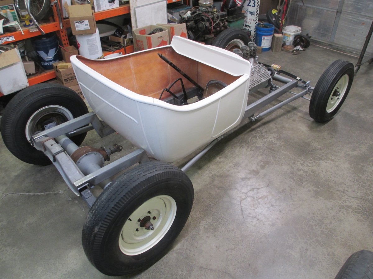

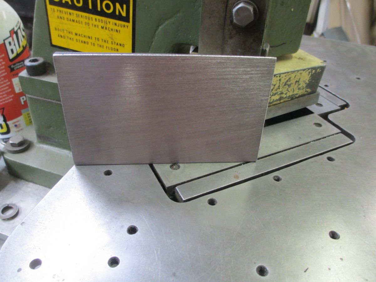

    More detail work. Got the caps for the frame rails fit in place, I will weld them in the morning, when I am rested. Should get the caster corrected on the front bones, tomorrow and have it sitting on the floor Saturday. IMG_4491.JPG IMG_4492.JPG IMG_4493.JPG IMG_4494.JPG IMG_4495.JPG IMG_4496.JPG IMG_4498.JPG IMG_4500.JPG IMG_4499.JPG IMG_4501.JPG IMG_4502.JPG

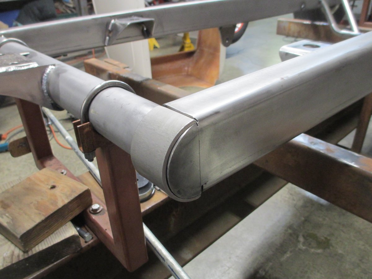

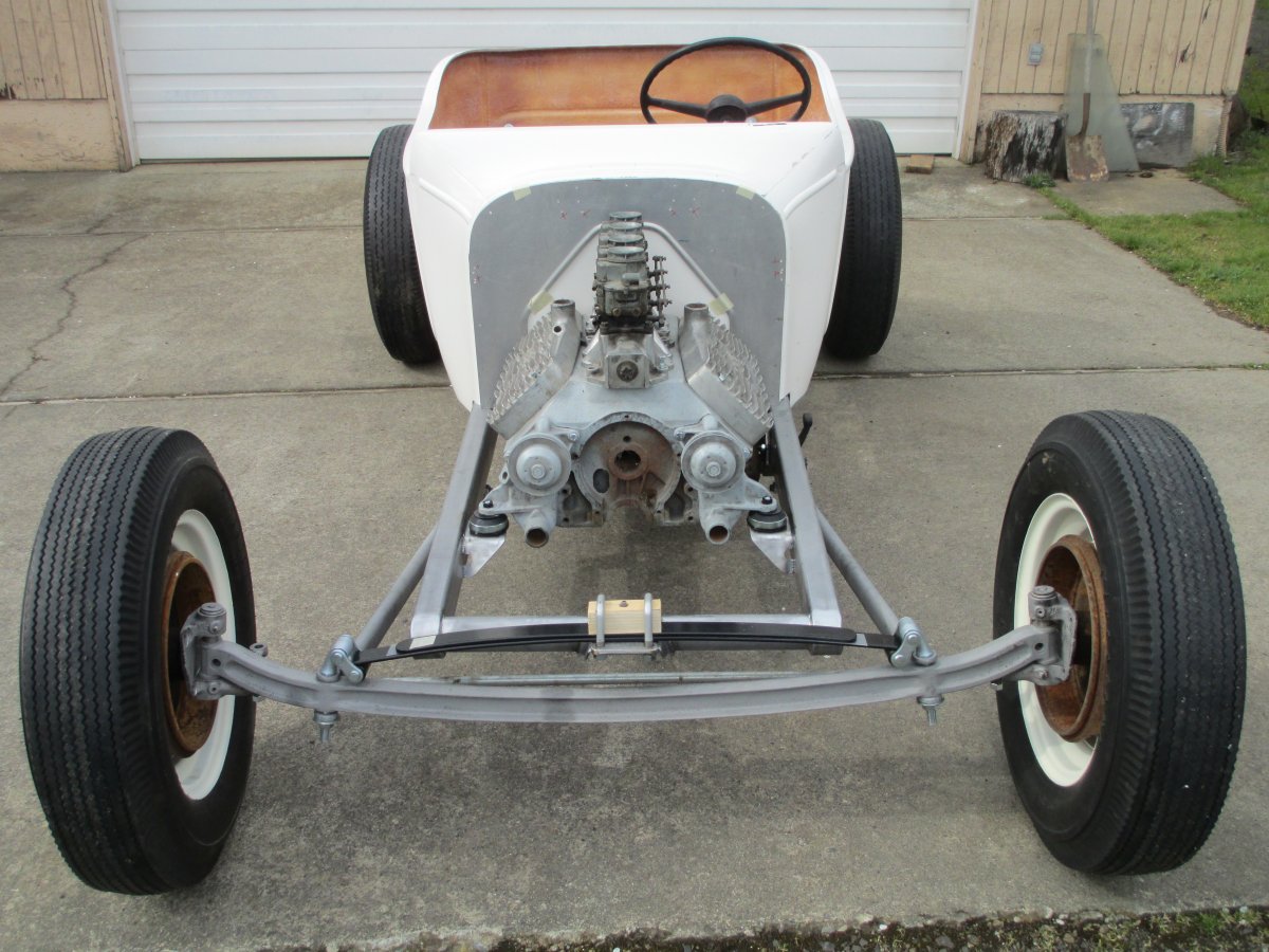

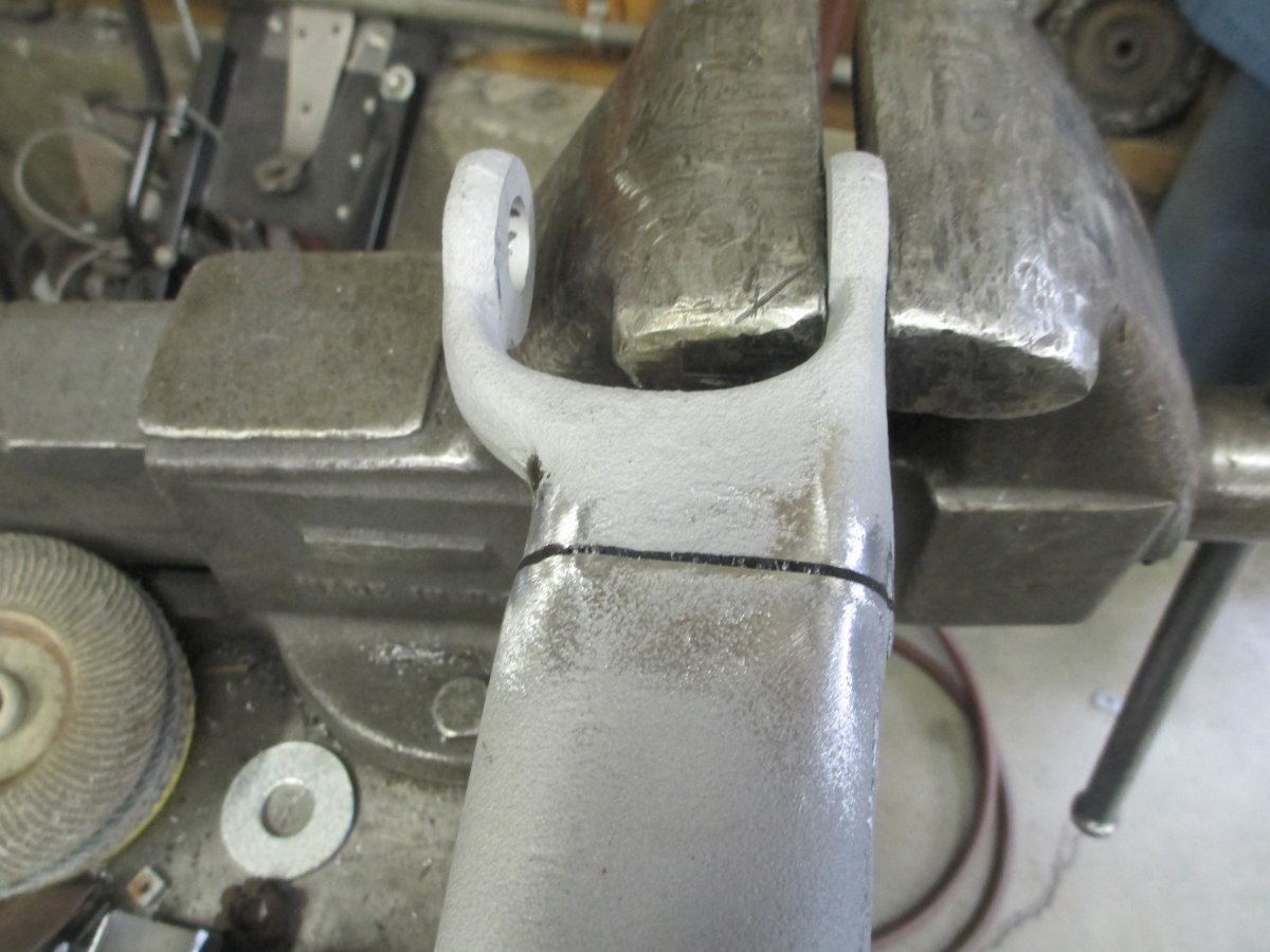

    Got all of the welding on the front of the ch***is done. When welding the caps, I leave the front inside weld until the rest is ground and finished. When doing the caster correction on the front bones, I saw from the bottom up, leaving around 1/2" uncut. That way I can bend to the proper angle (2 degree change) and weld the bottom. Once the car is on the ground, if I need to make changes, I can saw the lower weld and change the angle. Looking across the shackles, I think it's pretty close. A little more welding in the morning, and I will pull it out of the jig, reinstall the engine, and body. IMG_4504.JPG IMG_4505.JPG IMG_4507.JPG IMG_4513.JPG IMG_4515.JPG IMG_4518.JPG IMG_4517.JPG IMG_4521.JPG IMG_4523.JPG IMG_4522.JPG

    Pulled it from the jig, it rolls !!!! IMG_4526.JPG IMG_4529.JPG IMG_4531.JPG IMG_4534.JPG IMG_4535.JPG IMG_4540.JPG IMG_4541.JPG

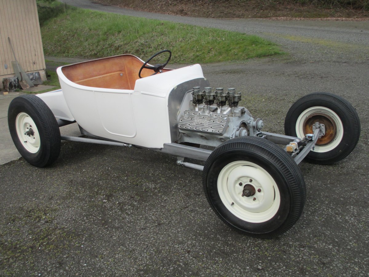

    Well, the weather permitted rolling it outside, for some longer distance shots, with the turtle hull attached. IMG_4542.JPG IMG_4543.JPG IMG_4544.JPG IMG_4545.JPG IMG_4547.JPG IMG_4548.JPG
