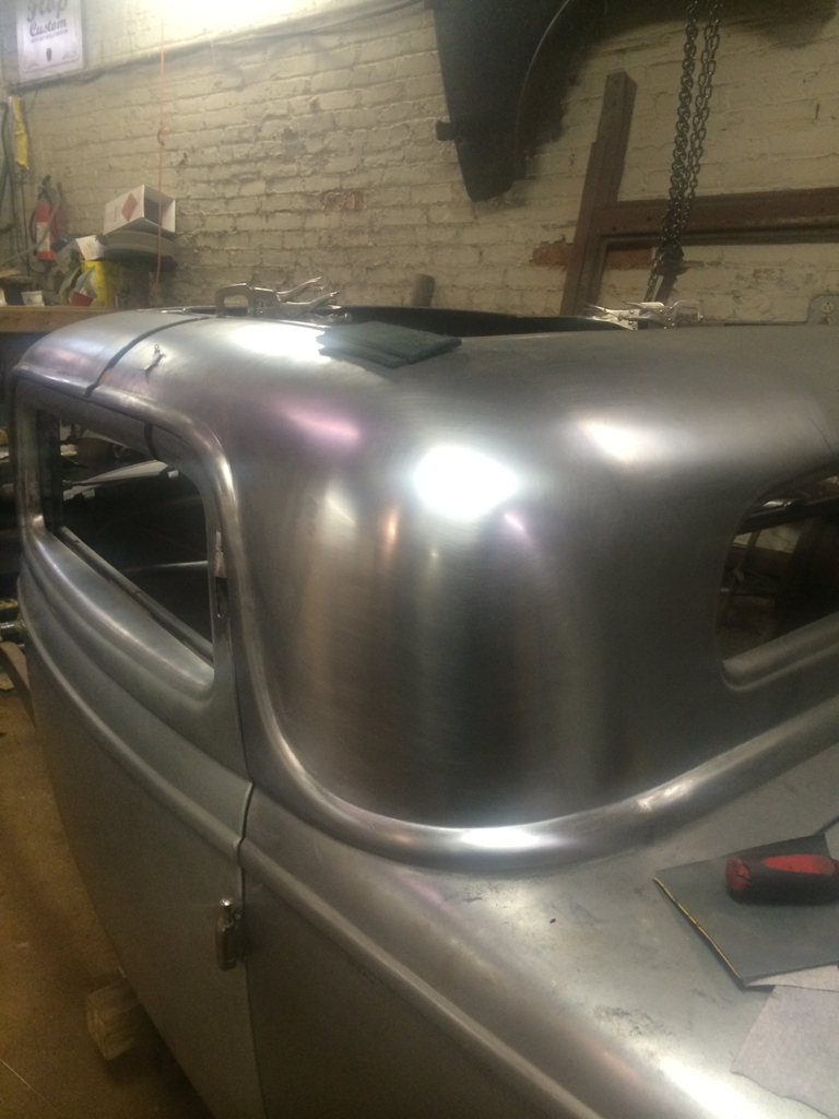

    Details and cleanup of the metal today
  10. What did you use for the cleanup of the metal?

    At the risk of getting flamed for a really stupid question (one of my personal specialties)....... why did you start with panels and the subframe rather than just get a complete body?
    Is it to perfect the fit and finish compared to what Brookville consider 'good-enough'? Are they that much worse than Henry's original?
    Anyway, subscribed and looking forward to regular updates over the rest of the build.
  12. Flop
    Joined: Jun 8, 2006
    Posts: 3,885
    Flop
    Tightening things up !

    I get cars unassembled because then I have complete control .

    Is that upper door to quarter gap correction done in lead or steel?

    John it's all steel .
    Stanchions fitting the way I like em
    This side just about done . Doors latching etc

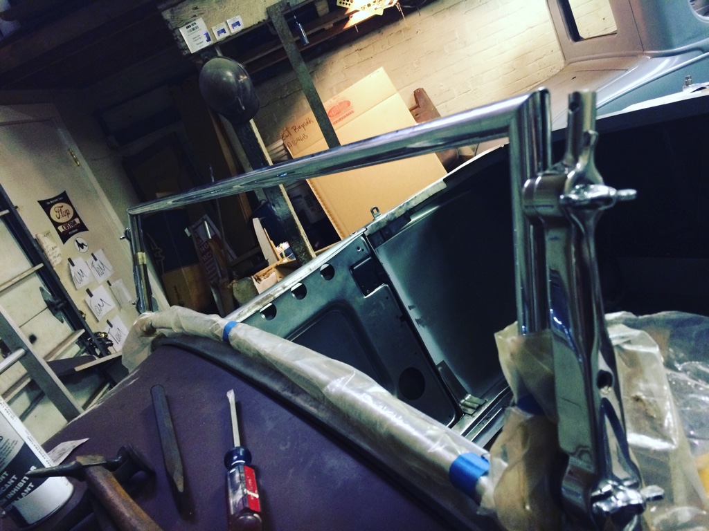

    Rather be homeless then chromeless . ImageUploadedByH.A.M.B.1465081428.851293.jpg
    kiwijeff, grumpy32, Stogy and 2 others like this.
