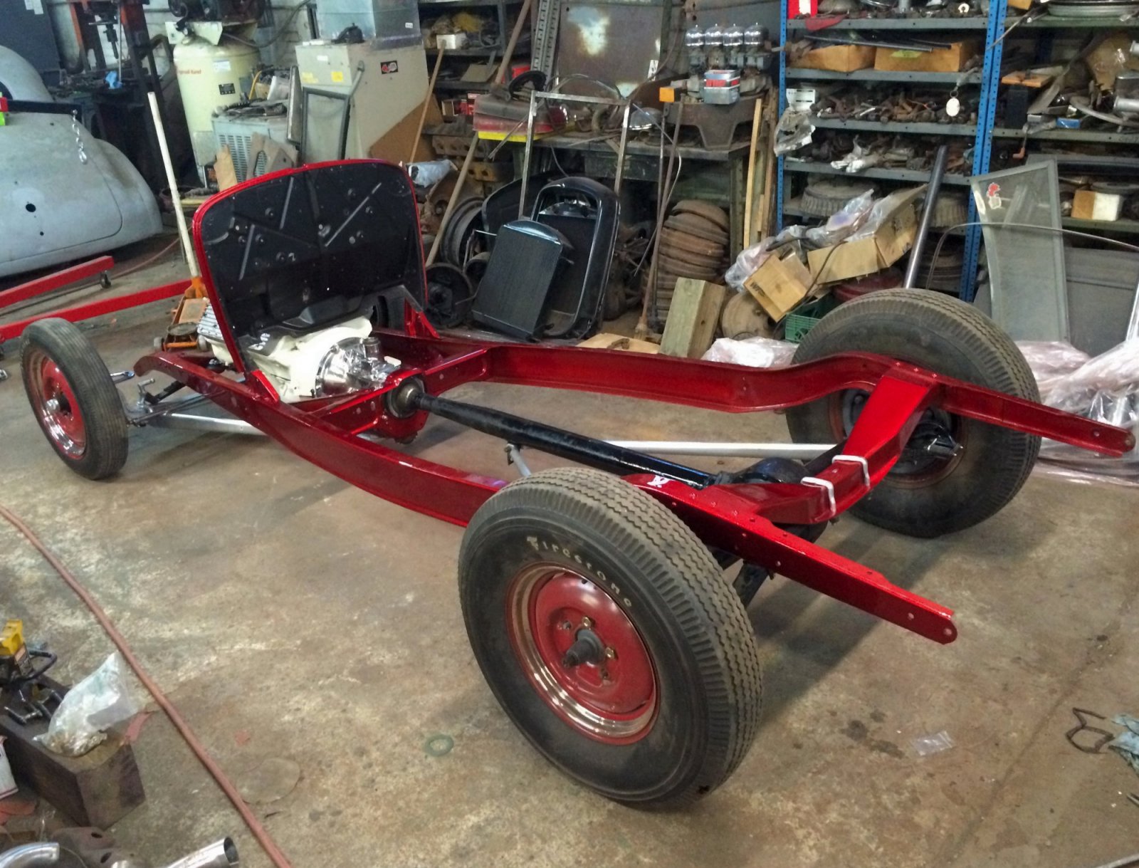

    Do you have anymore pictures of your front crossmember? I'm doing the same thing now. I was curious where you spliced in the Model A center?

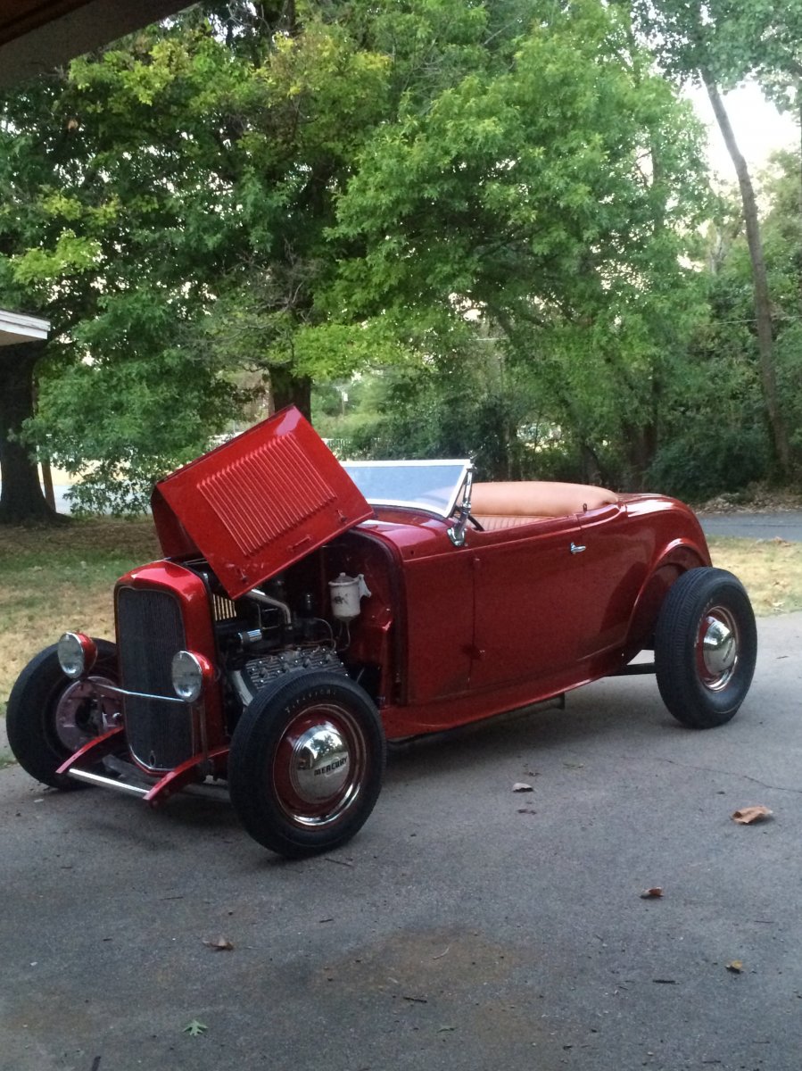

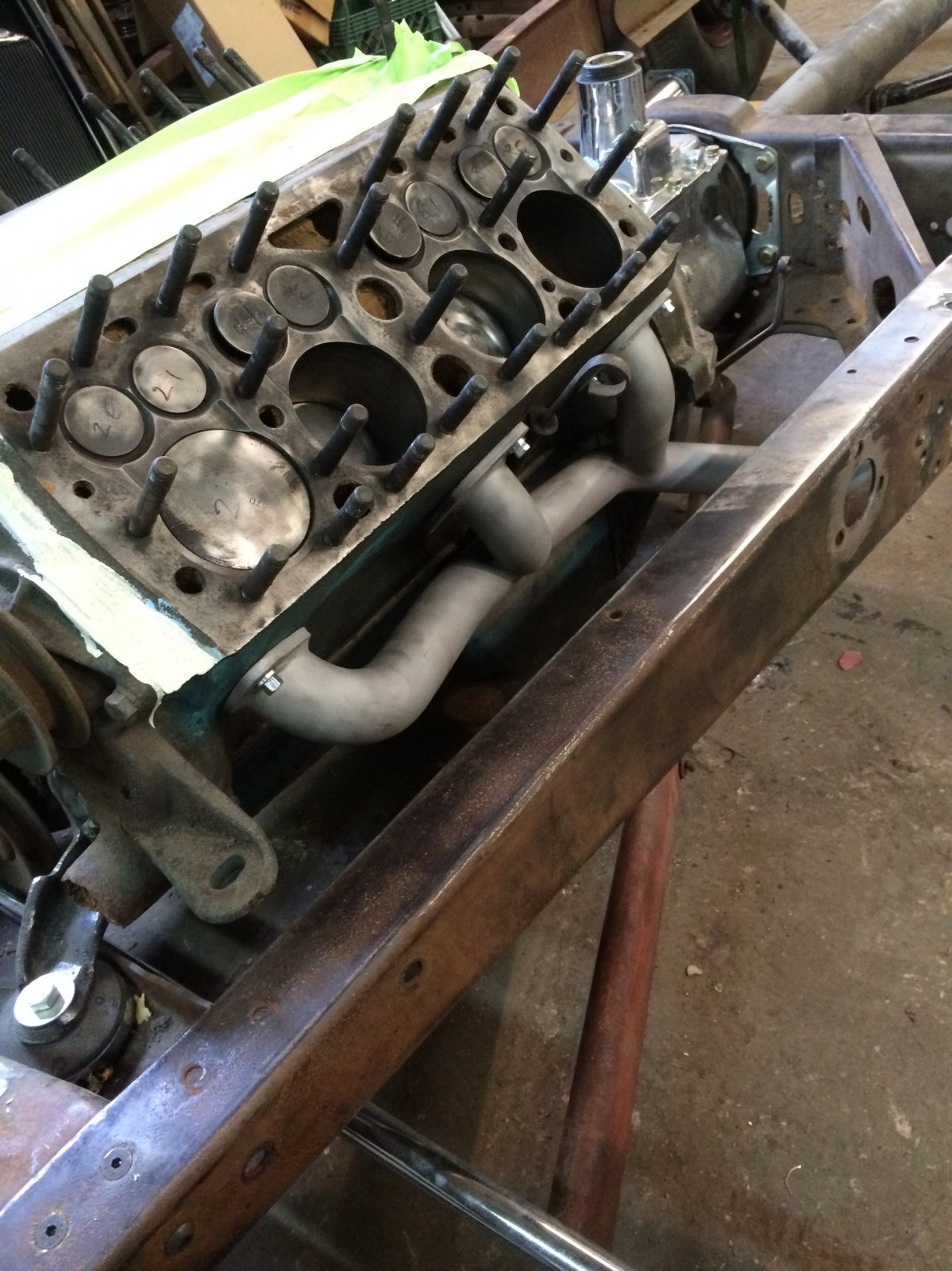

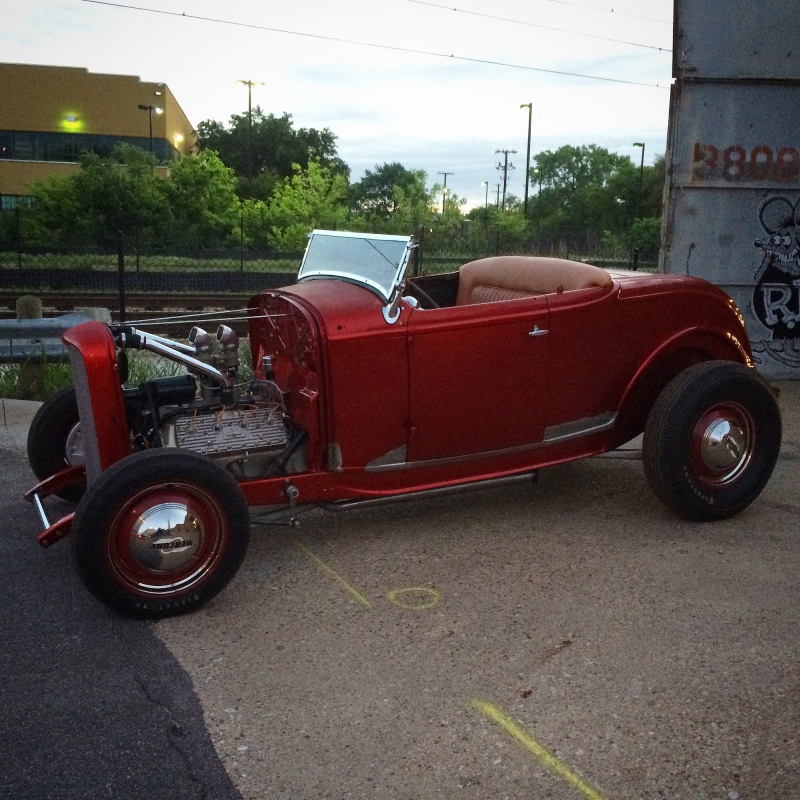

    I just looked and I can't find any photos of where I worked on the front crossmember. I guess I didn't take any for some reason, or I accidentally deleted them. Anyway, if you zoom in on the photo below, you can sort of see the crossmember. It's spliced just to the inside of the raised "bumps" in the crossmember for the radiator, back to the inside edge of the motor mounts.

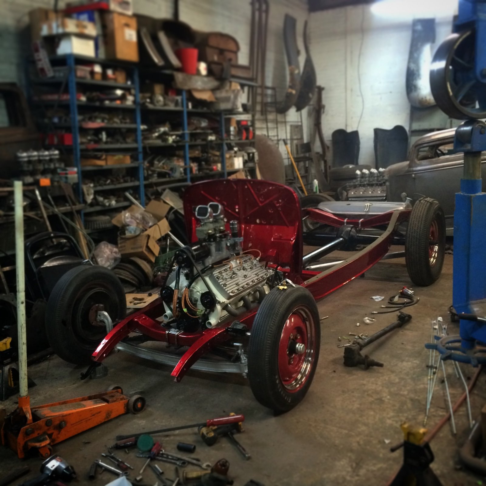

    In the above photo, I was in the middle of pulling the motor and transmission to fix a noisy throw-out bearing and a cluster gear problem. The '39 box now has a cherry gearset out of a rebuilt '47 Ford sideshift trans. I had it apart in about an hour and a half, and it was back together and driving the next day. It shifts so much better now!
    So far, that's about the only mechanical problem I've encountered, and I've been driving the car a bunch. I did hang the oil pan drain plug on a speedbump a couple of days ago, but I realized what was happening and was able to back off of it. That didn't seem to hurt anything, fortunately.
    Only other update I have for now is that I did some minor bodywork on the bare metal patches on the bottom of the body, and spotted in some red oxide primer. I think it looks a lot better than the bare metal spots did.

    Thanks, thats where I spliced my crossmember also.

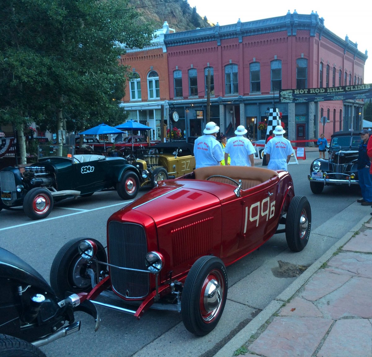

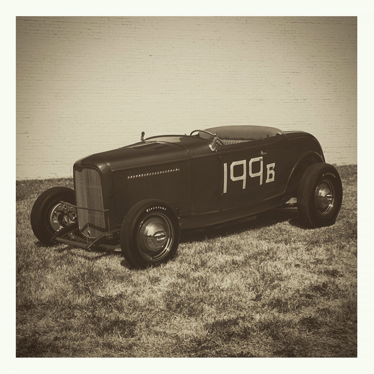

    Everybody likes pictures right?
    Here are some more pictures of the roadster, including photos from the Hot Rod Hillclimb and Reliability Run in Georgetown, CO.
    The last two are of the car in race trim for The Race of Gentlemen. See you there!
