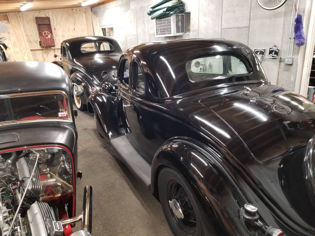

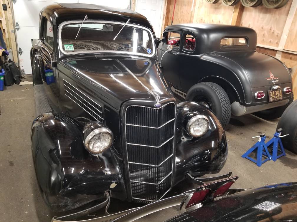

    Thanks again for everyone's suggestions. 20180823_073107.jpeg 20180823_073026.jpeg

    Nice bunch of cars! You are a lucky man. How do you keep a shop so un-cluttered?

    Looks like they are all completed roadworthy cars:eek:, unlike mine:D.
