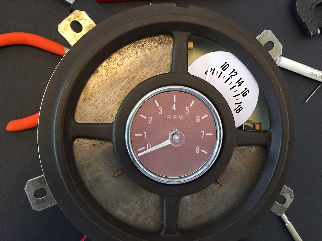

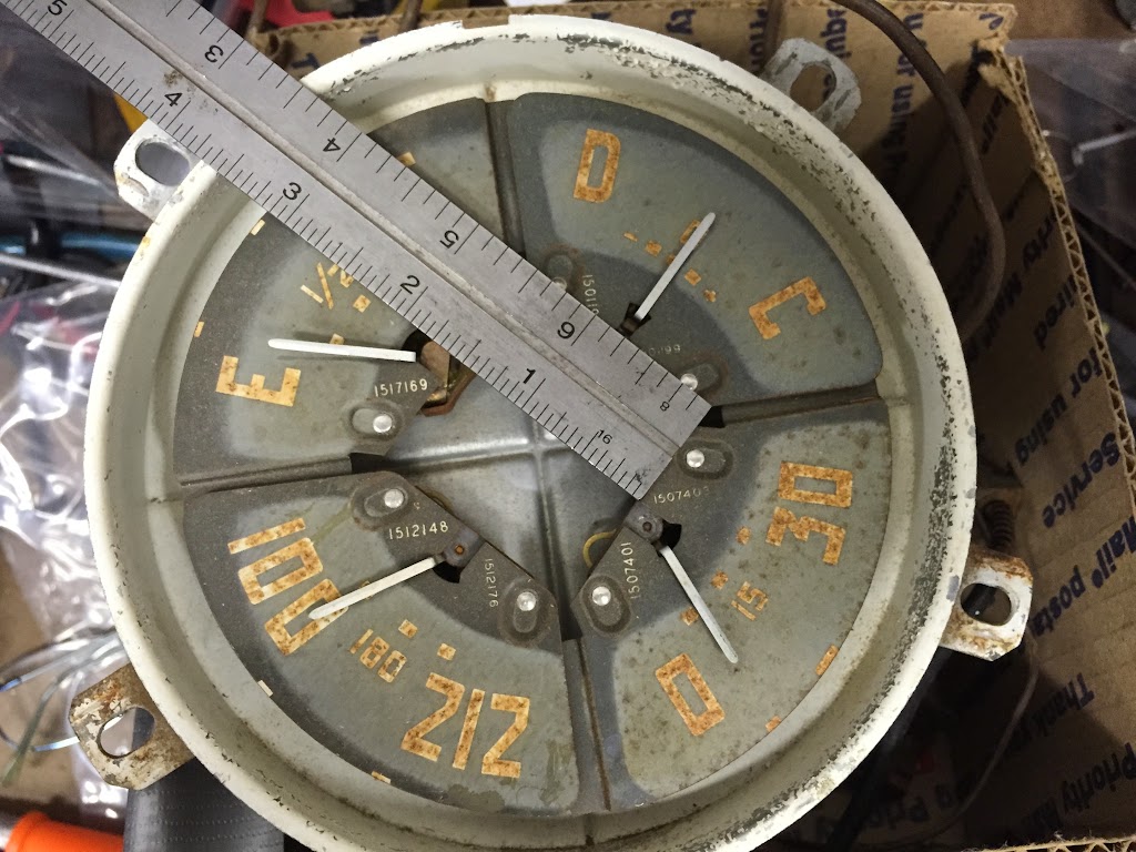

    I would like to try to incorporate a small tach in the center of my gauge cluster
    1950 Chevy 3100
    I have approx 1 3/8 space to fit something in the center
    Is there a tach with guts small enough to fit?
    I can open up the back of the housing so depth is not an issue,
    just need a small diameter.
    It would look something like this
    I would color the faceplate and dial to match the existing gauges

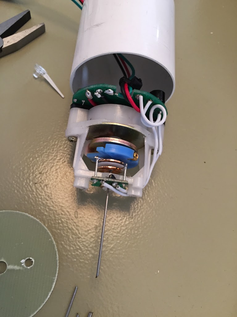

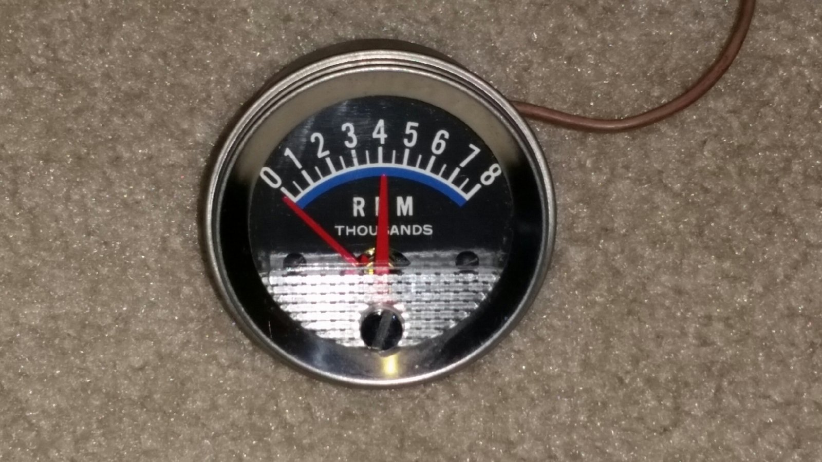

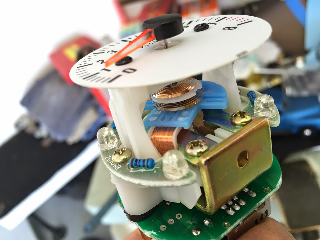

    this is the tach I dis***embled and tried last night
    unfortunately I destroyed the spring coil while prying up the needle
    A needle shaft extension should work, Just trying to figure out how to accomplish that.
    The guts of that gauge were about 1/4 too big.

    Before I'd try to modify a tach to be smaller I would quarter the original truck gauges. You can see they are just 4 gauges mounted in a cup which is already "Quartered" for you just enlarge the cup it won't be seen anyway. By the way, nice idea!
  10. not that one guy
    Joined: Mar 28, 2011
    Posts: 293
    not that one guy
    from So NV
    Ill check that out
    But the gap on the outer edge provided the light

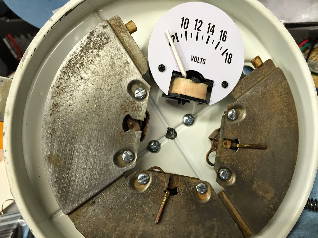

    Made a little progress

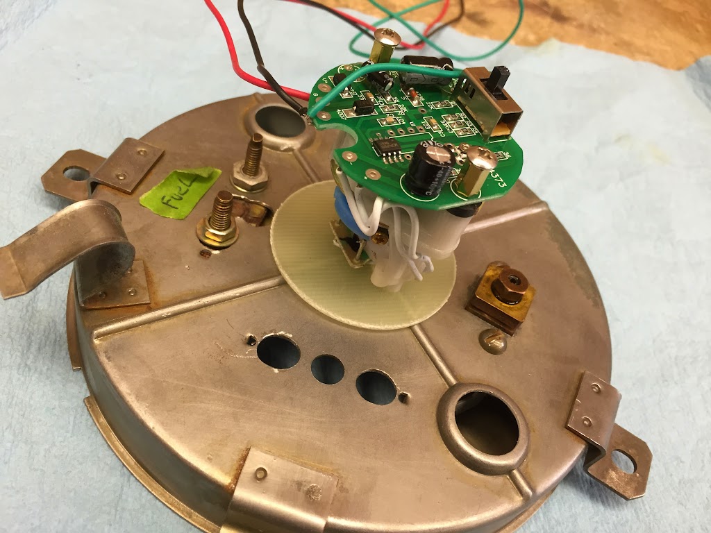

    I could not figure a way to to fit my trial tach in the housing so I mounted it to the back of the gauge cluster housing
    Now just need to figure a way to extend the shaft of the tach
    Not quite sure how to accomplish that.
    I'm testing the fit up with a spare housing I have.
    If I get this figured out I redo it with a better tach

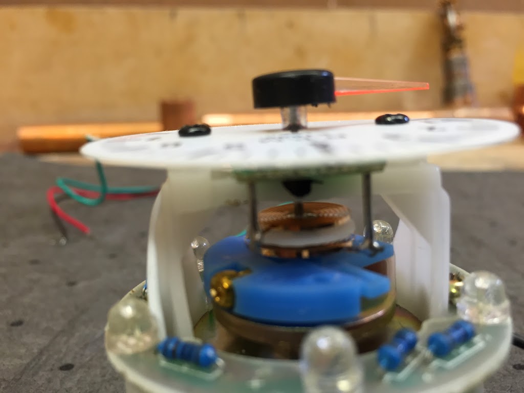

    After the tach was broken down it still did not fit inside , but it was close
    As I mentioned earlier this was a cheap tach I got off amazon, it was about 12 dollars and probably not very accurate. I thought I would use it as a test to see if it was possible to modify it to the AD gauge. If it doesn't work I'm not a lot of money, just time.
    Here's a pic of the small coil springs mentioned earlier

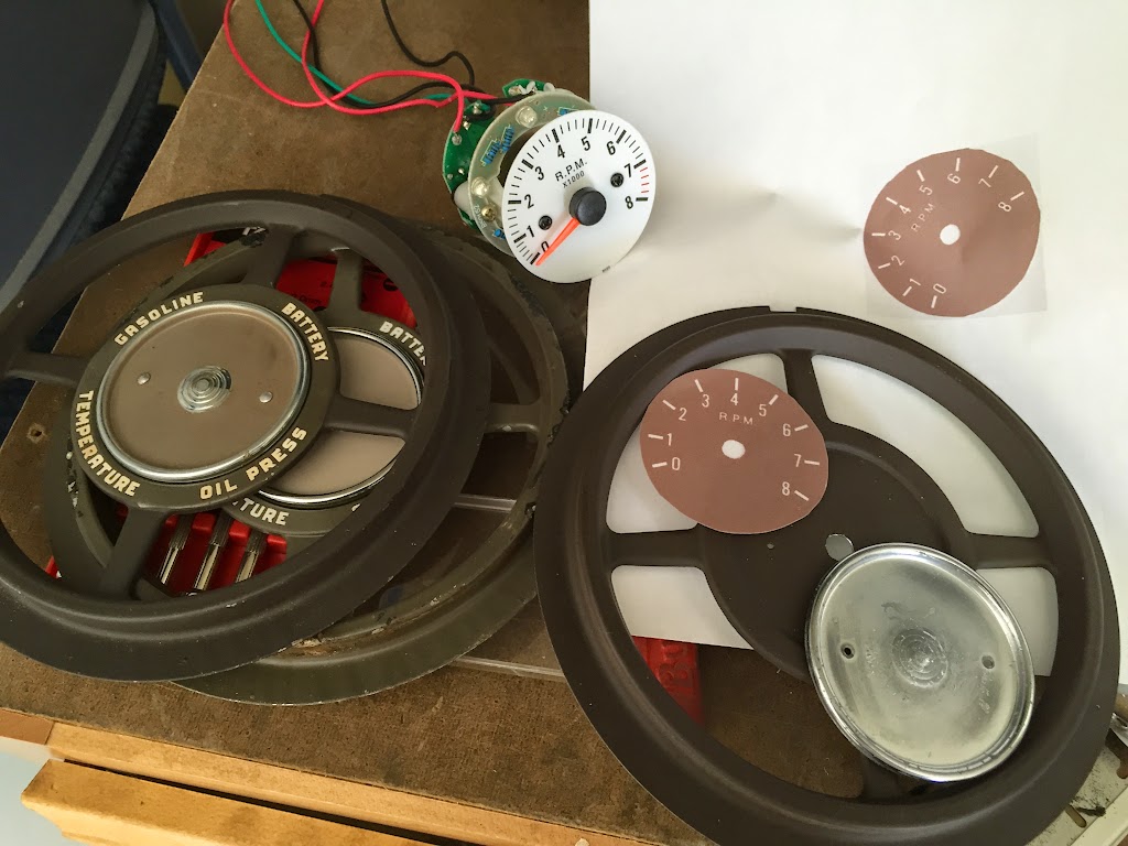

    A little help from my wife on the tach face. Matching the color,

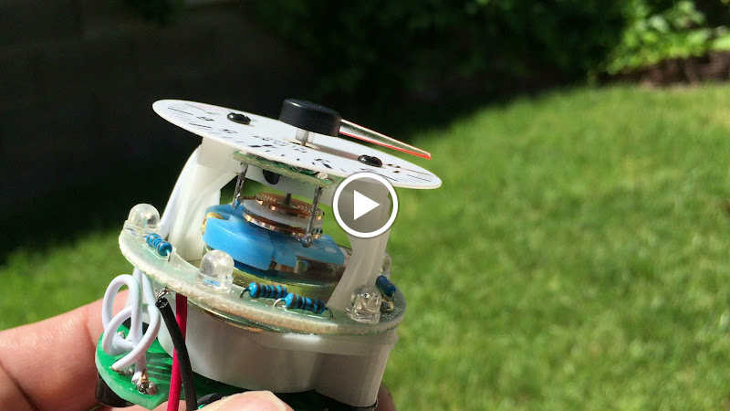

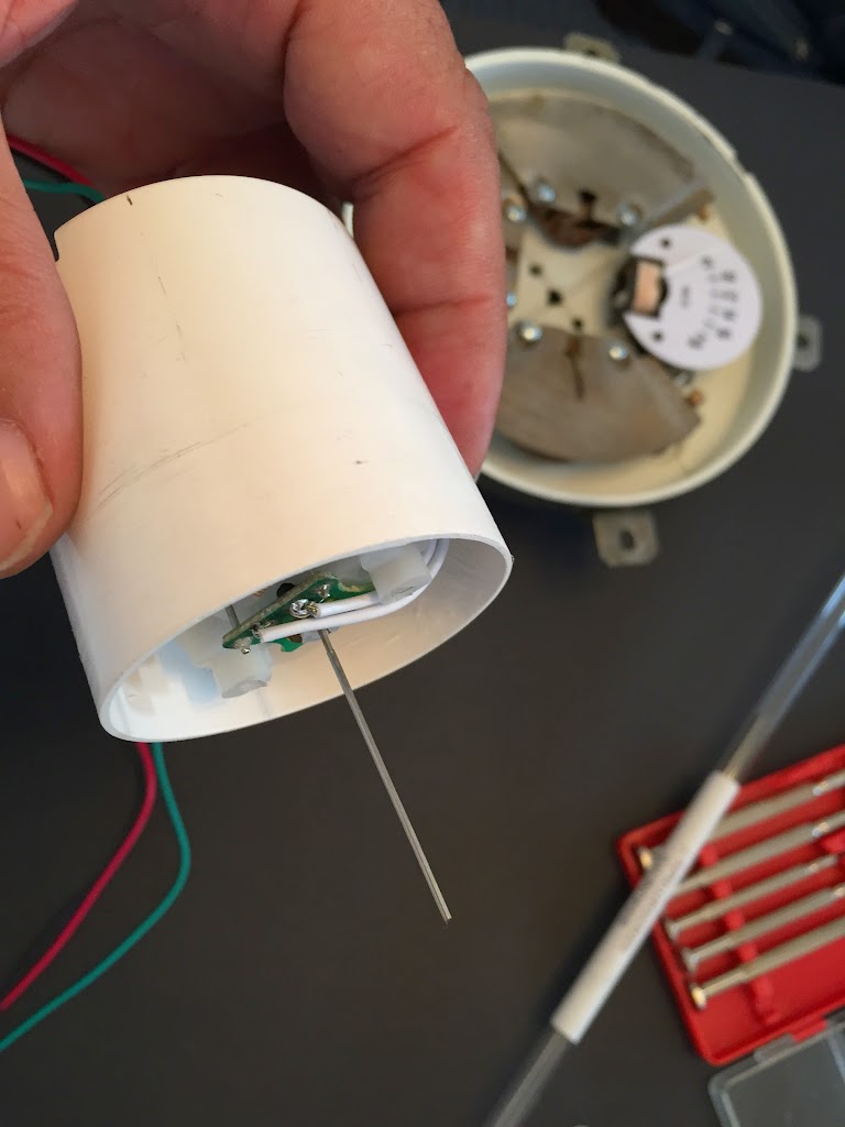

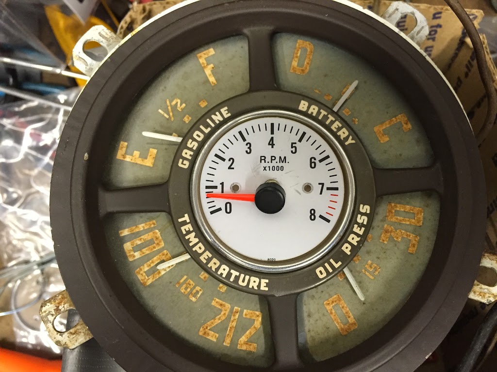

    I was able to extend the needle with the tubes I purchased.
    Still mocking it up
    Ran into a little snag on the first mock up
    The needle would not return to zero, not sure what the hang up is

    finished the mock up

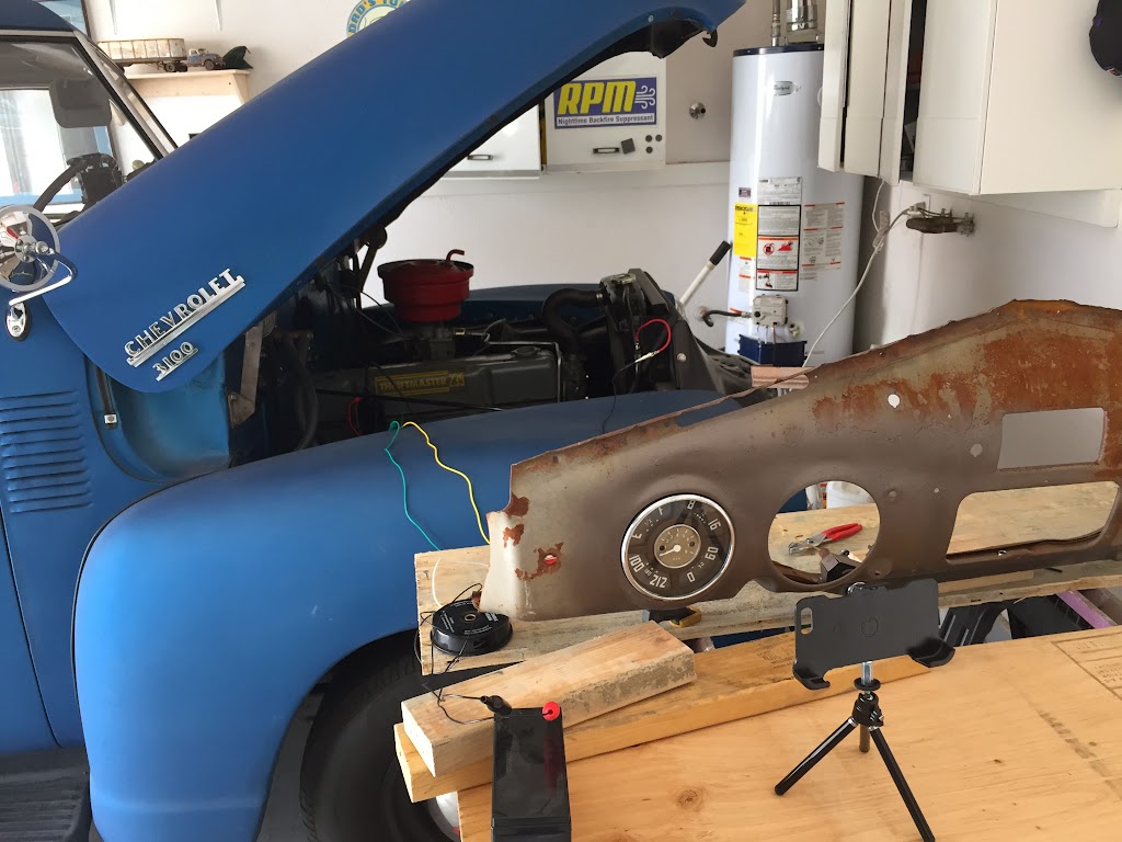

    finished a bench test
    the tach worked, I did this test with a cheap tach I got off amazon just to see if it was possible.
    here is the test
    The tach is not very accurate as I suspected, My idle is set at 450 rpm.
    but I can take what I learned here and incorporate it to a better tach maybe a
    Sunpro CP7906 Mini Super Tachometer II

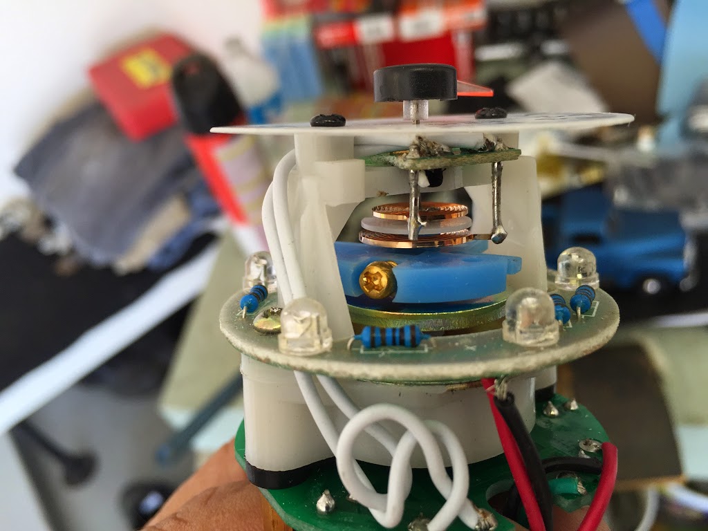

    the tach calibration might be off from the added weight of extension for needle. i'm sure it's light but any weight could change it. killer idea!
  28. not that one guy
    Posts: 293
    not that one guy
    from So NV
    Strangely it seems to be more accurate on the 4 cylinder setting
    But still off
    Ill apply what a learned here to a better tach. Maybe a 0 to 6 k mini will be better suited.

    does the needle just need to be rotated?
  30. not that one guy
    Posts: 293
    not that one guy
    from So NV
    Looks like 0 has a positive stop, you can see the coil resting against it in this pic
    But there is a lock collar, I'm not sure if there is any adjustment there. Seem like the needle needs to be loaded more
    The needle does move at idle, just dose not register correctly.
