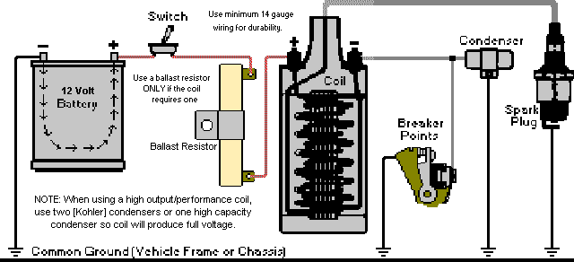

You will need to add a ballast resistor shown above to reduce the voltage to the coil just to make the points last longer. Your distributor will work just fine on a 12V source once it is reduced with the ballast resistor. A ceramic ballast resistor mounted on the firewall is a classic sign of an old hot rod. I mounted mine prominently because that is how we did it
