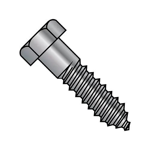

    Try a hex lag screw to snug it up as a temp fix till you do it right. Lag studs are also available.
    sgtlethargic likes this.

  27. The threads are already pulled out of the original hole. In order for a lag to work, it will need to cut its own threads. Me no likey that idea. If you are going to use anything to cut new threads, it should be a tap.
    Tap the existing hole using whatever tap is able to leave threads in the present hole (metric or std/imp). Find a bolt that fits. Chop the head off the bolt and convert it to a stud then drill out the manifold to fit. If the manifold can't take a slight hole enlargement, then thread the new bolt into the head, mark how much sticks out. Now, the part that sticks out of the stud needs to be machined thinner so it can accept the original thread size. Thin out the bolt on either a metal lathe, a drill press and a file or grinder, of just a grinder. Cut the new threads. Done.
    The existing hole will help keep the tap straight, ***uming you are doing your best to line it up in the first place. No helicoil, no right angle drill, no head removal, just a tap set, a bolt, and a grinder.
    Personally, I'd use the drill and helicoil method but this will work too.
    sgtlethargic and ekimneirbo like this.
